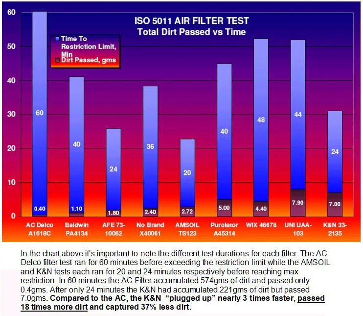

  • K&N 33-2114 Air Filter
    • Go back to stock. A K&N lets way too much dirt and fine dust into the engine. Really. Take a look at this chart from an ISO lab test of various air filters, the K&N was dead last in terms of its ability to filter. Especially note the last part in bolded text, the lab's words not mine.

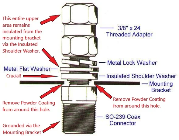

  • Teraflex CB antenna bracket
    • Ok just make sure to remove its powder coating in the areas shown or the antenna won't work well.
