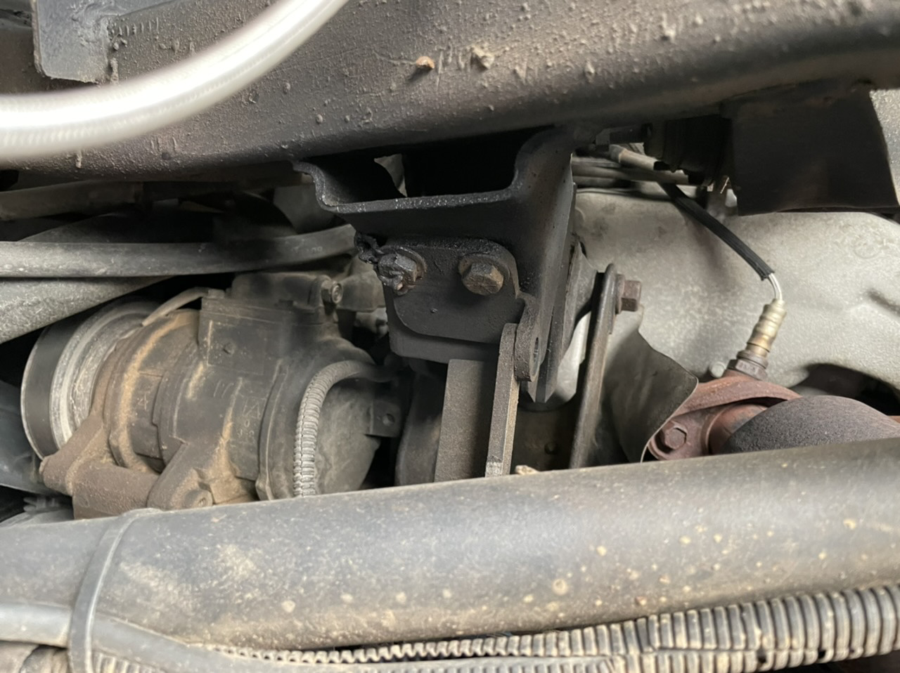

When I was out wheeling last weekend with @starkey480, I kept hearing a weird noise underneath my vehicle when I would start getting to higher speeds and hitting bumps. It sounded like metal-on-metal, but it didn't sound bad, just like a piece of metal tapping against another piece of metal.
I was underneath the vehicle today with the wire wheel touching up some spots where there was some very light surface rust, I look up, and low and behold the Savvy engine skid is missing a bolt entirely from where it's held onto the frame rail bracket next to the header.
While I am not 100% certain this is the source of noise, it certainly stands to reason that it may be. Not sure how this happened, but it would appear someone may have just forgotten to install it. It didn't however make this noise until this last wheeling trip (and we had gone wheeling before then), so I can't really explain that.

I had some of the center philips and one frame bolt fall out on my Colorado trip. Mostly because I’m just a dumbass who can’t tighten things. Shouldn’t be that big of a deal, just make sure you still have the spacer if it was one of the bolts that uses one between the skid and frame.
I am not sure this is your fault, I have had them come loose more than a few times as well. Some of the others said the same thing and many have added blue loctite.
This is the bolt that is missing:

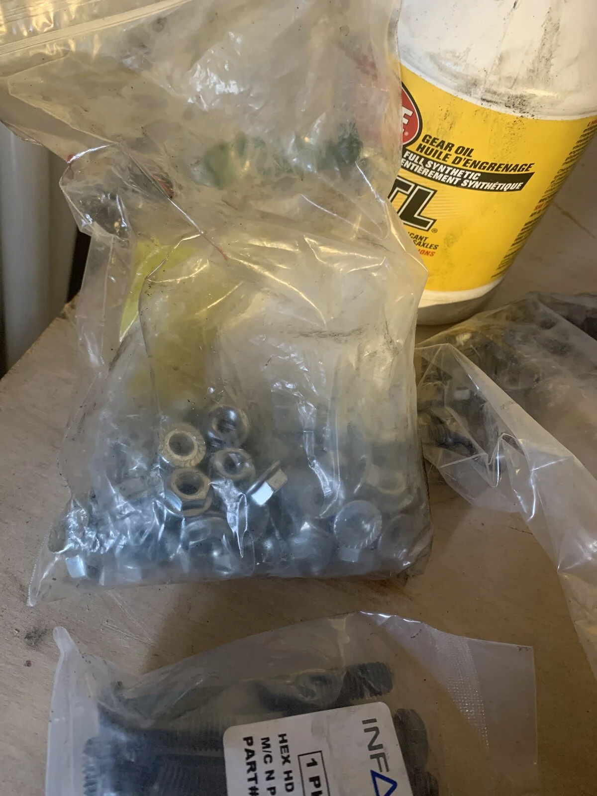

Serrated flange nuts are good lock nuts for this application so long as you get them tight enough. I lost some #4 phillips flat head fasteners before i bought a bit i could use on an impact.
My bad. For some reason I thought you meant the transfer skid into frame connection.
I bought bag of these from McMaster along with a bunch of the philips bolts. Pretty cheap and handy to keep around since none of the stores near me stock them.
I am lucky, the ACE near me has tons of these things.
You happen to have the size info handy, I was going to order some replacements and planned on pulling one out but if you happen to have it that would be easier.
