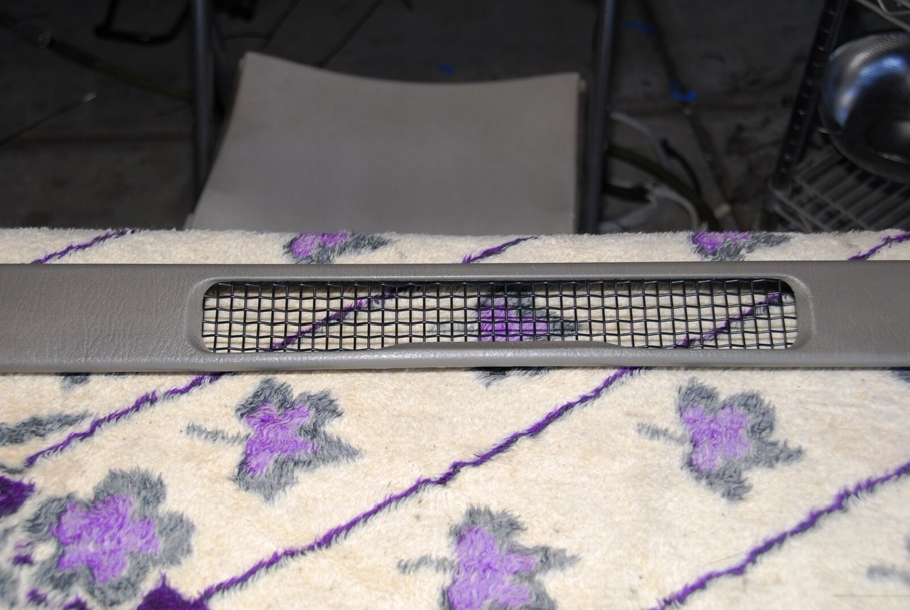

What replacement mesh did you use? How did you bond it to the back side?!
I am about to do this little project myself…
Basis 3 x 3 stainless wire mesh from McMaster Carr. Carefully cut to fit and then I use a combination of plastic bonder, soldering iron melting of some of the bits and JB weld to stick it in place.
Do you paint it?
I just looked on their site, searched for stainless steel mesh, and found a 1 ft by 2 ft piece. Is this the correct?
https://www.mcmaster.com/mesh/mesh-size~3-3/
304 Stainless Steel Wire Cloth, 3 x 3 Mesh Size, 0.286" Opening Size
Looks like it. There are many on there depending on what your needs are. I like the stuff that is mashed around the cross bars but it is very expensive. The plus is the wires don't move around when you cut it. Best way to cut is with a cut off disc. The stuff in Chris's is not the mashed stuff. Just have to be gentle and pay attention when you cut.
