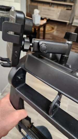

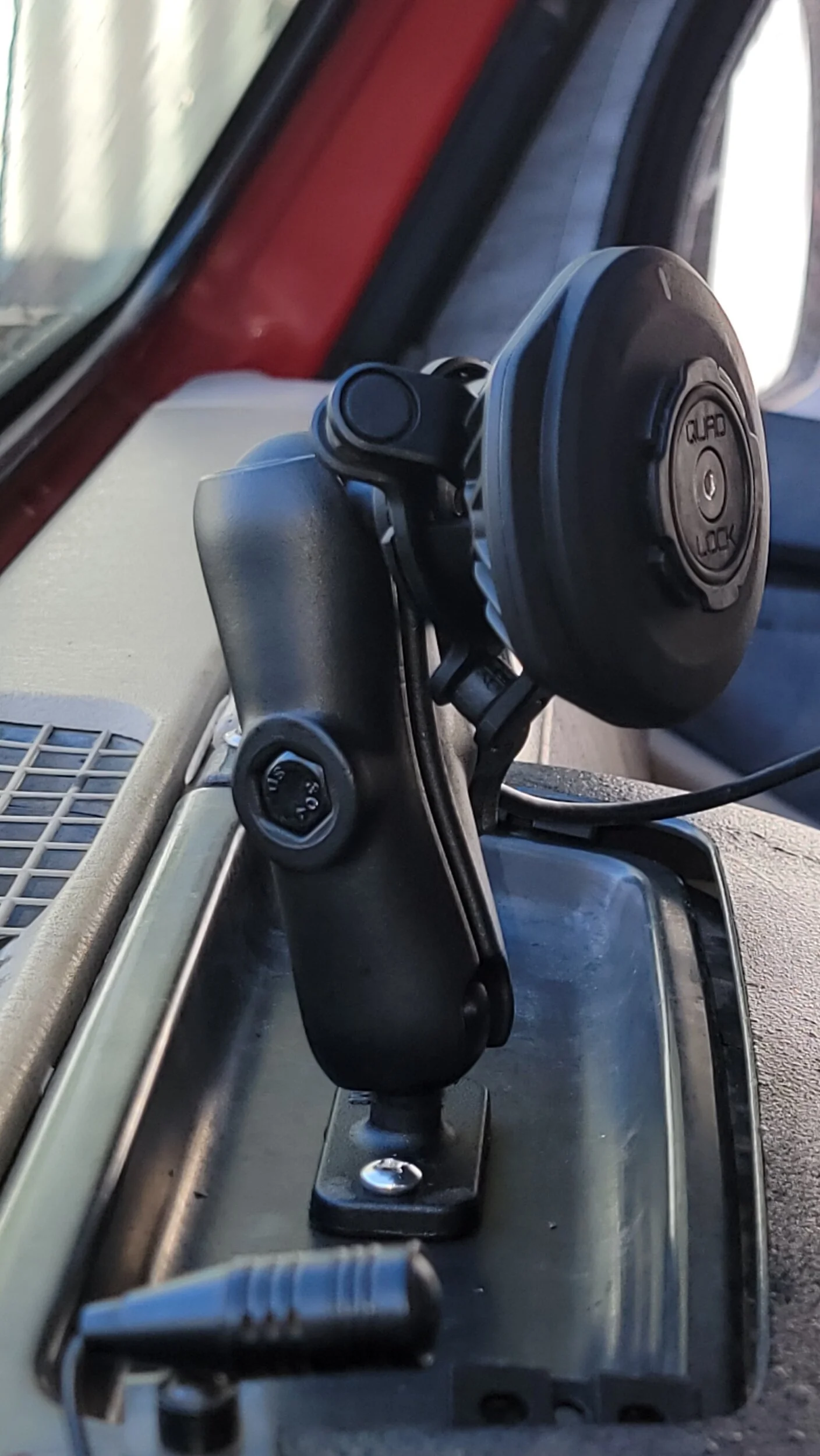

I have one of these. It stayed on the last few wheeling trips. No vibes on road either. The mount is aluminum. They do make ram mount and mountain bike style mount bases that hard snap to the back of phone if you want more holding power. I run this mount in my daily and jeep now.
I ended up with this because it's one of the few cases with magnetic mounts that work for Samsung. Basically adds stronger magsafe to your phone.

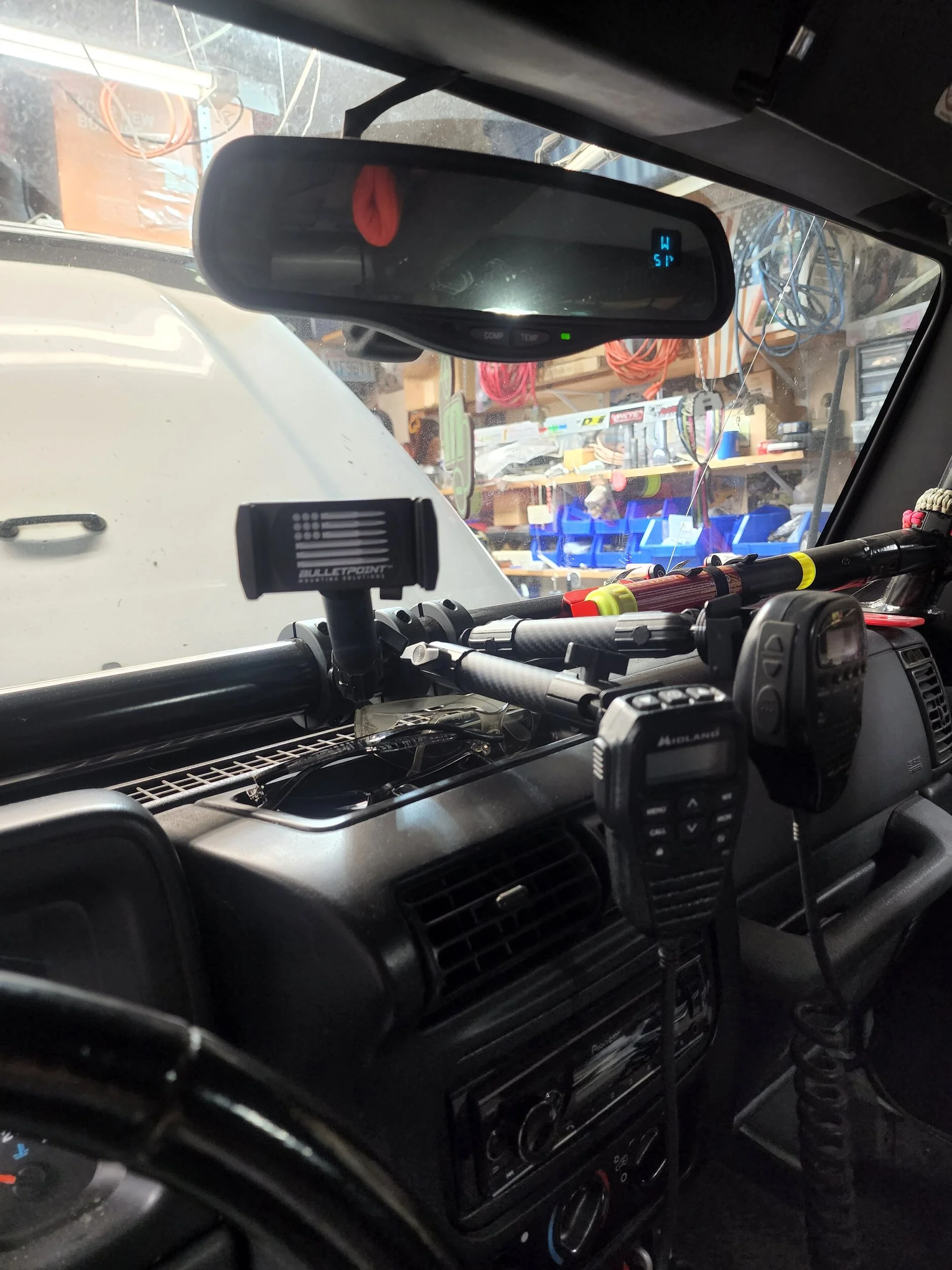

This was our solution , the Hug Buddy . They work great for our situation because I have a co-pilot/navigator . I removed the airbag and used that area for a communication center . There used to be a set of Wilson Sleek cellphone cradle-boosters there , but technology changed and the were now useless . We found the Cell Buddies to take their place . On the hood where the rubber windshield pads were , we have short cellular antennas which used to be hooked up to the Wilson Sleeks . Now we connect them to a Cradle Point modem/router for WiFi in the Jeep . The Cradle Point gets cell service signal much better than a cellphone therefore keeping Internet in remote areas better than just a cellphone . The CB and Ham radio mic holders are strong magnets .

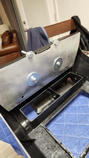

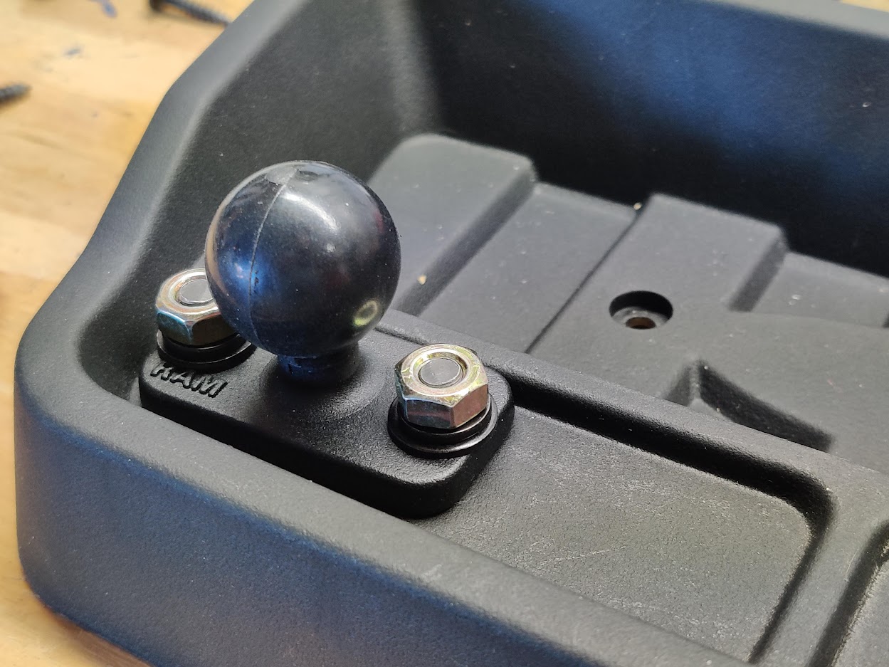

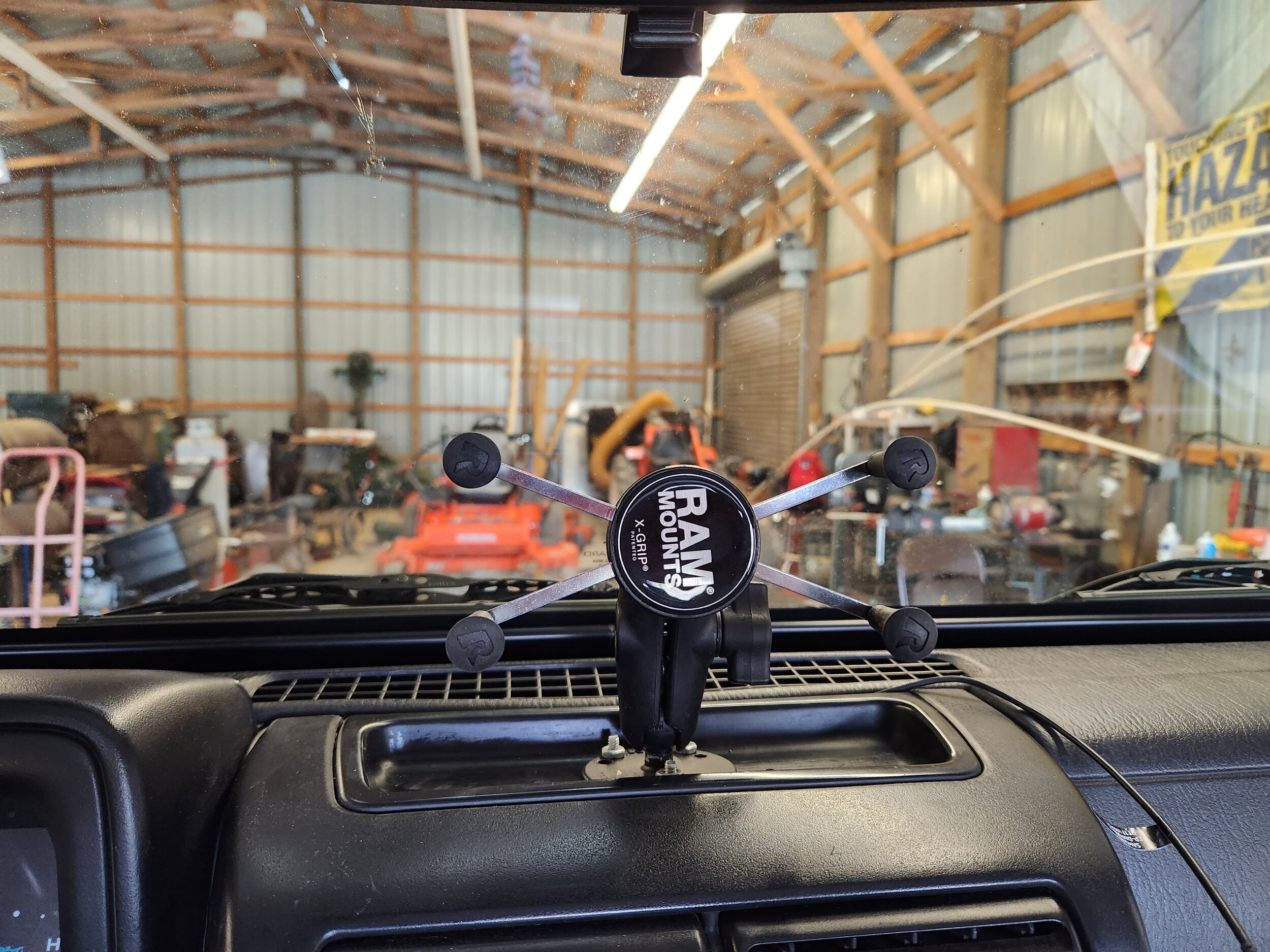

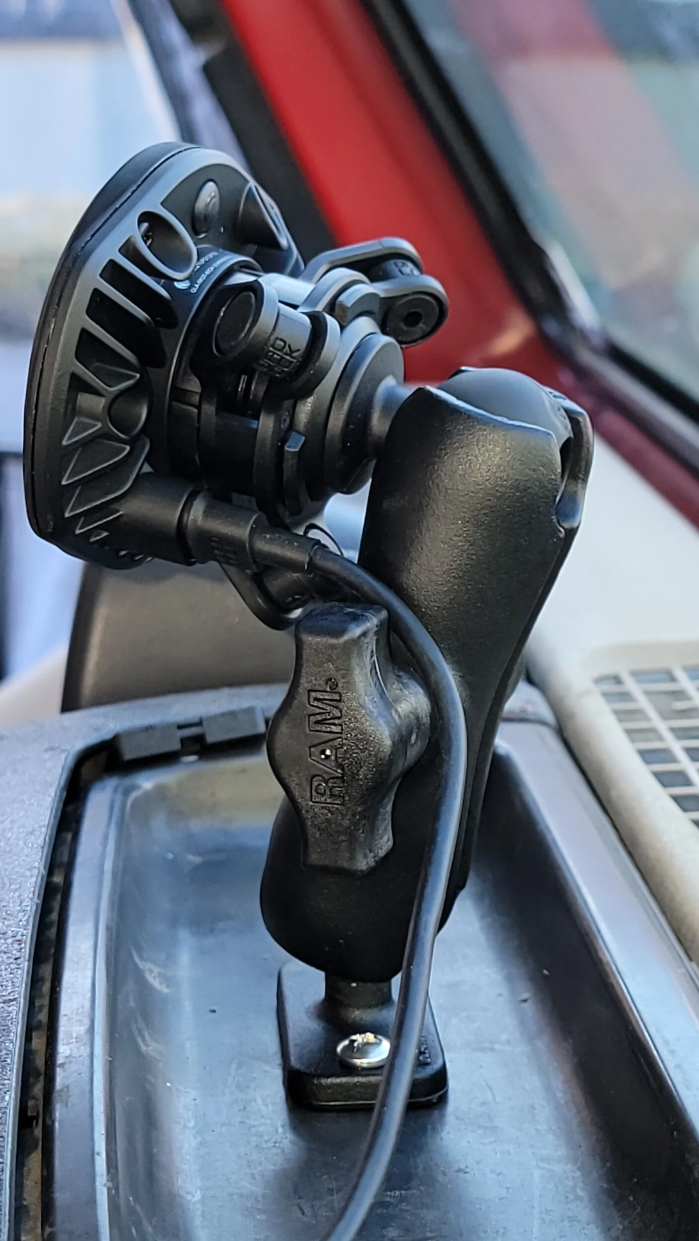

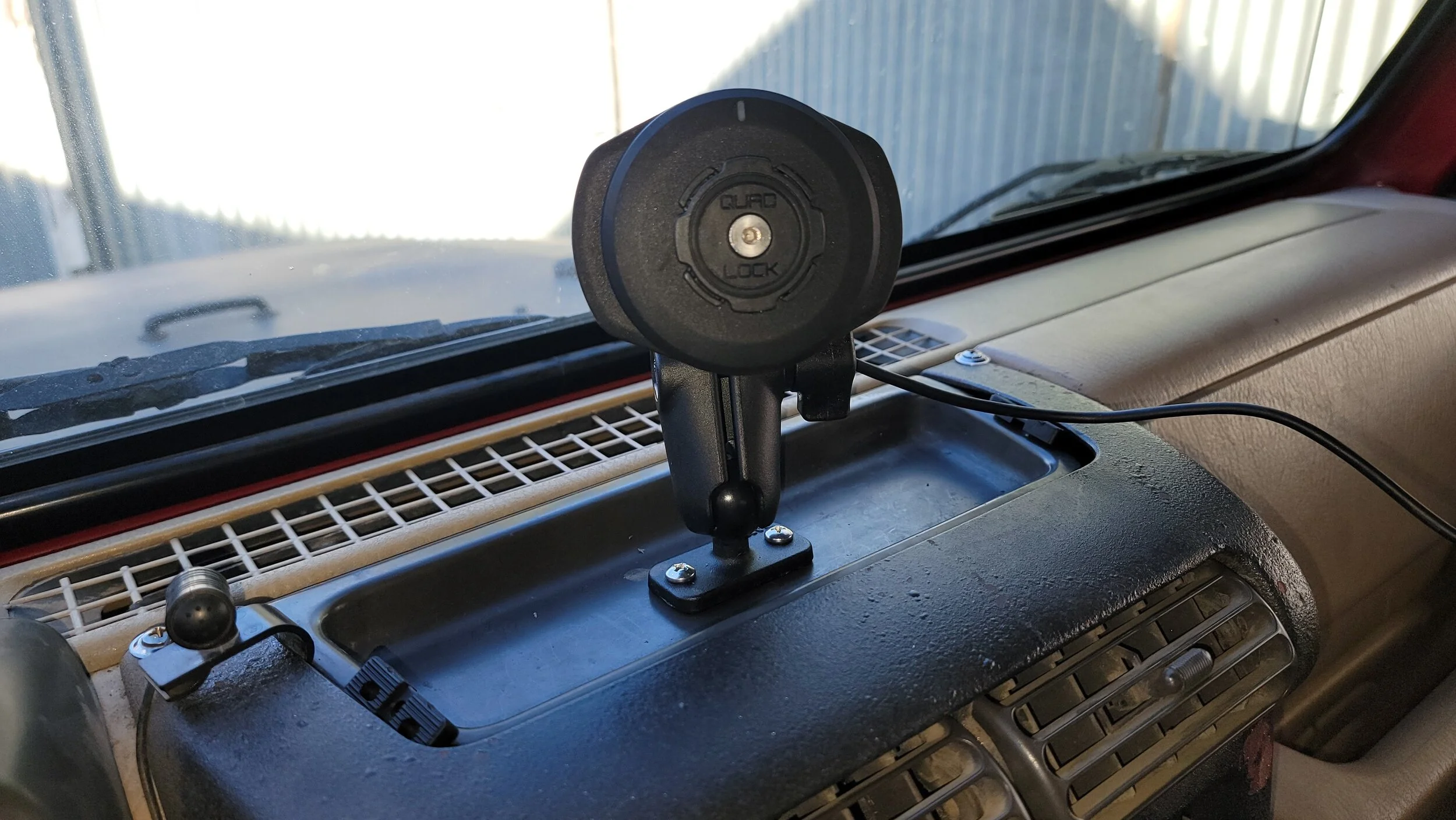

@John Cooper how is this holding up? I did the same thing and the vibrations from road corrugations, slamming on rocks, etc finally caused fatigue cracks of the plastic and the durn thing fell off. The '03+ tray isn't attached solidly and there is little support from the bezel.
Mine is still holding up. The tray started to break away, but gorilla glue took care of it. I haven't been easy on it, but did buy a backup Bezel just incase.
