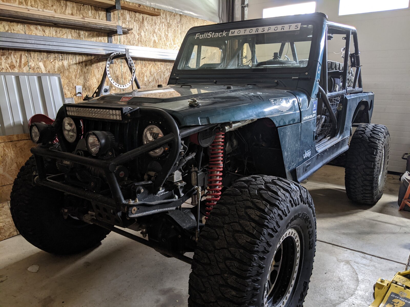

Well, the TJ is going to it's next owner. I've had it for 21 years. Learned how to build suspensions (8 iterations that I can remember) swap engines (two different brand V8s), and learned how to tune shocks on it. Lots of memories.
It was the tires wasn't it. 😜
Last week we did a Roadkill style 4 day GM V8 swap into Kevin's TJ. JY 4.8 with 4L80E. Made all the mounts, using bolt ins would have been quicker. We are keeping the Jeep PCM for the stock gauge cluster.
We are currently building a pretty hot 5.3 for it, the 4.8 was just to get it swapped and running.
Kevin did an XJ rear 44 with disc brakes, and rear triangulated 4-link midarm, 2.5 inch lift.
