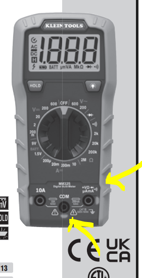

Trying to track down a parasitic draw on a 98. I cant recall what's what on my DVM. When set at 200Ma I get a .2 reading, or set at 20Ma I get a .02 reading. Is this excessive? IIRC, 50Ma is normal on todays ECM equipped vehicles. So what would 50 Ma draw look like set at 20Ma or 200 Ma dvm setting? I think im going senile :cry: Here's the kicker if the draw is to much. This thing had/has issues based off battery/starter wiring mods. Somebody set up battery cables like the following. 2 HD cables off the battery neg, 1 to the block, the other to the body, Good I say. The pos battery terminal has one cable into the PDC in, and then out to the alt. The other straight to the starter. Disconnecting either the + or minus cables, and using my DVM to monitor draw I get that .2 draw when either + or - cables touch the battery. I considered a bad diode in the alt, but I still get the draw with the alt cable unhooked and then landing the PDC cable. I've pulled every fuse and relay there is and still the draw.

Unless I'm also going senile, it should be outputing mA, when you notch down the setting it gets more accurate. So the 20 reading is more accurate than the 200. It is closer to .02mA than .2mA. You should be able to step down one more if the setting is available.
That seems like very low draw, there are normally two sockets to choose from for amperage, are you using the right one?
Yes, I started with the 10 amp probe socket and saw nothing. Then moved the probe to the middle/Ma socket with the black lead in the ground setting. Its like .02 is OK but .2 is bad. So which do I have, Ok or not OK, sheesh. And to think I once was a math wizard of sorts. :cool:
Either .2 or .02 mA should be fine, both are a fraction of a regular self discharge rate of a battery. Even .02 Amps would be okay (20 mA).
