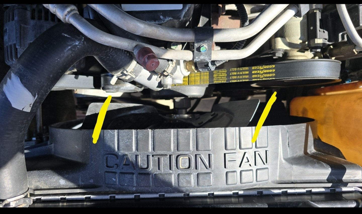

Be certain your fan is attached to your clutch in the proper direction. Fins should be at a diagonal towards the driver's side (US) as pictured below.

Fins are definitely in the right direction.

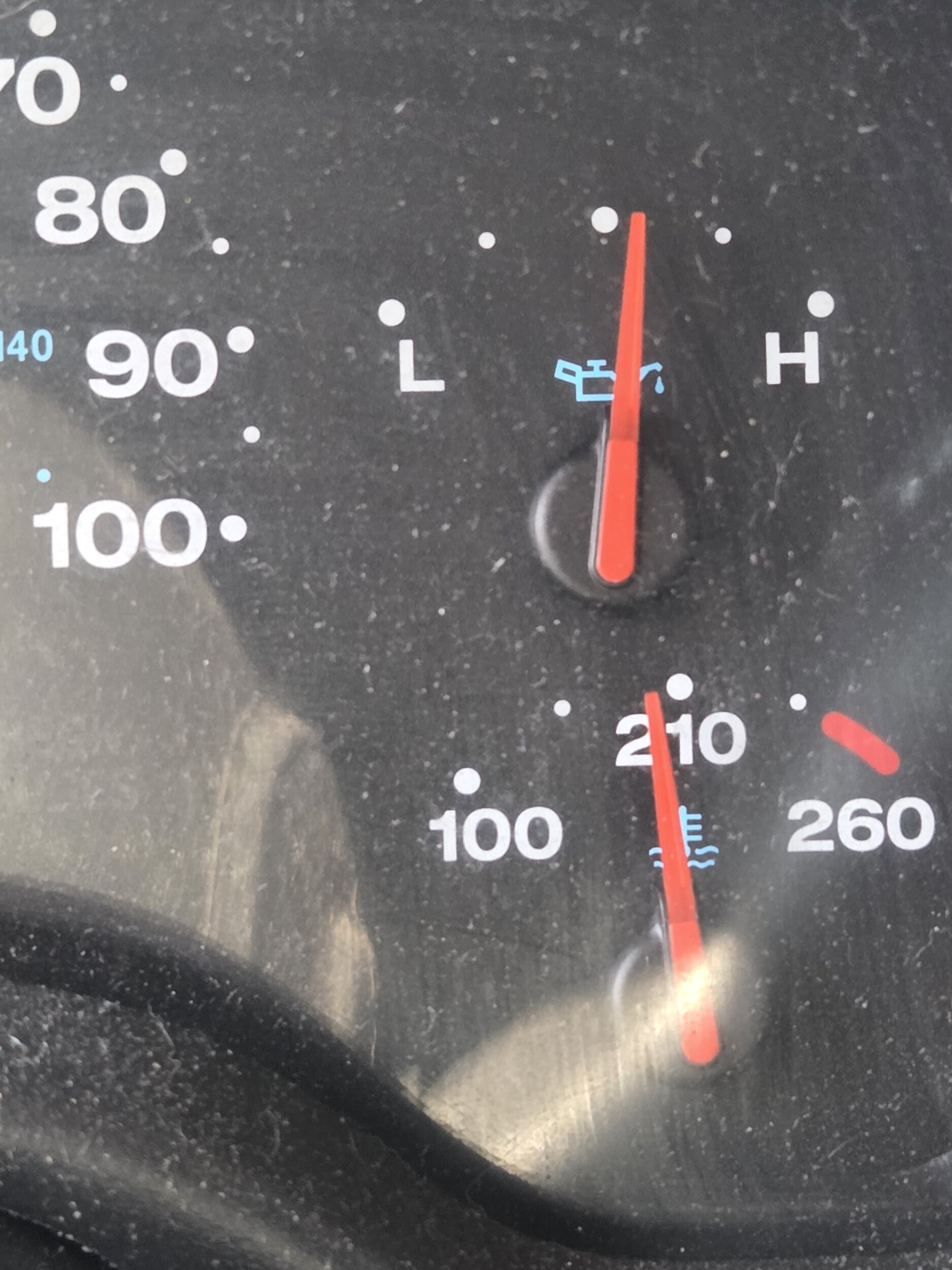

Sitting at idle 90° after just having driven 35 mi with the AC running and it's holding temp under 210 I think everyone was right and that it was radiator clogged. I don't have a pic but the bottom two or three inches of the old radiator were covered in Old leaves and Gunk and whatever and I couldn't see that without taking the radiator off probably had other issues as well but I haven't opened it up to look inside but the new radiator is definitely working like a charm. And that was literally the last piece of the coolant system so now I have a complete overhaul on my cooling system on my Jeep that I didn't really want to do in the first place but I did anyway. I really appreciate everybody's help and advice!
