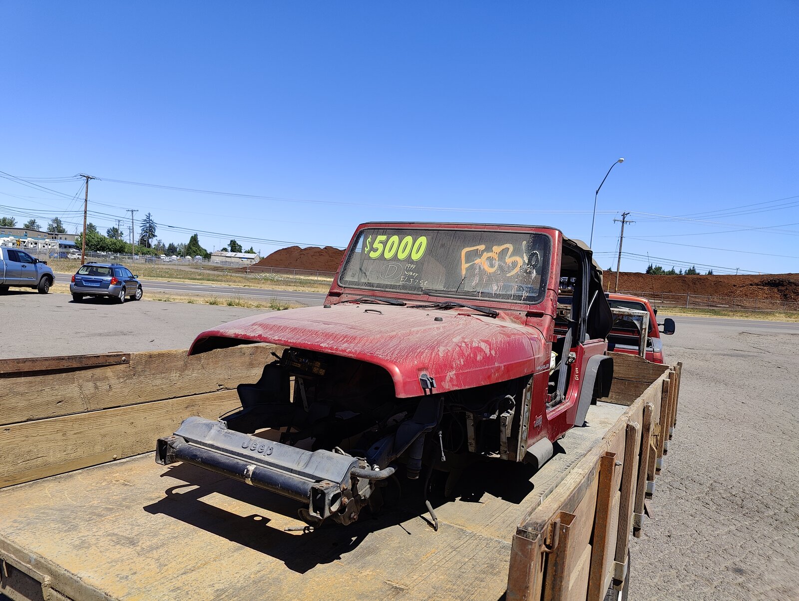

Drove all afternoon to grab my TJ...6 hour drive with my truck and trailer...7 hours back. An hour of winching and loading.

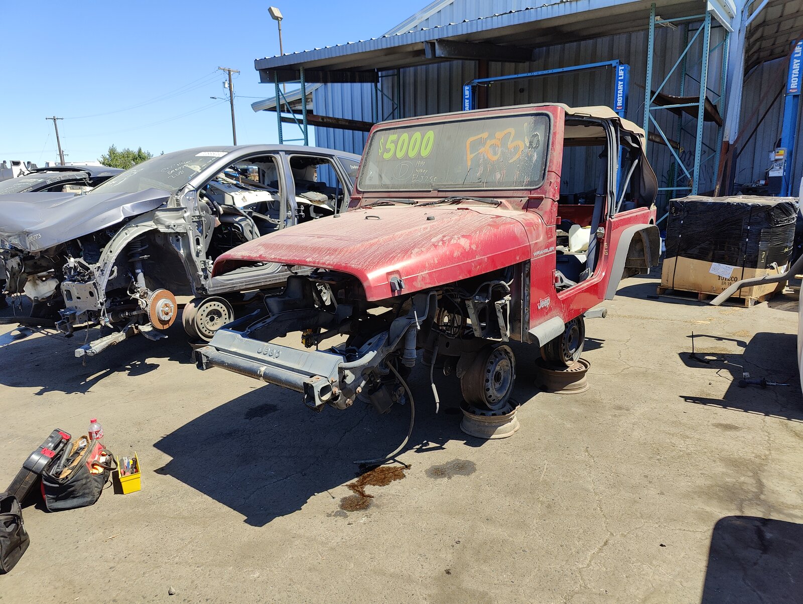

Got home at 5 am. Slept until 7 am. B&R called and they wanted me to look over my frame and tub. Unloaded my white 97 and drove my truck, trailer and tools to the Eugene yard.
Talked to folks... basically they wanted to know exactly what I wanted...which I completely appreciate. I offered to do all the work on Phoenix...flame red 99 4 cyl chassis. They wanted the fenders and seats...since they didn't say anything about the sliders I kept the passenger flip and fold for my driver side. Me doing the work also meant getting Phoenix today and not next Monday or Wednesday!
Phoenix came with everything. I paid a little more for the hood. I ended up with the tailgate, roll cage (with padding!), two center dashes, the dash, console...the radiator unfortunately had a hold in the plastic tank. The fuel filter housing came in handy.
Got it loaded and home. Pulled all the stuff out and made sure the frame and tub were rust free...they are pristine.
