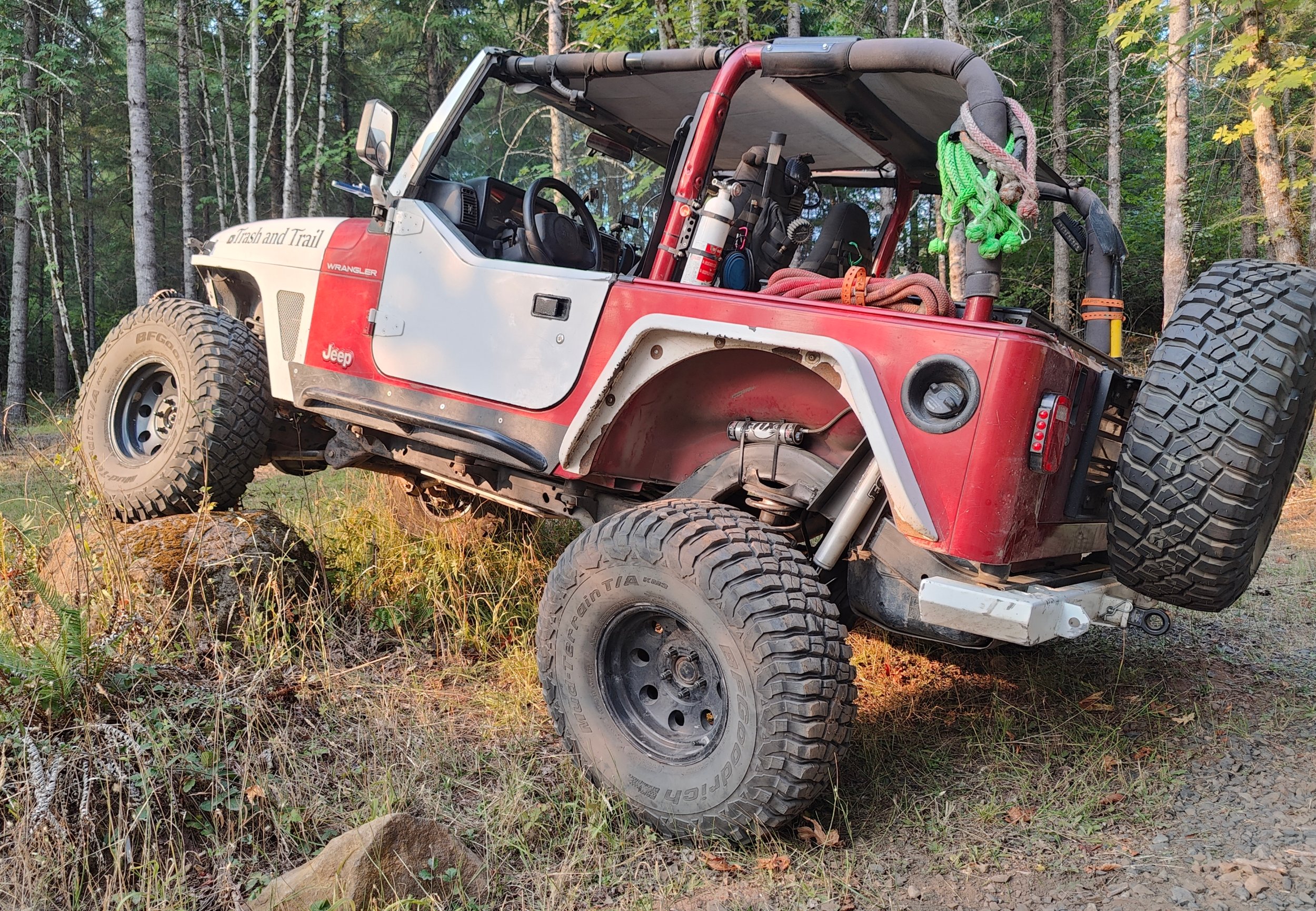

Drove to town for cheap gas. Astro in Eugene is $3.49 cash instead of 3.94. That and I needed non ethanol for my lift. Man everything drives really smooth.
I need some pointers to destructions for operating the single dial on the shock reservoir.
Weighed the Jeep coming home. Emptied out all my camping gear. Had my tools. 2080 front, 2260 is the back...but that's also with 11 gallons of extra gas.

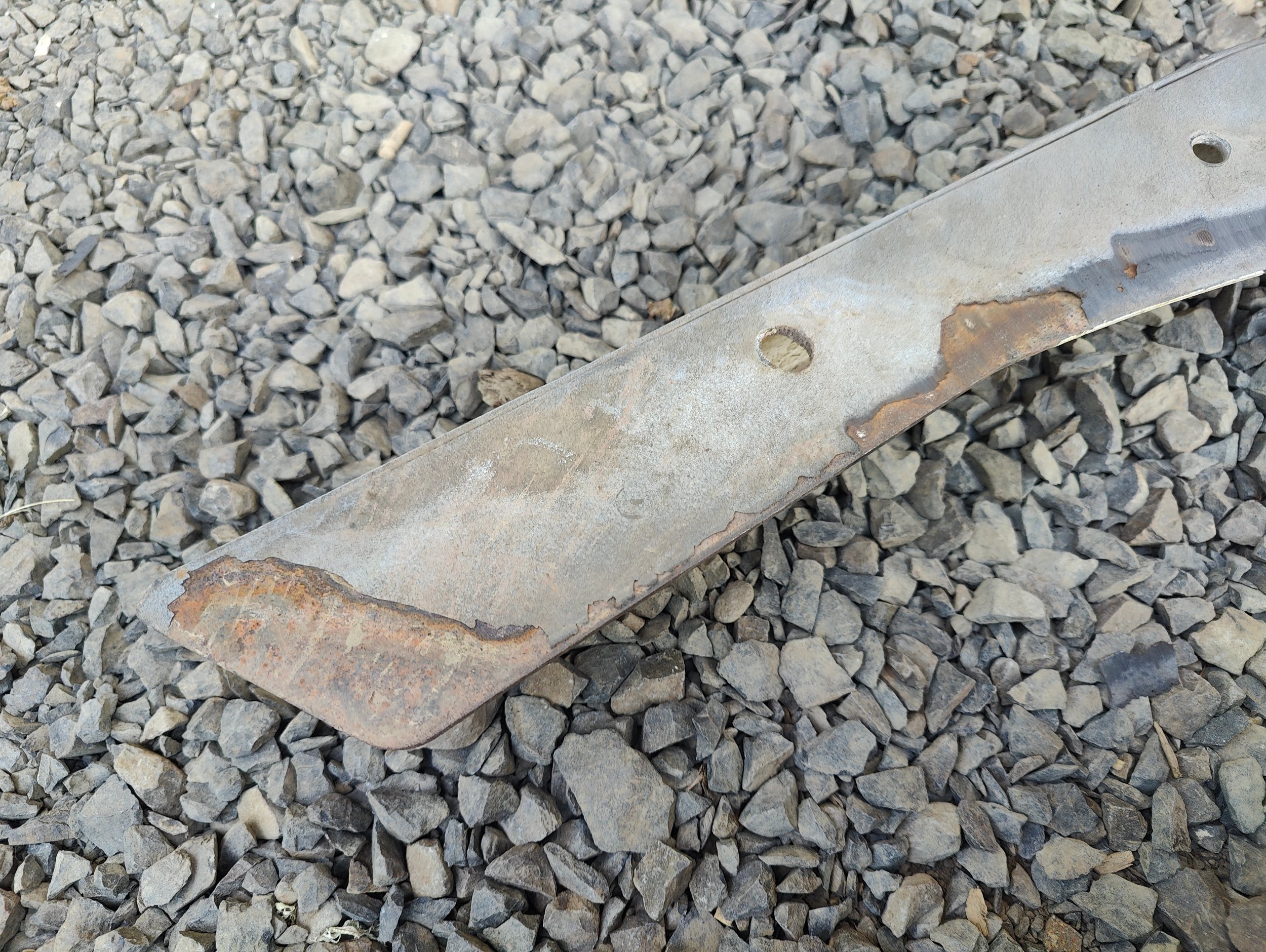

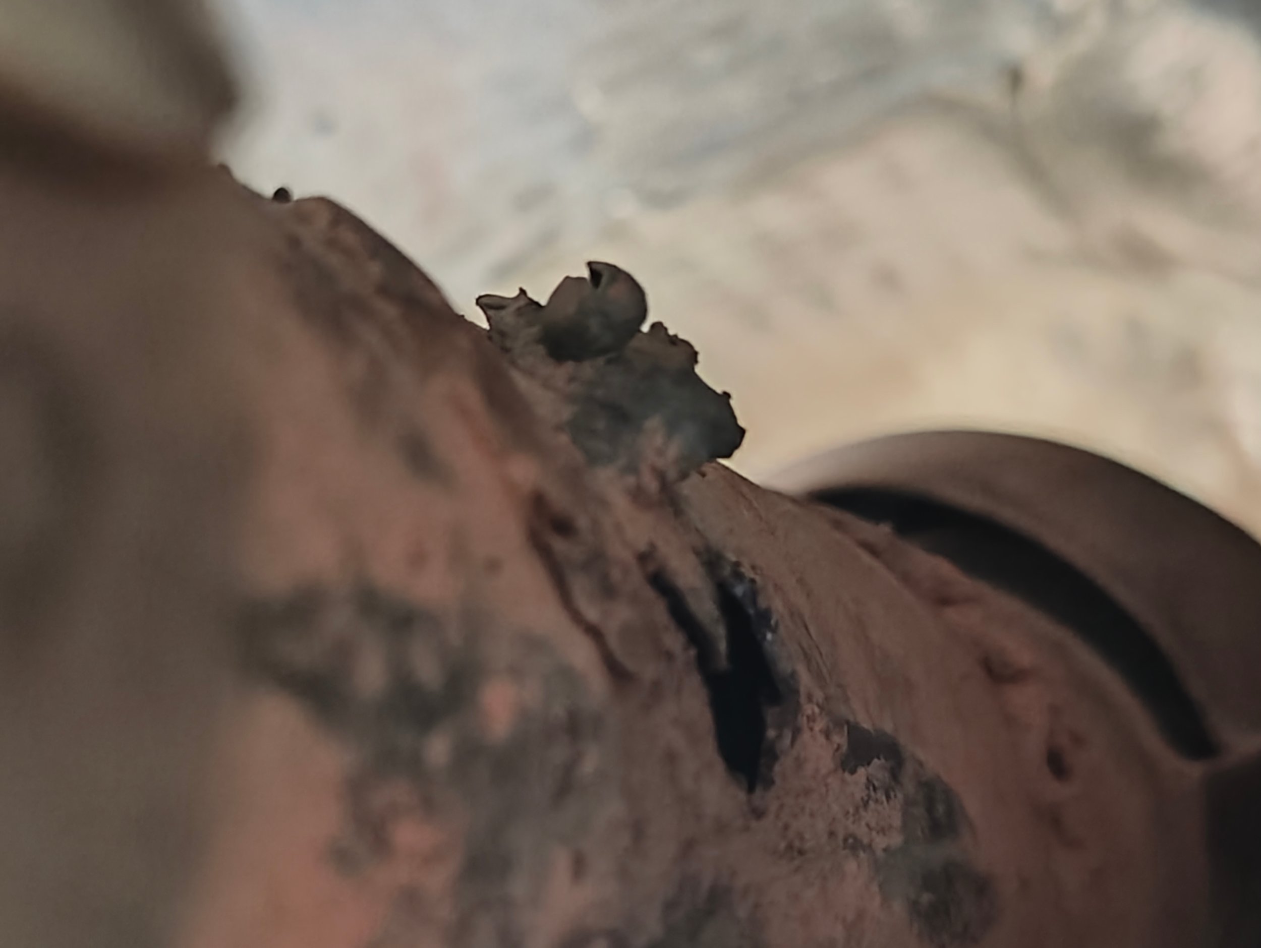

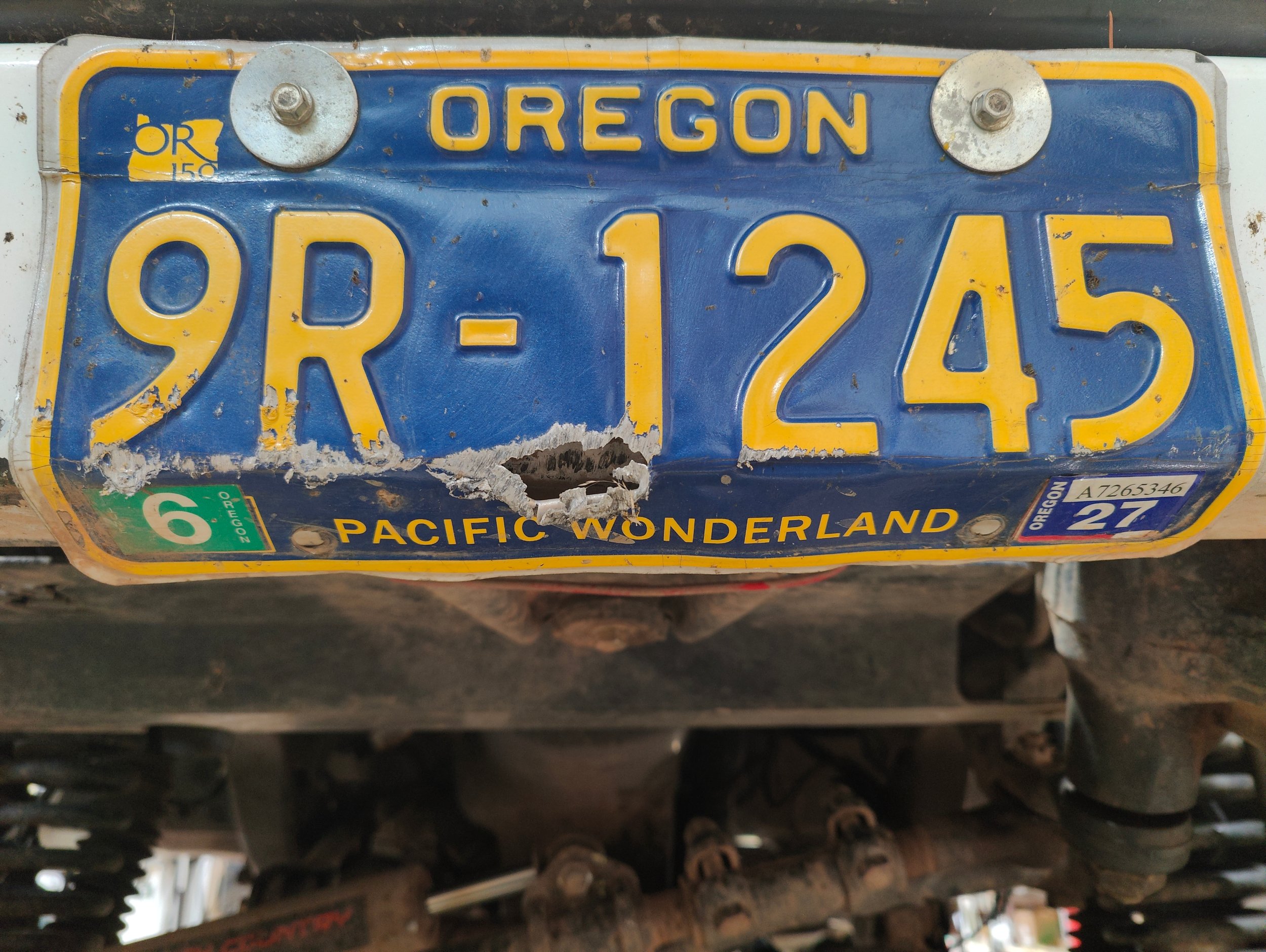

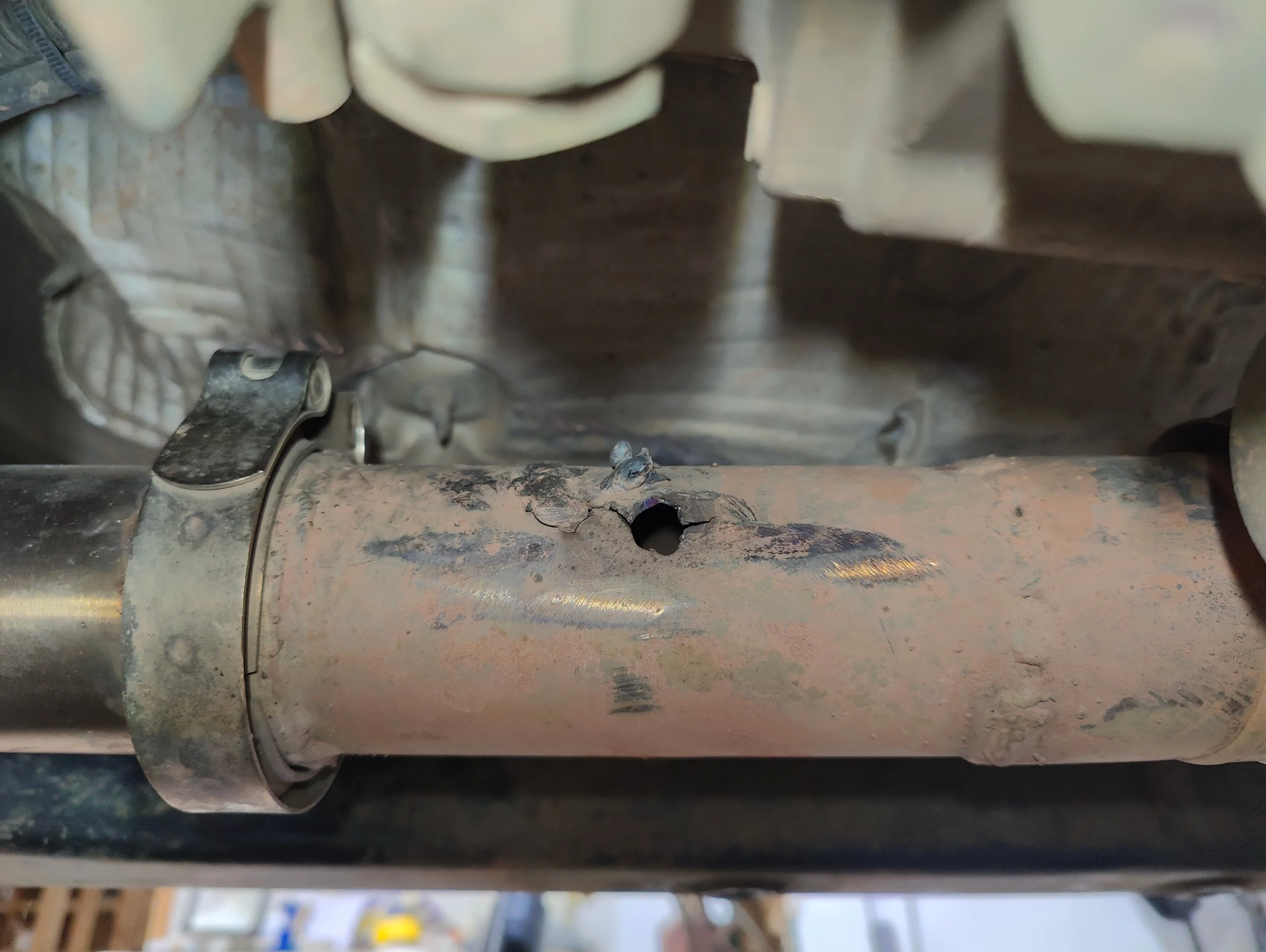

Noticed extra carnage. Chip in the windshield. Hole in the front license plate where it's folded under the bumper. Hole in the exhaust where the transmission mount ripped off.
Planning on welding a patch slash reinforcement plate on the exhaust to better spread the load of the mount's 1/2 rod.

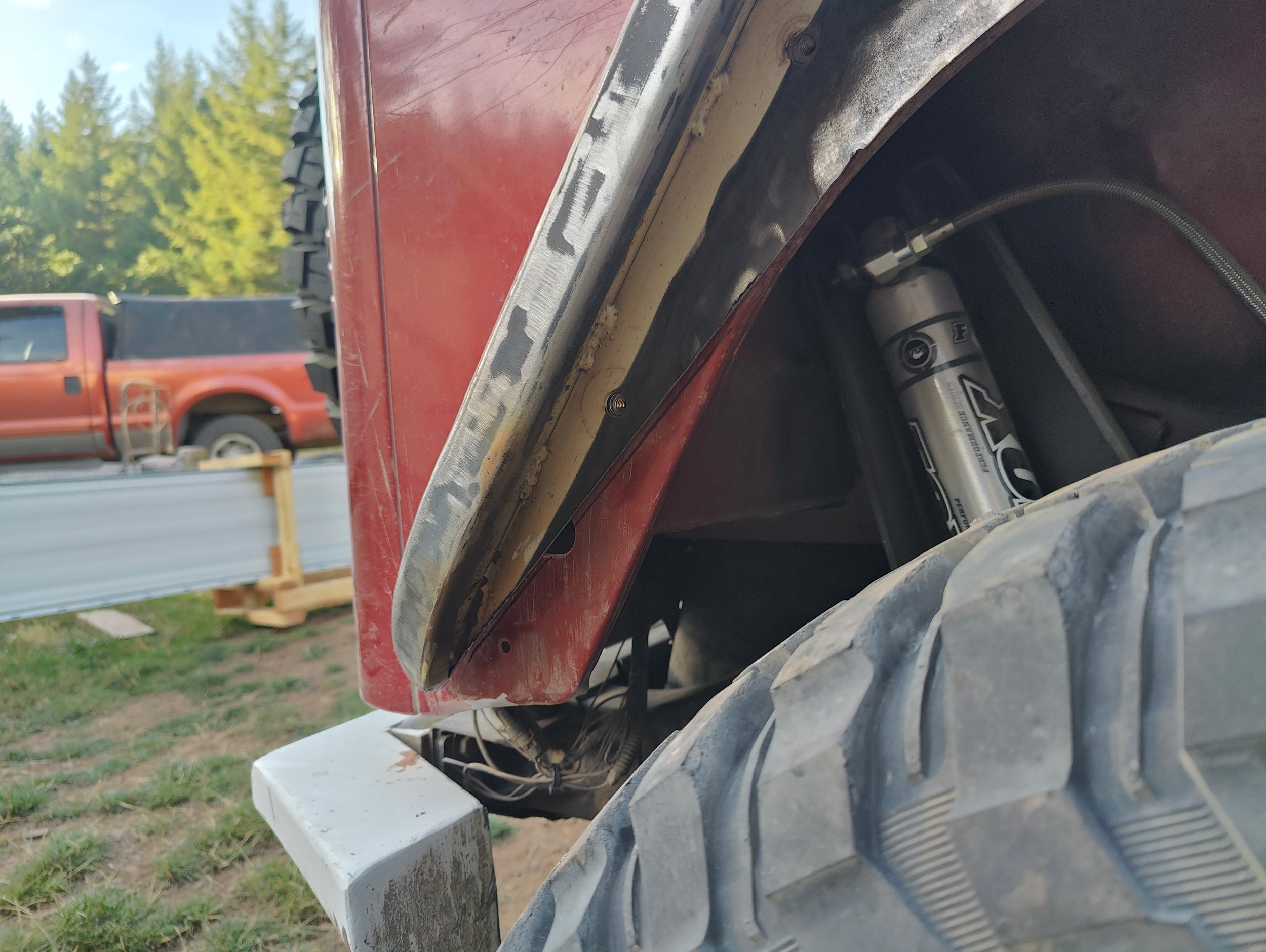

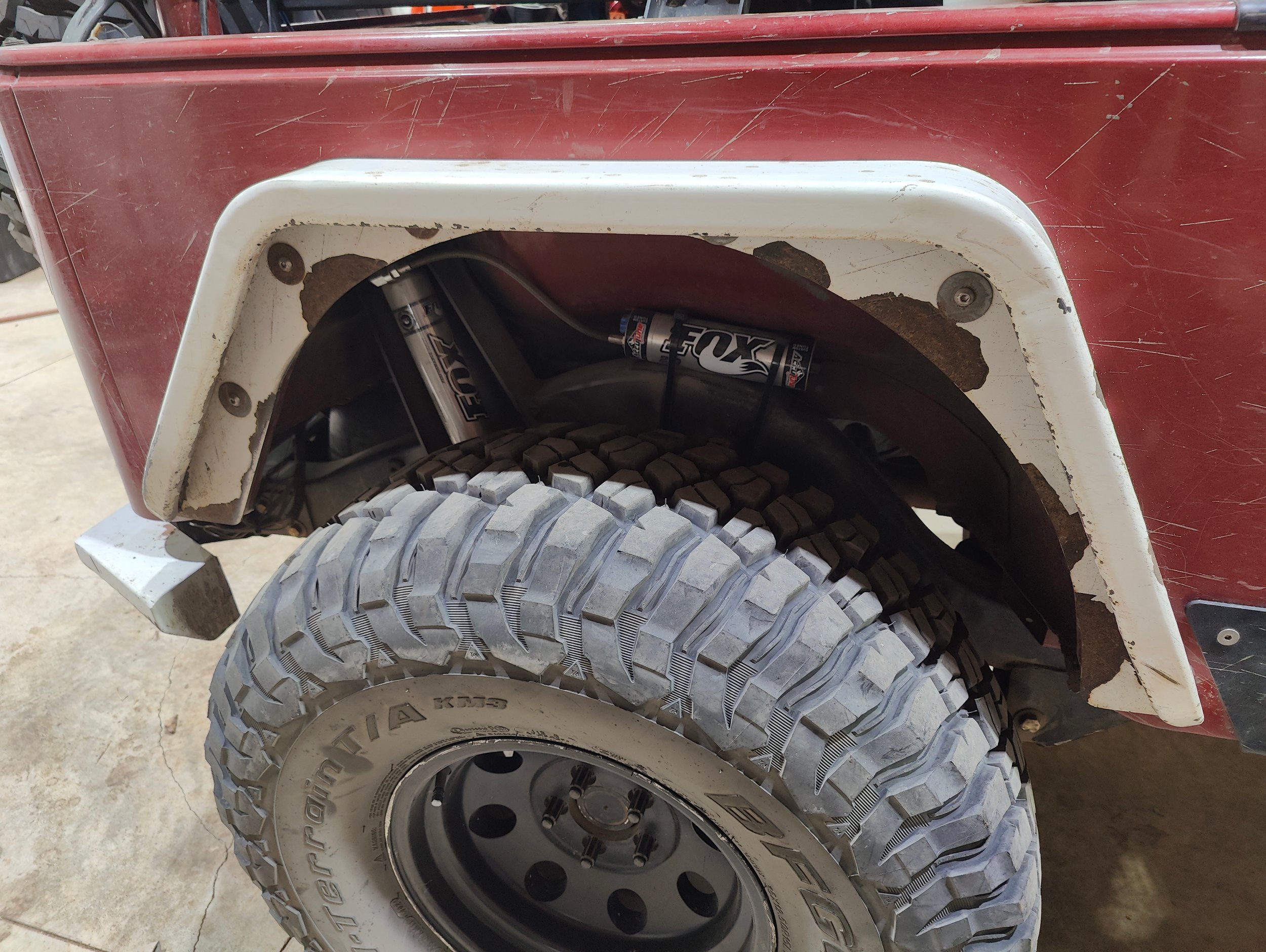

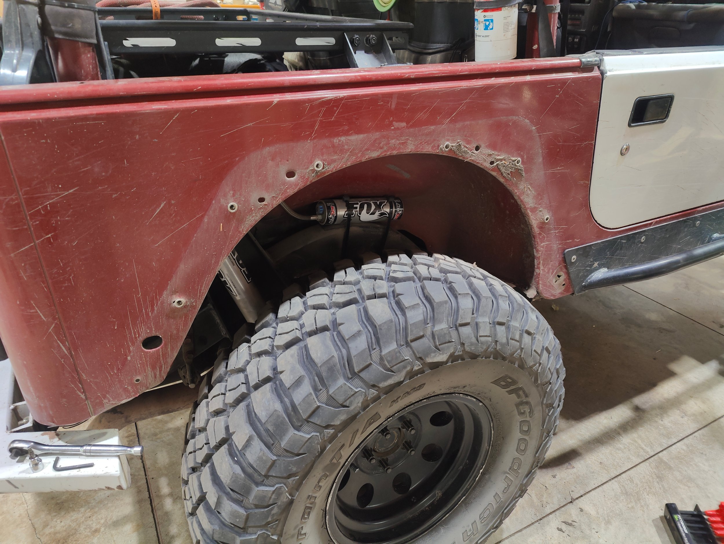

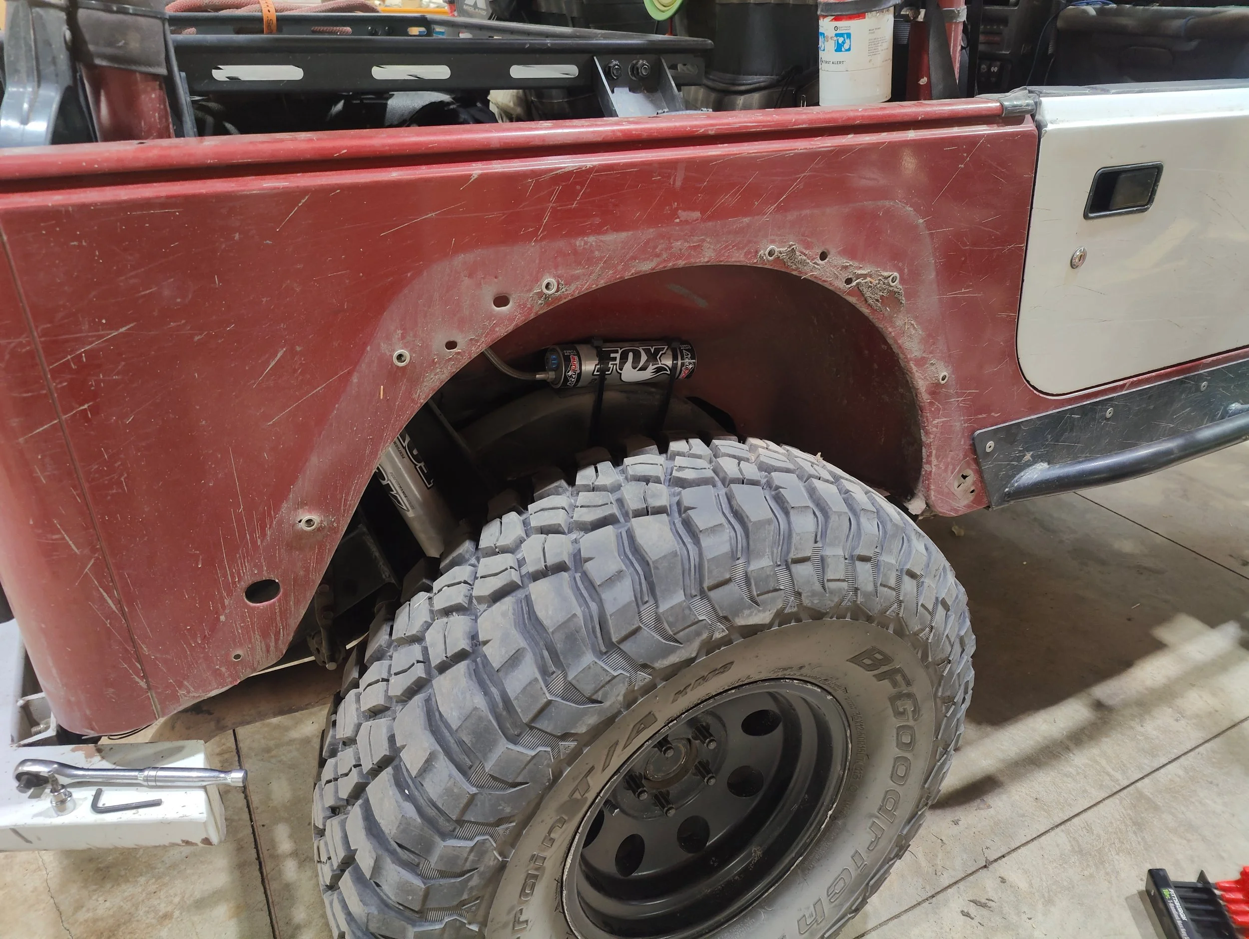

I need to clearance the rear fender. I think I'll pull the tire and run a hot line with the torch and fold so I've got a smooth spot farther up rather than a knife edge.

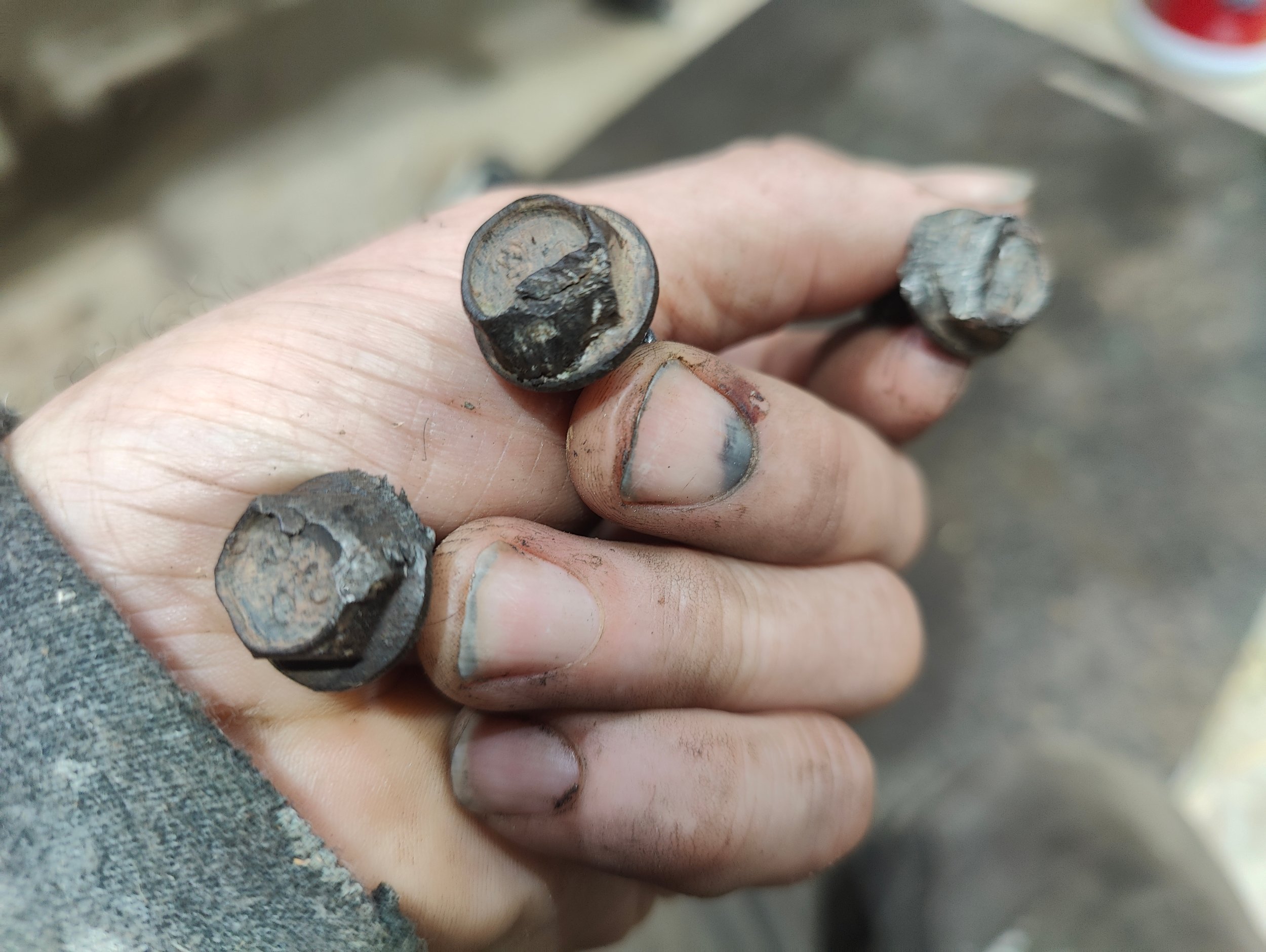

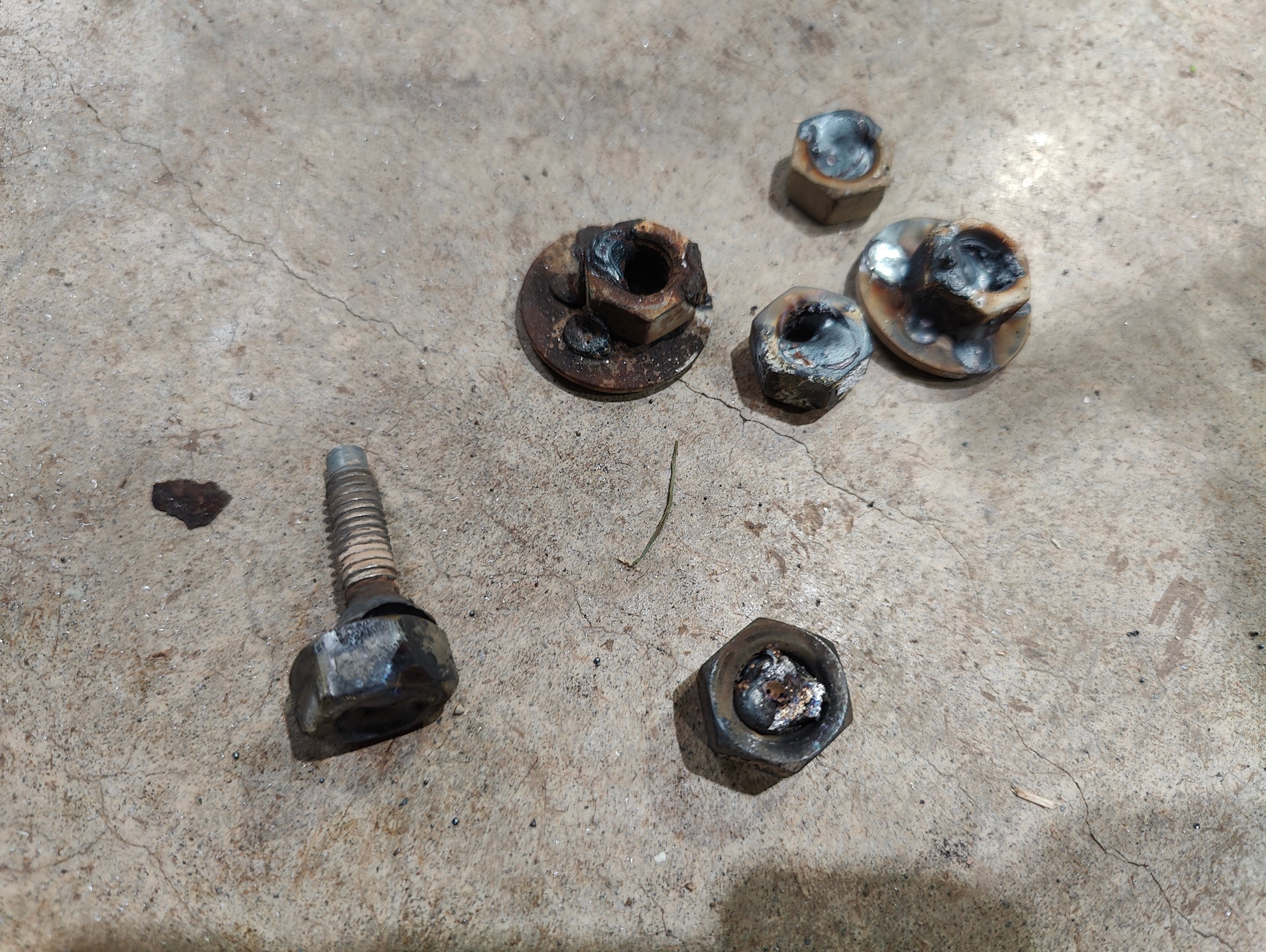

Ordered some grade 8 flange bolts. Maybe they might stay under the skid plate. Seems resistant to red and blue loctite. But I probably need to clean up more of the antisieze I previously used in the holes.

Did a hundred miles of Forest Service roads in the afternoon. I like these shocks...very close to a go fast rig. Takes corners well and runs whoops and washboards without issues.

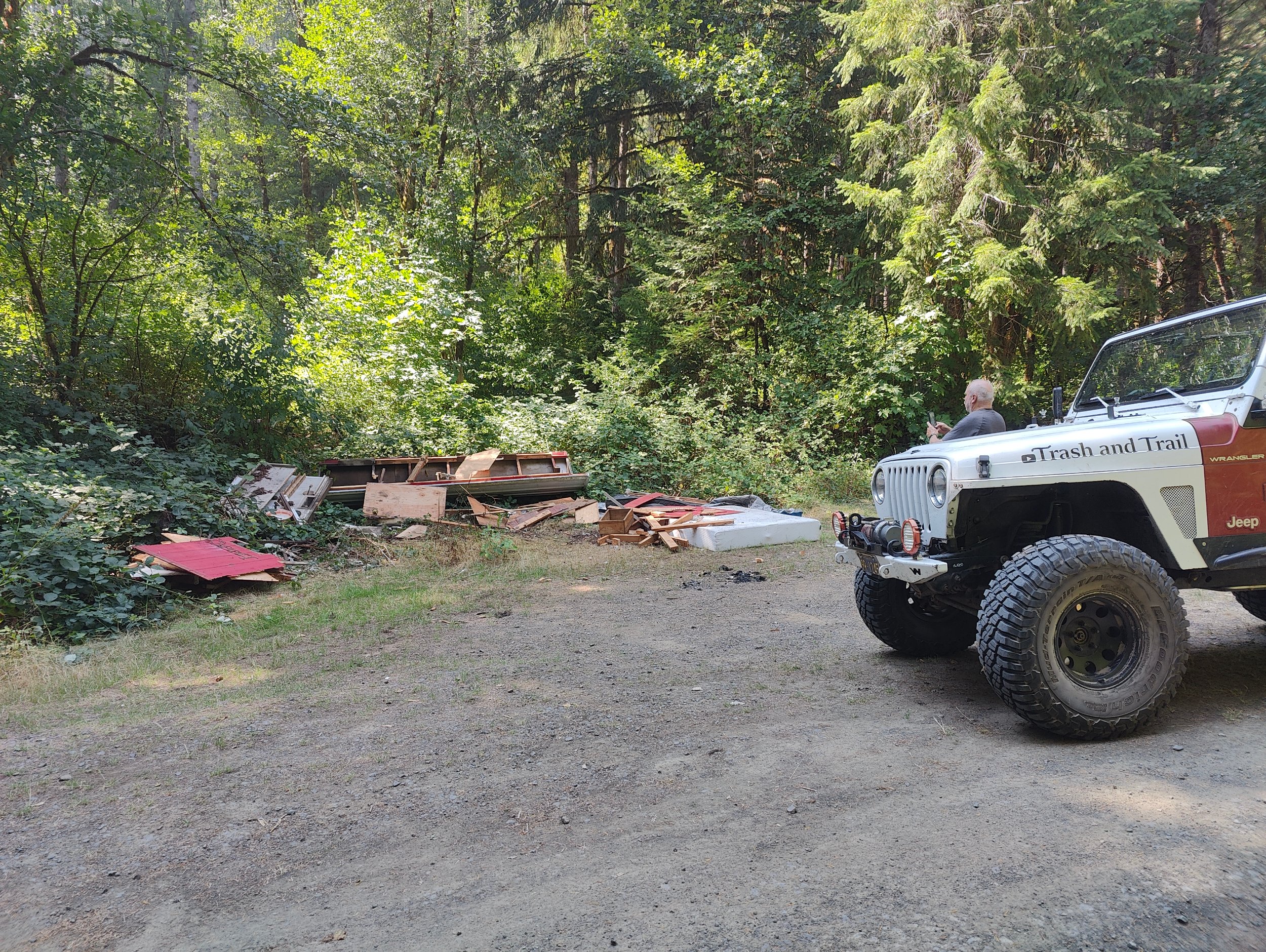

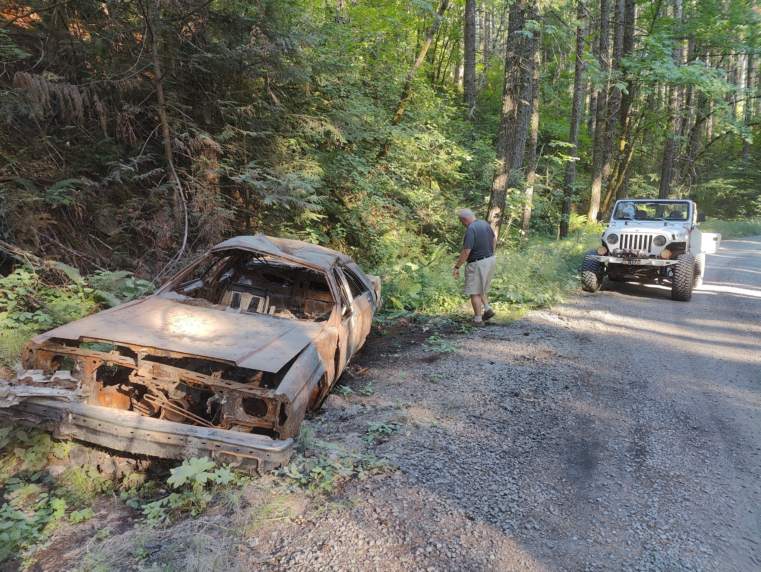

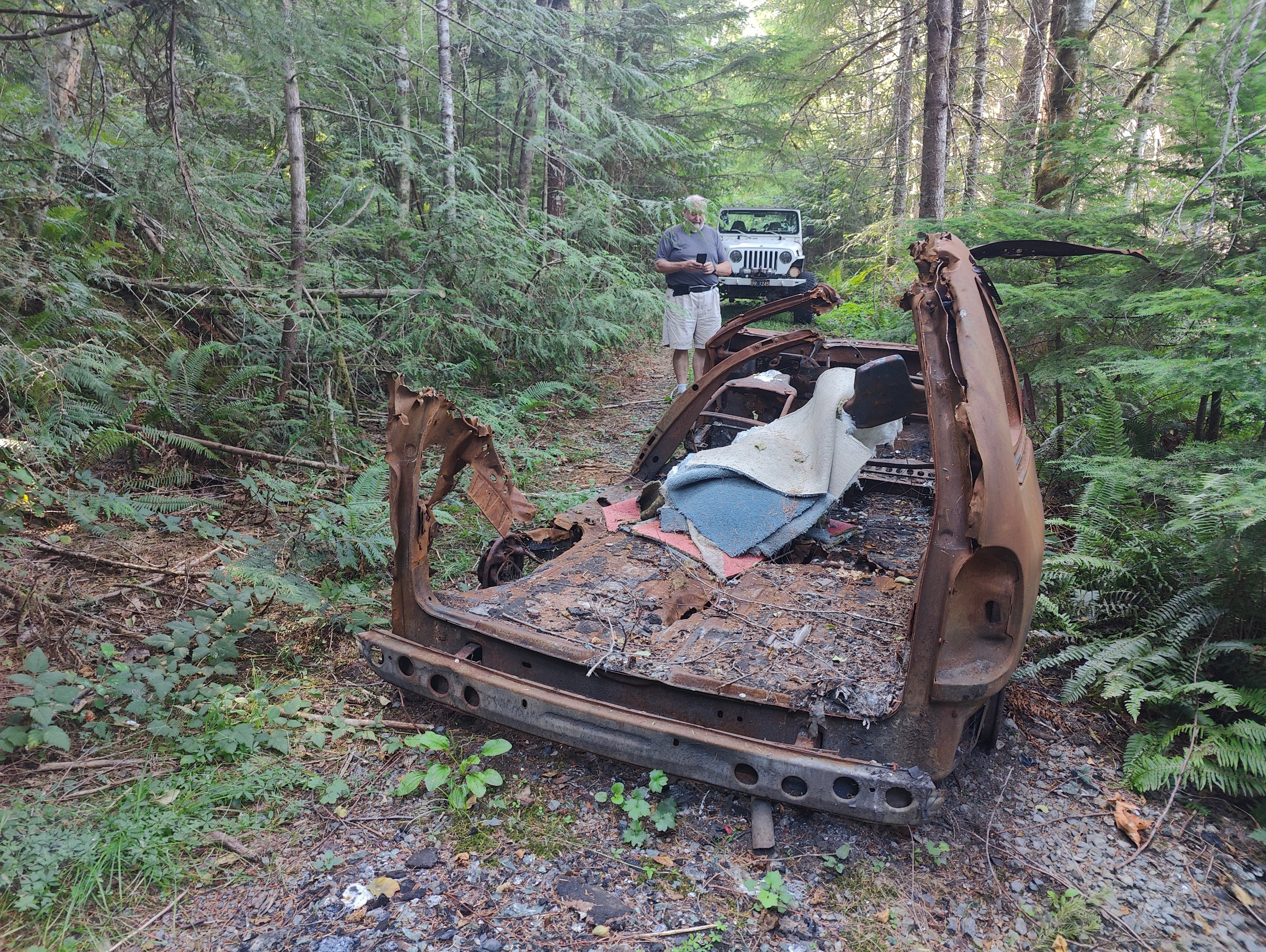

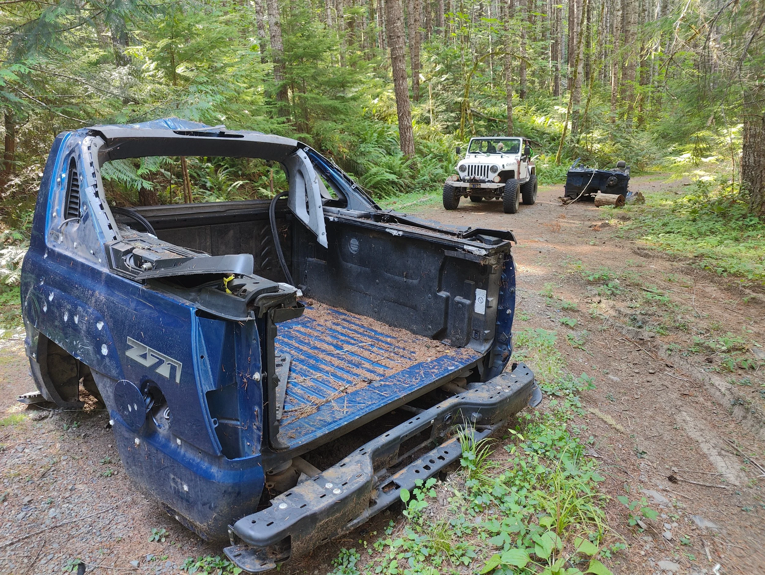

Found a few cars. And a halfalanch. Used the winch to flip the roof on the Hobbit tiny house to get to the sealant for asbestos tests.
Everything ran flawless. Need to patch the exhaust.

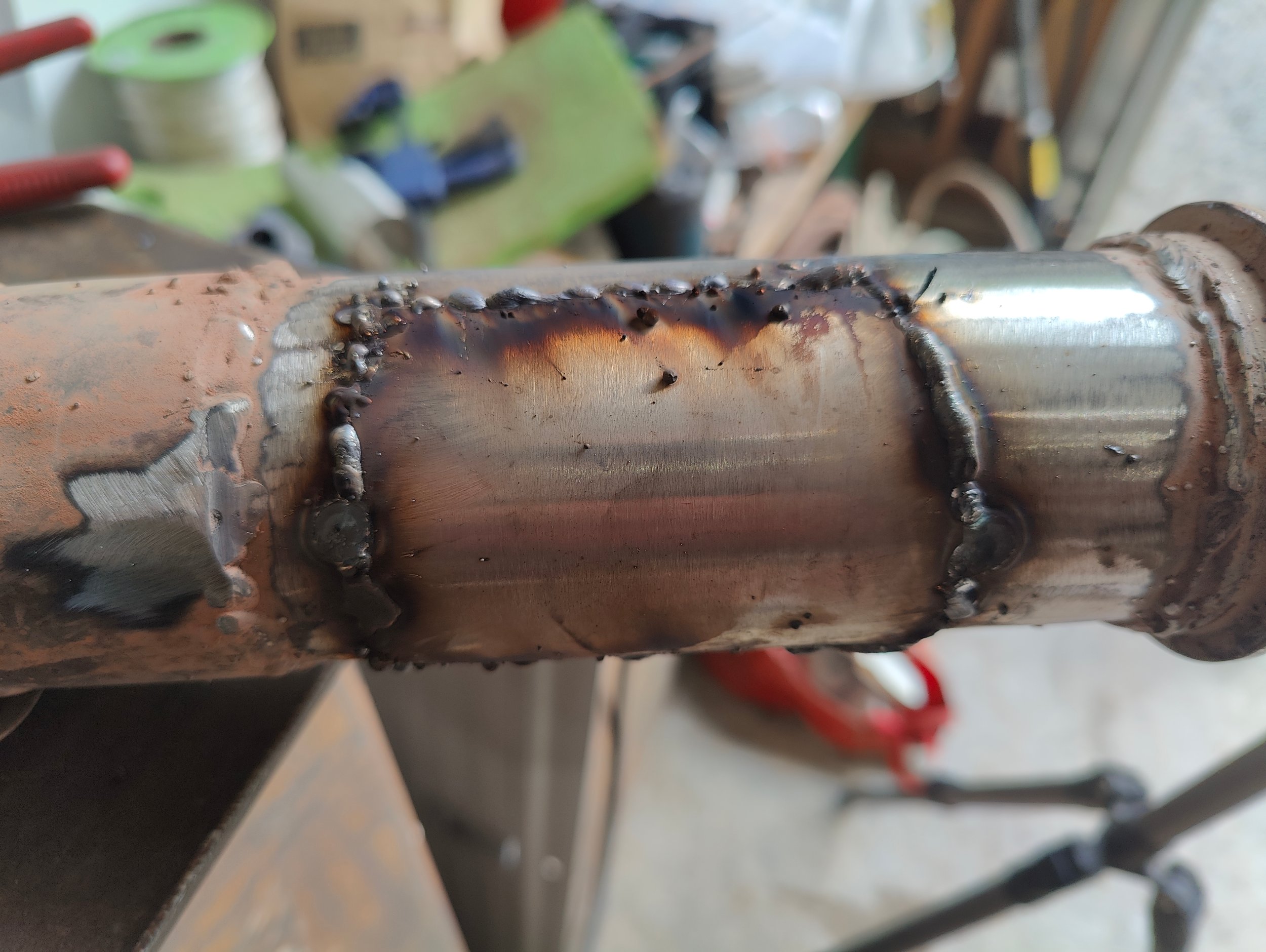

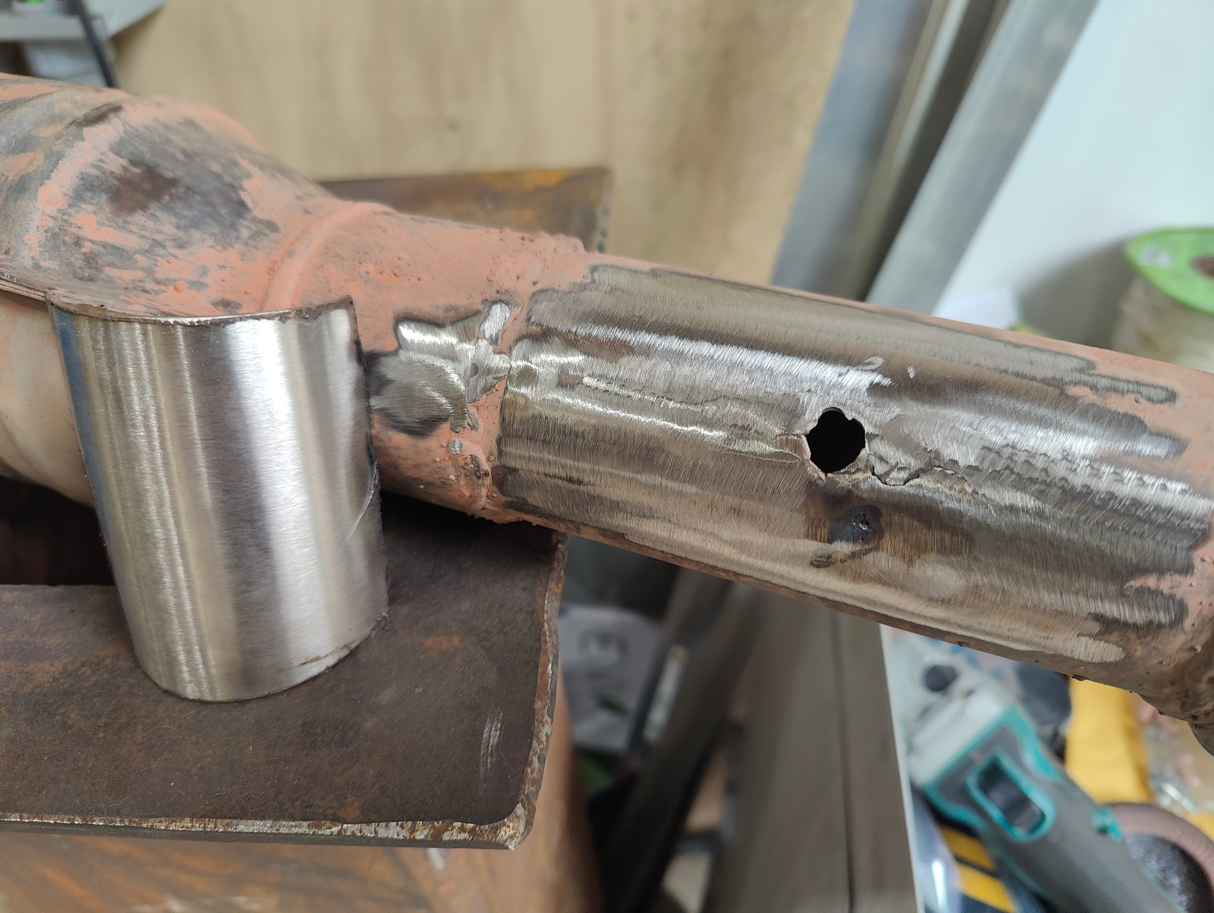

Un holed the exhaust and got the mount properly welded.
I really need a TIG welder.

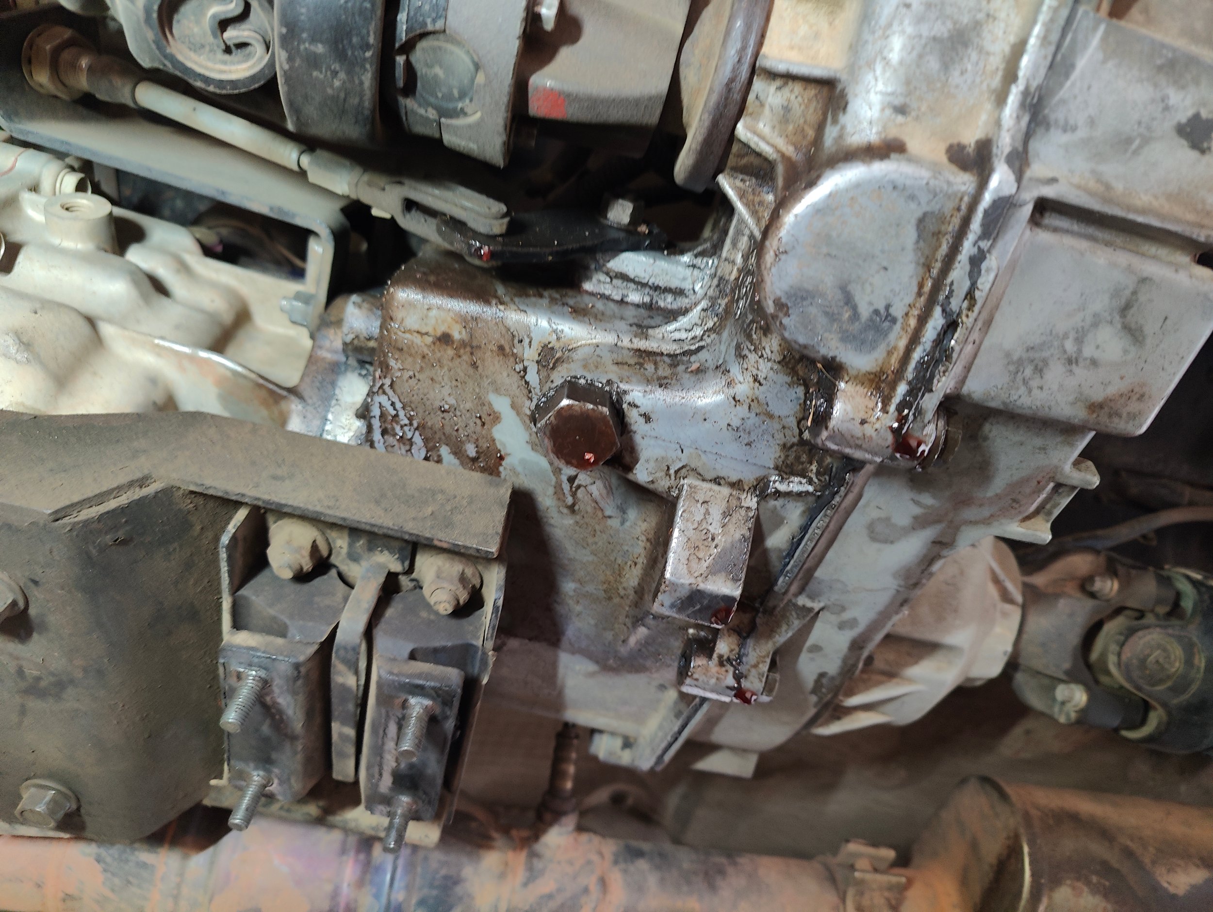

Oh and the 231J is leaking. Not hemmoraging.

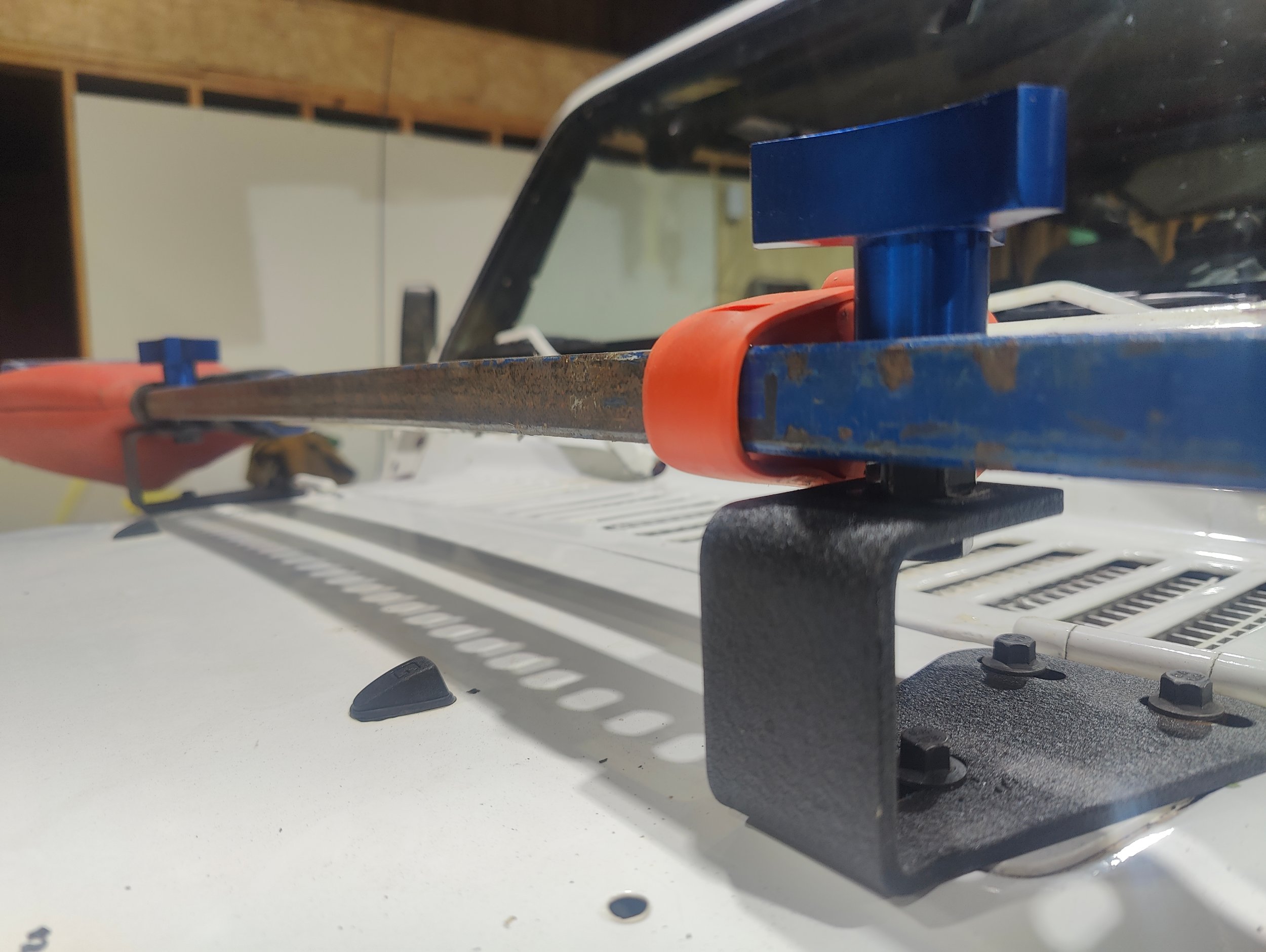

And parts/tools arrived! And I replaced the bright silver bolts on my jack mount with black ones and got the right metric thread pitch to use the knobs from my dump trailer mount. Lot harder to loose a big knob and a lot easier to grab with sore hands and gloves.

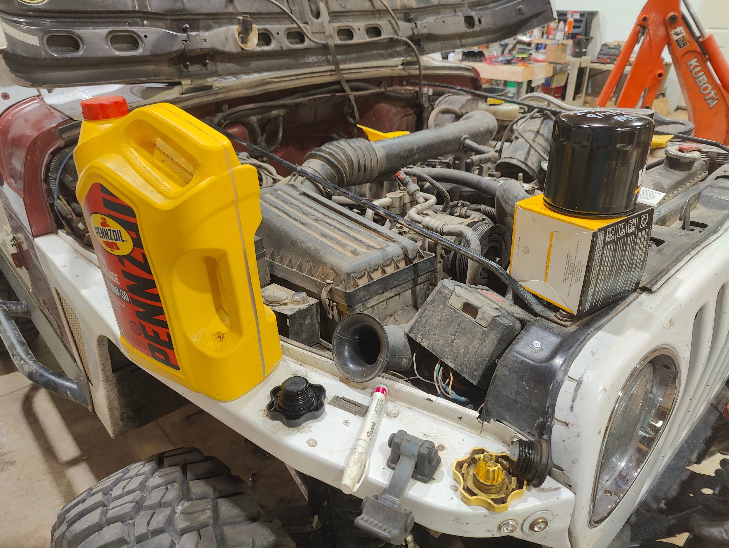

Yesterday I changed my oil. Had to use a chisel on the old oil cap and replace it. Today I edited up footage I shot doing my outboard.

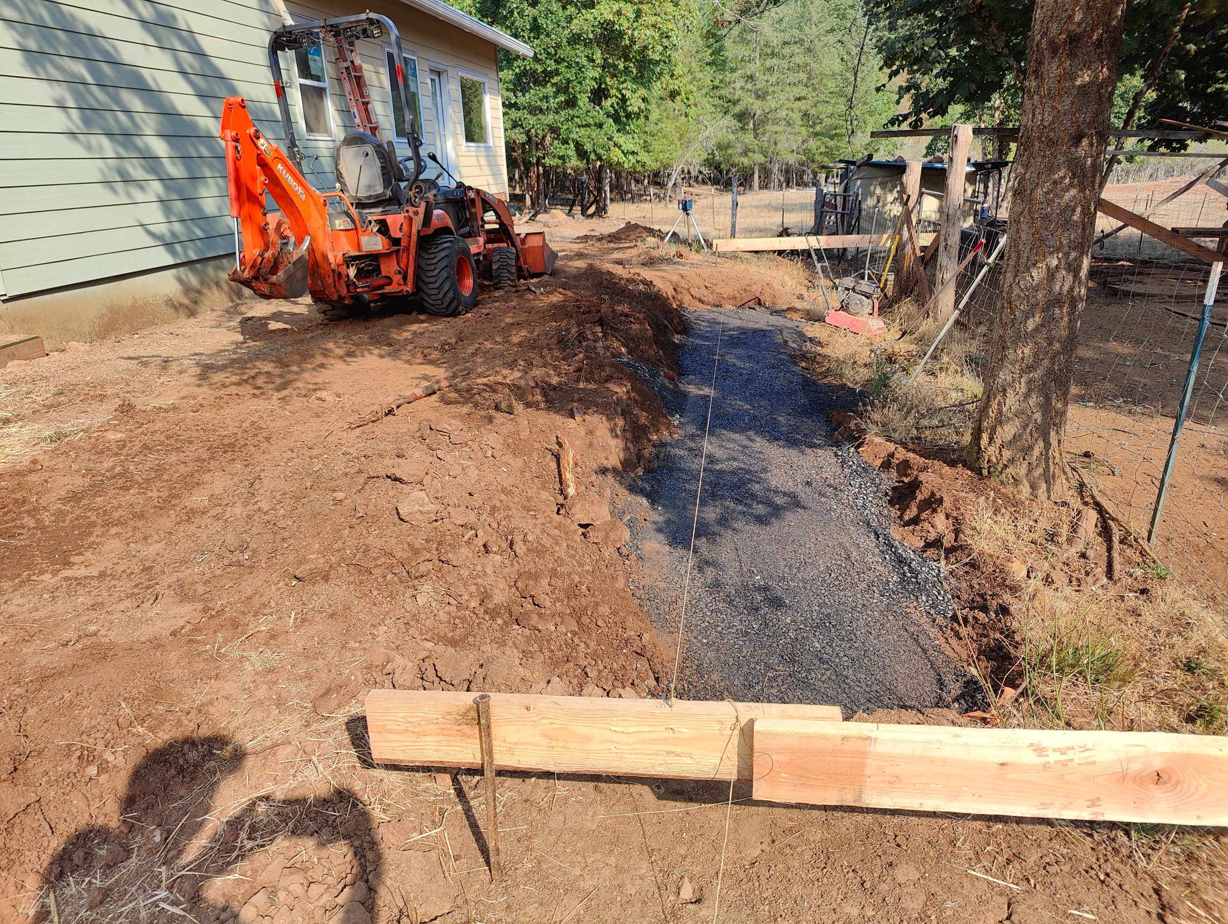

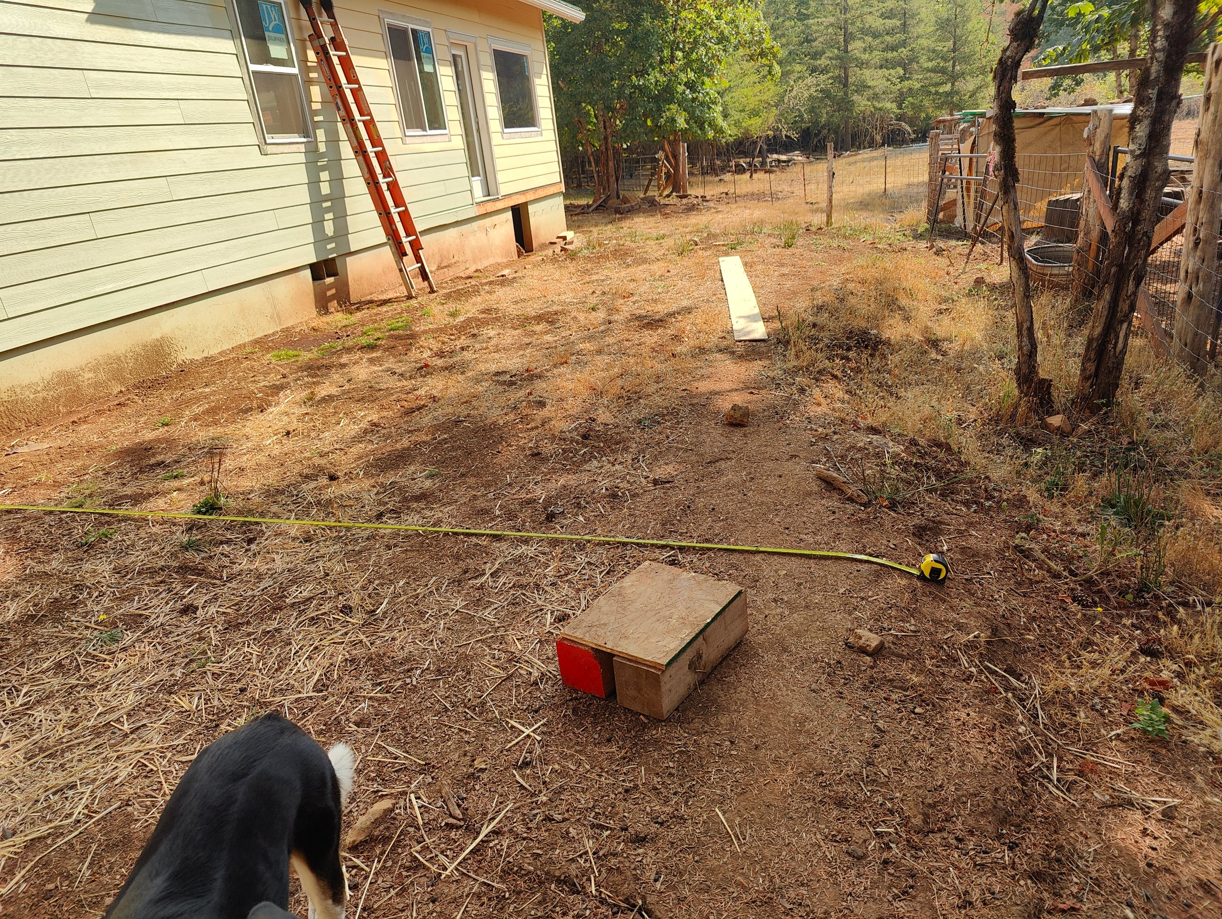

Was digging a little to set footings for a side shed on my shop and found a nest of ground bees. Got stung on my hand. It's quite swollen.
Flexed out the Jeep in the yard to shoot an intro. Another reminder I need to clearance the back part of the fenders.

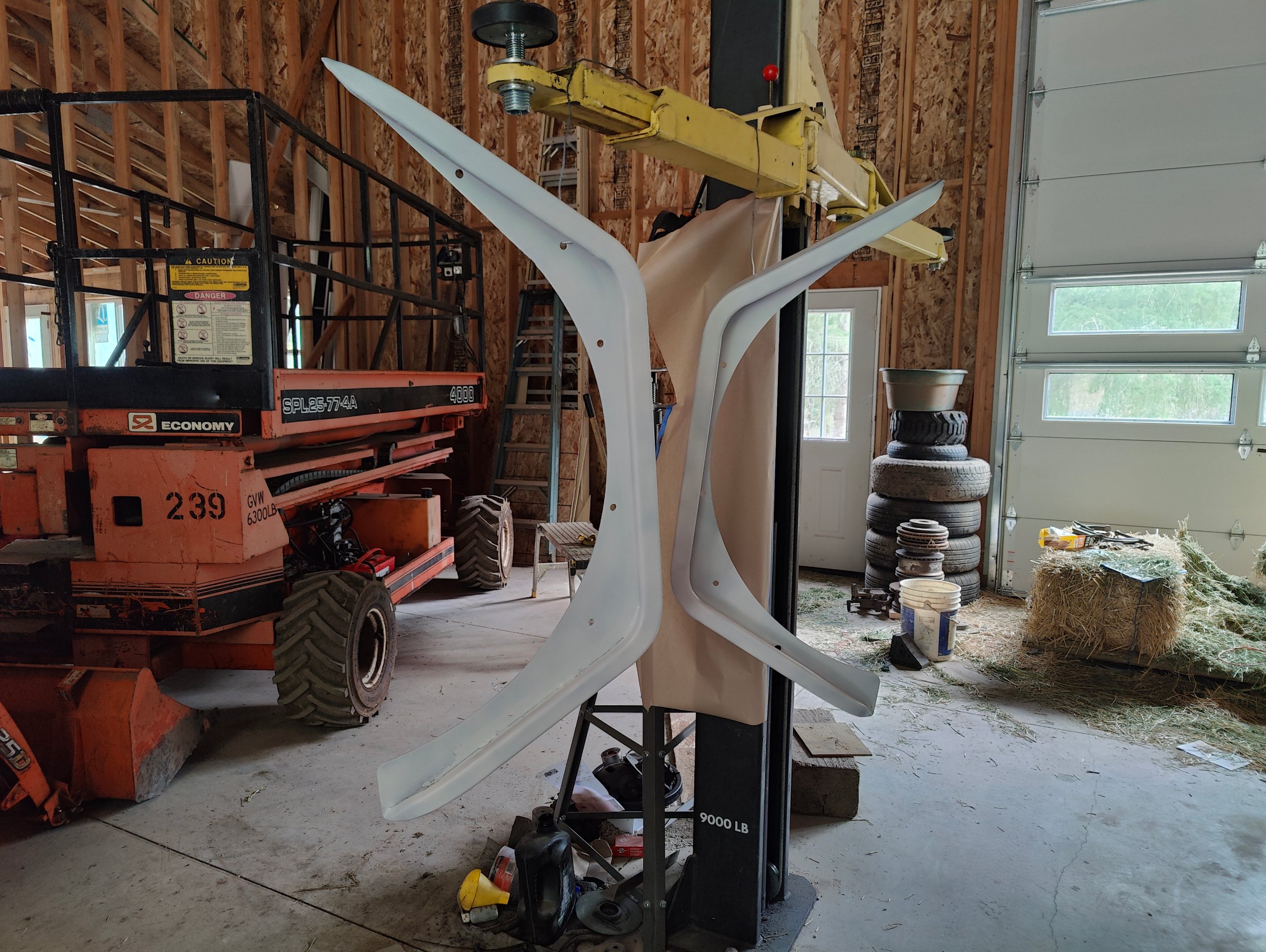

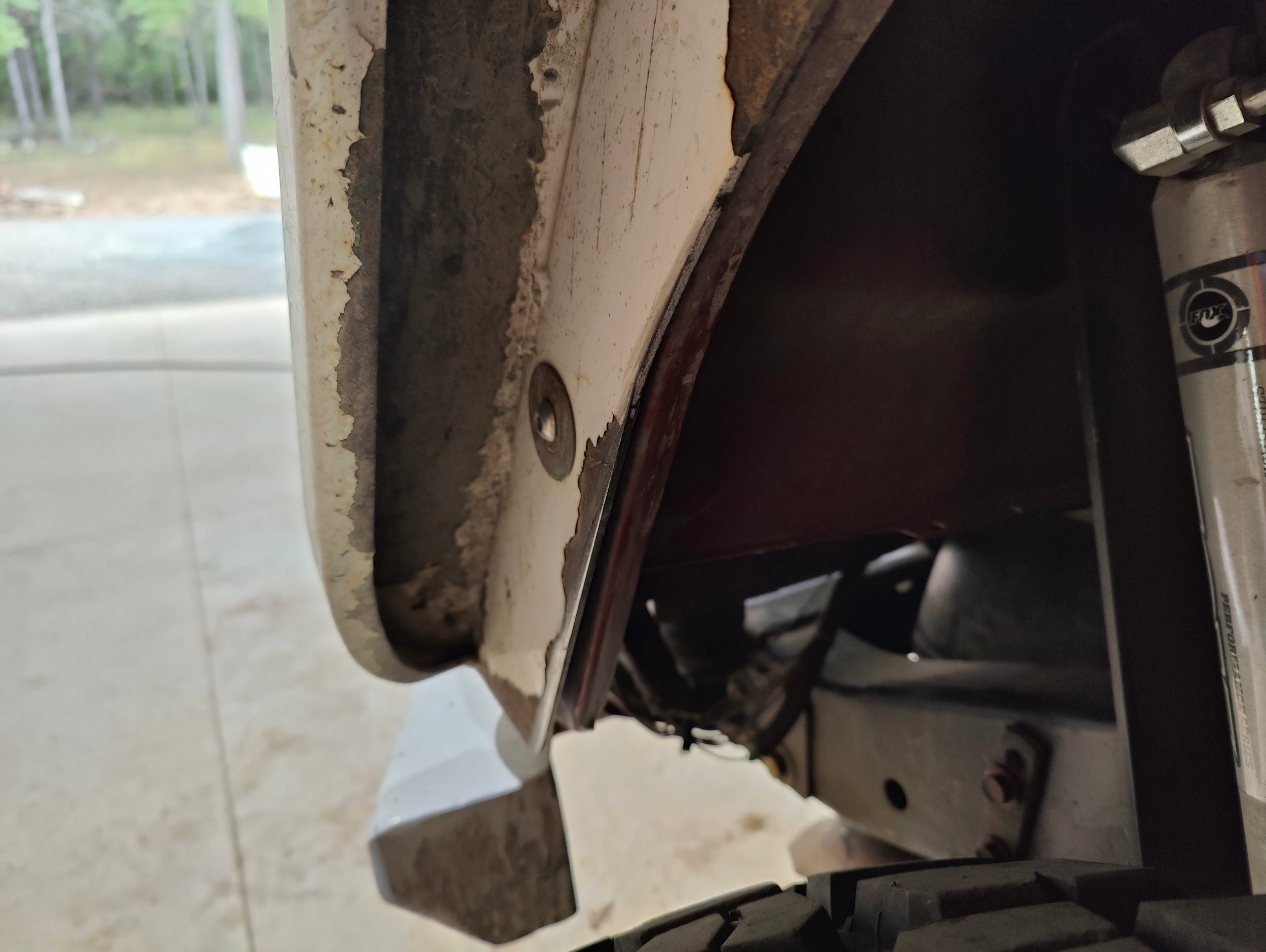

Need to clearance these fenders. Was originally thinking of heating up and folding an inch inward but now I'm thinking maybe I should do a jog cut on the top of the fender and push the whole arch back 1.5" and clearance the tub to match.
Hmm. Thoughts? All the powder coating is sheeting off the fenders anyways.
-Mac

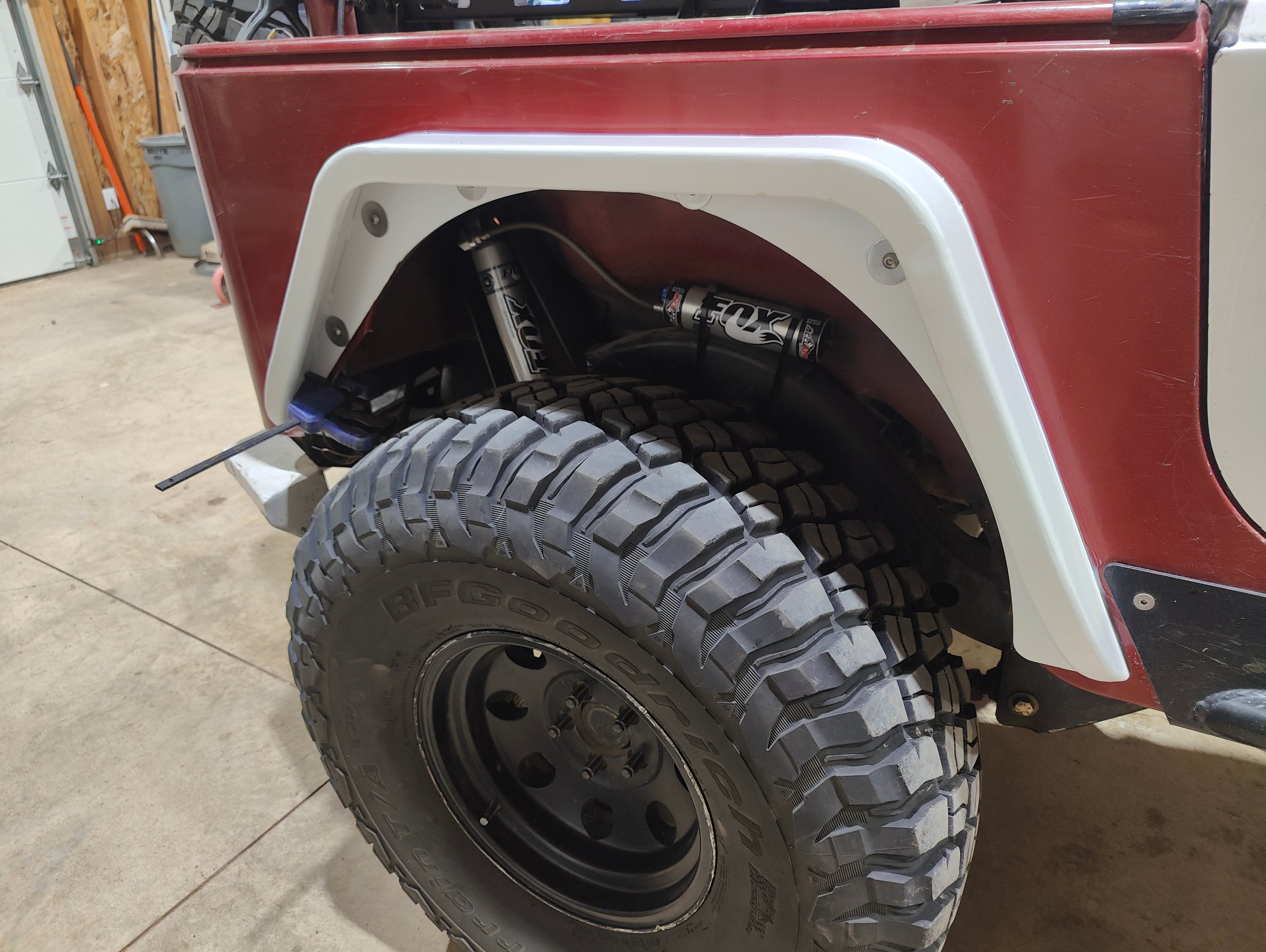

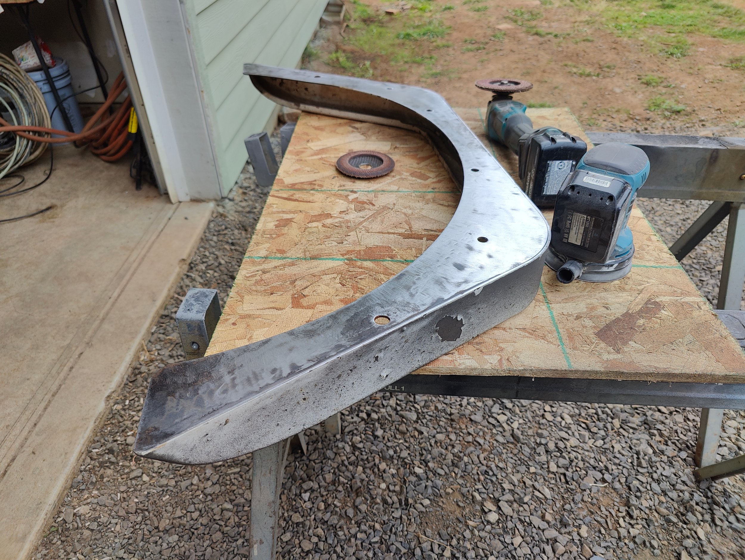

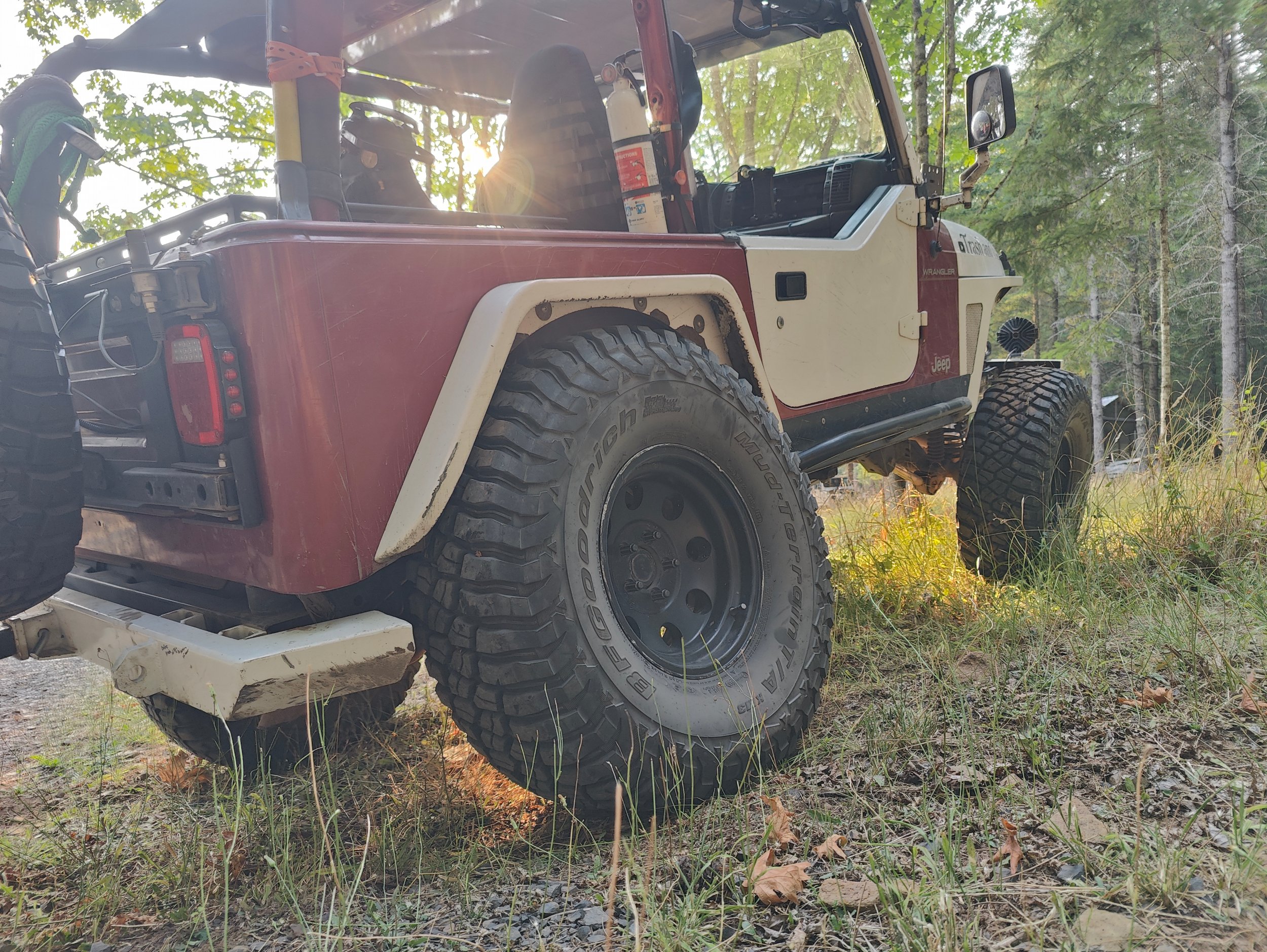

Fenders chopped and painted and bolted back up with a little silicone on top to maybe keep the grit out...but it's probably coming from below.

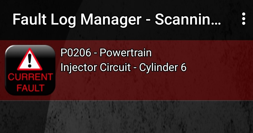

Got a P0206 Cylinder 6 injector circuit code the other day. Interesting that after the code popped the fuel trims went flat. Cleared the codes, fuel trims are now moving and no further issues.

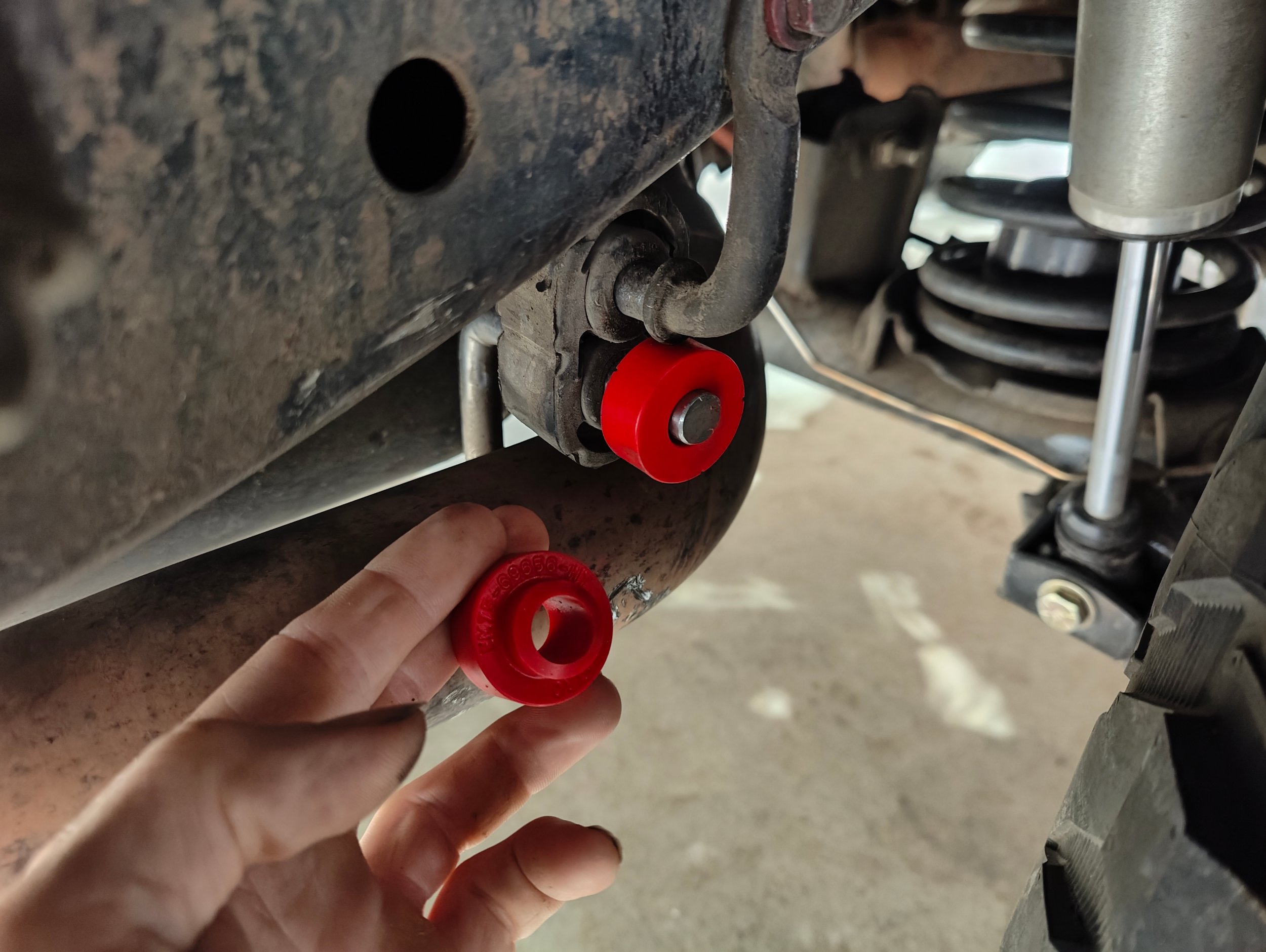

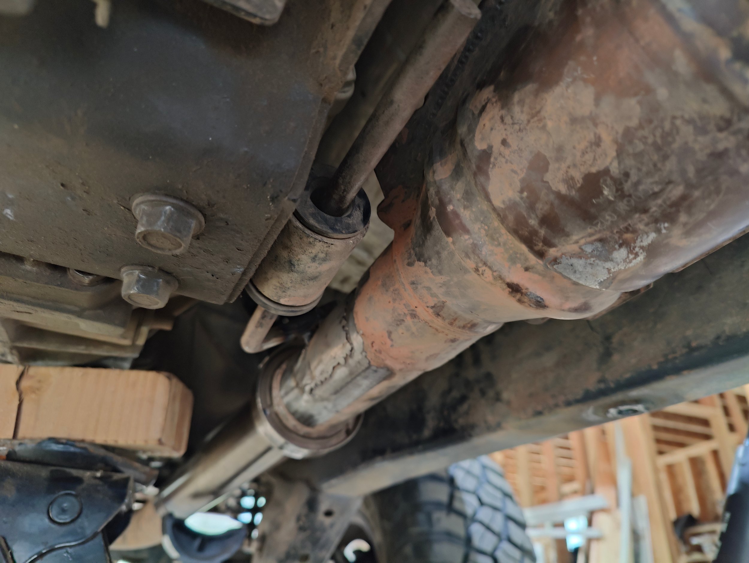

Meanwhile some parts came in for my exhaust plans. Got a hi temp bushing and some 1.5" 1/8" wall DOM. Decided the hook on the exhaust tip won't work and ordered some stainless coupler nuts and some 1/2 stainless threaded rod.

Is this just to keep the hanger from shifting in the rubber and contacting the tank?

I need to pull the exhaust up so the plan is to French the DOM tube into the frame...insert the high temp red isolation bushing...then weld a coupler nut to the top of the exhaust...and run the threaded rod through the frame to the coupler nut. The threaded rod should give me a ton of adjustability.

Oh I see, that makes sense.

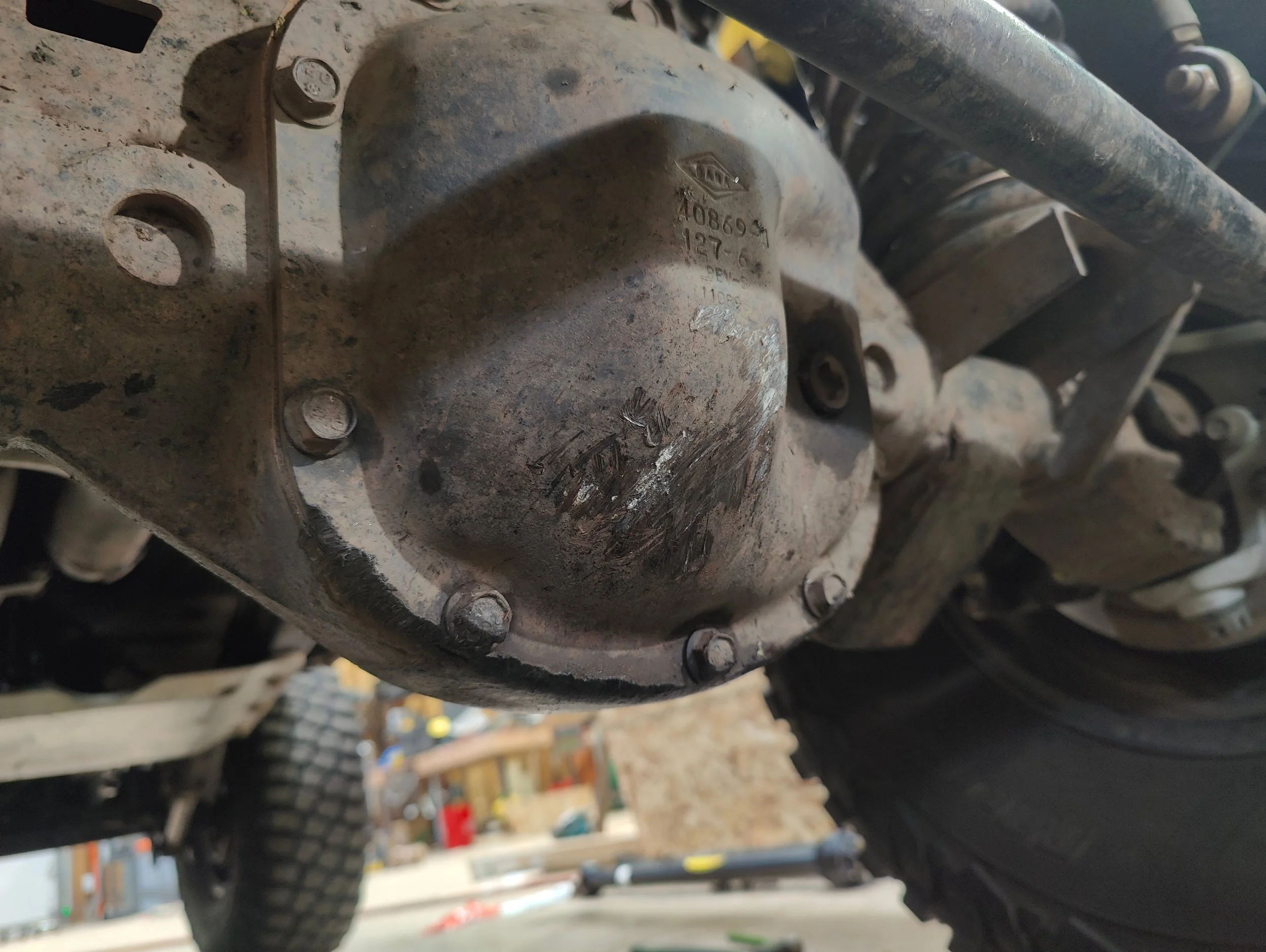

Ordered a Tom Woods driveshaft on Tuesday. Arrived Thursday. 42 1/8" just about an inch longer or so than my previous Adam's shaft. Figured I might get away with it when I pushed the transfer case up...but no.
Drove it for a few days and it was much smoother. I beat the crap out of that front shaft...has some pretty good witnesses marks.
Guessing since my Dana 30 pinion seal is leaking the wobbling shaft might have caused my 231J issues. Certainly didn't help.

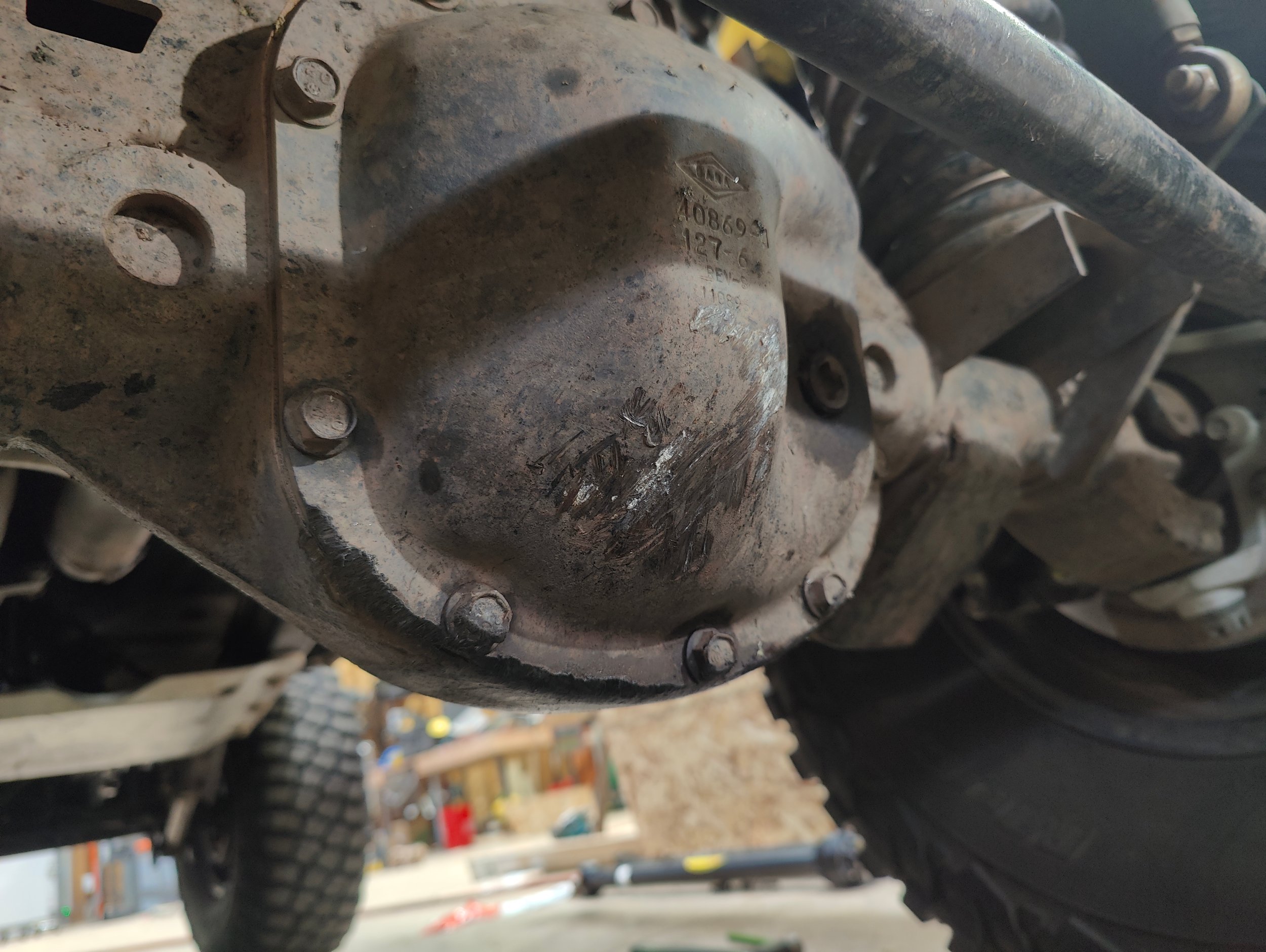

Pulled the diff cover to play with the e-locker. Found three teeth in the bottom of the housing. E-locker is kinda working... pulled more wire into the housing to let the stator assembly rotate more freely.
Pulled the Lube Locker off. All the bottom silicone traces fell off. Sealed it up with Right Stuff and pumped it full of Lucas 85w140 after replacing the pinion seal.
Those teeth have probably been off for a while. I don't think I've opened it up since I did the regear. It'll be fine until I get my credit card down from the giant crater I made doing an outboard.
Probably will order 5.13s for the front and back too...cause why the hell not.
Was able to bolt up the new shaft without dropping the skid...body lift is convenient and years of contorting myself working on cars has taught me a few skills.

Spent the last couple of days adding a side shed to the shop to park the lift and tractor so as not to clutter up my shop space for parking. Going to pick up some IBC totes and move the goat's alfalfa out there too.
