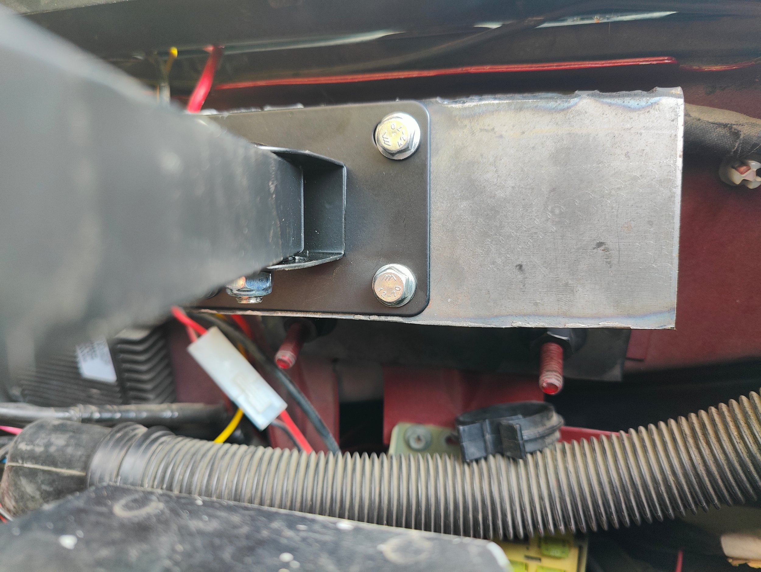

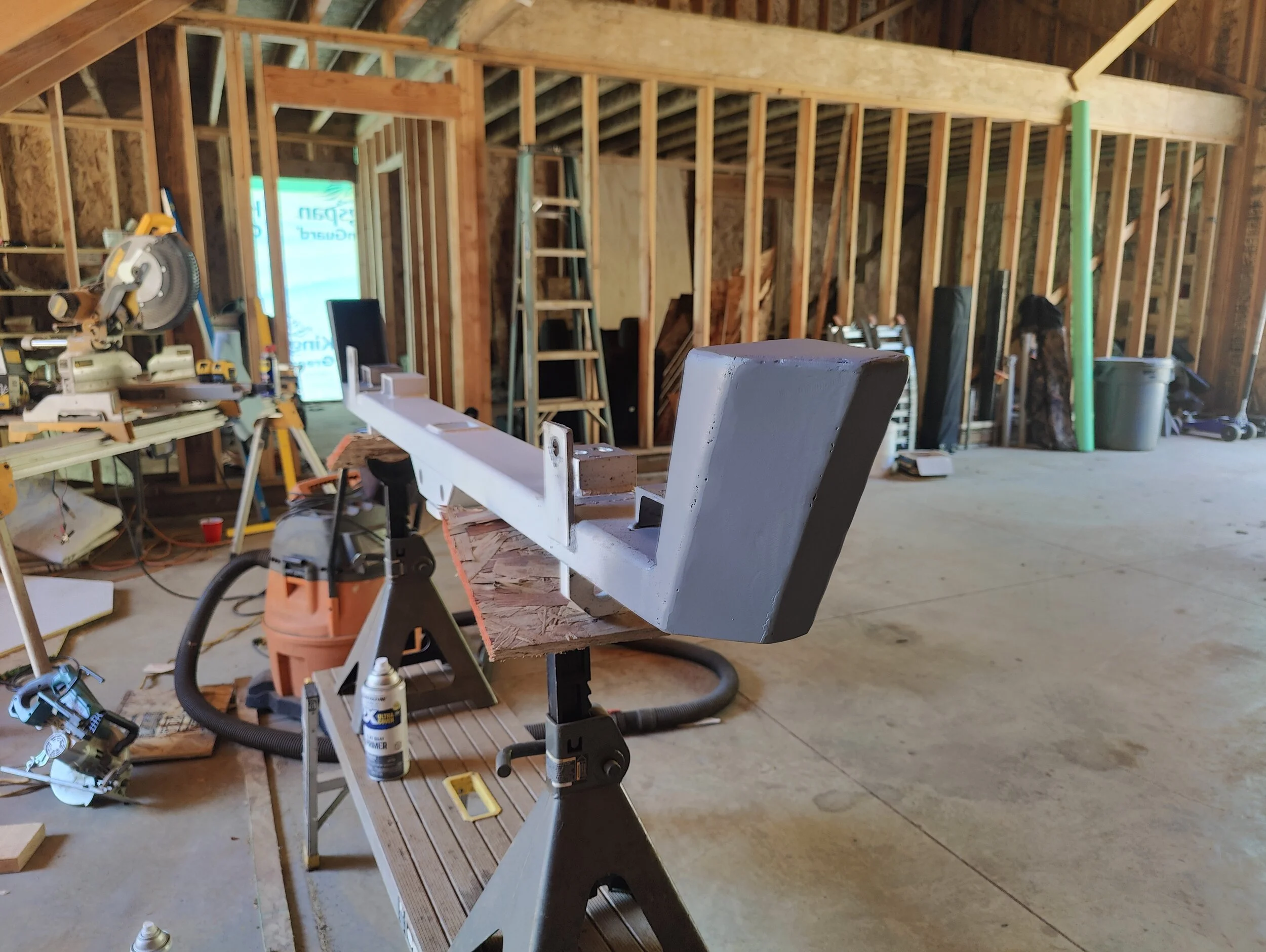

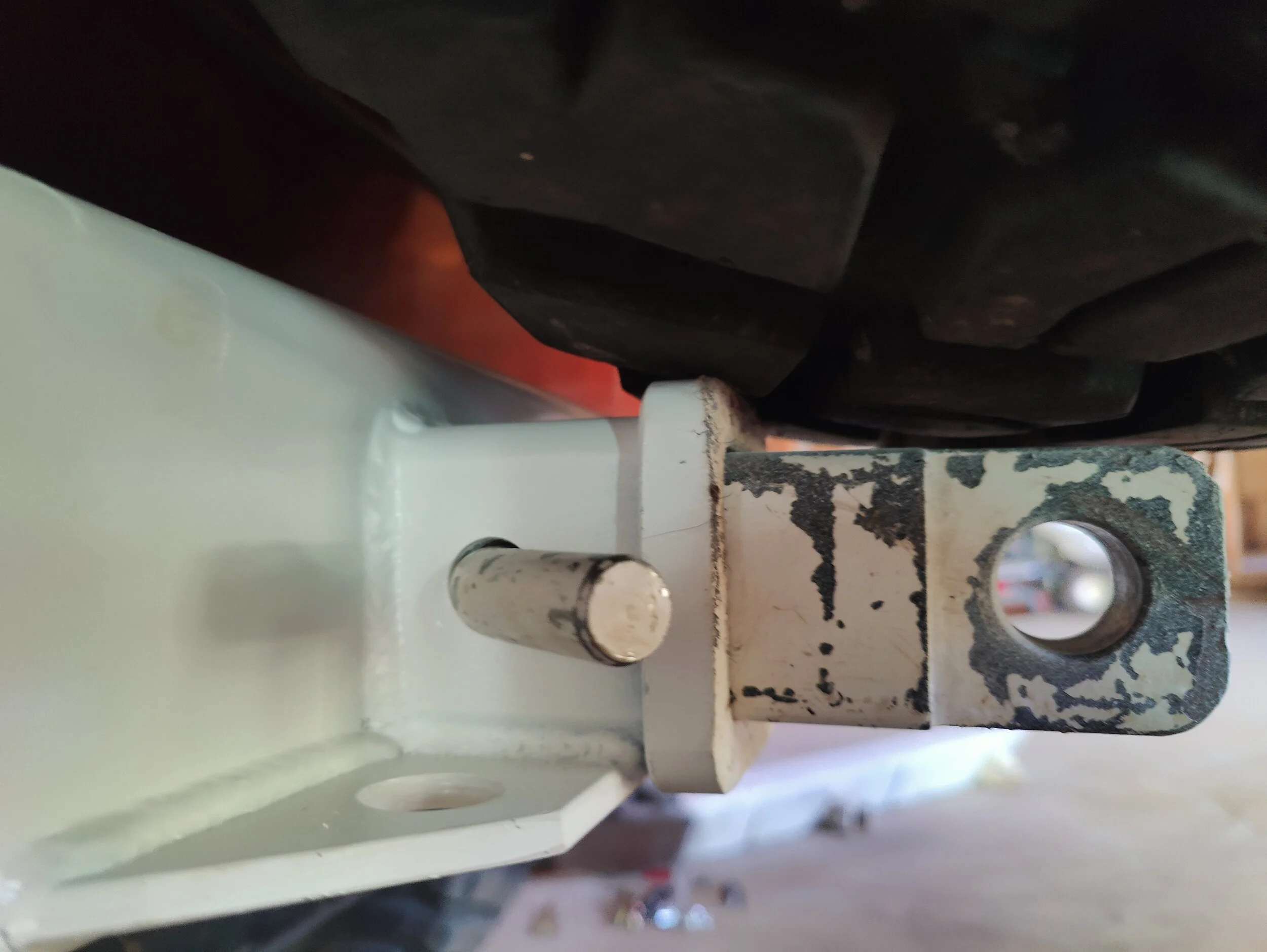

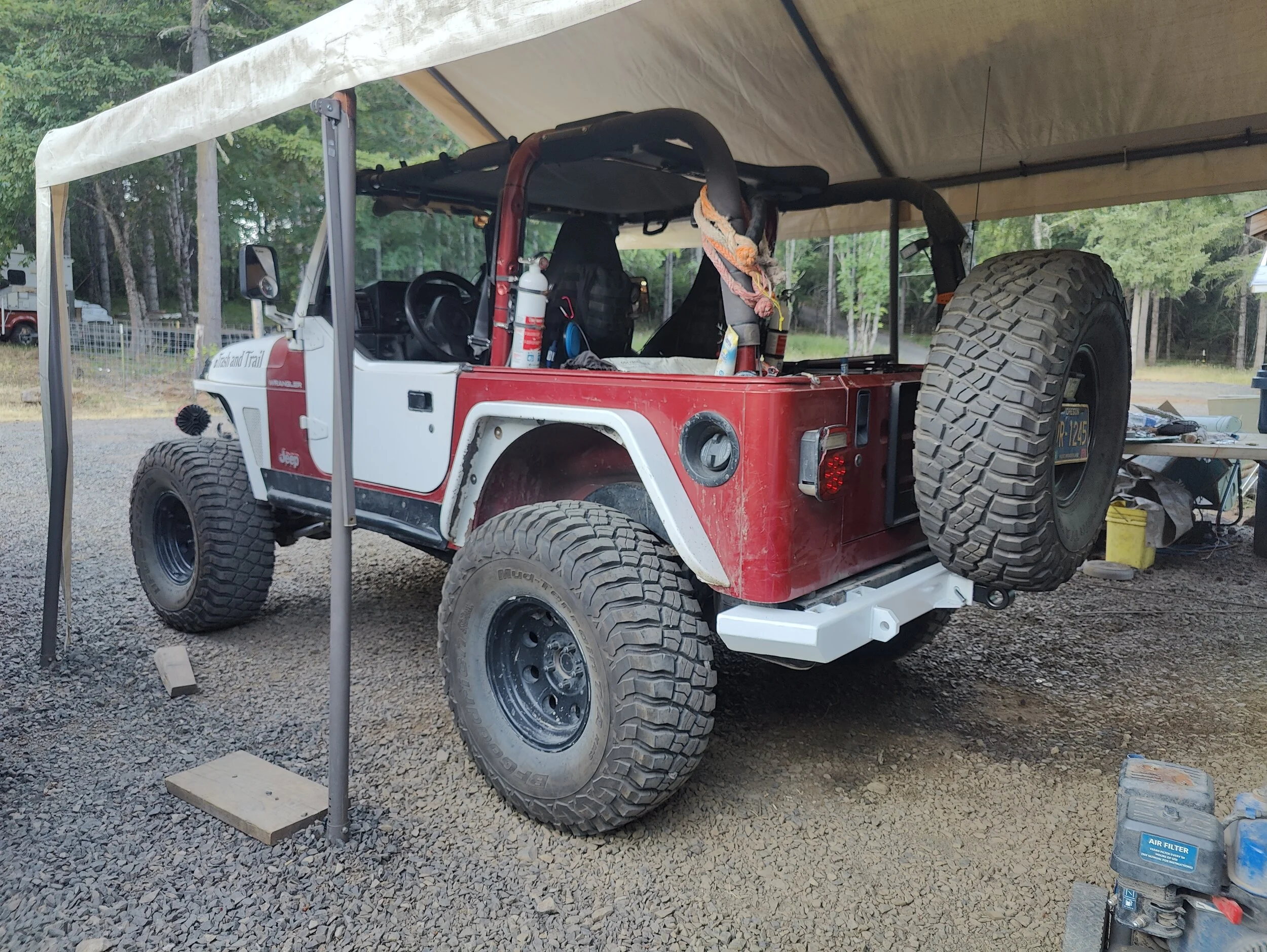

It'll do for now...looks good from 20'. Frame reinforcement brackets installed. Need to drop the gas tank for the inner bolts. Five bolts per side will do for now.
Bonus...the hitch holds up the spare tire.

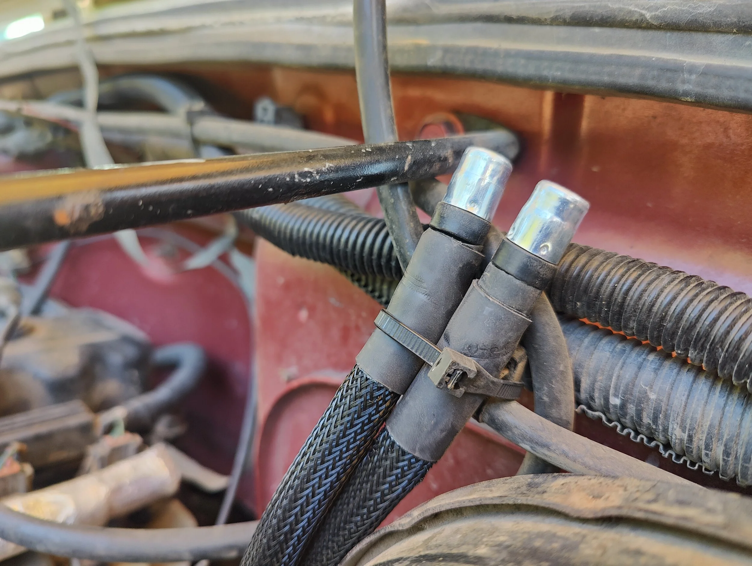

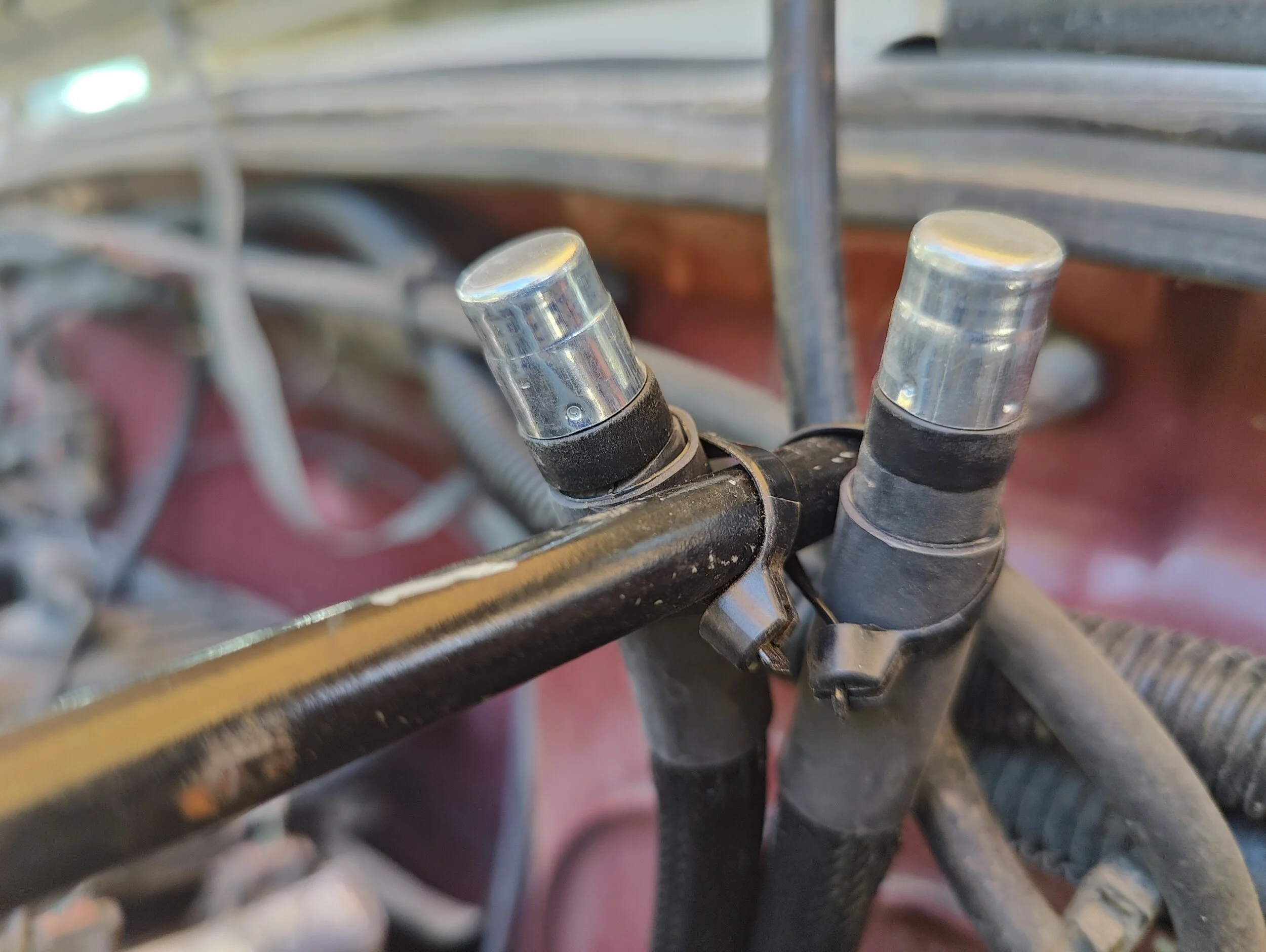

Replaced vent lines. Used Gates vacuum hose and some braided heat resistant tubing. Original spot for the vents hit the hood, moved them lower.
Dropping the gas tank and reinstalling the bumper here in a bit.

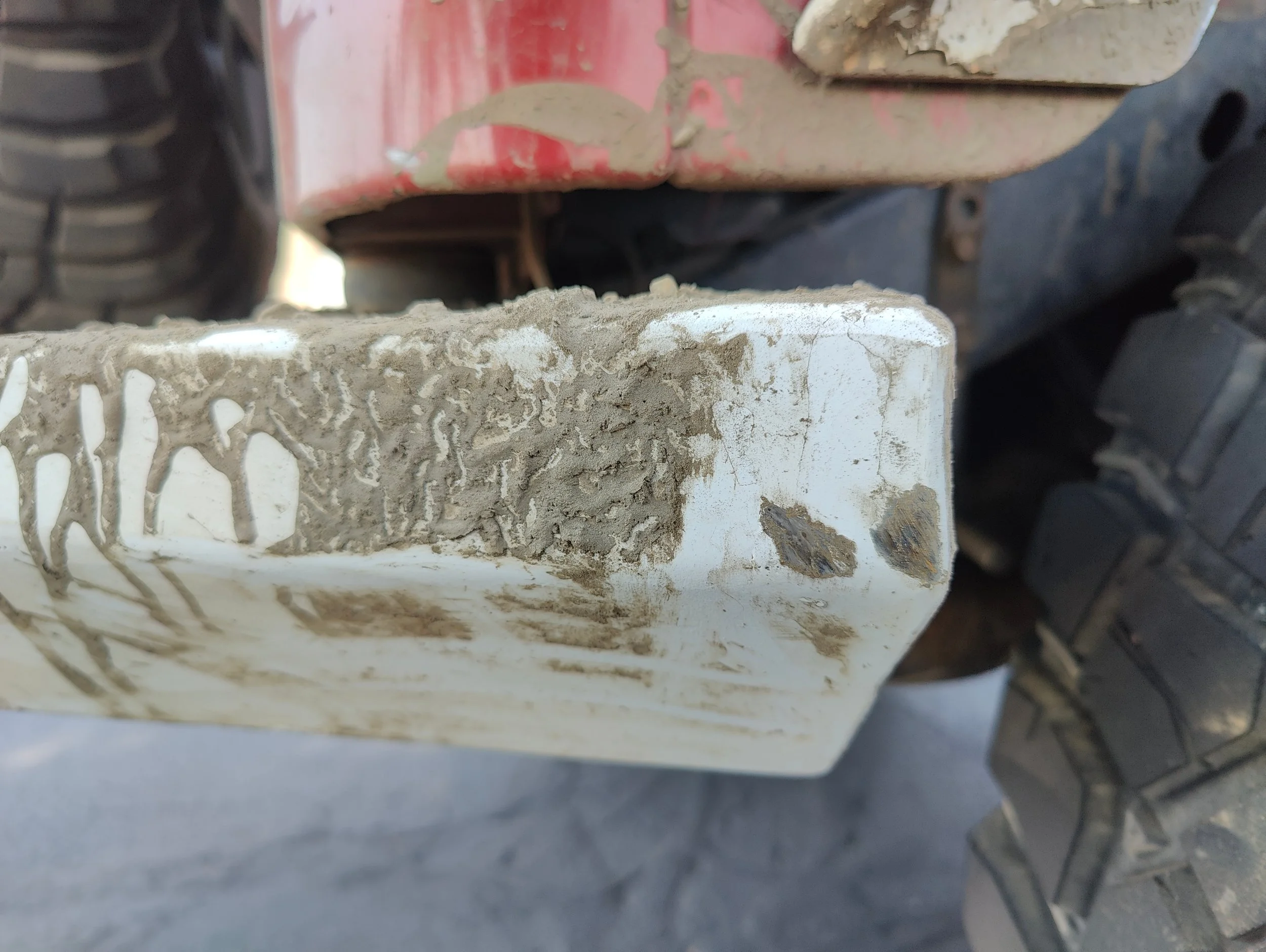

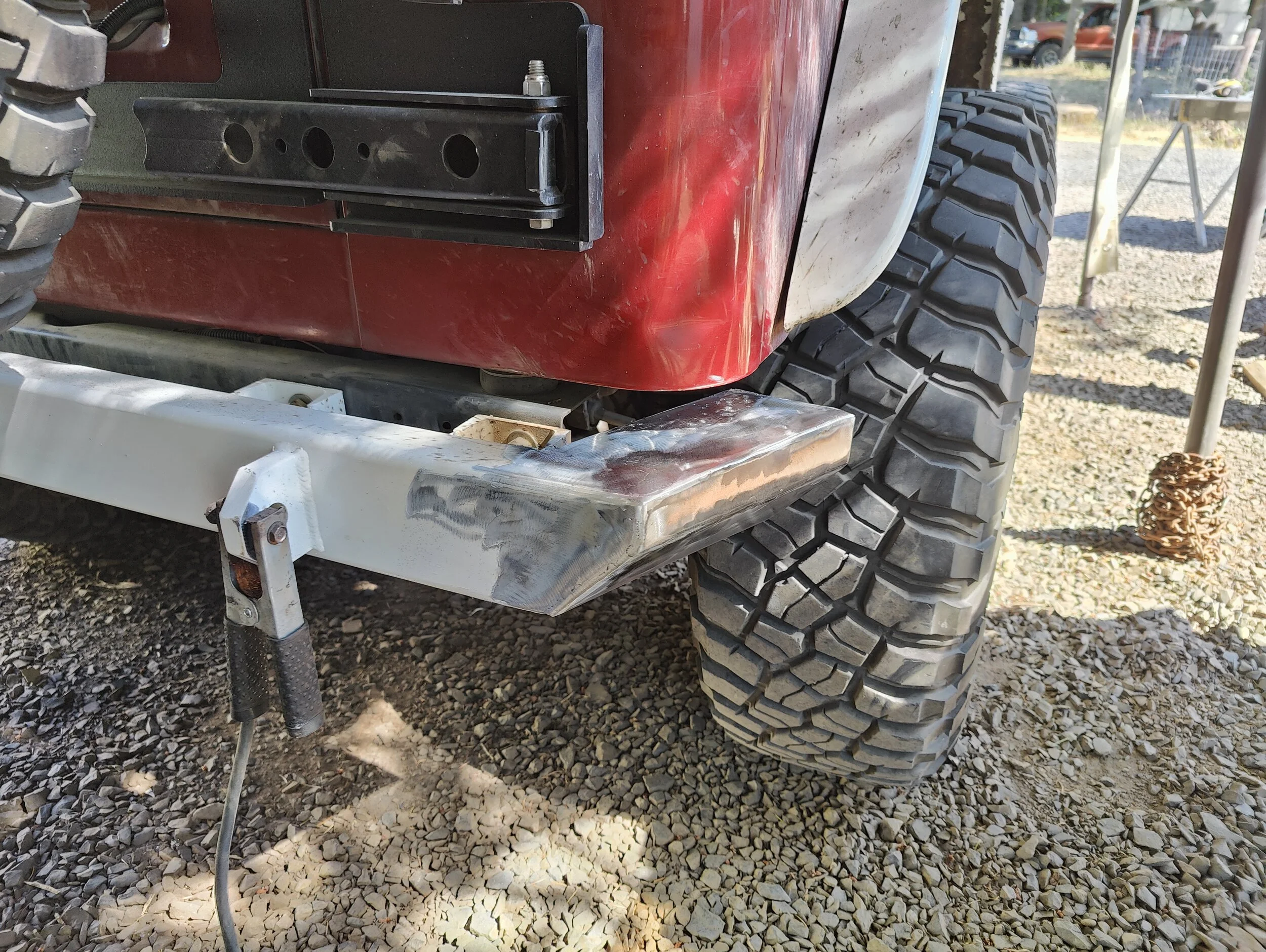

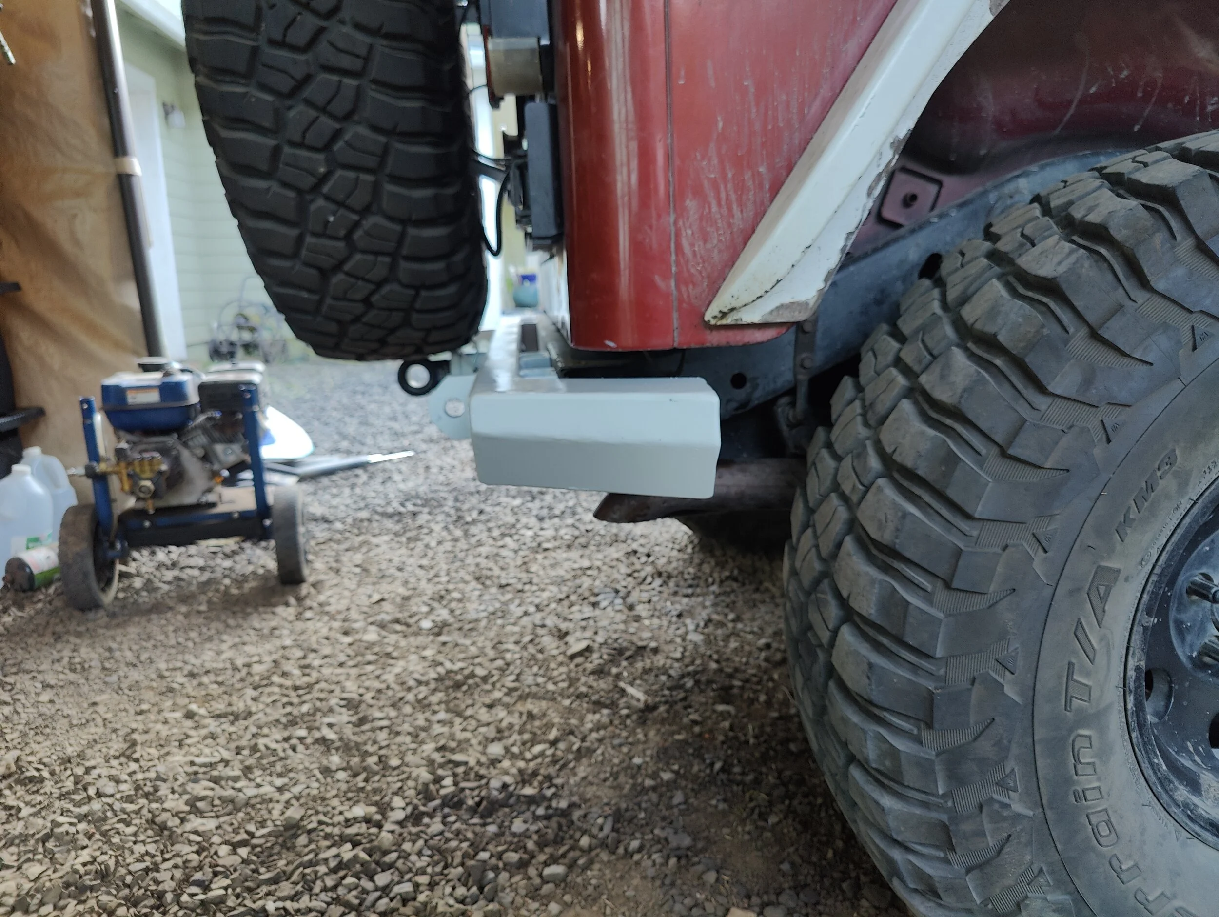

Battle damage assessment...one minor mystery dent in the rear driver corner...must have slid into something. Very glad I extended my Dirtworx bumper.
Axles took some rubbing, along with the transfer case and gas tank skids but nothing major. No oil pan skid... didn't hit it or my exhaust or driveshafts.

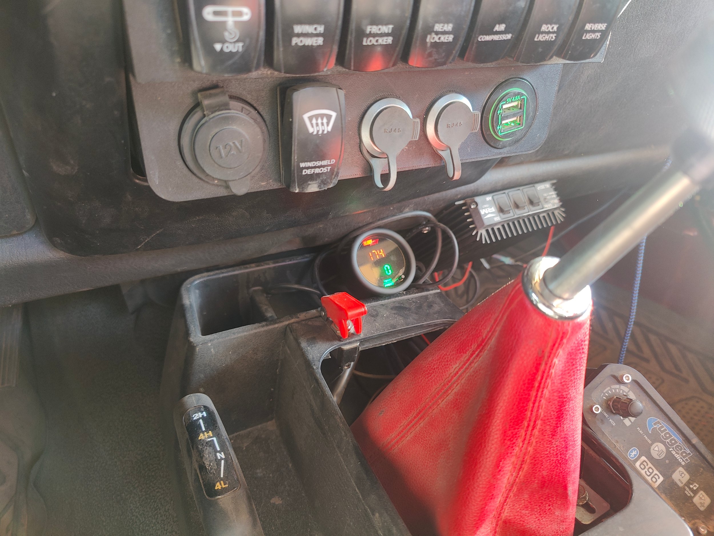

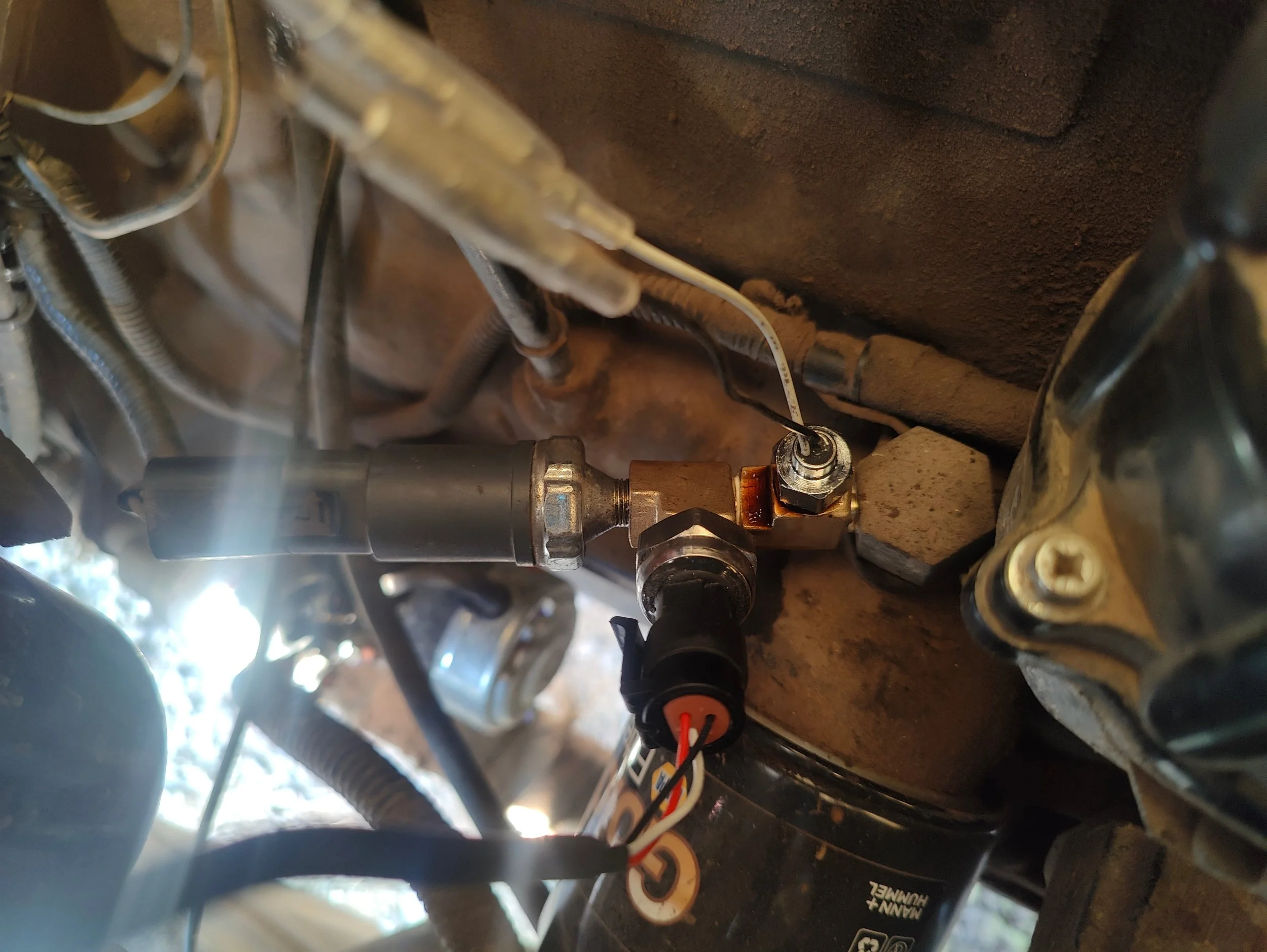

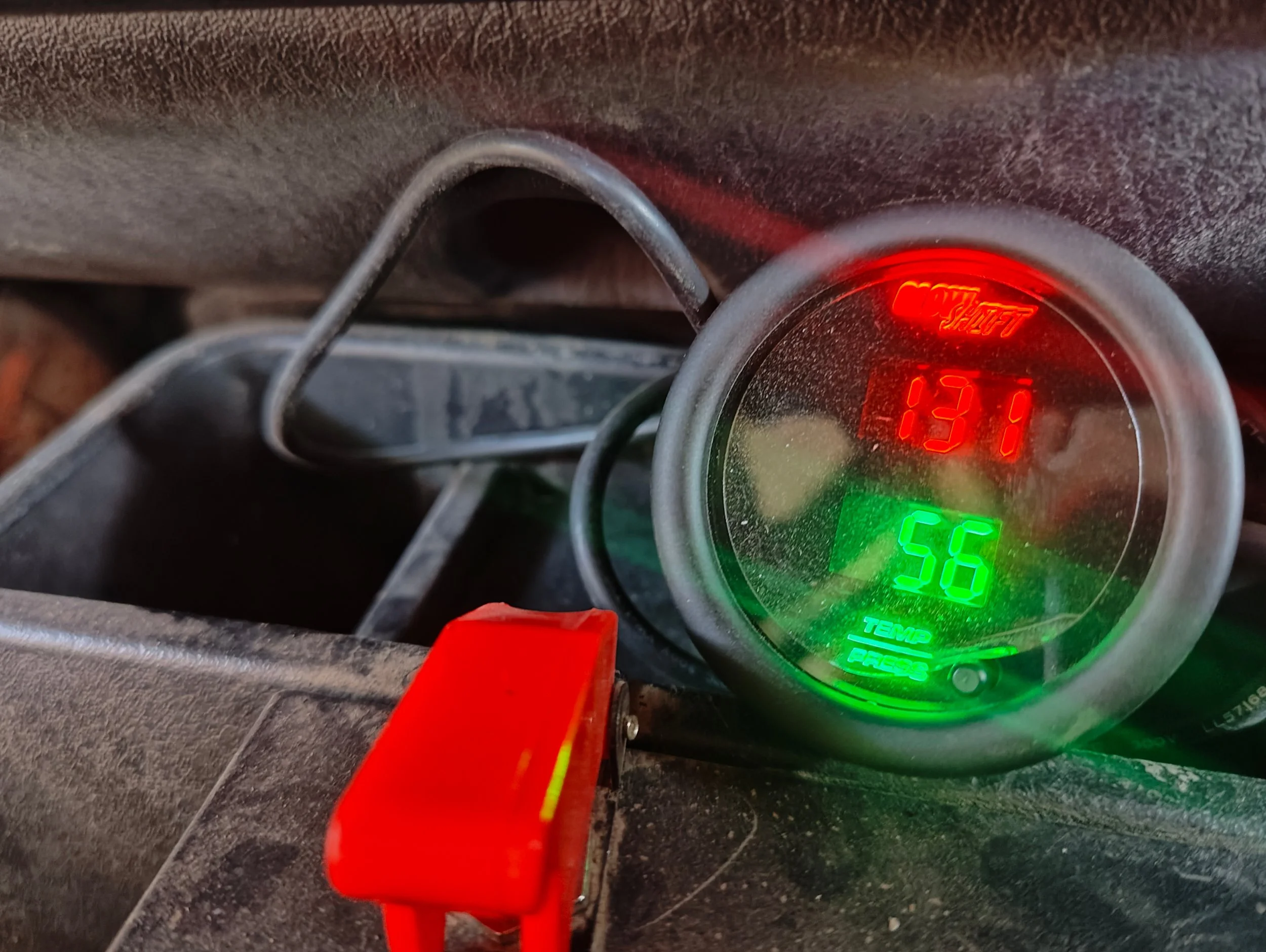

But why work on that... installed a GlowShift pressure and temperature gauge and two 1/8" street Ts.
Plan is to monitor temp and pressure for a month and then install a oil cooler ala the Ecoboost post. But I want data first!

Belt is still down a rib.

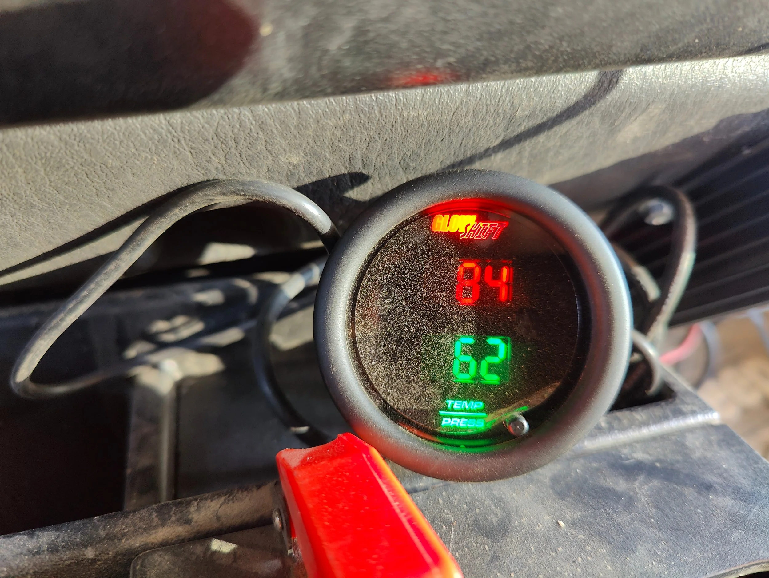

Guess I need to redo this post...wiped out in the restoration.
Drove to town yesterday... starting temperature is probably pretty close to ambient temperature.
After driving 5 minutes or so...
Got to town...oil temperature seems to stabilize around 170 degrees. Dropped as low as 168 and as high as 177. Soon as I slowed down and parked the oil temperature creeped up quickly.
And after driving home...again...40-60 mph, 25 miles, 30 minutes...right around 170...
Used my IR thermometer and hit the two street Ts. Came out at 198-200 degrees. Also the temp probe is leaking oil... thinking the cheap Amazon T is bad.

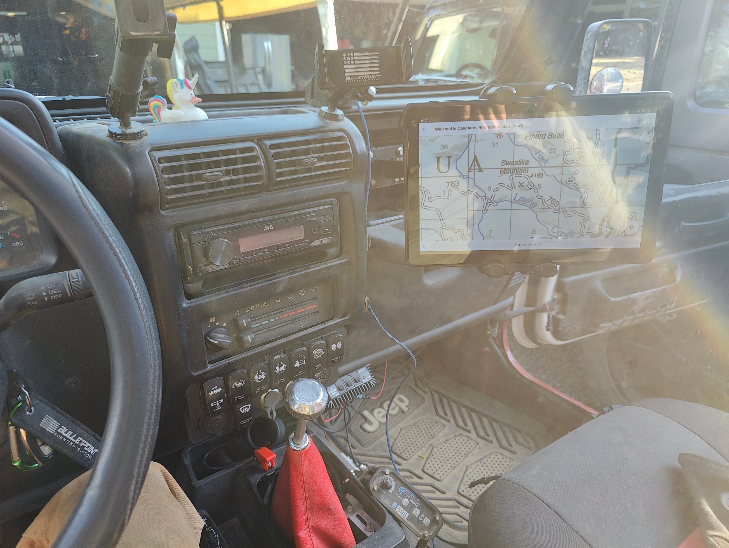

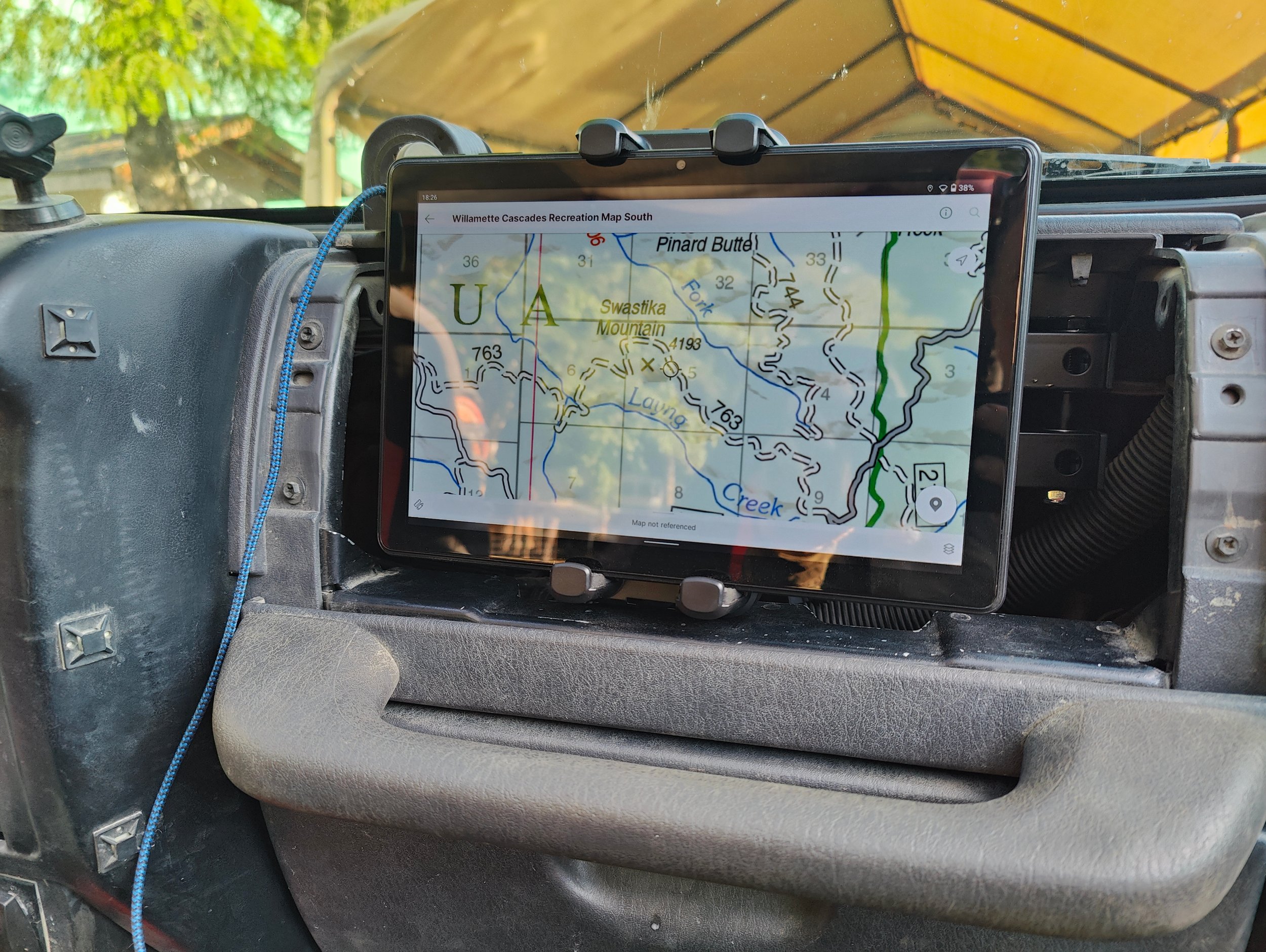

So after that I needed a break...so the cheapest tablet arm I could find on Amazon arrived. I looked at tablet mounts for months and couldn't decide on anything.
Plasma cut out a quick bracket, drilled and tapped some holes. Think it needs a gusset on the sides and some paint. Concerned with bouncing and occilations while moving...but conceptually this is what I'm after.
