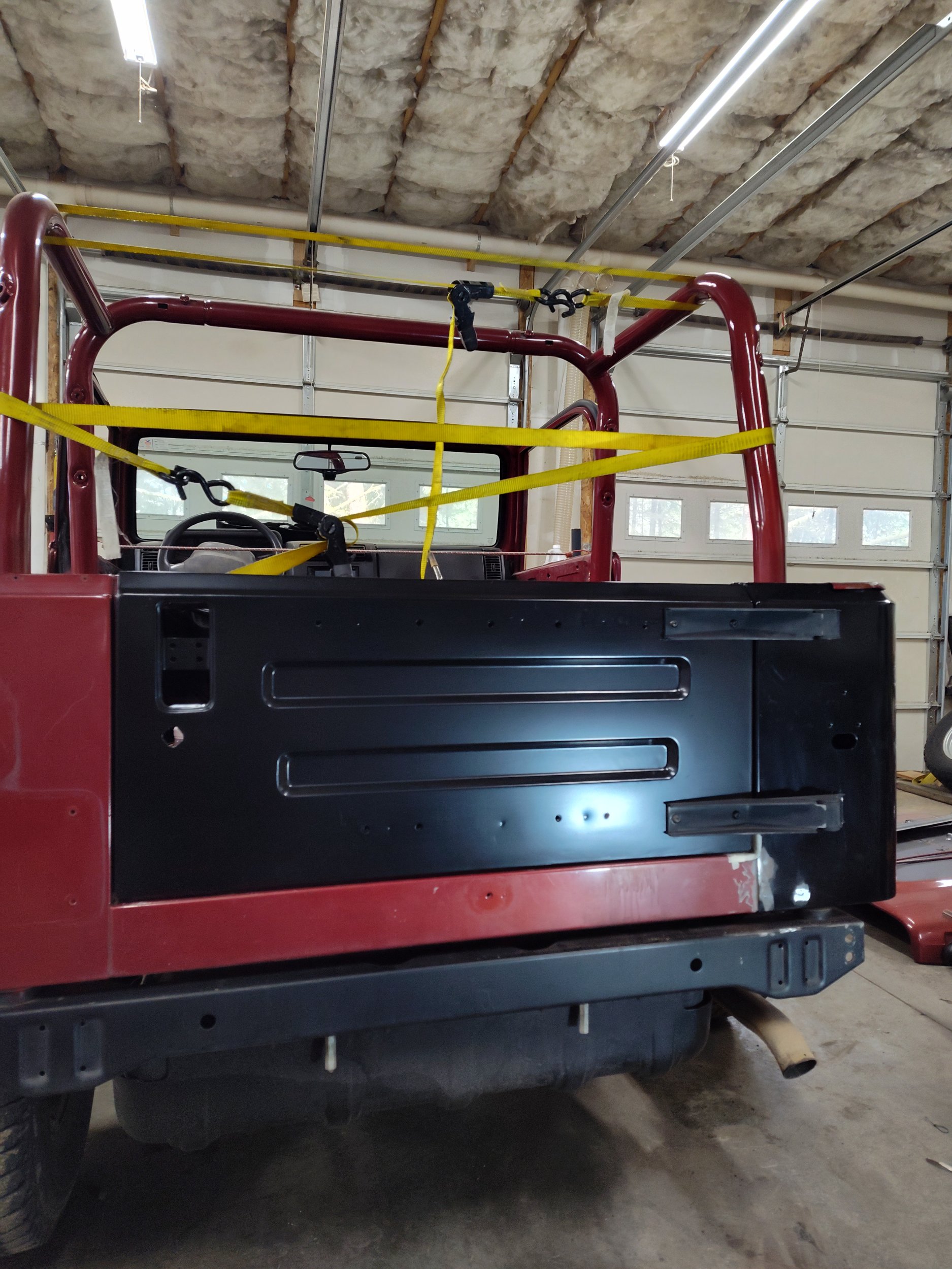

Just replaced my tailgate with the Crown gate and I have nothing to complain about. The only issue is the third brake light harness hole is missing but not a big deal. I hung the gate about a 1/4 in high on the latch side to counter the weight of the spare.
