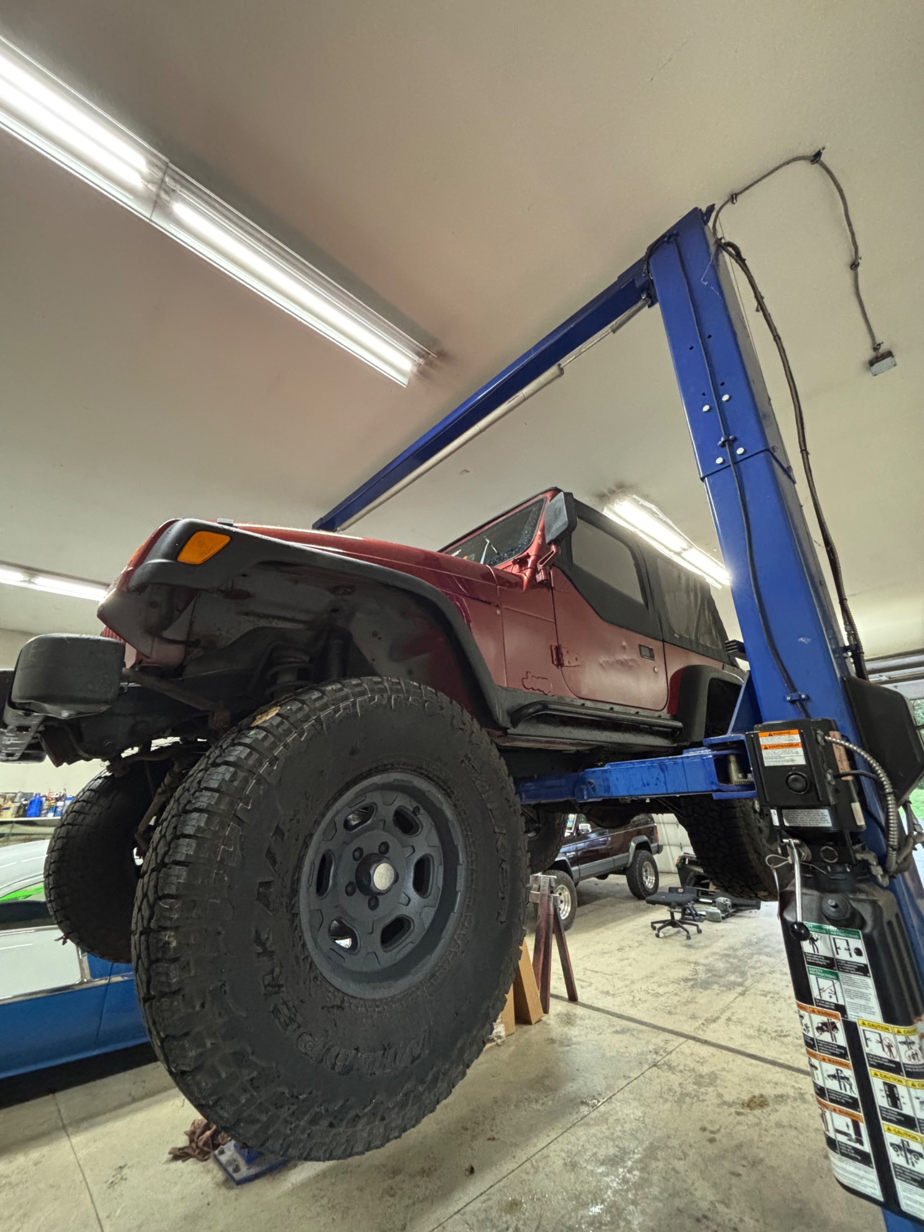

Update: slave and master cylinders are installed!
Pros: clutch feels better than before and shifts are smoother.
Cons: after the test drive, I noticed a noise coming from the transmission when I shifted. Listened closer and Everytime I shift into another gear and let out the clutch, it makes this screeching sound. I think I might be in for a TOB replacement.
Reactions: TJ Jim
