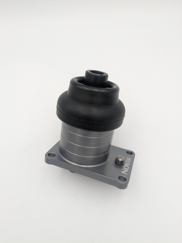

By chance is the breather installed in such a way as to make it easy to install a barb fitting to run a breather hose up high?

Now on the vent, you should be able to remove the existing vent and replace it with a nipple. It is mounted right on the plate of the shift tower as seen in the photo below. Depending on how much space you have between the body and trans, you may have to do a 90 degree nipple rather than straight but should still work.
