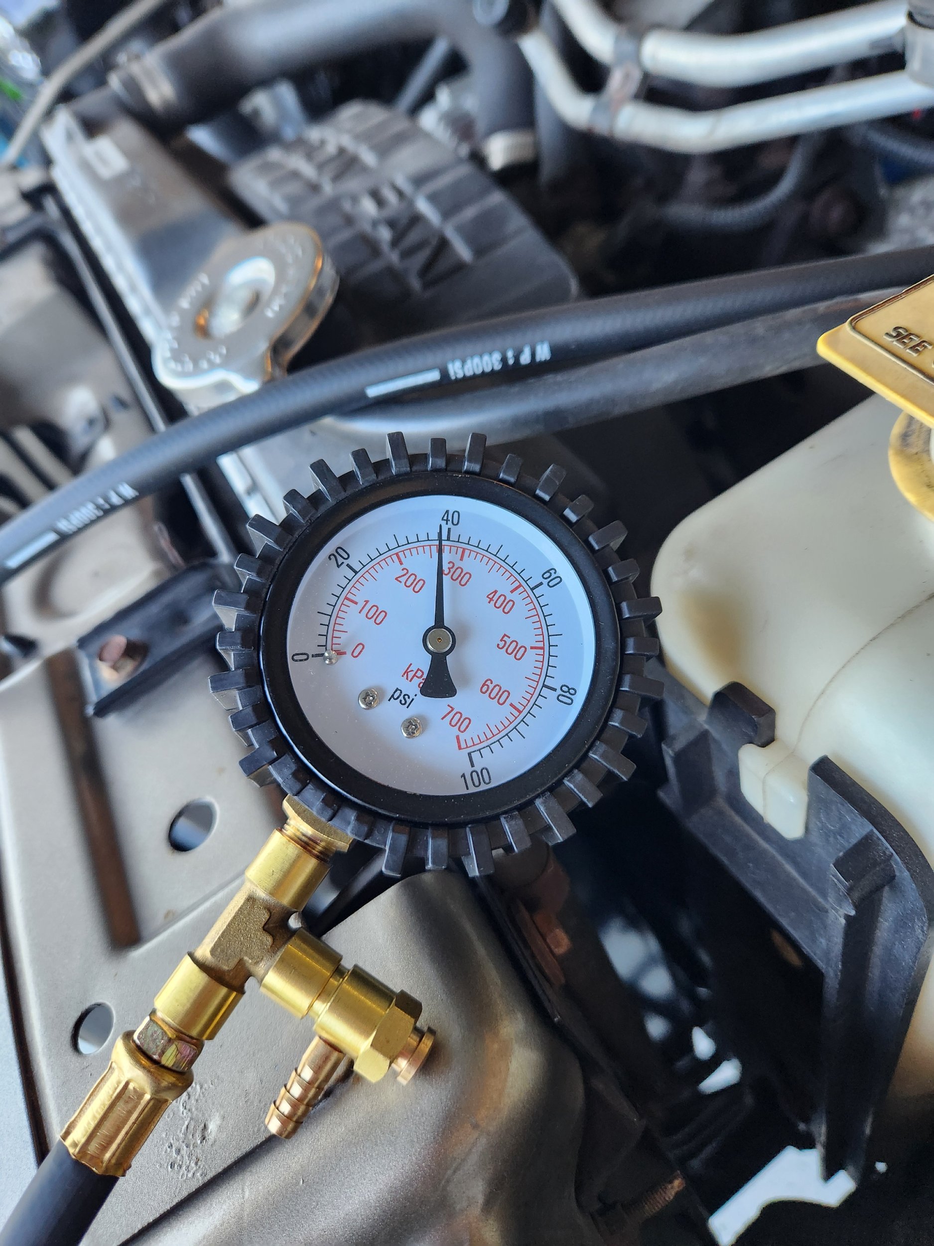

I didn't want to start another thread so I thought I would ask here. Is 40 psi while the engine is running too low?
Just a touch. Should be 48.
Mine ran on 30 but you could see the PCM compensating in fuel trims and my gas mileage was down 1-2 mpg.
I'd start by verifying with another gauge.
-Mac
