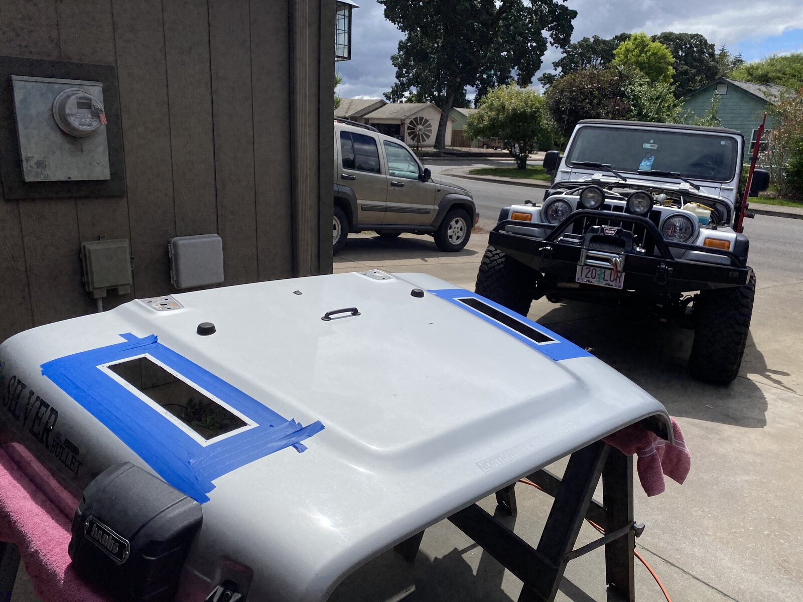

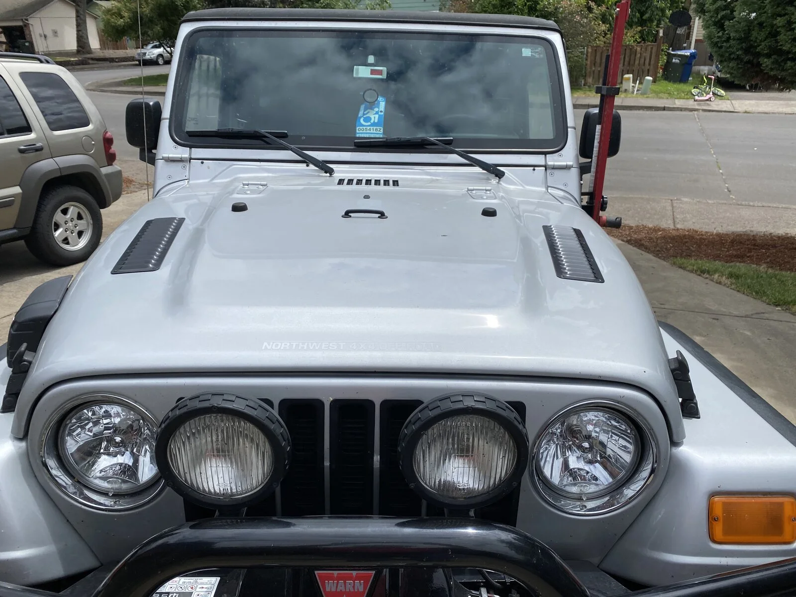

Well here are the vents installed. I didn’t complete the venting holes because the hole saw was making quite a racket and my neighbors can only tolerate so much before they report me to the HOA. 🤷🏻‍♂️ I’ll finish making them functional another day at a different location. Also I’ll get some better pics but overall the look of them is extremely underwhelming, just as I hoped.View attachment 266345View attachment 266346

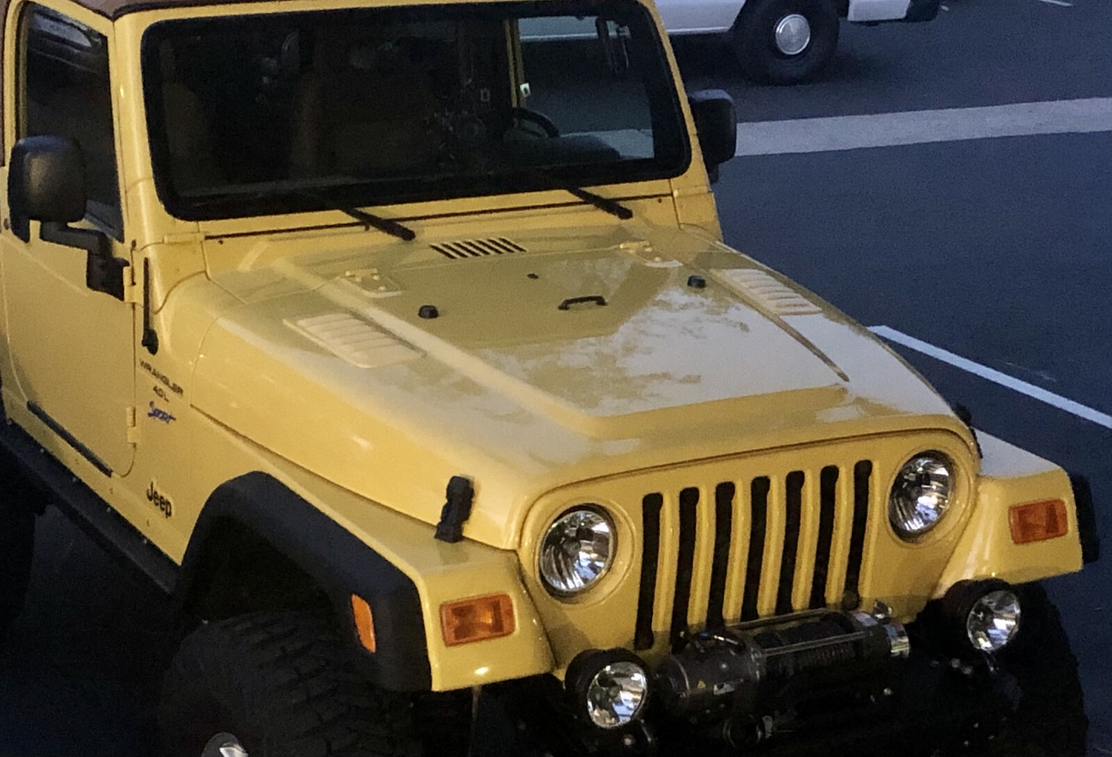

Love the vents! What temp is it running at after you installed them?
i used some for heat control and the only answer i could give is no longer hot where i needed it not to be hot.

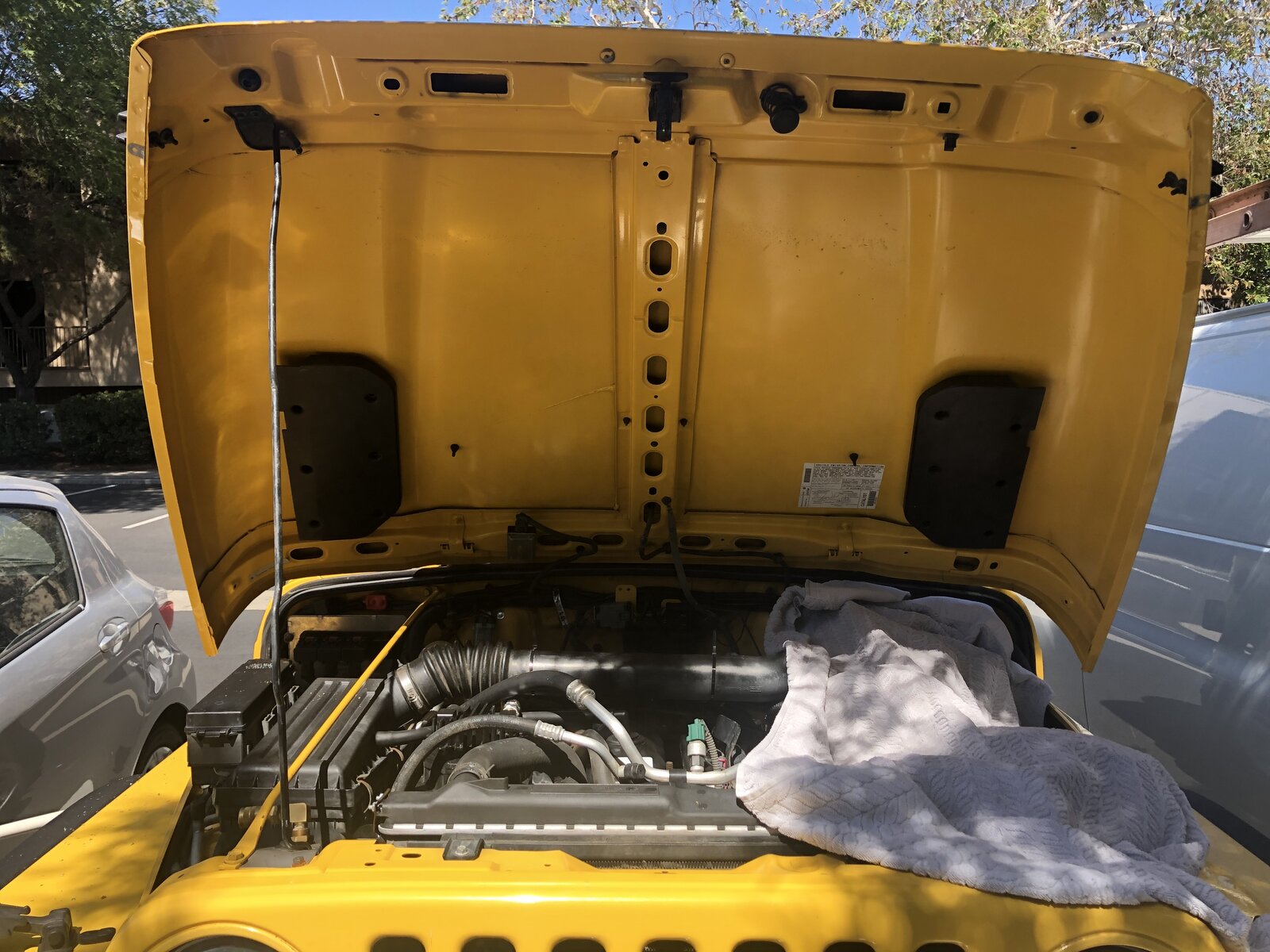

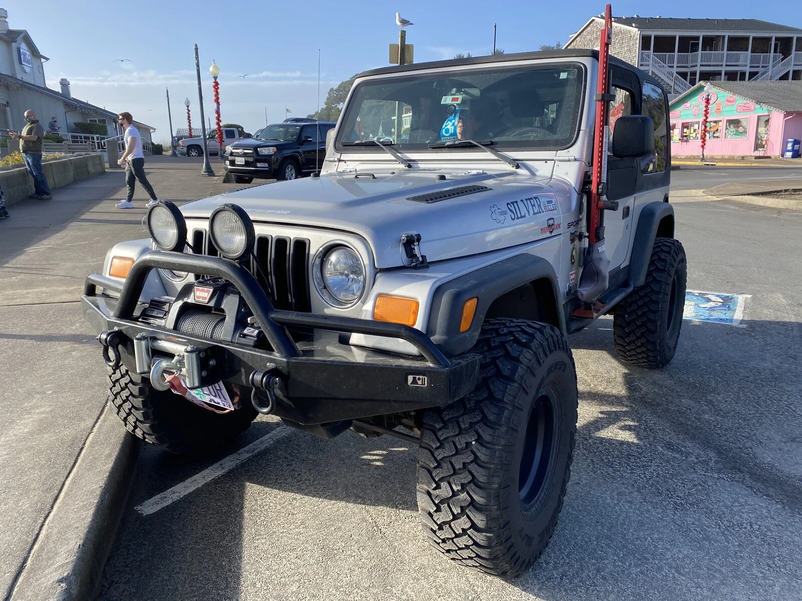

Picturers of when I installed my vents. While it did reduce my temp by a couple degree’s I was looking for more. I did a Ford Explorer conversion fan clutch with a 10 blade fan and HD water pump. The temp went from 210 at idle to 195. It’s been on the Jeep for a year and works great. My 4X4 shop recommended the conversion, and when the called the parts distributor they knew exactly what the technician was talking about and had the parts to us the next day.

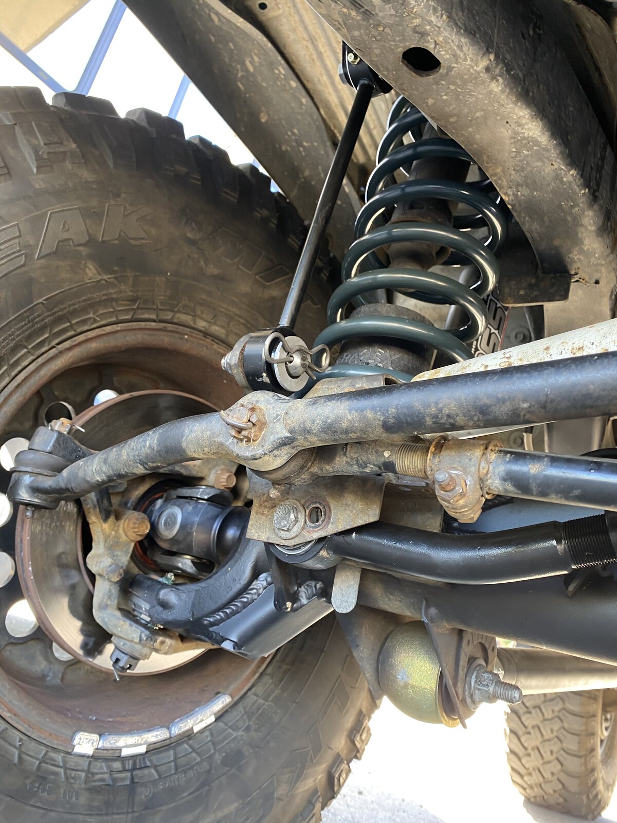

Yes, Adham Sproat run’s it. I am originally from Monroe (just returned after being gone for a long time for work) and it is cool that I have a great shop right here. He put on my 4” long arm lift, trussed both axles and my ball joints, as well as many other things.
He trussed your ball joints?
