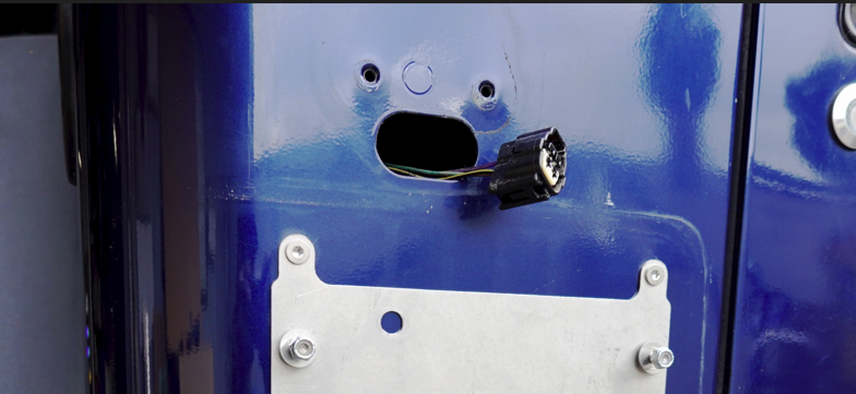

Are these mounted with through bolt and a nut on the backside in the tub or is there supposed to be threaded nutserts in the tub?
Neither, the OEM mounting method is 3 extruded holes in the sheetmetal that they use Type F thread cutting screws to make the threads when the lights are installed.
PO 'fubar'd' mine and there are just mangled holes in the tub. Can I through-bolt them?
Yes, you have 2 options, if the original holes are there but ruined, I can include 12-24 Keps nuts so you can use the supplied screws and through bolt. If the original holes are cut out like would happen if someone hole sawed for grommet mount round, then the housings have holes in each corner you can use. They will then use a low profile 6mm screw with Keps nuts to mount either through bolted in the sheet metal or drill and tapped corner armor. I am short a few pieces for that hardware kit but they are in transit.
Thanks. I’m fine with wiring them. Got any pics of the mounting?
This is the bottom two.

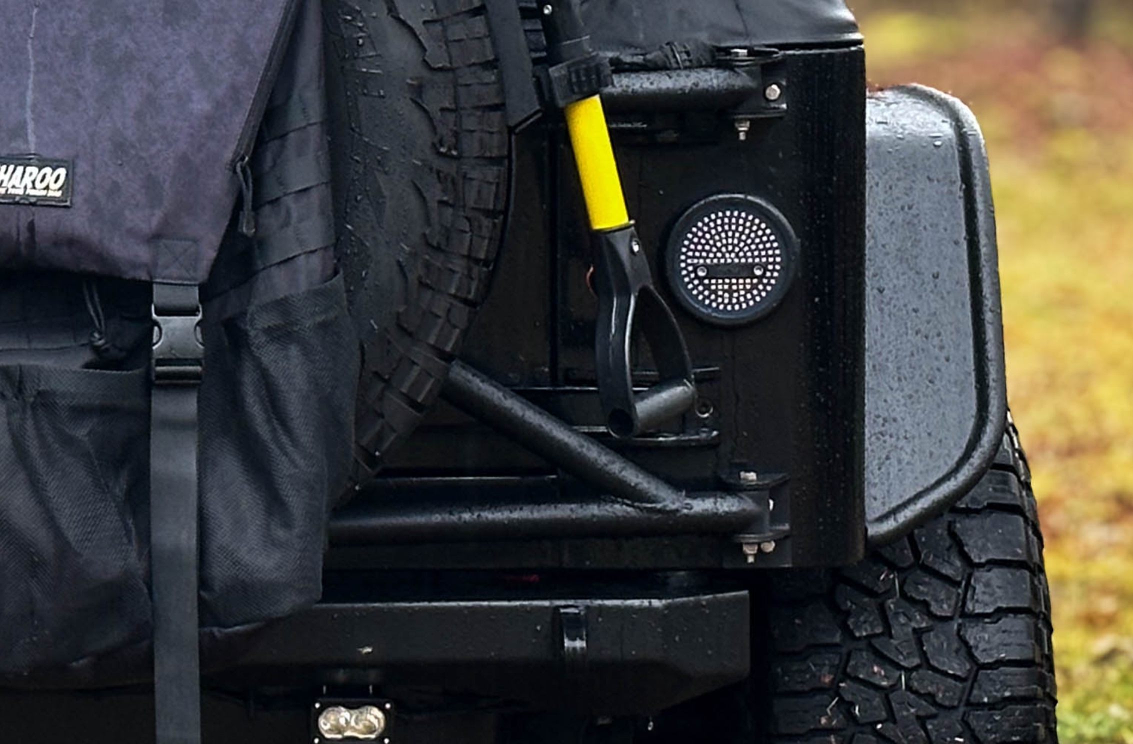

I should ask this now…. I have the Bestop Highrock 4x4 Oversized Tire Carrier.. Looks like there is ample room to mount the lights but…. Thoughts? Any interference from the swing-outs mounting bracket? Think the lights will clear?
