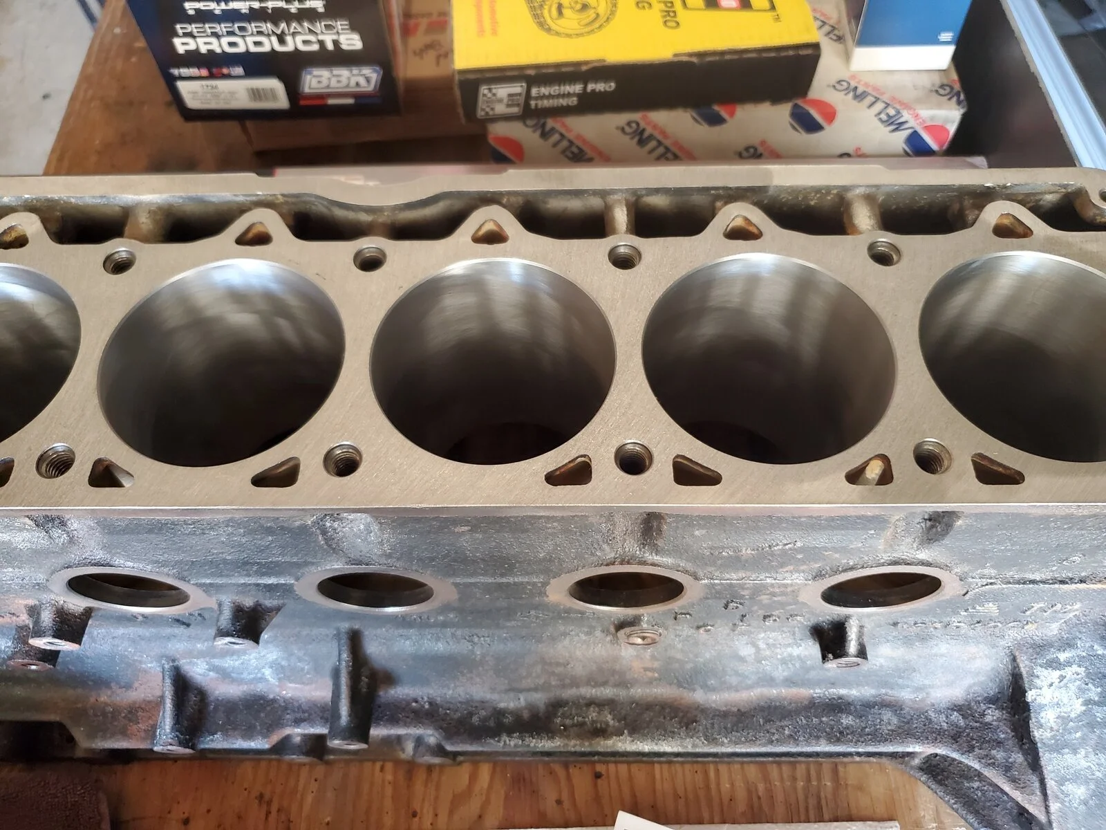

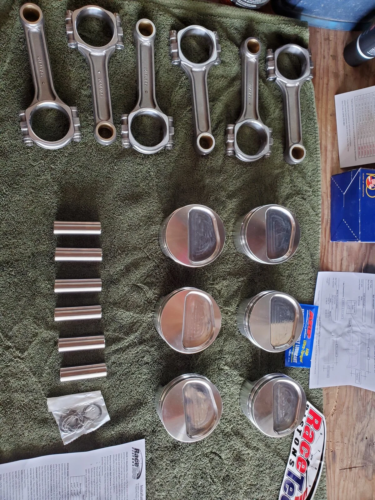

So I picked up most of the parts for the 4.7 Stroker from Russ this week. Here's a quick look at some of them:

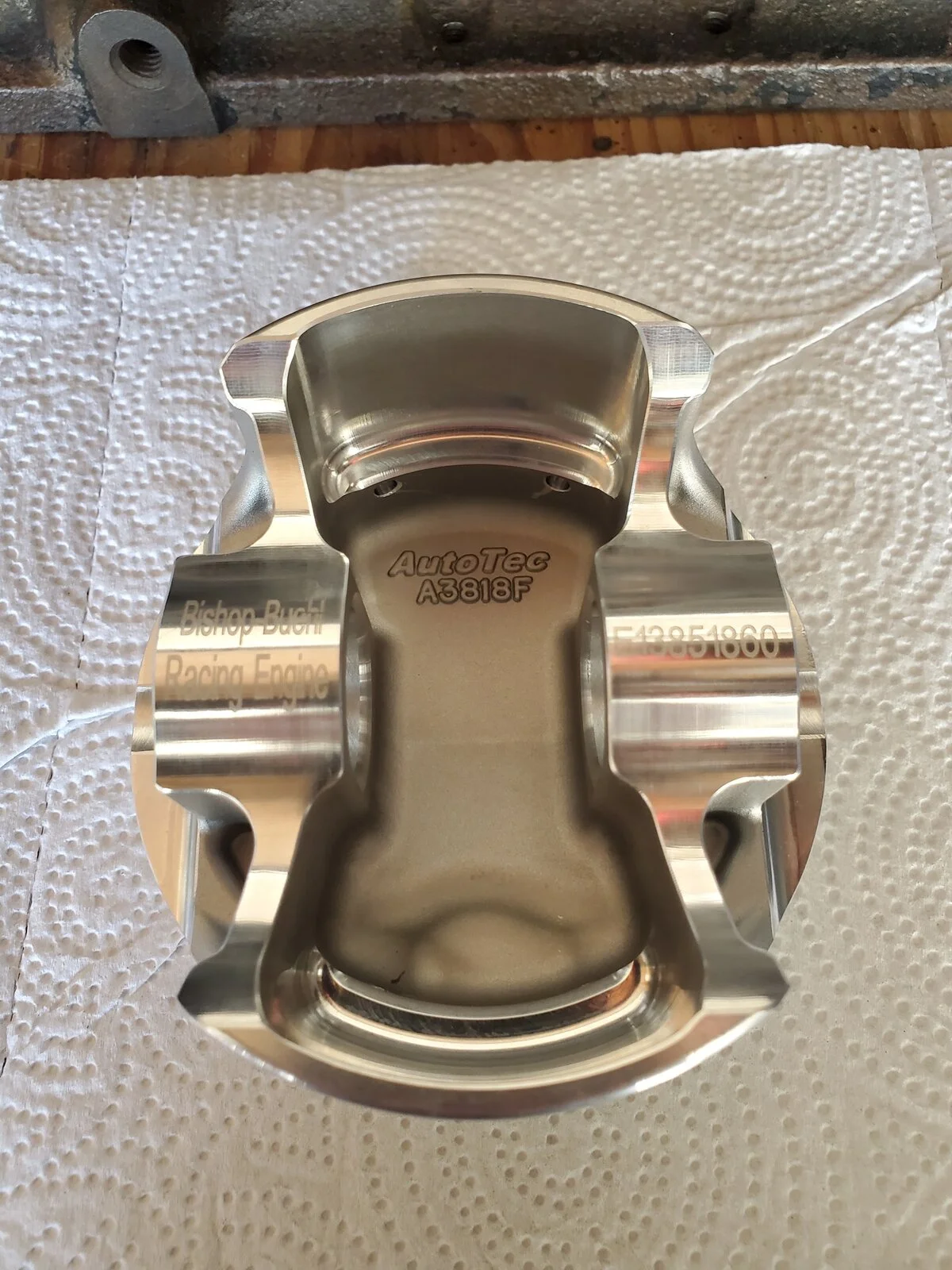

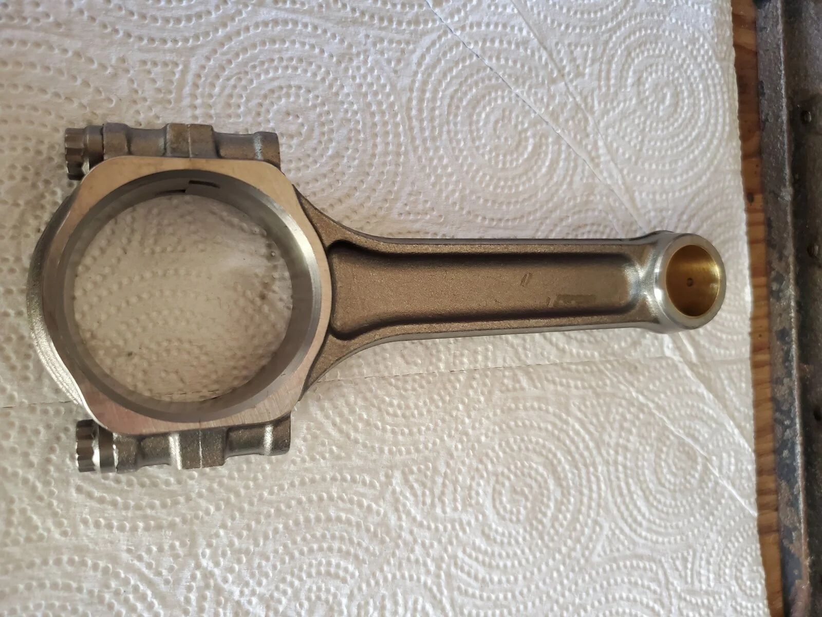

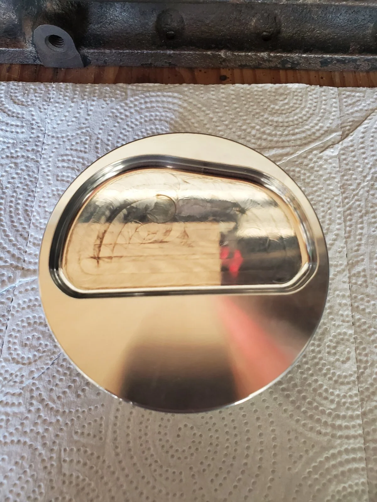

Forged Pistons and rods

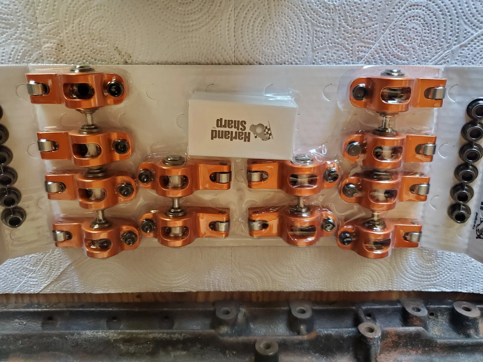

Roller Rockers

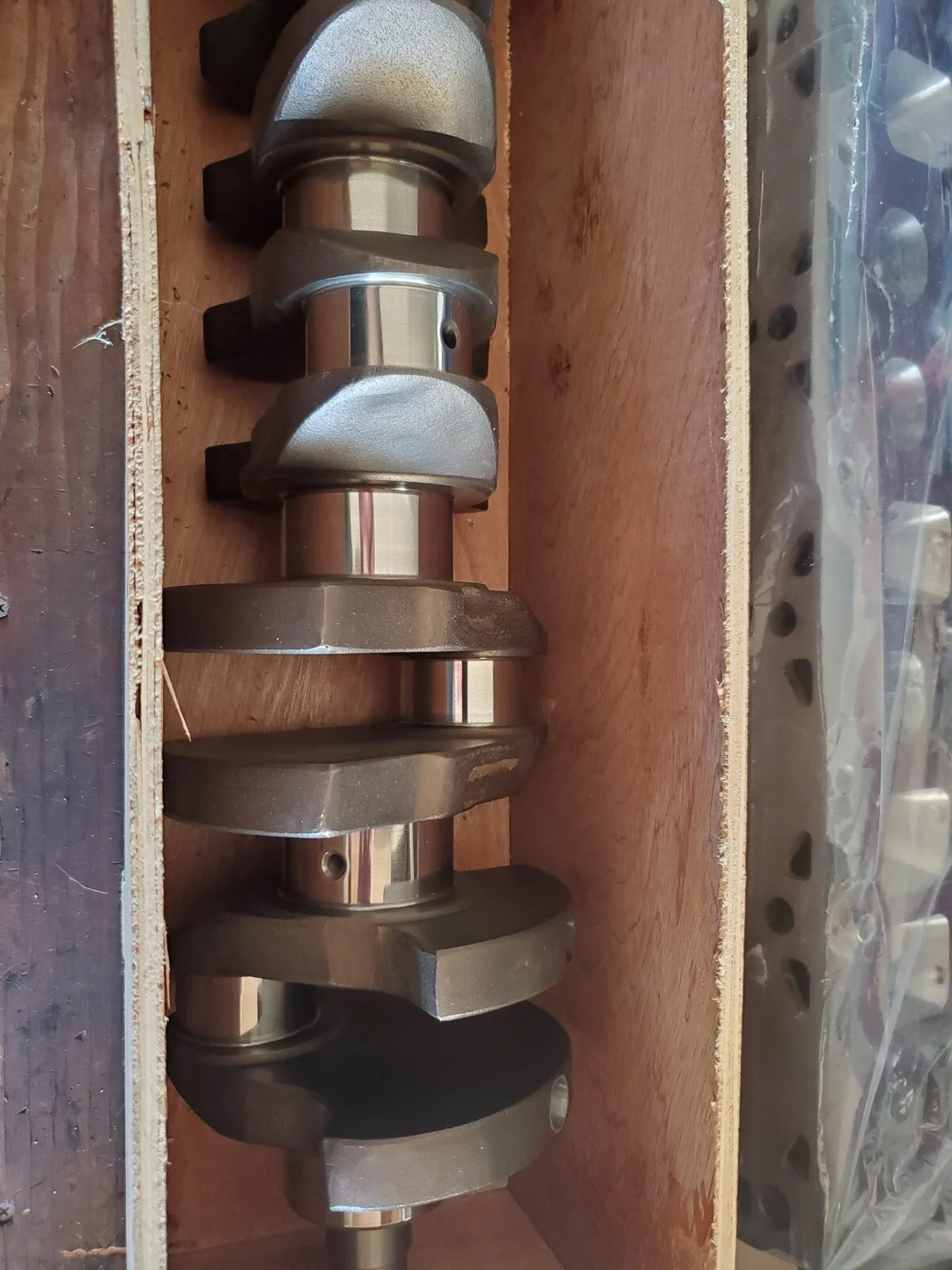

12 wt crank

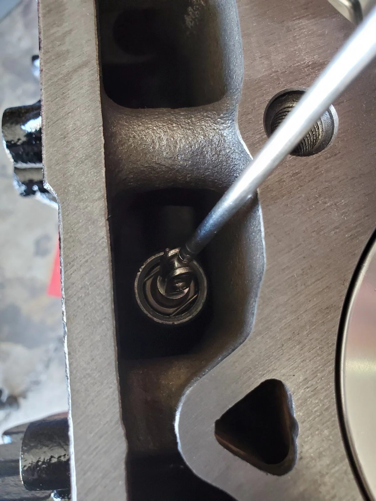

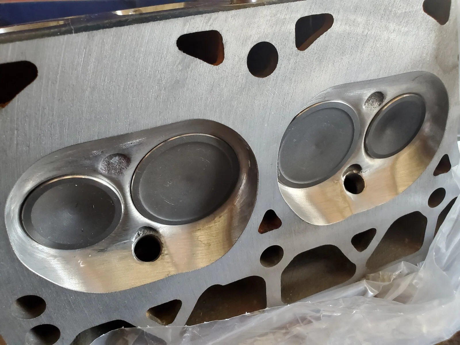

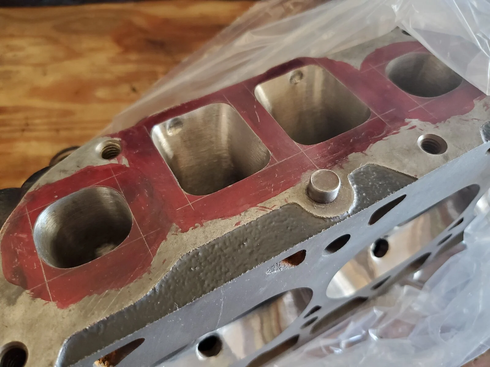

The head had a lot of work done to it. chambers opened a bit with LS valves and ported

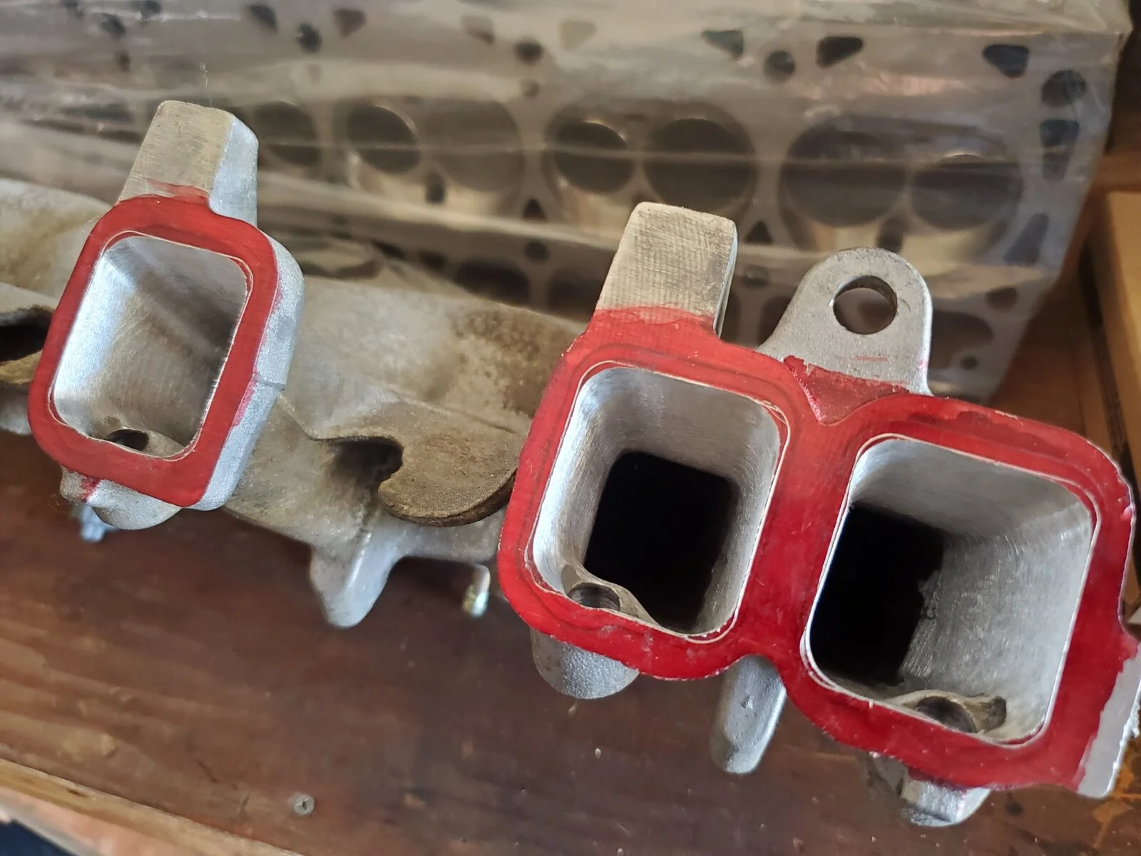

Intake has been port matched

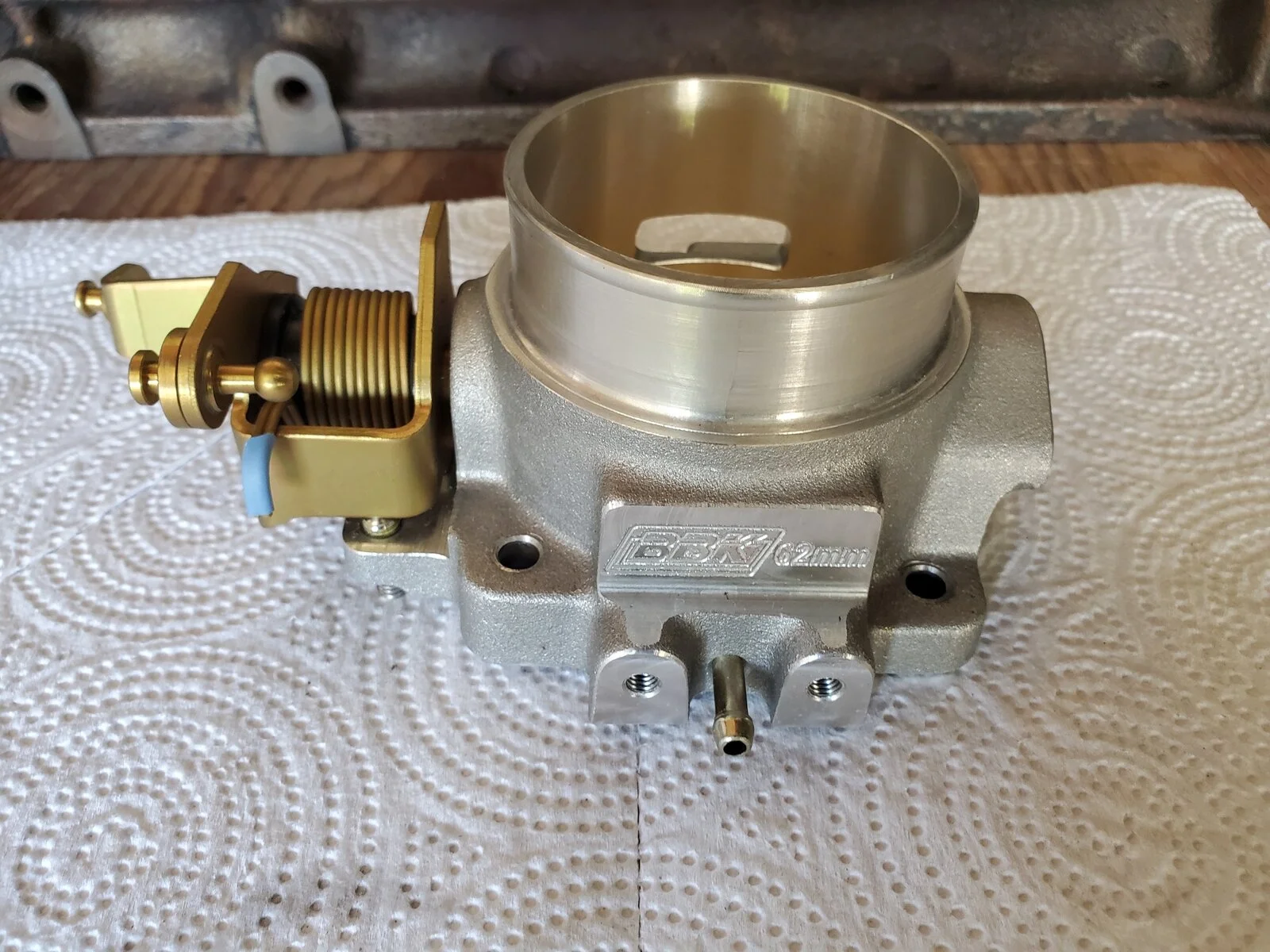

62mm throttle body - CARB approved
He also did my engine block machining

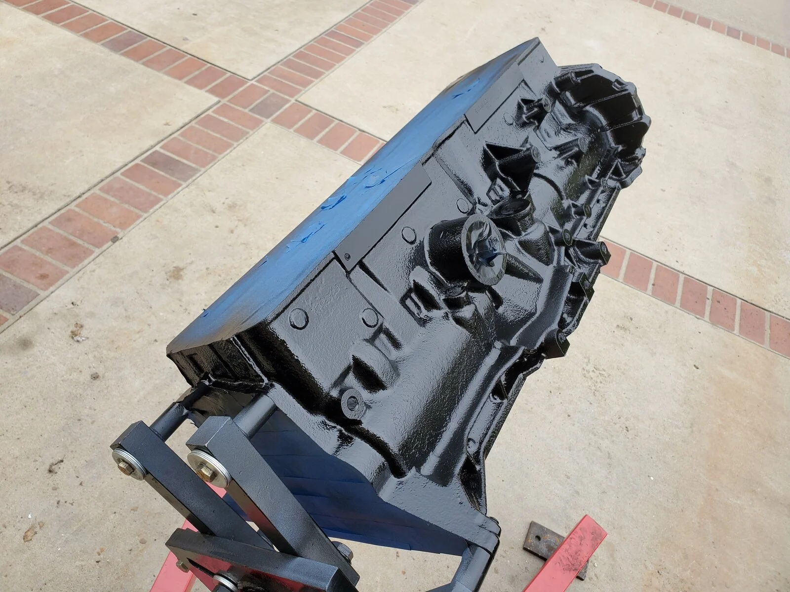

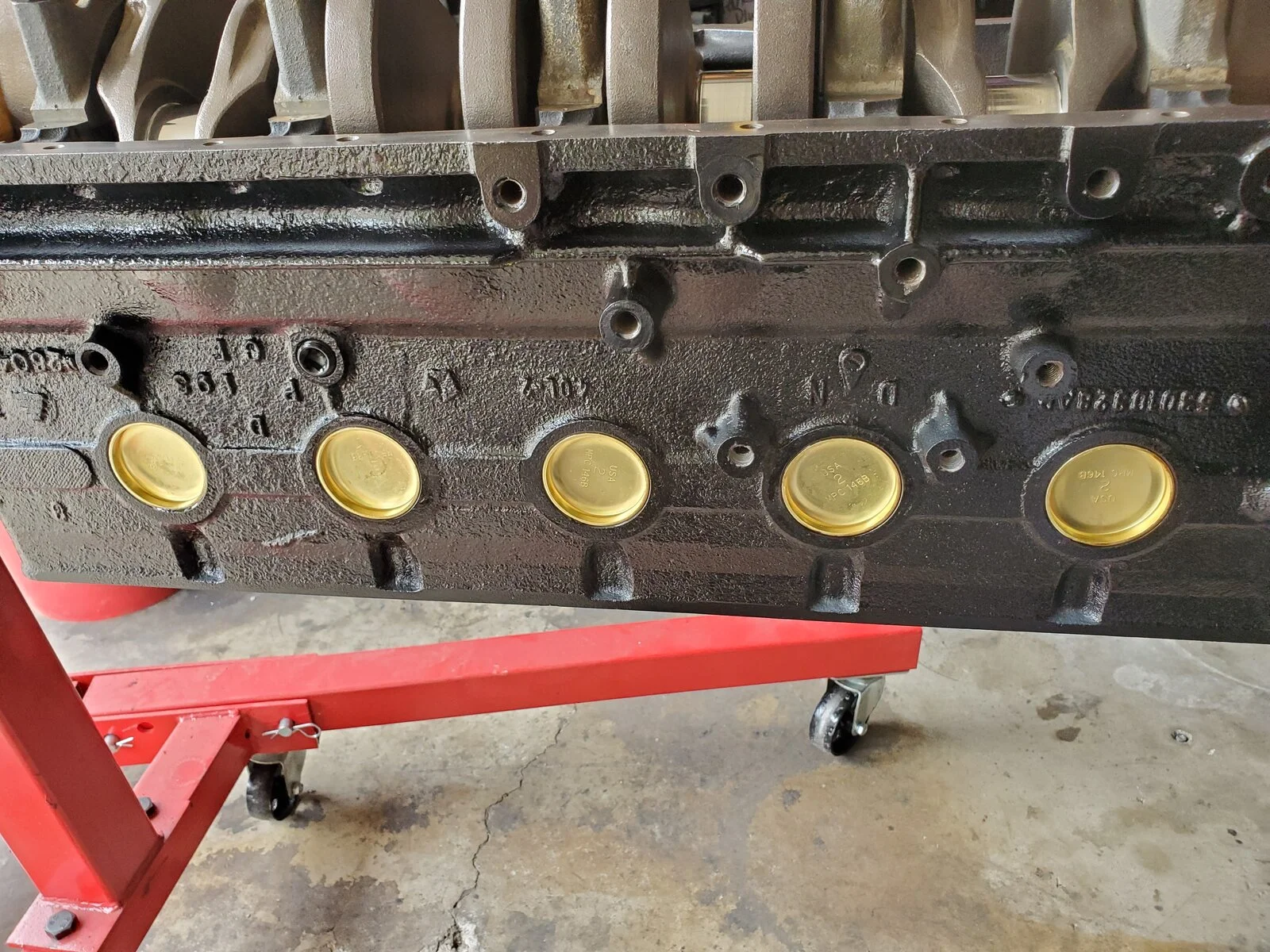

I'll start this weekend by thoroughly cleaning the block as well as make sure my work area is super clean. The last thing I want is to have debris find its way into this build. I also need to get all of the supplies (assembly lube, sealants, brake cleaner, etc).

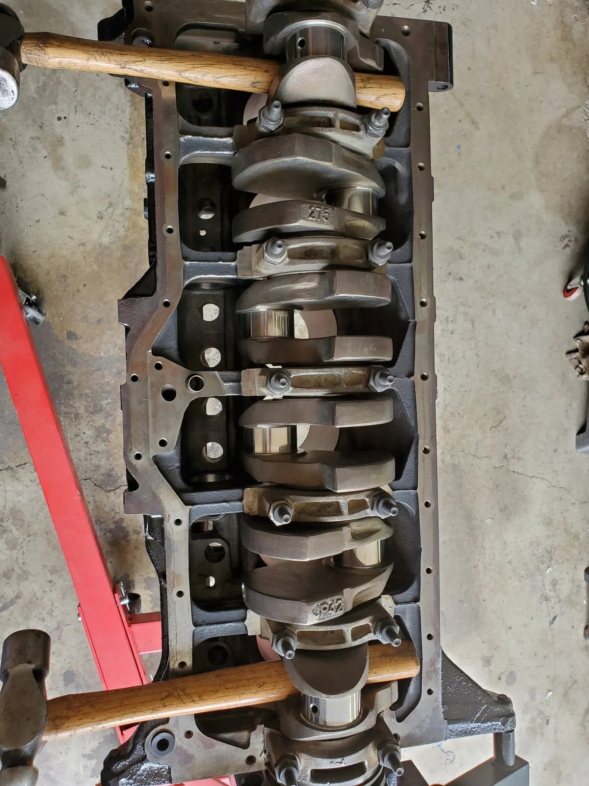

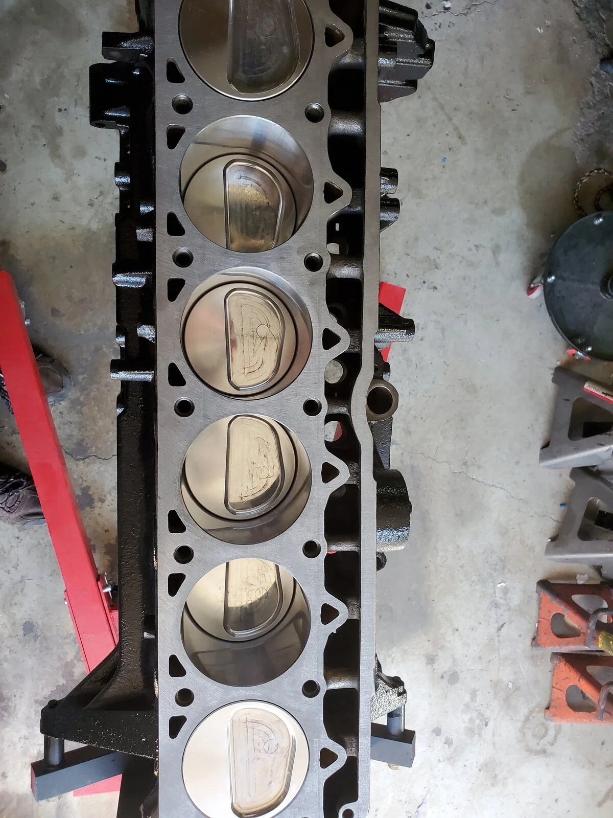

Plastigage shows .002 to .0025 for the gap for all bearings. Time to pull the crank, install the main seal, then reinstall the crank with assembly lube.

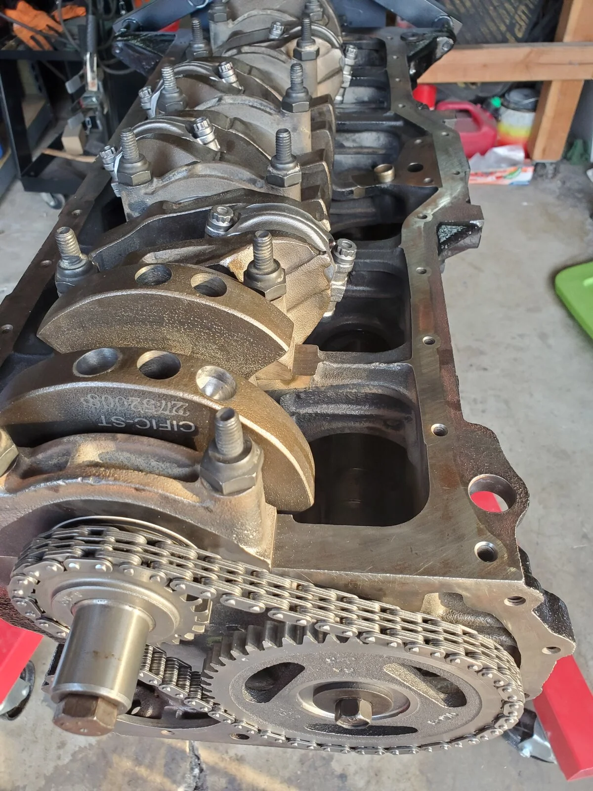

Cam is in and timing has been set. I think I'm done for the day. I have a few things to get yetto finish the bottom end. I need the spacers for the girdle and I still need to buy a new oil pan.

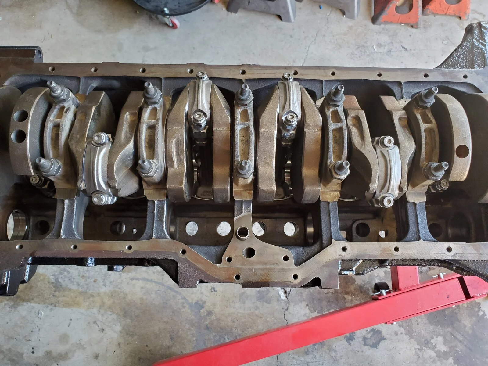

Probably the worst part about today was putting in the clips for the wrist pins in the pistons. Those things took some effort. Everything else just takes a bit of time.

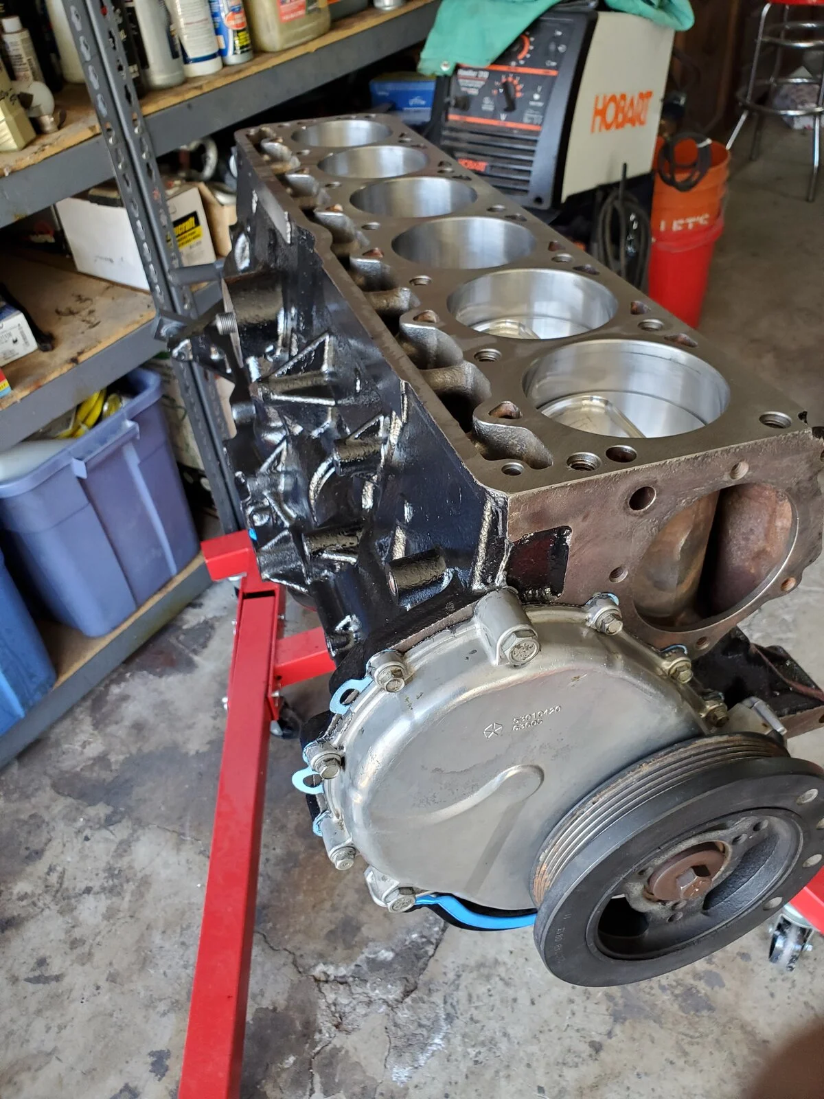

I'm working on it for a bit today. I put the timing cover. The cover goes on loosely until the balancer goes on otherwise the seal in the timing cover will leak. You also need a good mating surface for the oil pan gasket.
I didn't take any pictures of installing the oil pump and pickup but it's in there. I used a modified piece of EMT to install the pickup in the pump.

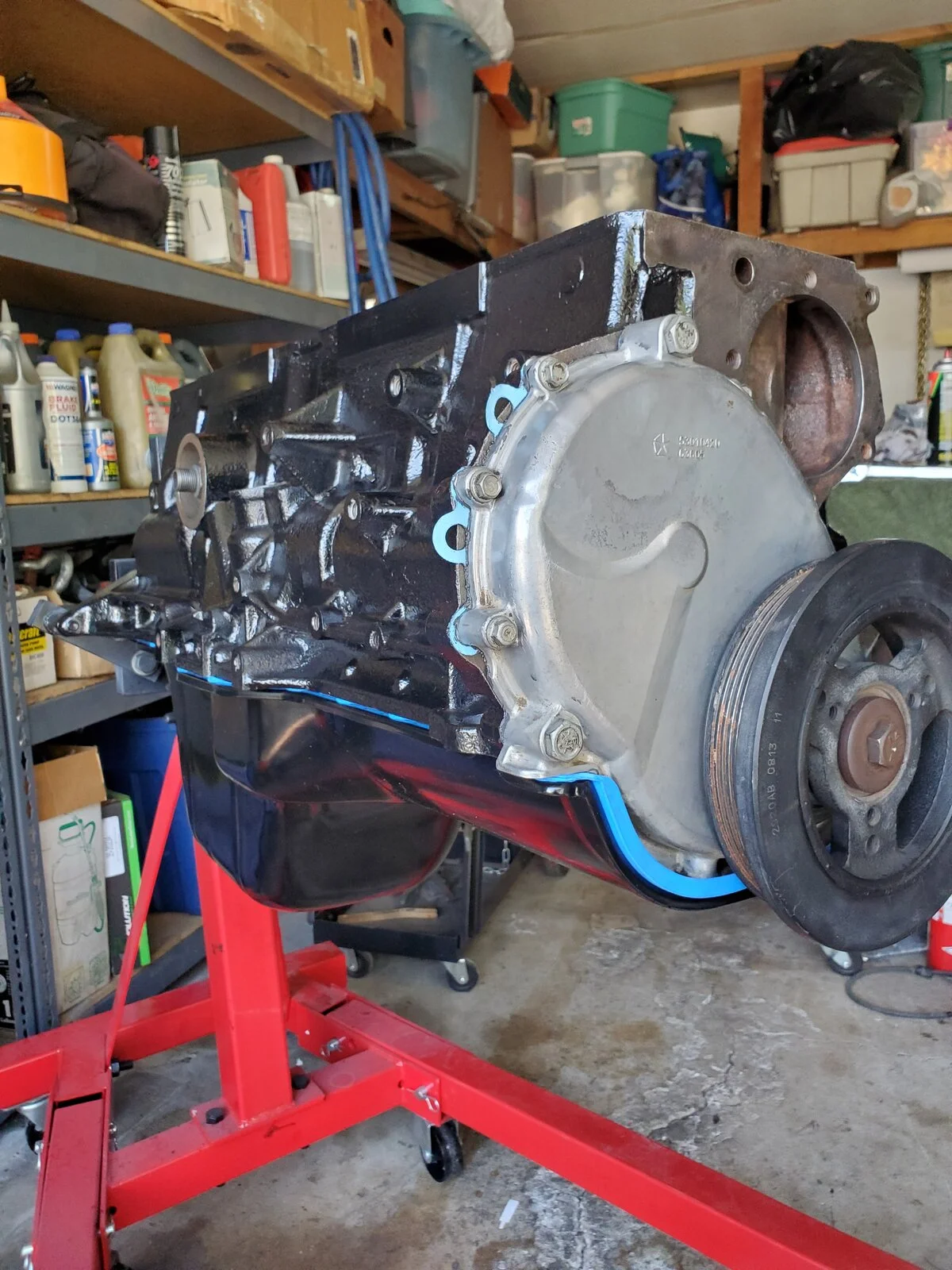

I also installed the new oil pan and gasket. I did have to add ARP .120 spacers under the girdle which lifted it enough to clear the rods and crank. By doing that the pan touches the girdle. A slight persuasion with a rubber was all that was needed.

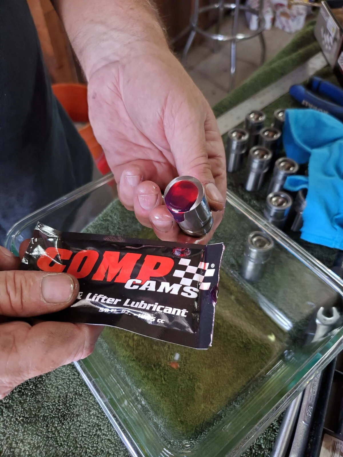

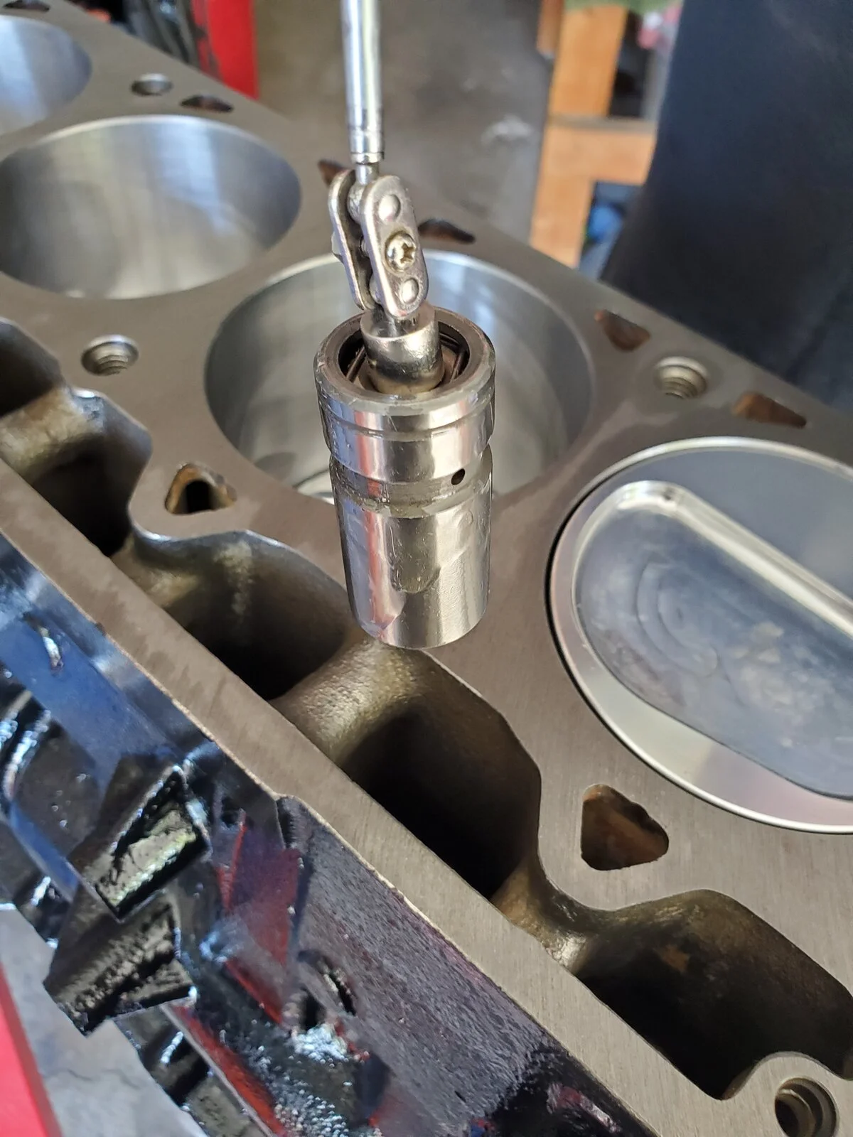

Installed the new lifters and used the comp cams lube that came with the cam. You have to use a magnet to drop them in.

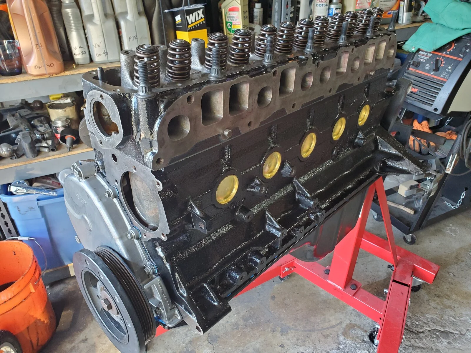

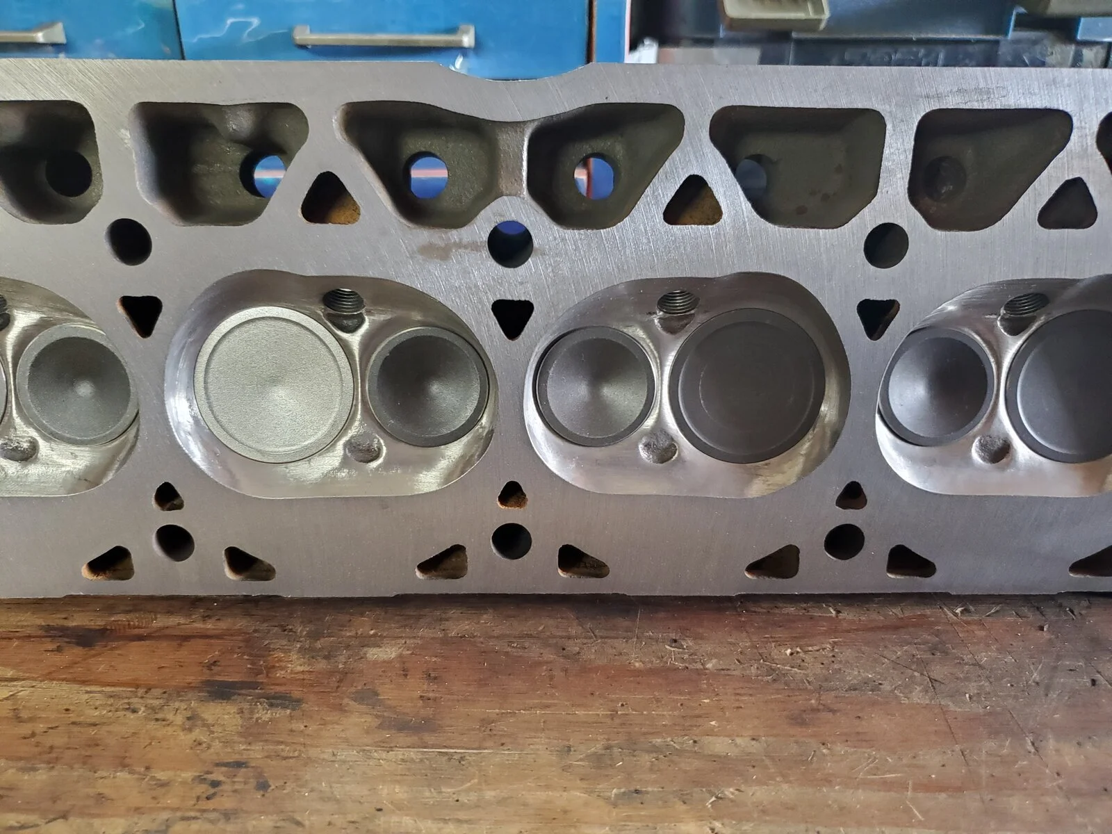

Painted the head and am getting ready to put it on. Below is another pick of the LS valve Russ put in them as well as opening up the chamber.
Looking a bit more complete with the head on. One of the head bolts go into the water jacket so it needs sealant on it.
I need to stop since the next step is to put on the roller rockers and measure for pushrod length. I need to buy pushrod checker and soak the roller rockers at least over night. Once I have the length I need to contact Russ to get them.
I heard I need to remove the baffle from the valve cover but I won't do that until the pushrods and rockers are fully installed.
