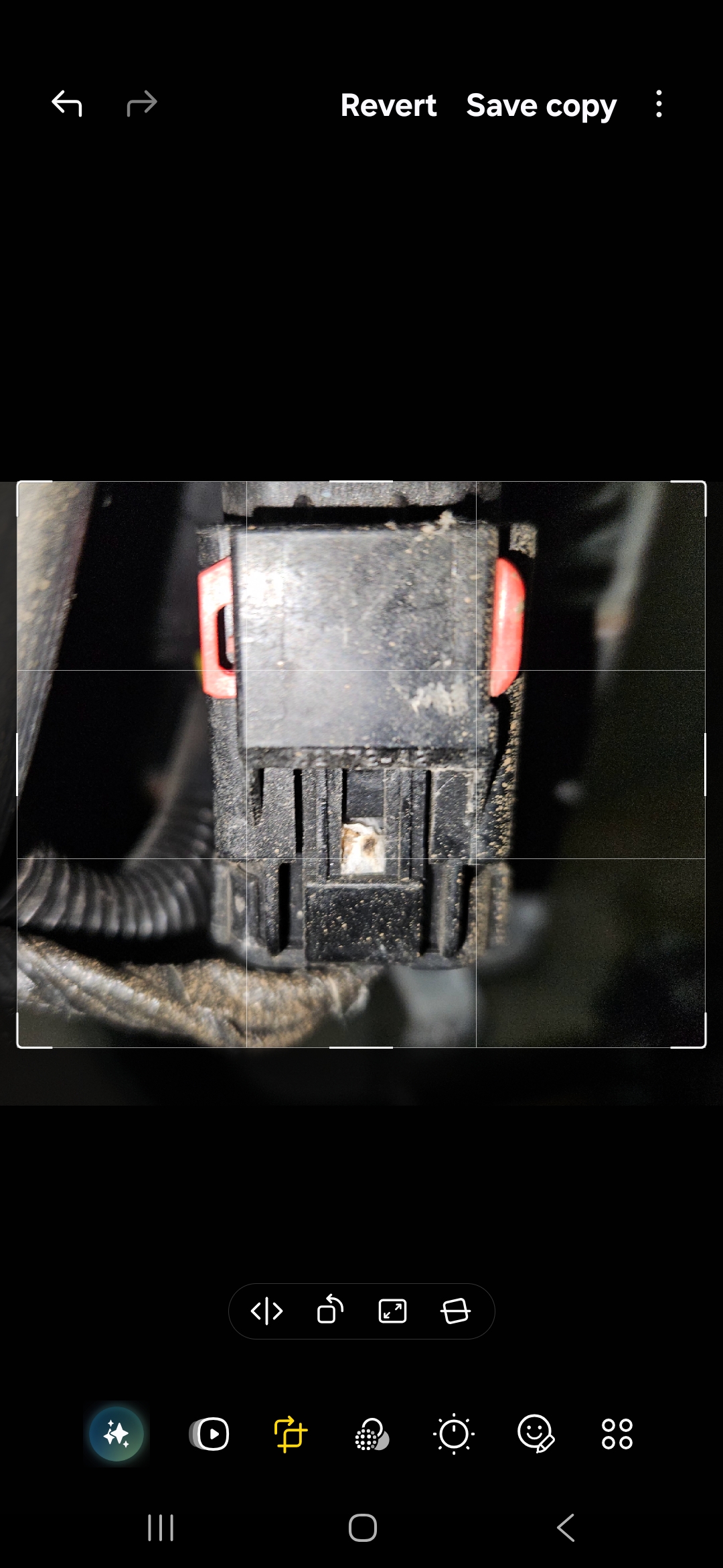

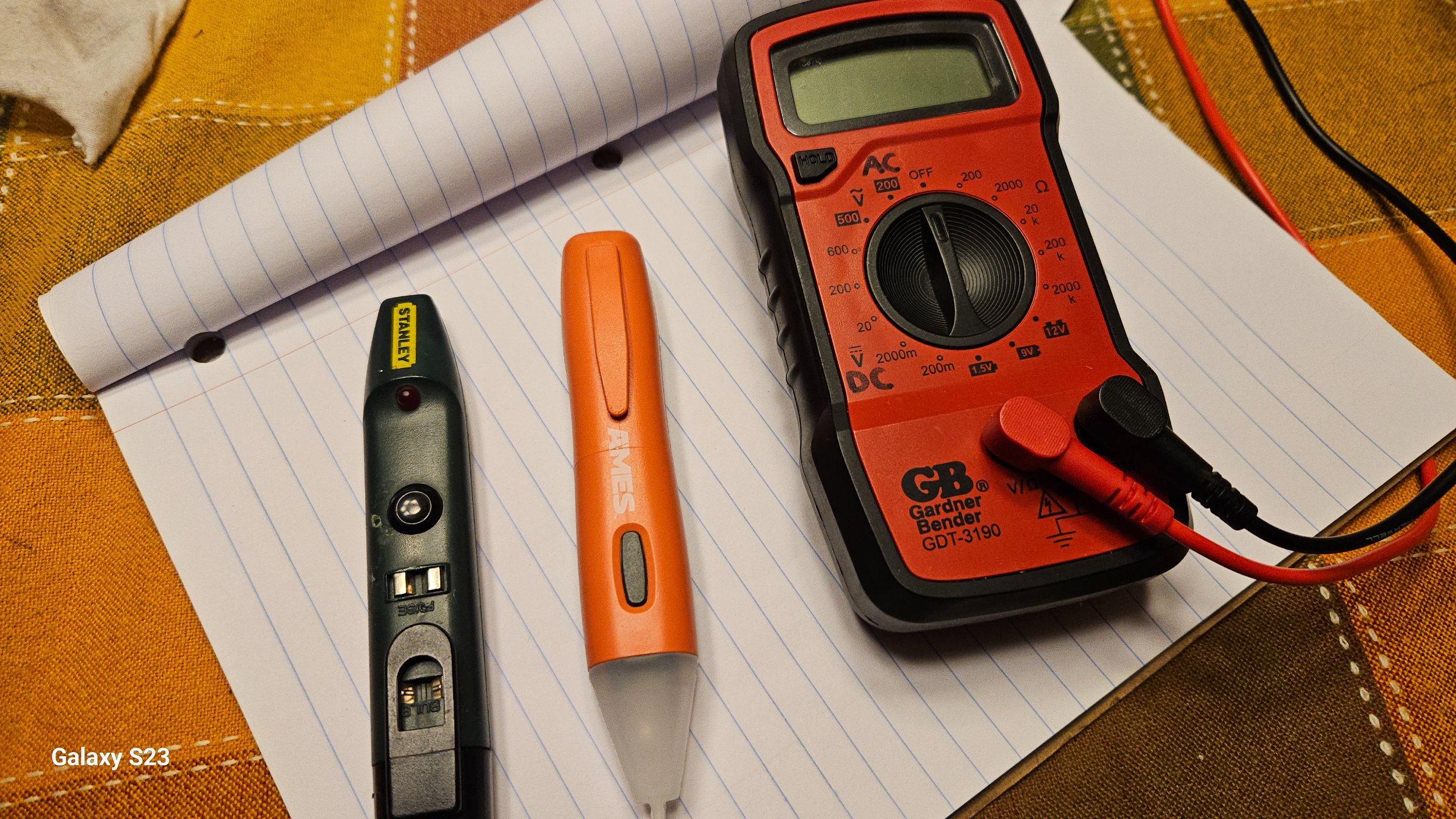

Thank you...can you tell if the red "lock" is already open? I CANNOT get it to move to either side or slide up, but if it's already open the ends aren't budging either - that could be my problem hand though. And I'm assuming I need those separate to test power. I have a multimeter and 2 other types of testers (but honestly don't know which to use, and where to poke what, and what a zero or actual number would mean).
And are you saying the switch is bad bcse it's sending power to one and not the other? I don't know how to confirm that or what to check next (it's okay to explain it like I'm 5).
This is still locked. Pull the tab to the right in your picture. They can be a pain to unlock
