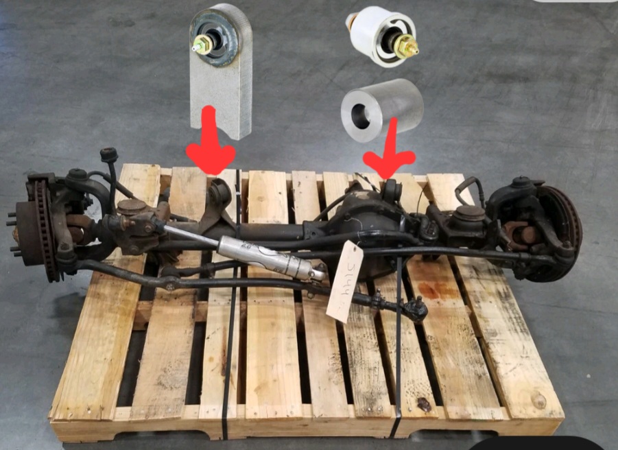

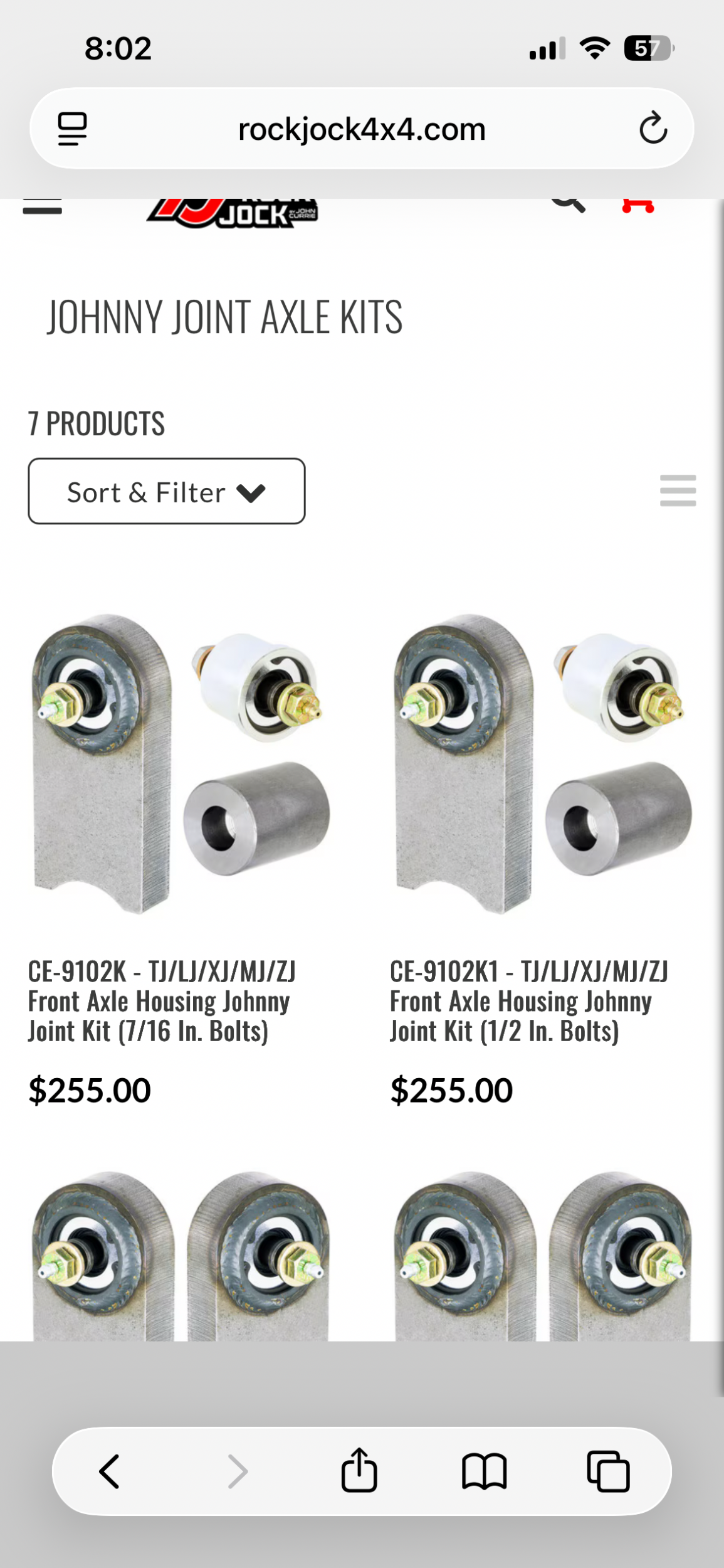

I am getting confused with what's going on. I have the Savvy Double Adjustable control arms on order. I want to convert the front axle bushings to Johnny Joints as well. This link is confusing in the description, it keeps saying 2WD. The link is below.....
https://www.rockjock4x4.com/CE-9102K2B
It also says half inch bolts and drilling out. I hate drilling the new Savvy arms though the little they are talking about isn't much. Any advice or better ways or am I over thinking it?
You need the kit with one upright and one barrel. They sell 7/16 or 1/2”.

Help me out here if I'm a little stupid lol but the one upright and one barrel is 250 bucks per side 500 for the front diff. The one I posted is both sides both barrels for 255 both sides. Am I mis reading something? Please someone tell me I'm an idiot and missing something.
The link you posted is for something like a 2WD XJ Cherokee I think. I know it lists TJ’s and LJ’s, but did those ever come in 2WD?
If you have the Dana 30 or Dana 44 front axle under your Jeep, you’ll need one of the kits with the upright weld on part and the barrel. They come together in a kit, you don’t need $500 worth, unless you have 2 axles up front. 🤔😄
