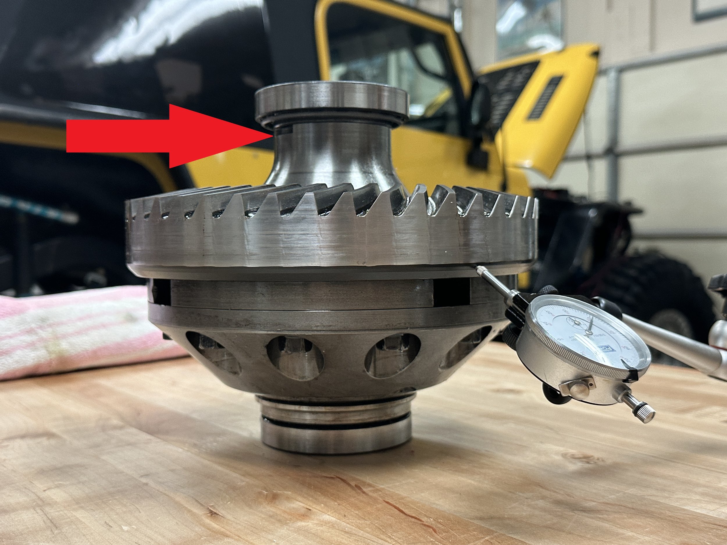

I just took a close look at the ring gear on the bench, and put it under the mic. It is dead true, but there is an uneven mark around the edge of the milled (shaved) surface that makes it look like it's wobbling in the video. At least it's not wobbling as much as it appears in the video.
But, if the bearing was off center by 7 thou, maybe it was wobbling enough to bind the bearing, and make some noise, but likely not enough to see in the video.
Spending some more time with the high-def video, I'd swear I'm seeing a bit of up and down movement, exactly in time with the rotation, right here:
That explains the video wobble. The lines in the metal extending down from the roots of the gears are interesting. Are these things made by some type of hot forming rather than being cut from an unmanipulated block of steel (probably not using the correct terms)? I think I recall splines on axle shafts can simply be cut or they can pressed into heated metal and the latter is stronger.

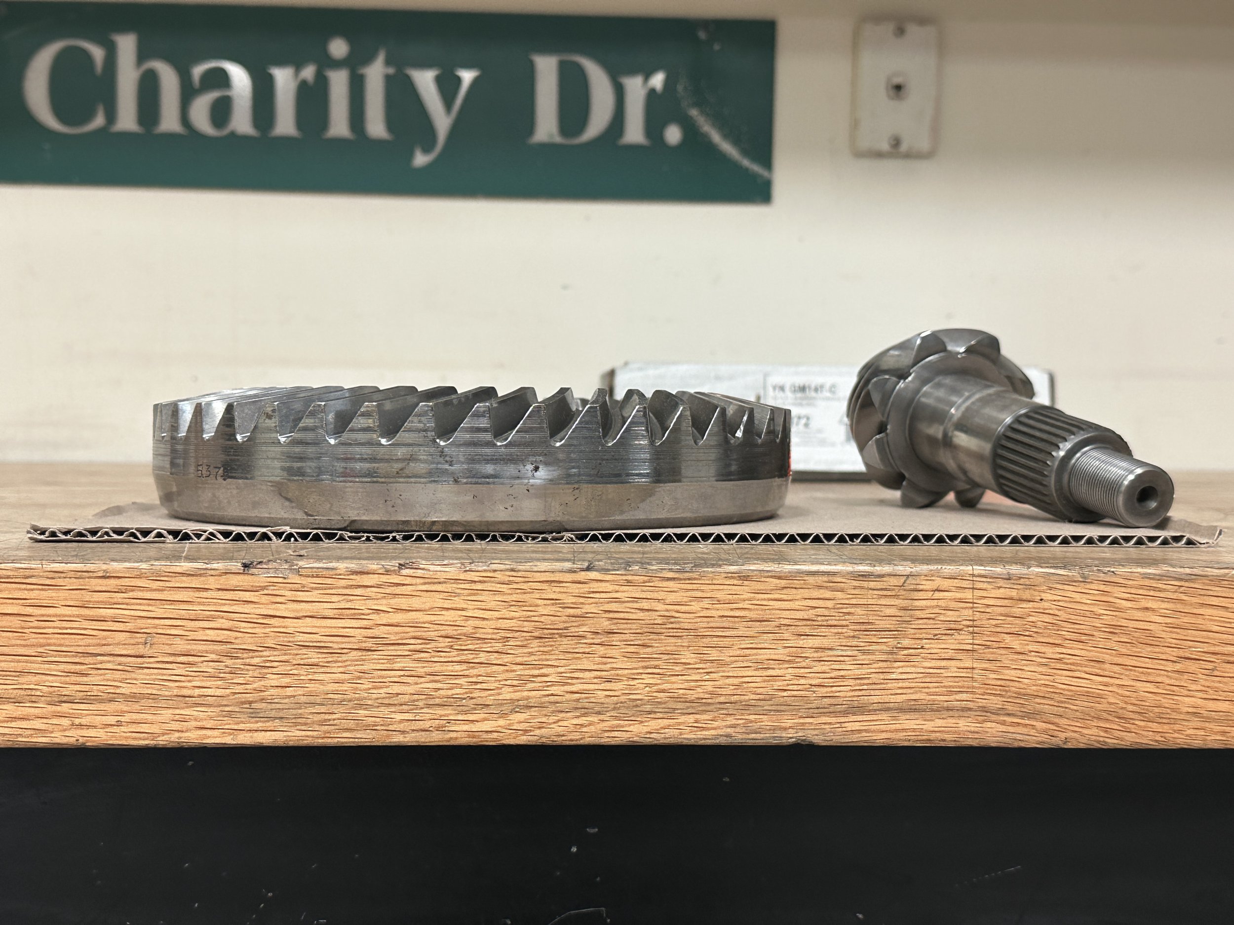

No idea. Since they are Yukon gears, my guess is that they are not manufactured using the most sophisticated processes...
In comparison, the Crowne Racing gears do not have that feature:
