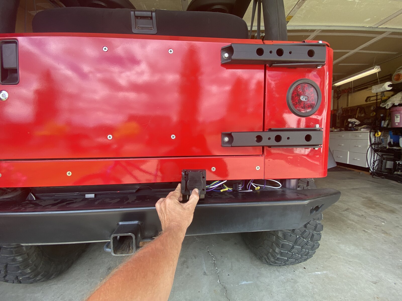

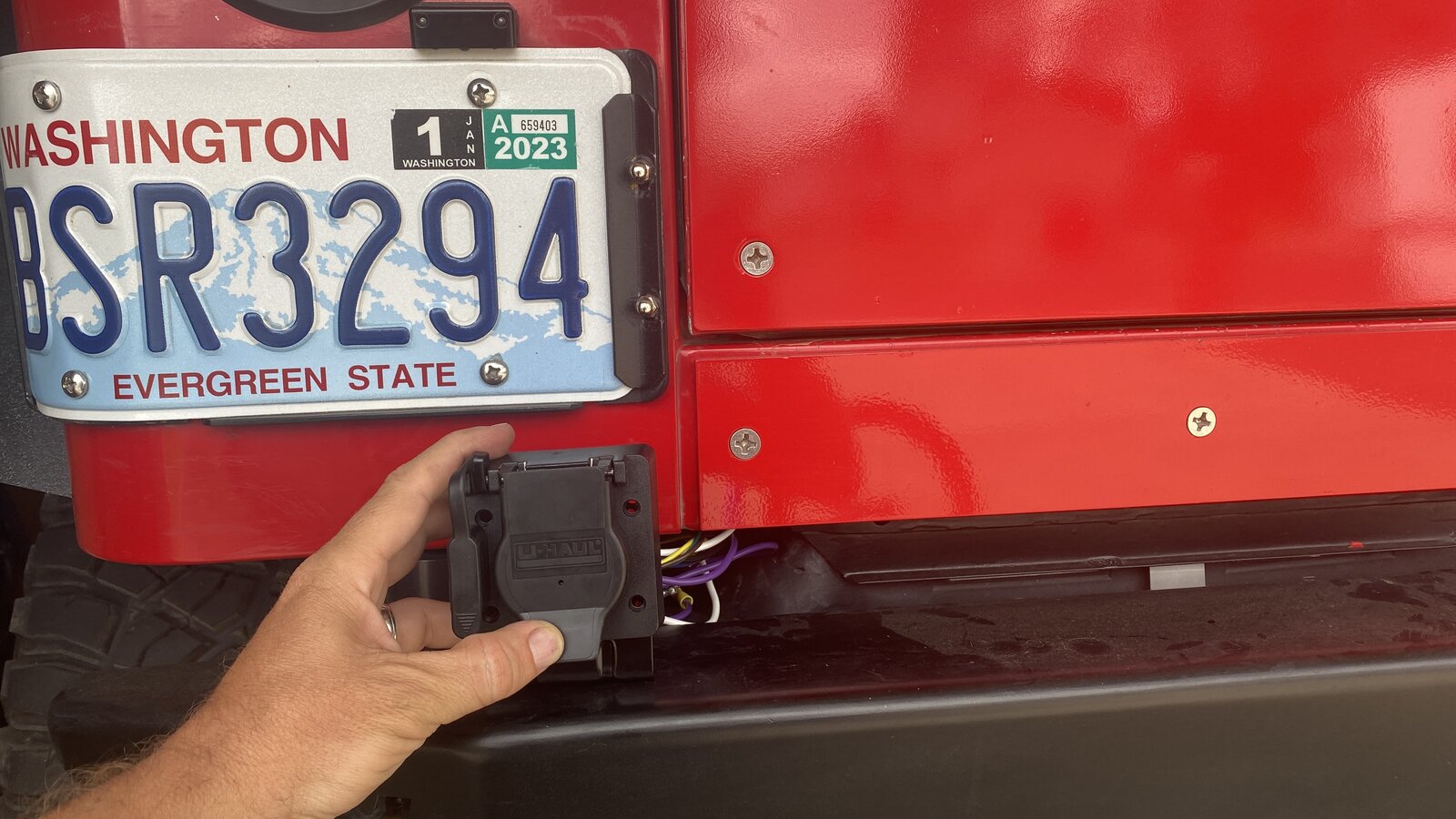

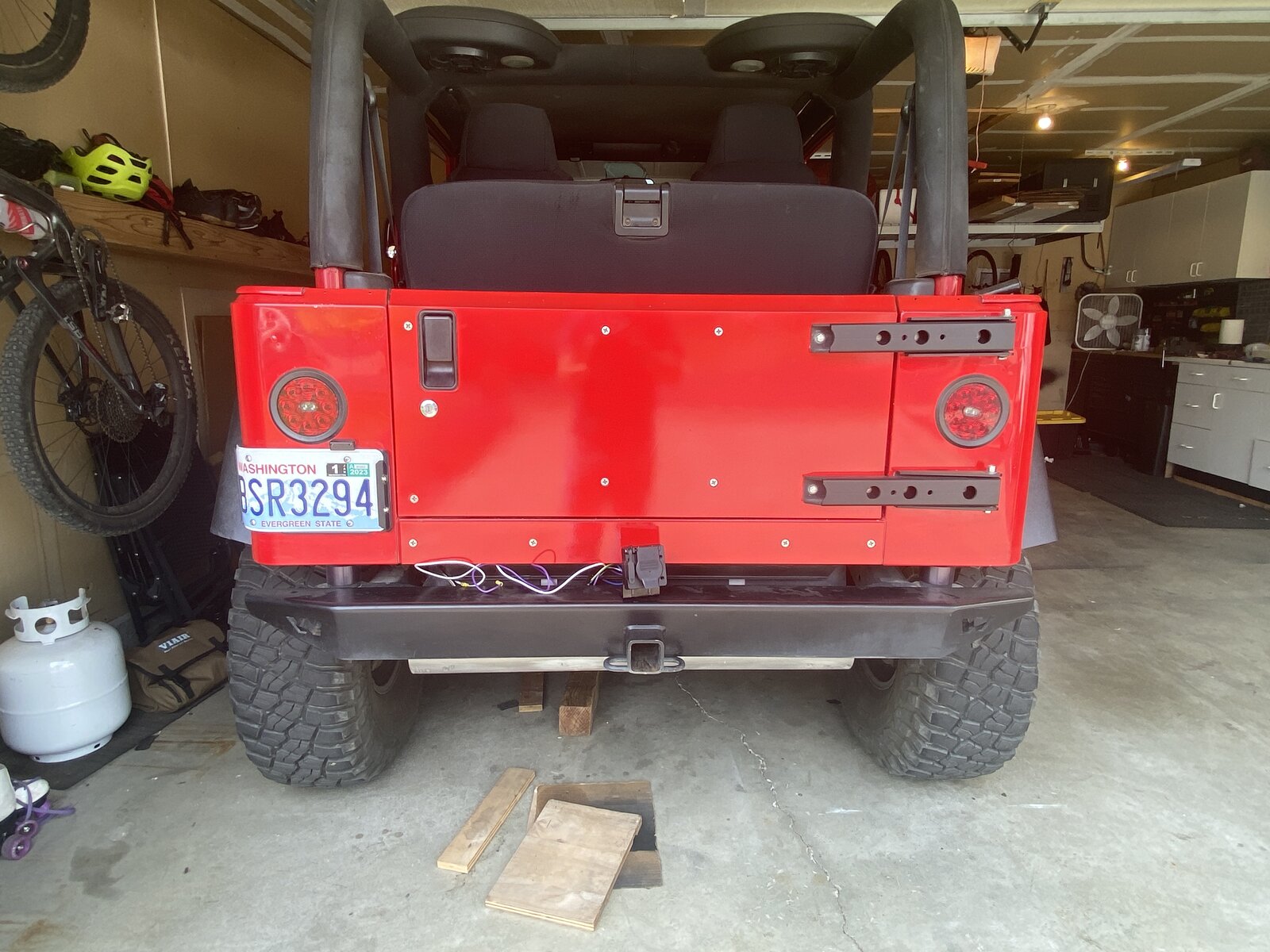

Where should I mount the 7-pin harness? This is all I can come up with so far. 1.25” BL, but not enough space in that gap to mount it. In the location pictured below I could remove it when not needed. Still, drilling a couple of holes in the top of my bumper is not my favorite idea. At least it’s not under the bumper where I’ll knock it off!

Hard for me to recommend anything, I ground off my trailer pigtail on rocks and haven't replaced it :D... that said it's kind of a personal choice I'd think other than what you already said, somewhere it won't get hit. Doing it to the side like that, just be aware to have enough cable to reach when turning right, you have to make sure it's not so long it'll droop/drag when turning left, which is why most are mounted more centrally.
Reactions: reddvltj and JMT
Hmm….maybe just be safer and mount it more centrally. Sucks. I don’t like any of the mounting positions. Maybe off-center right so it’s more out of the way when opening the tailgate.
Dead center might look less conspicuous. 🤷‍♂️
  • Sad
Reactions: reddvltj

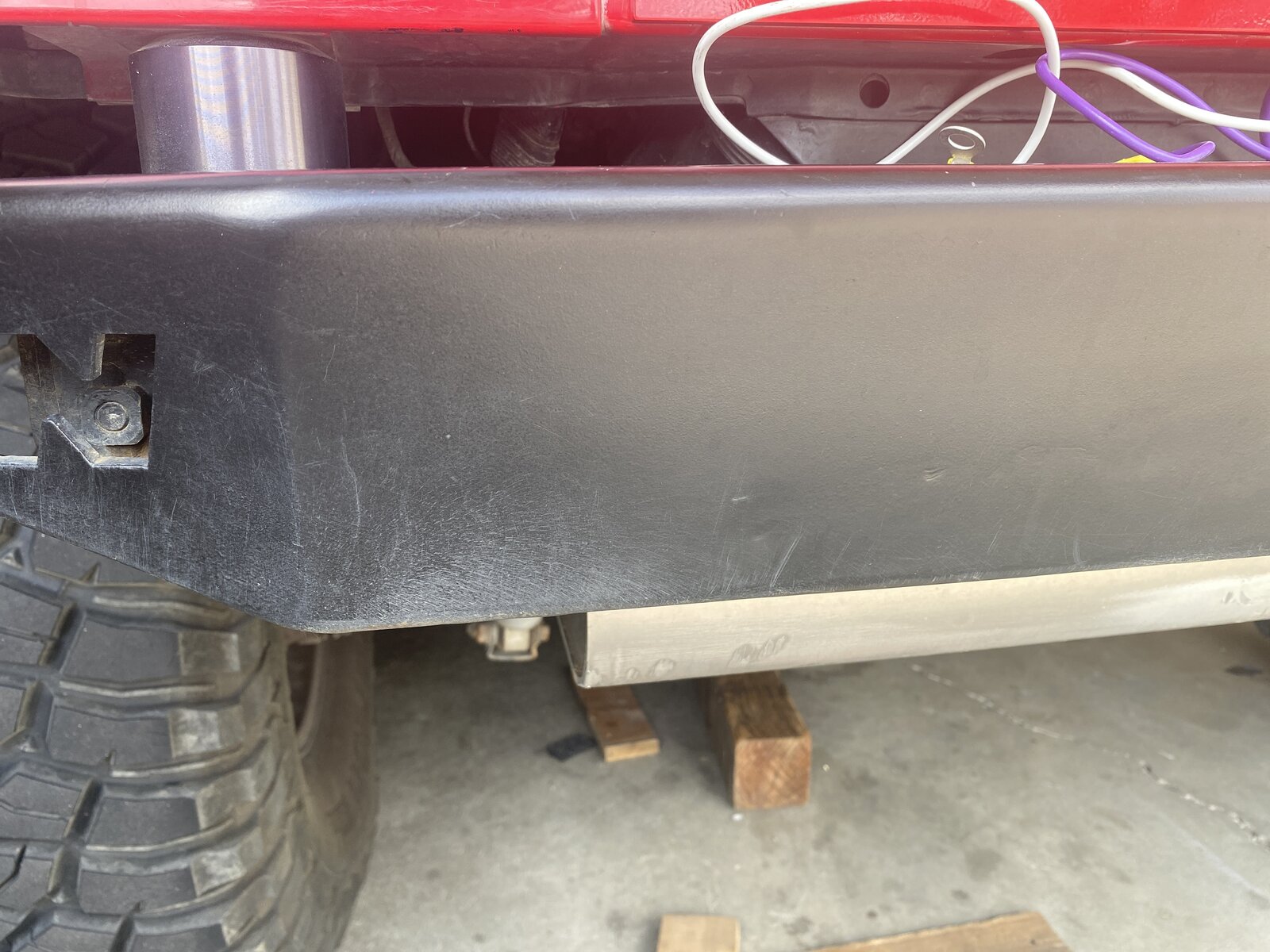

Sink it into the bumper
Thought of that. It’s not completely out of harms way there. Note scratches going up the face of the bumper. Thought about sinking it into the receiver, but same problem and worse. Recessed it will stick out 1 1/8”.

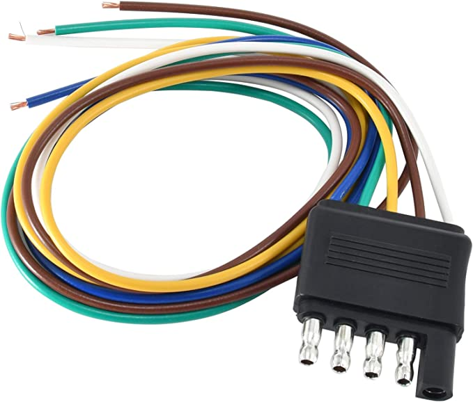

If you're not too far along at this point It would probably be easier to make an adapter that plugs into your flat 4 and the 5th wire with a long enough set of wires so that you can just plug in the 7 pin on the tongue of the trailer and secure it there.
Edit, you could eventually make an adapter using something like this wired to your 7 pin that would normally mount on the tow rig. Notice the 5th wire is blue... for brakes!!:D

Use your existing flat 4 (or you could swap it out for a flat 5 that has the additional wire for the brakes), get a trailer side flat 4 and a quick connect for the 5th wire. Take the pigtail (trailer side flat 4 and additional wire) and wire it to the (truck side) 7 pin you have in your pictures. All you'd be making is a plug in adapter to a 7 pin that can reach the tongue of the trailer. Then when you get where you're going just unplug the flat four and 1 quick connect wire and the adapter stays with the trailer.
I've got a few home made adapters in the shop that I can brake out tomorrow and give you a better visual of what I'm describing.
