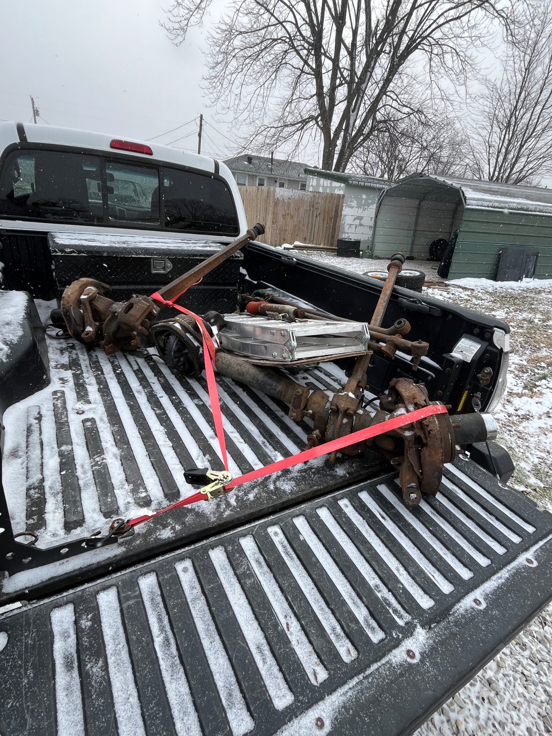

I picked up a 44HP today. It’s a cast wedge axle, but I just got it for the 5 lug parts. There’s a nice 8 lug one a few miles from home that I’m going to pick up and swap the parts over. I’m hoping I can put the 8 lug stuff on this one and recoup some money.

What width are you shooting for? The 8 lug HP44 might be a full width 69.5" WMS compared to the 65.5" WMS of the 5 lug Hp44. But I could be wrong.

It’s my understanding that if the outer knuckles are switched out how I’m planning the WMS width will only be 1/2” wider than the factory 5 lug assembly. 65-66” is perfect for me.

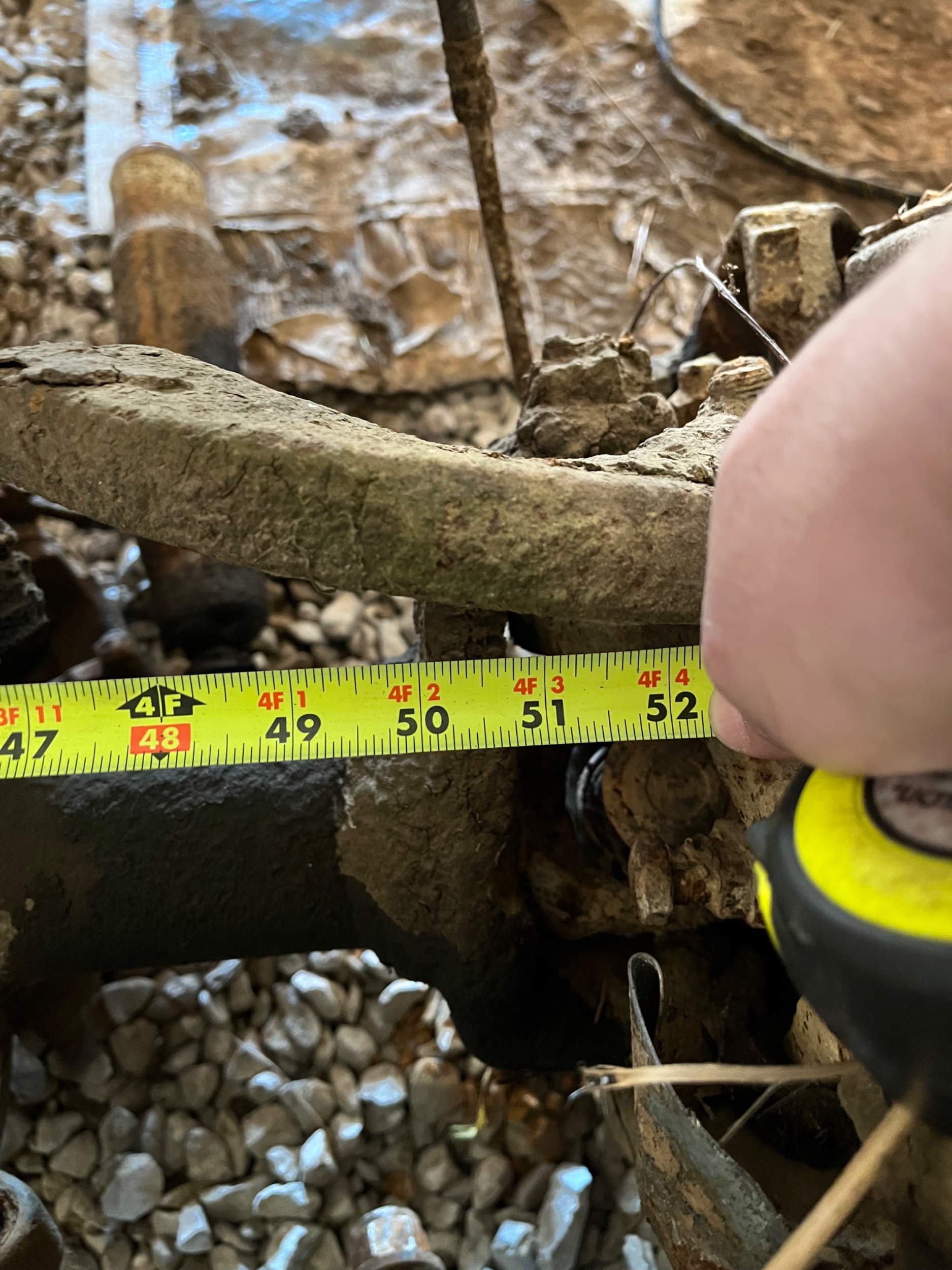

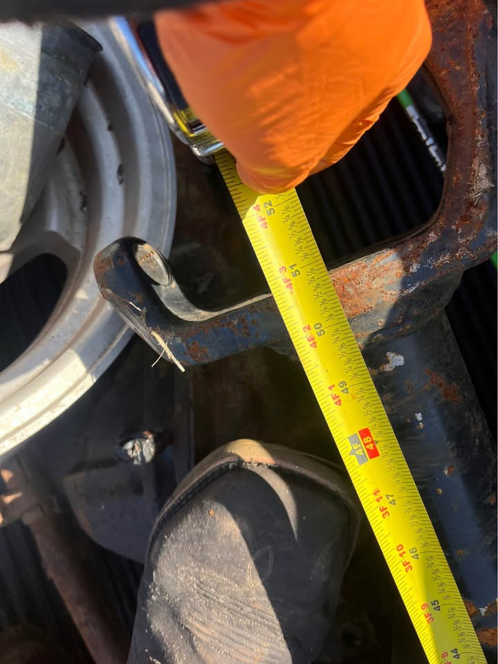

I ran by and checked out that 8 lug again. I got a measurement of the width at the ball joints and will compare it to the 5 lug one I already have. Dana 44 inner Cs should be the same, so if the width is close it should work

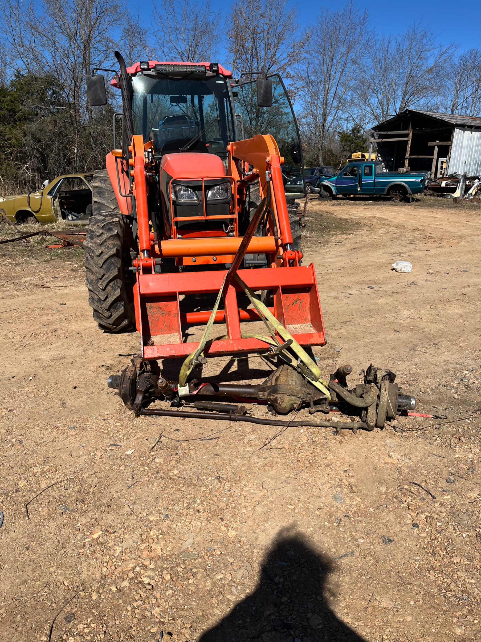

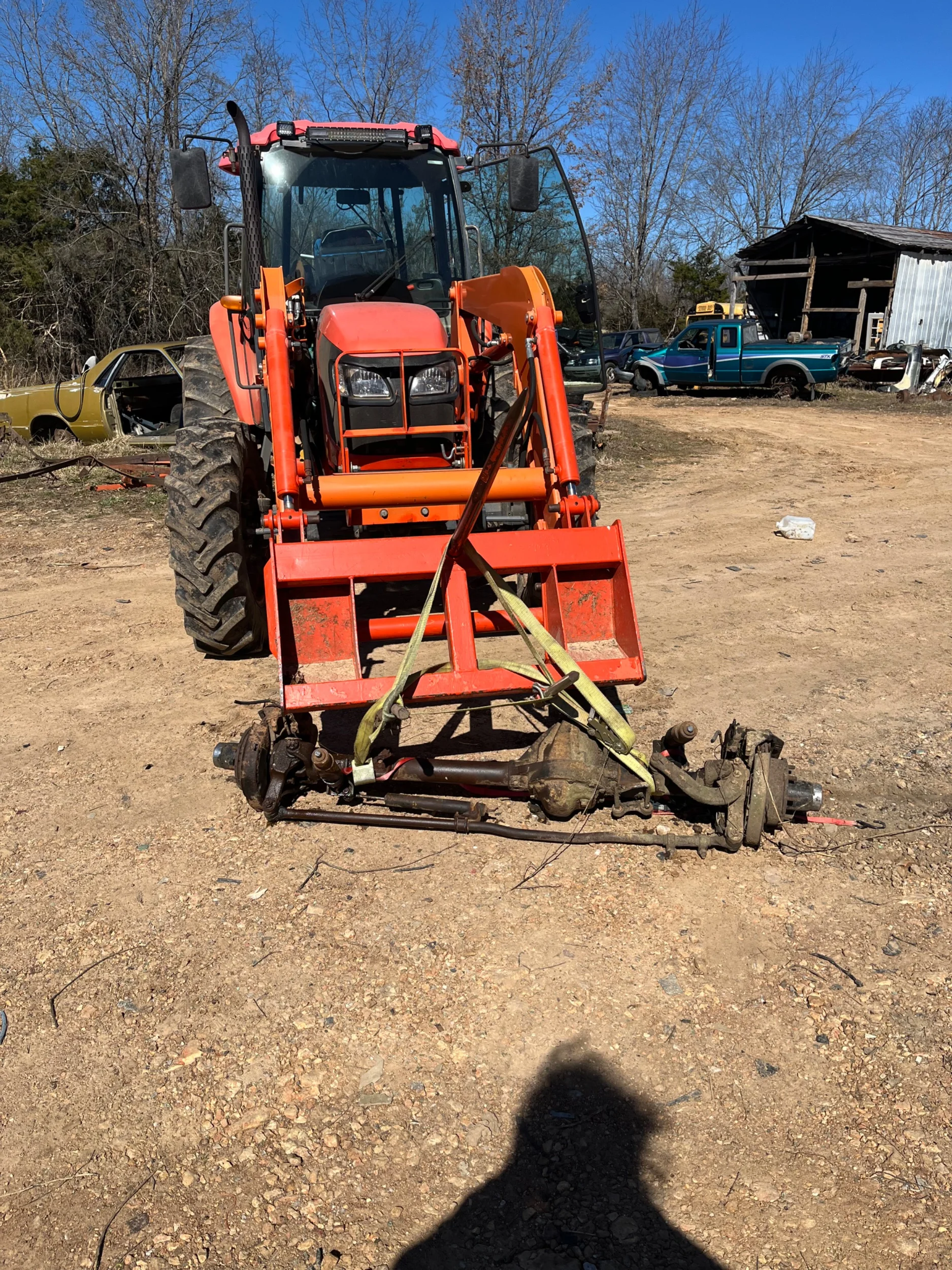

It was tough to measure both, but I got them as accurate as I could and it seems the upper ball joints are within 1/2”. I’m supposed to get it next Friday (I have to pull it myself and will have to bring my tractor to lift the truck and that’s as soon as I’ll be able to do that).

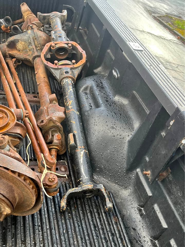

That axle turn out to not be a high pinion.... Which is a bummer...

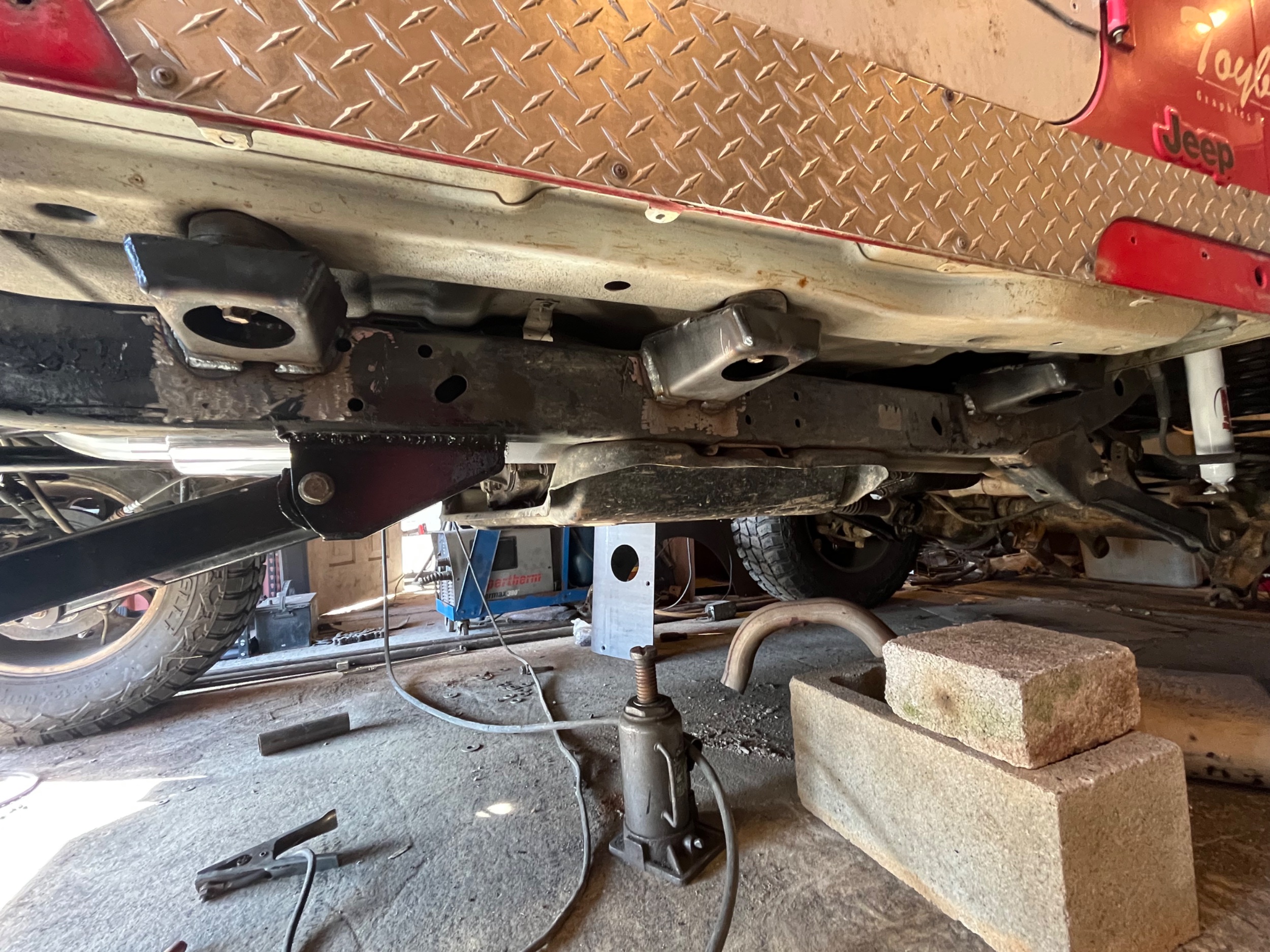

There isn’t anything really to show today, but I did just finish the motor mount lift install. I’m either going to use an aftermarket belly up skid plate or fabricate something on my own down on the road.

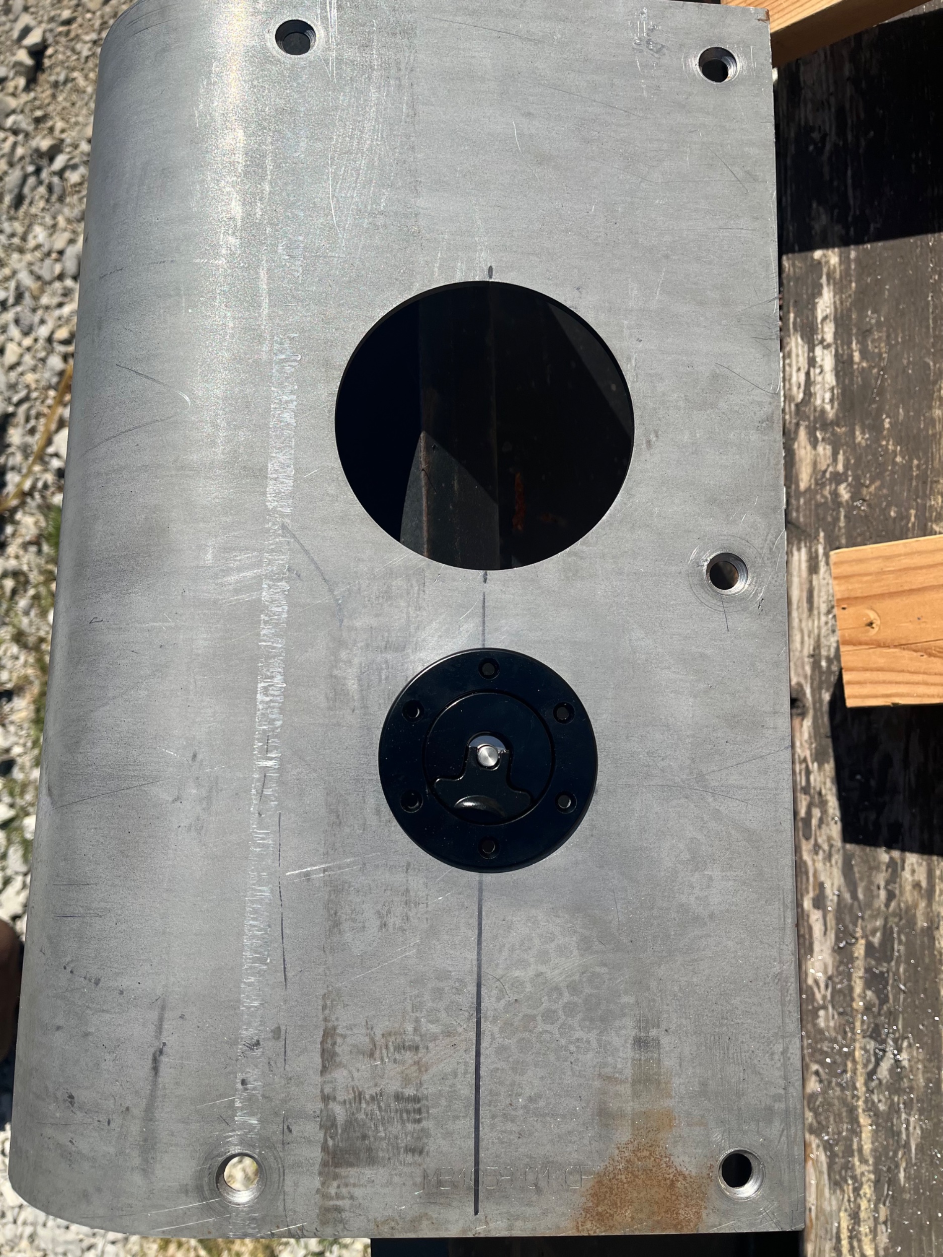

Another small update. Got my filler in the other day and just finished drilling the armor for it. I’m trying to prep the armor and tub for paint.
