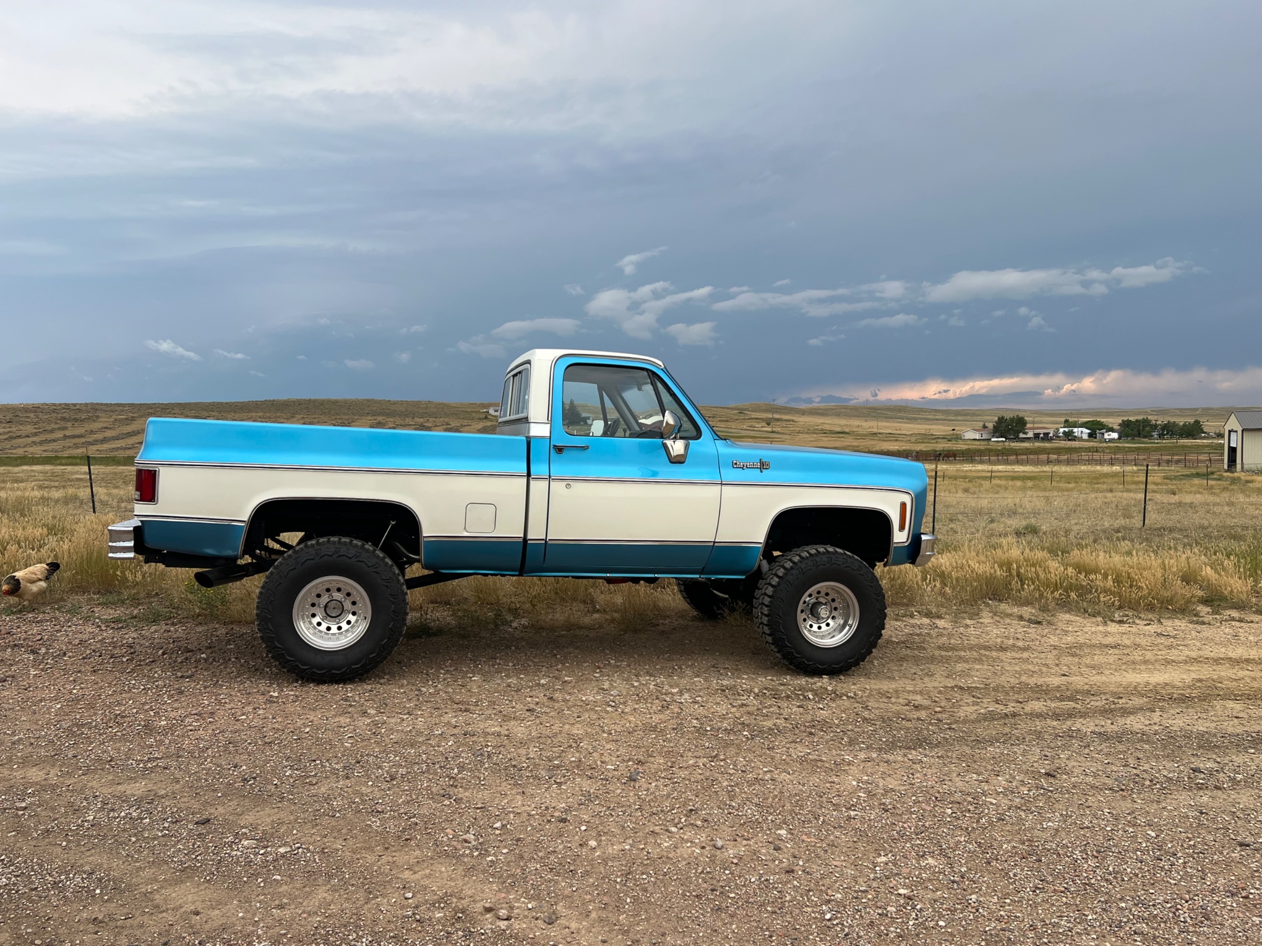

My 1973 K10 Chevy Cheyenne
Question for you folks:
I'm really wanting to swap a manual transmission in this thing. I suspect since it's a column mount shifter I'd have to cut a hole in the floor as well as get a clutch pedal and a few other things. I need to figure out what I need and price it out to see if it's worth it or not.
Let me ask you this though, if I did do a manual swap, what transmission would you install?

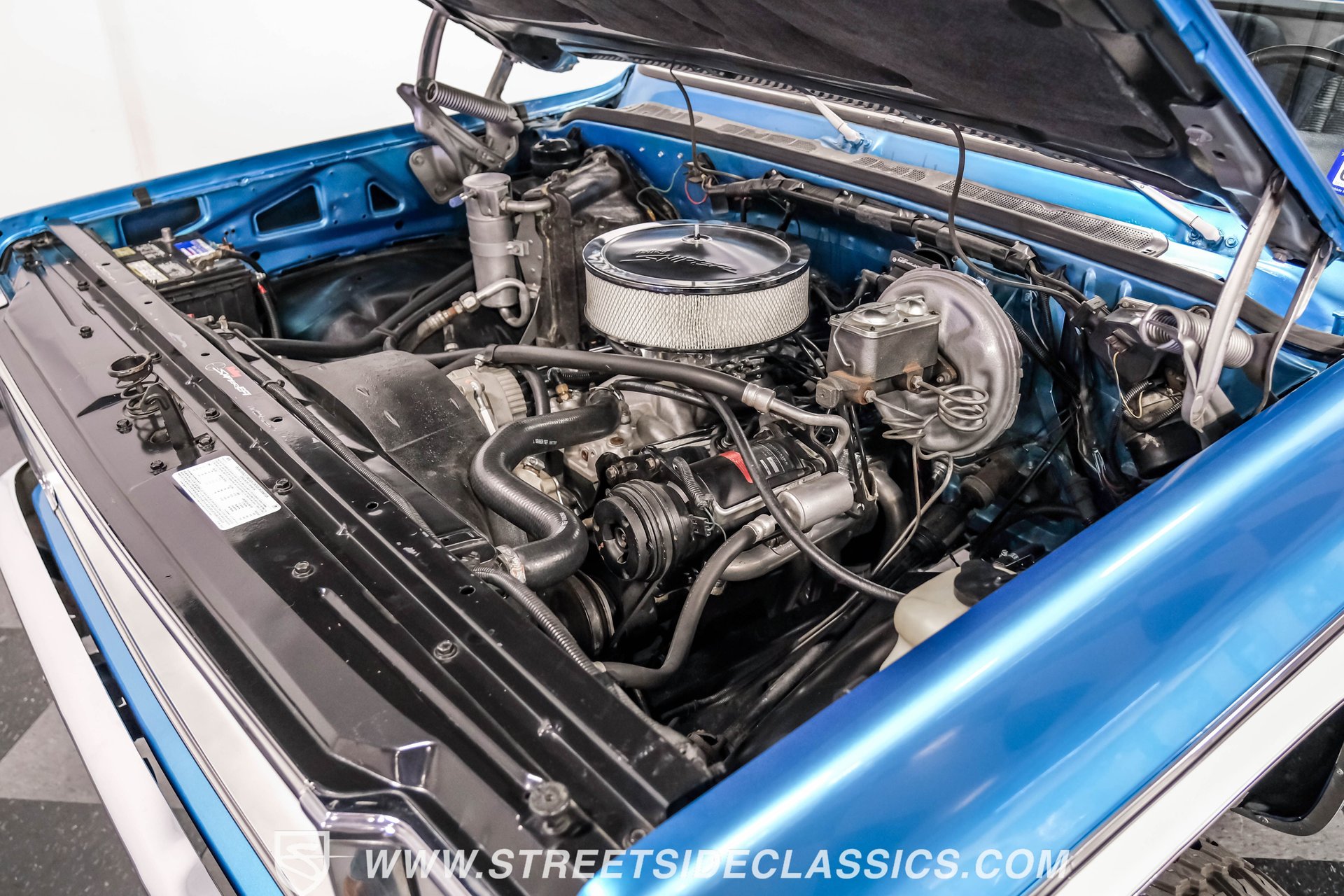

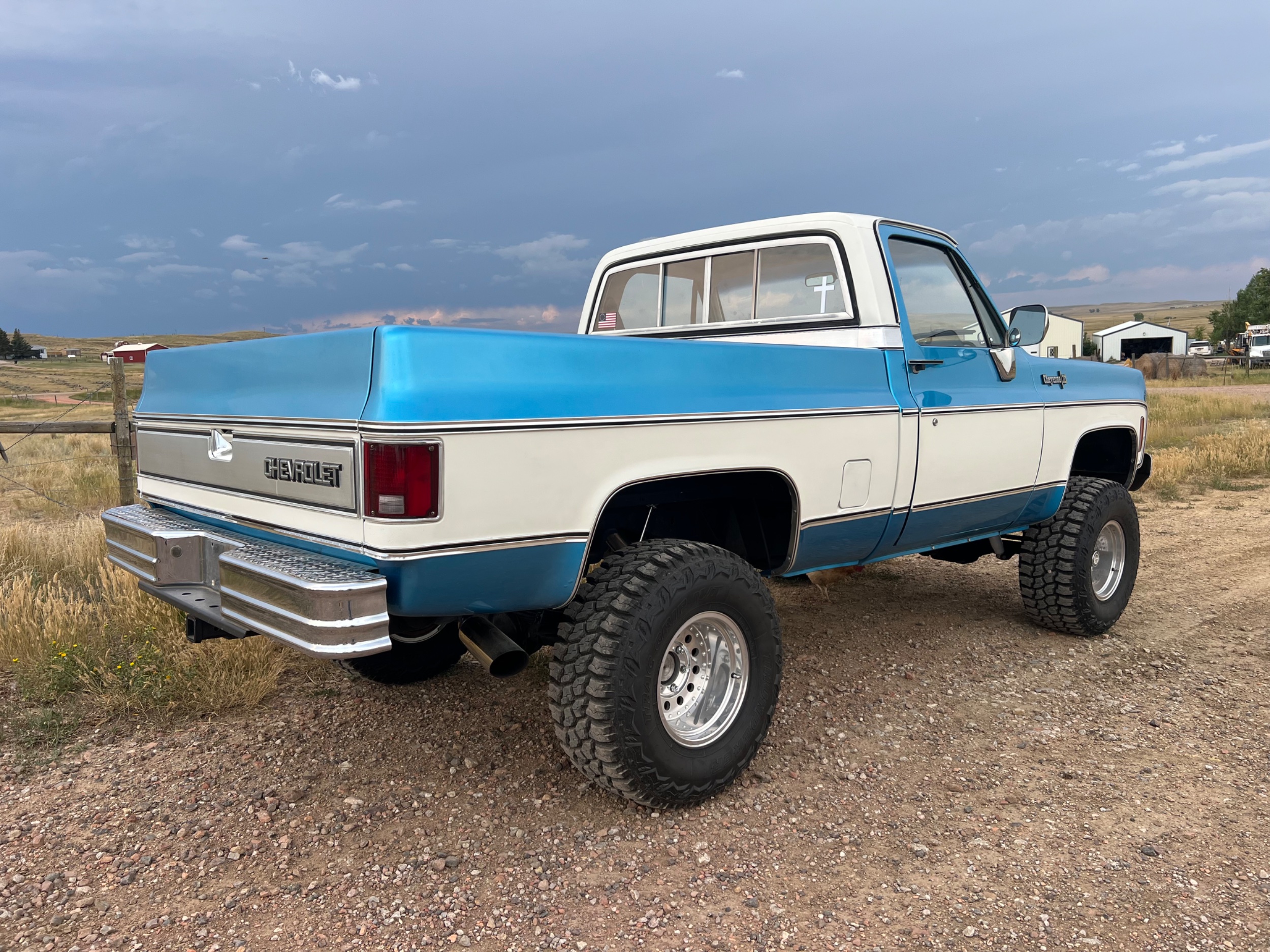

As you can see, it's got factory A/C including a period correct compressor.
I've got to figure the A/C out though. It blows cold, but not likely as cold as it should. It might have a leak or something somewhere, I'm not sure.
