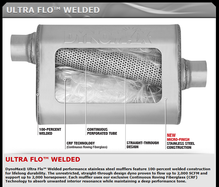

Magnaflows are nice, but likely out of your budget range. For your budget, DynoMax is a good option. https://www.dynomax.com/

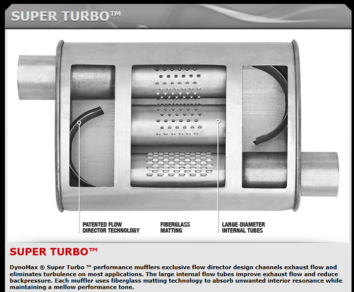

If you want more rumble without drone, a turbo-style is a good option.
A bigger "Ultra Flo" will be somewhat of a gap filler between the turbo style and traditional glasspack. Bigger muffler body = more decibel absorption
