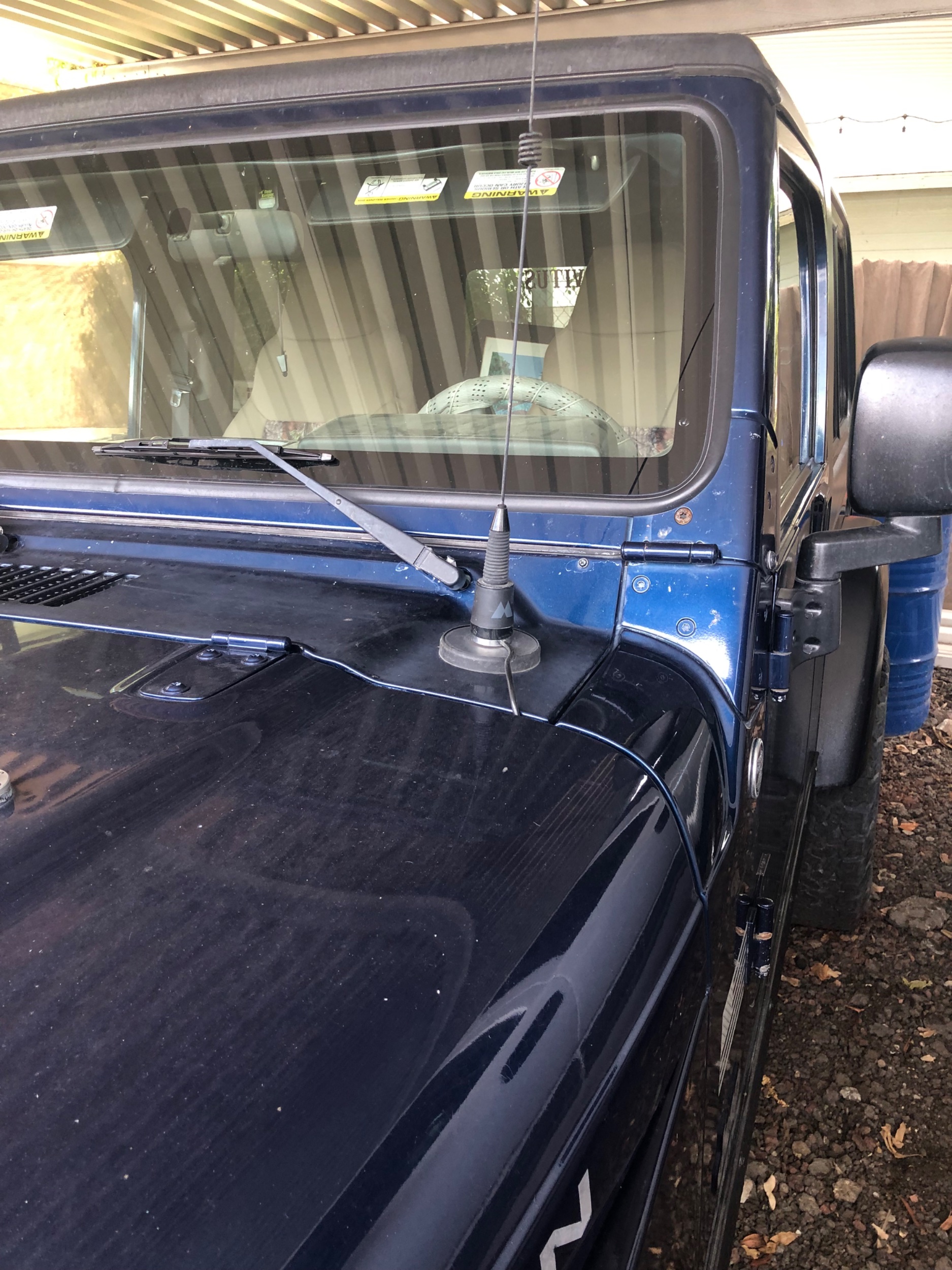

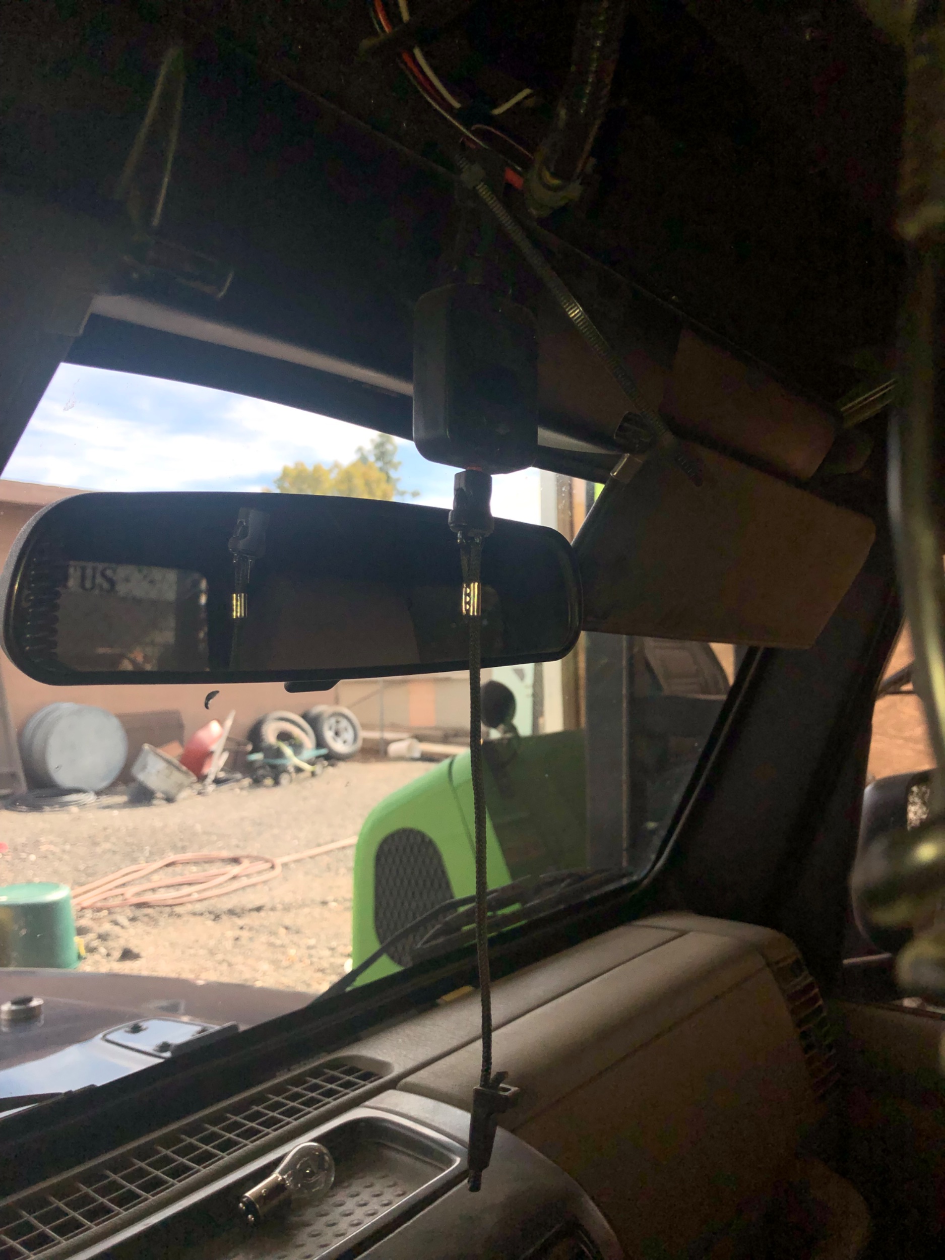

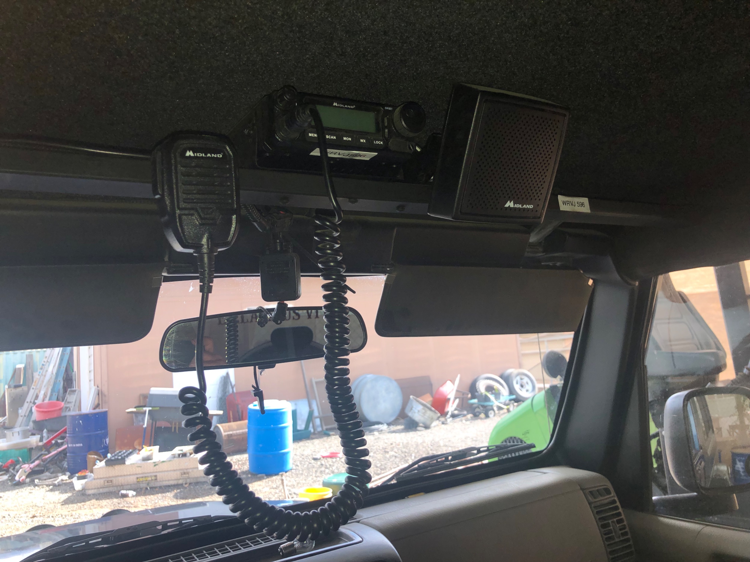

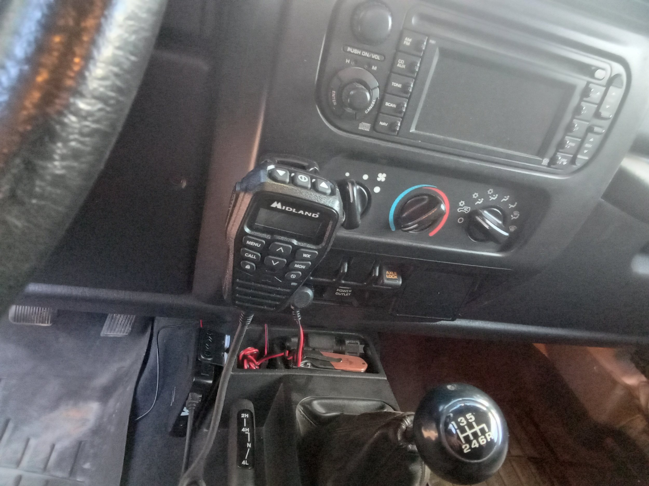

My MXT500 is mounted above the windshield along with external speaker. Mic clip is on the mounting bar and I have a retractable mic holder on the mirror when using on the trail. The down side of this placement is the cable hangs down in your vision. I tuck the mic cable over the bar when not in use so casual observer can’t tell it’s there. I also have a magnetic antenna mount on the hood witch allows removal. Power is direct to the battery due to the 50 watt power of the radio.
