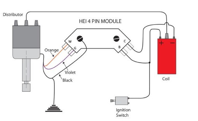

The hei from the 250 will fit amc 6's if you use the distributor gear off the amc.
Reactions: Blondie70
No need to use a Chevy Dizzy,
The AMC used Dura Spark ignitions.
Simple to modify to HEI Module.
When i have a worn out cj or yj dizzy though,its an easy choice to just get a chevy hei style distributor and run the coil hot and tach to it. I've done it several times.no worries about a suitable heat sink for the module.but thank you for the diagram and option. I didn't know that
