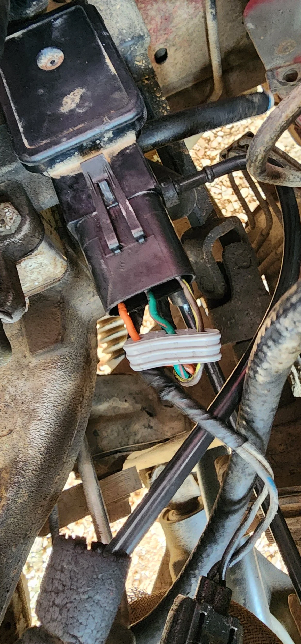

Would any have any links on how these map sensors are supposed to read? So my 97 2.5l is an early model 97 meaning it takes the round pin map sensor. I'm having connection issues in the plug and cannot replace the pigtail (they don't make them and we're discontinued.) The later model tj's had a flat pin map sensor and I can find those pigtails/sensors all day long. Would anyone here know how these sensors read that way I could study up and see if I could just wire in the flat pin sensor? Also, does anyone have any links on how the map is supposed to read on a volt meter? Thanks.
