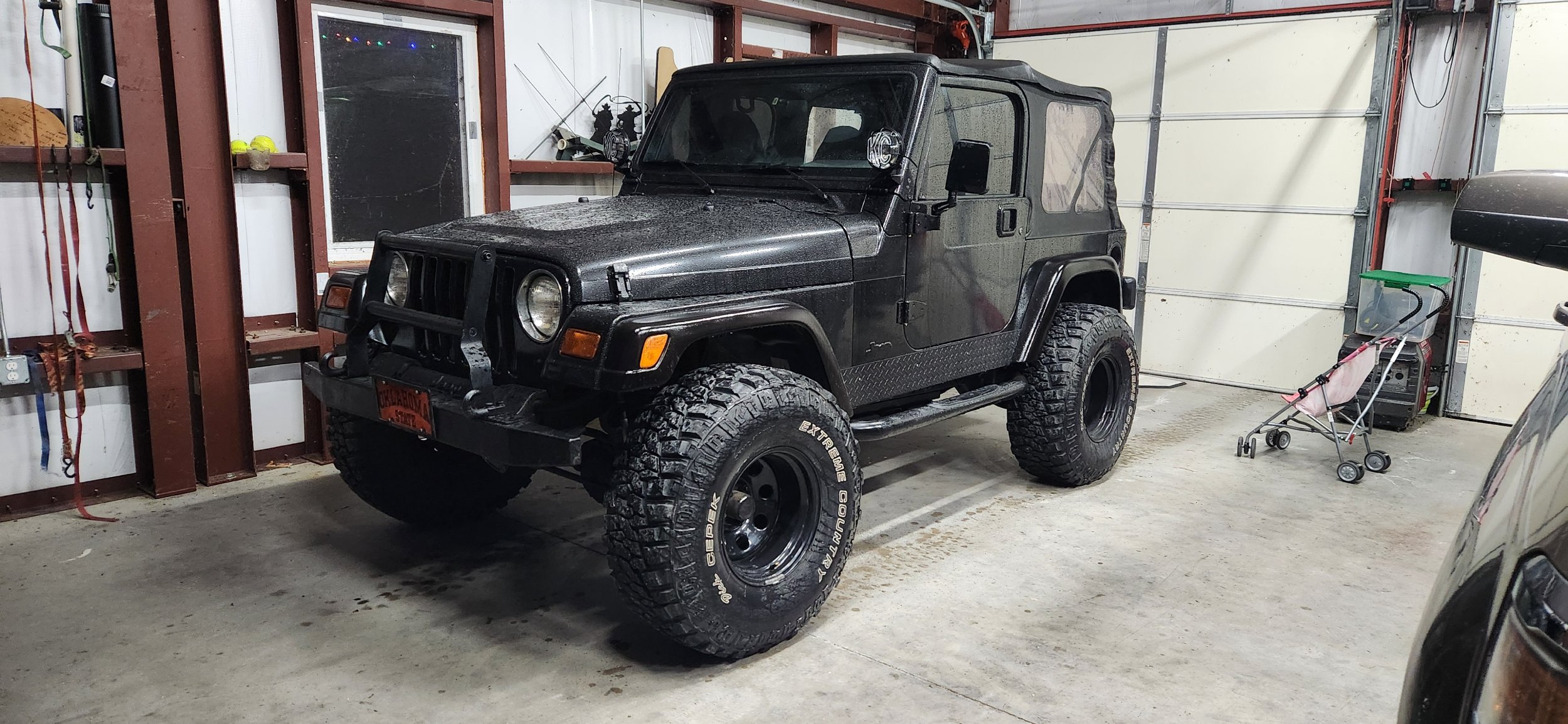

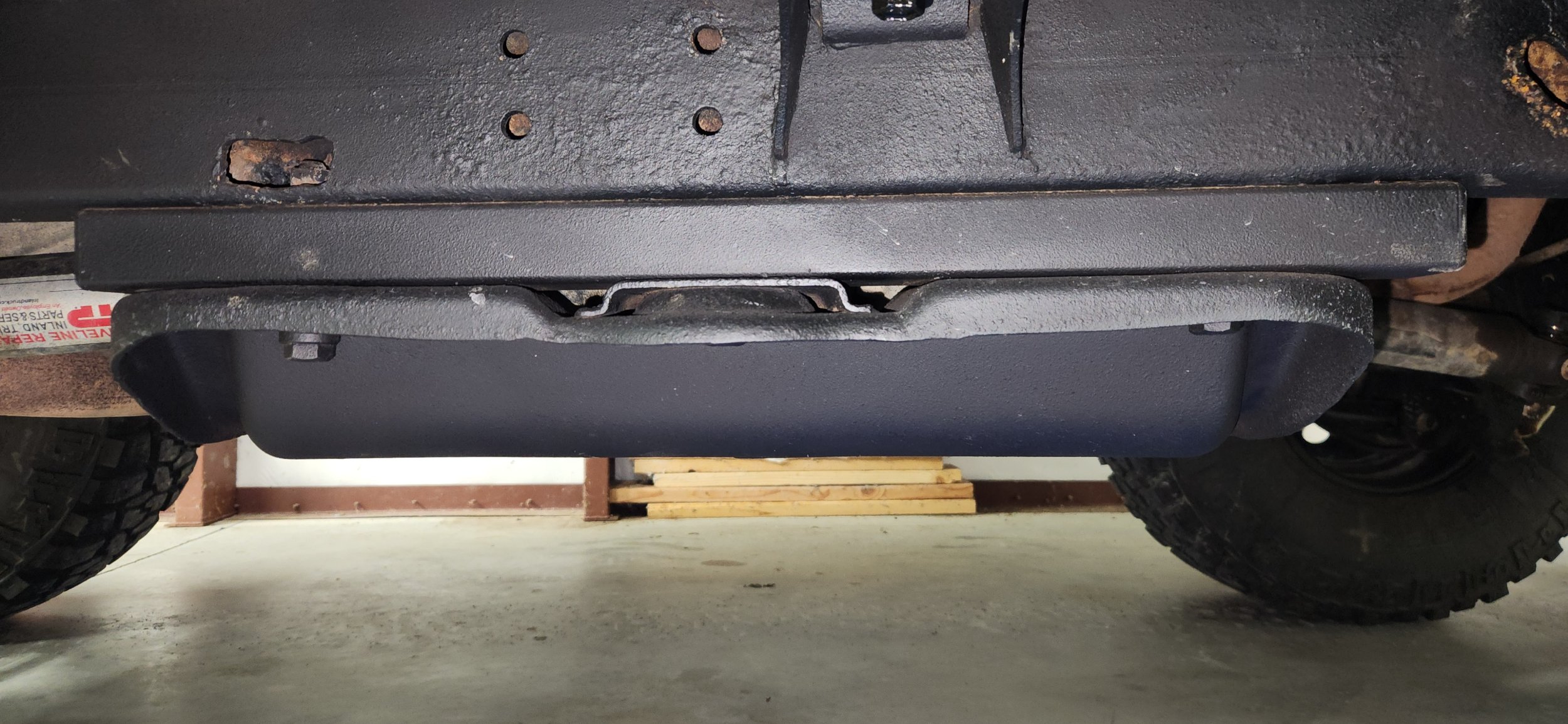

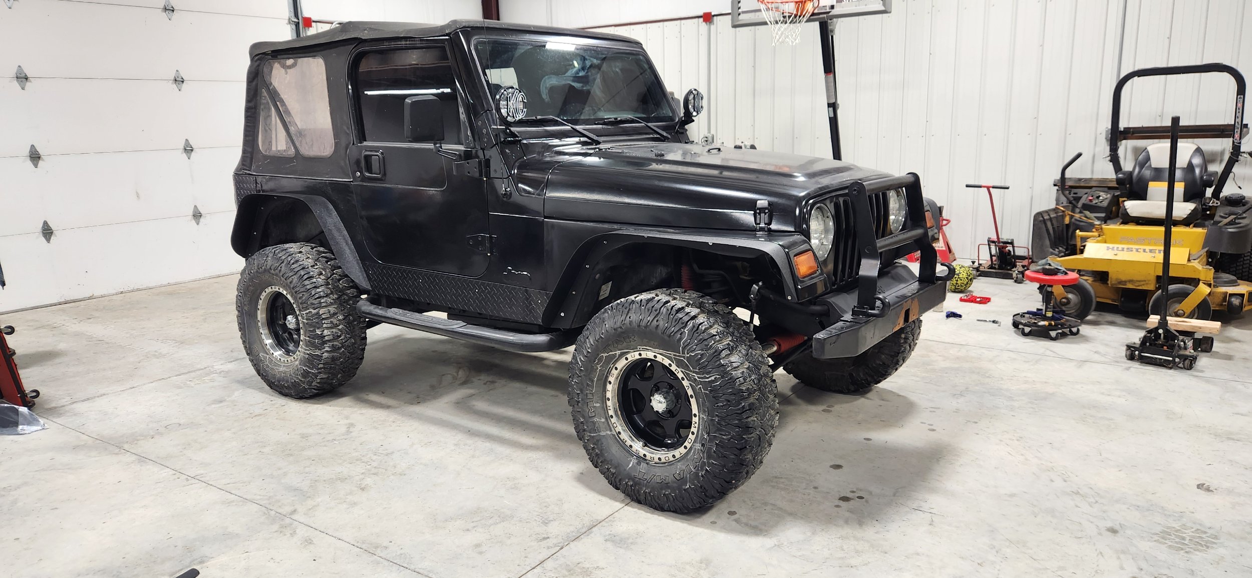

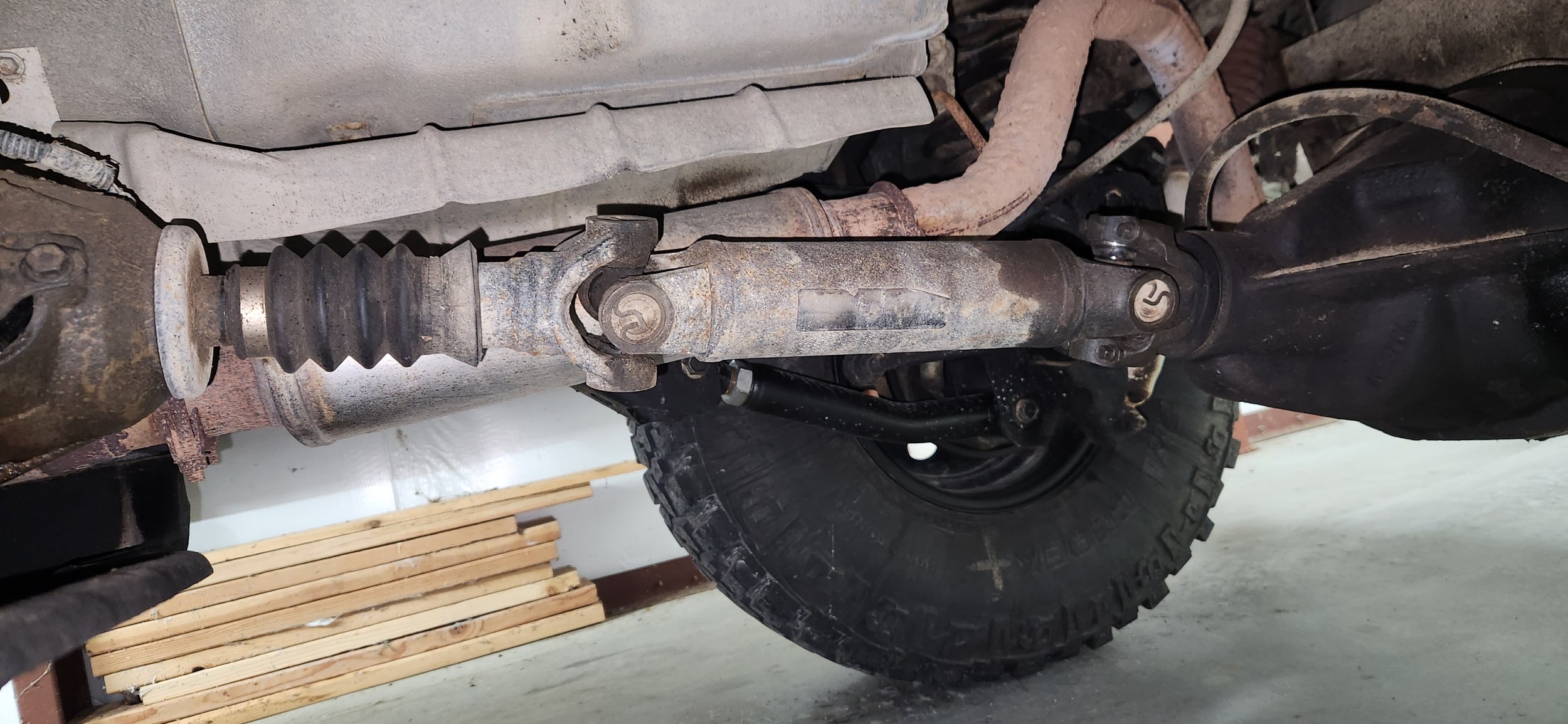

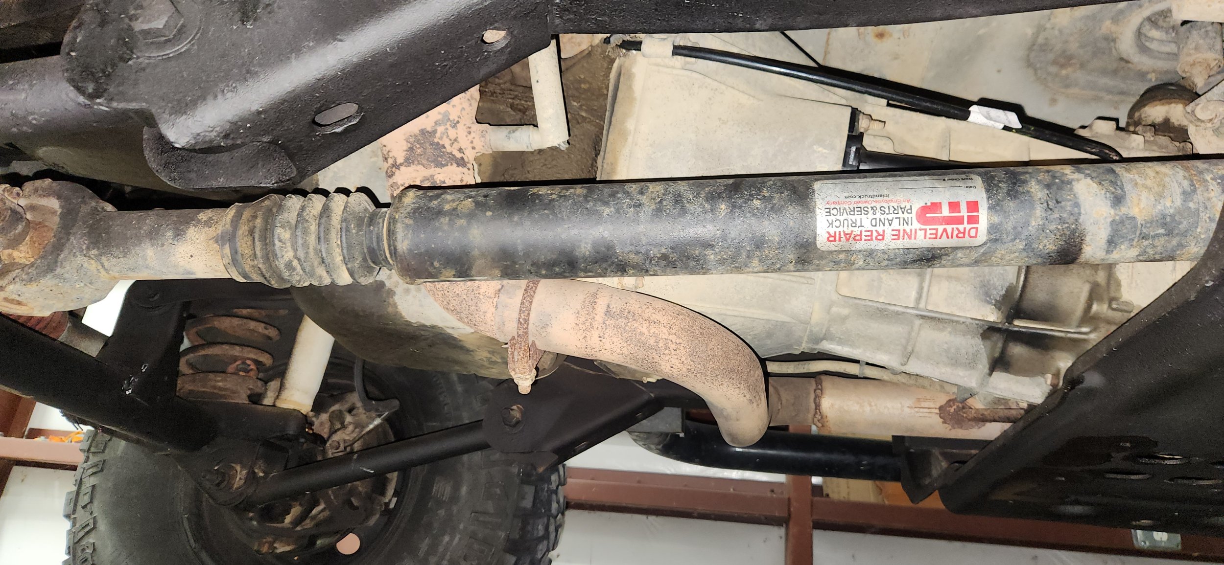

Hey guys I've only been on here a short time and yalls advice, knowledge is insane! I bout this 97 tj as something to tool around in, I only gave a 5k for it knowing it had been wrecked and rebuilt. It has a 4.0 and an ax15 5 speed. I'm looking to swap the 35s for 31s.....I dont mind the 2.5in coil lift, I noticed I ha e a little vibration during acceleration, I see it has some shims to lower the transfer case, also see pics, the 4wd linkage is messed up...best way to fix it? Cable? Vibration? Try shimming some more?
Im curious what you mean by vibration when accelerating. Where do you feel it? In the gas pedal? The floor? The whole jeep?
Recently had someone do some tranny work on mine and I think they may have put the transfer case back in incorrectly and messed up my angles. Thanks
