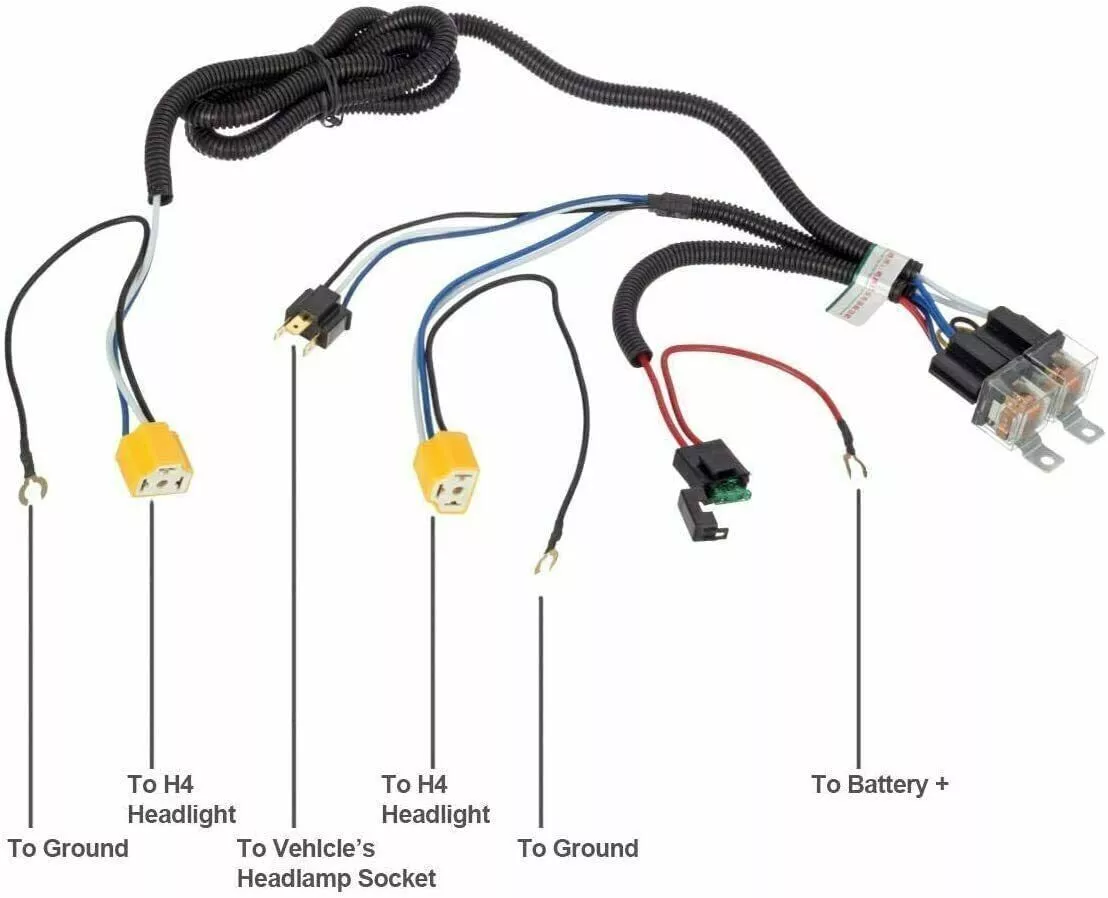

It seems the headlight switches are prone to burning out because of full current going through them. It's kind of stupid for Jeep to not use a relay. That being said I bought a relay harness off eBay. Works great.
Just to add that a relay wiring harness will make incandescent headlights brighter by allowing full current directly from the battery. The headlight switch is a chokepoint for current.
Good stuff, forgot I heard that there was no relay on main light circuit. Now I am running LEDs so probably not as much of an upgrade as far increasing illumination nevertheless a good upgrade.

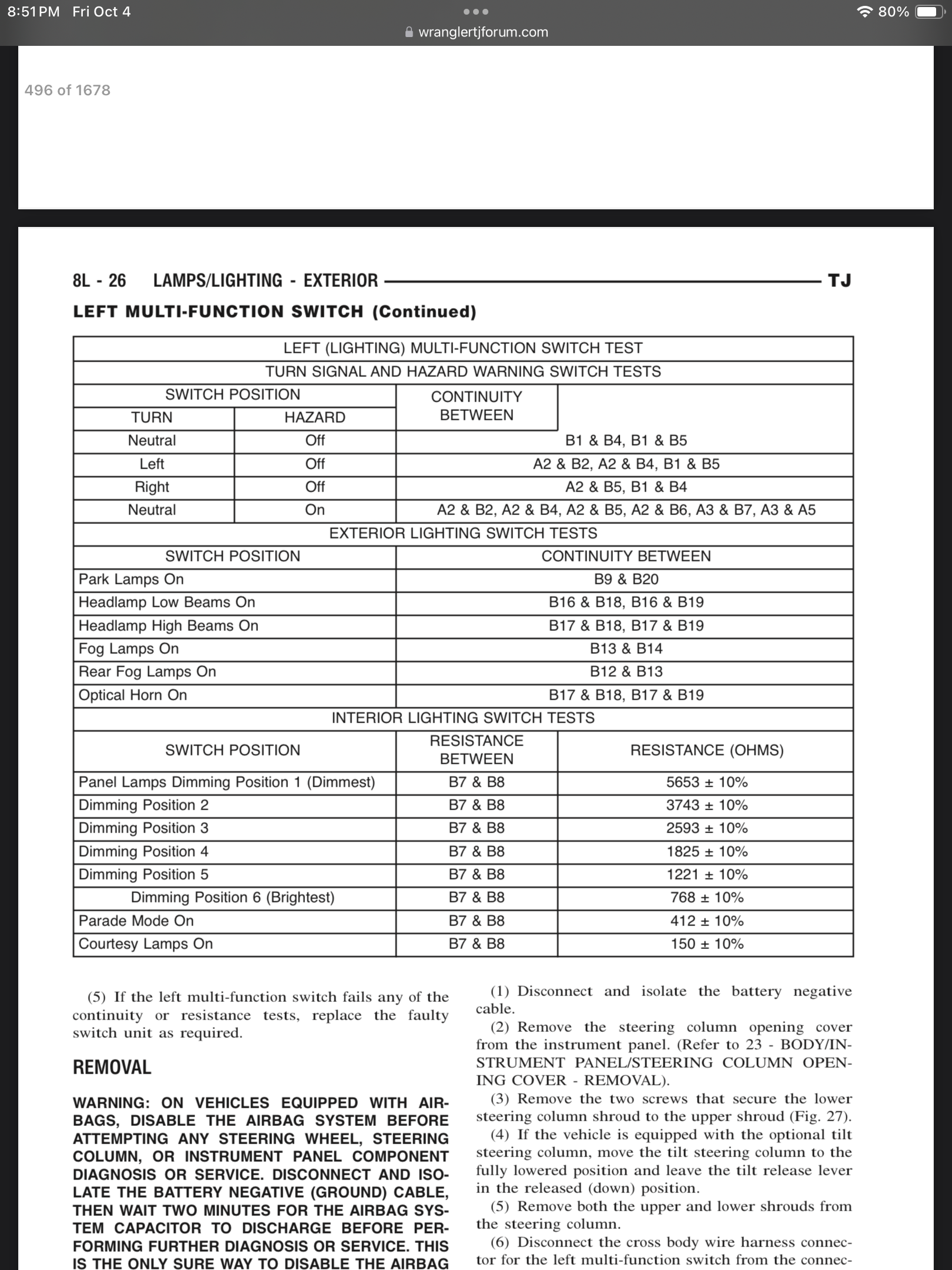

Hoping to get in and out of here with out this connector disintegrating in my hands. I was looking for the schematic for this dude but have not found it yet in the FSM section. image.jpg
Just leaving some bread crumb information ….found this table and you have a pin 1 reference so I am thinking that if I’d do a top/ bottomed from left to right and count the missing tabs as pin out spot get 20 points…🤔. image.jpg But my continuity testing does not seem to agree with this… just placed the order for replacement switch as I was out of time if I want it to tomorrow.
Well I futz around with the switch, pulled it a part, took a dental pick to the contacts…and seems to be working now…. So I do I put in he new switch when it arrives tomorrow or see how more life this one has to give…🤔
