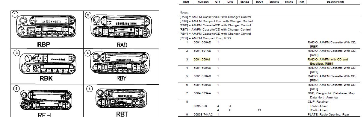

Since your build sheet doesn't mention a cassette player my bet is you have the RBK radio which is the only one without a cassette and changer controls. Its Mopar p/n is 5091556AI from the 2005 Mopar Parts Book.
