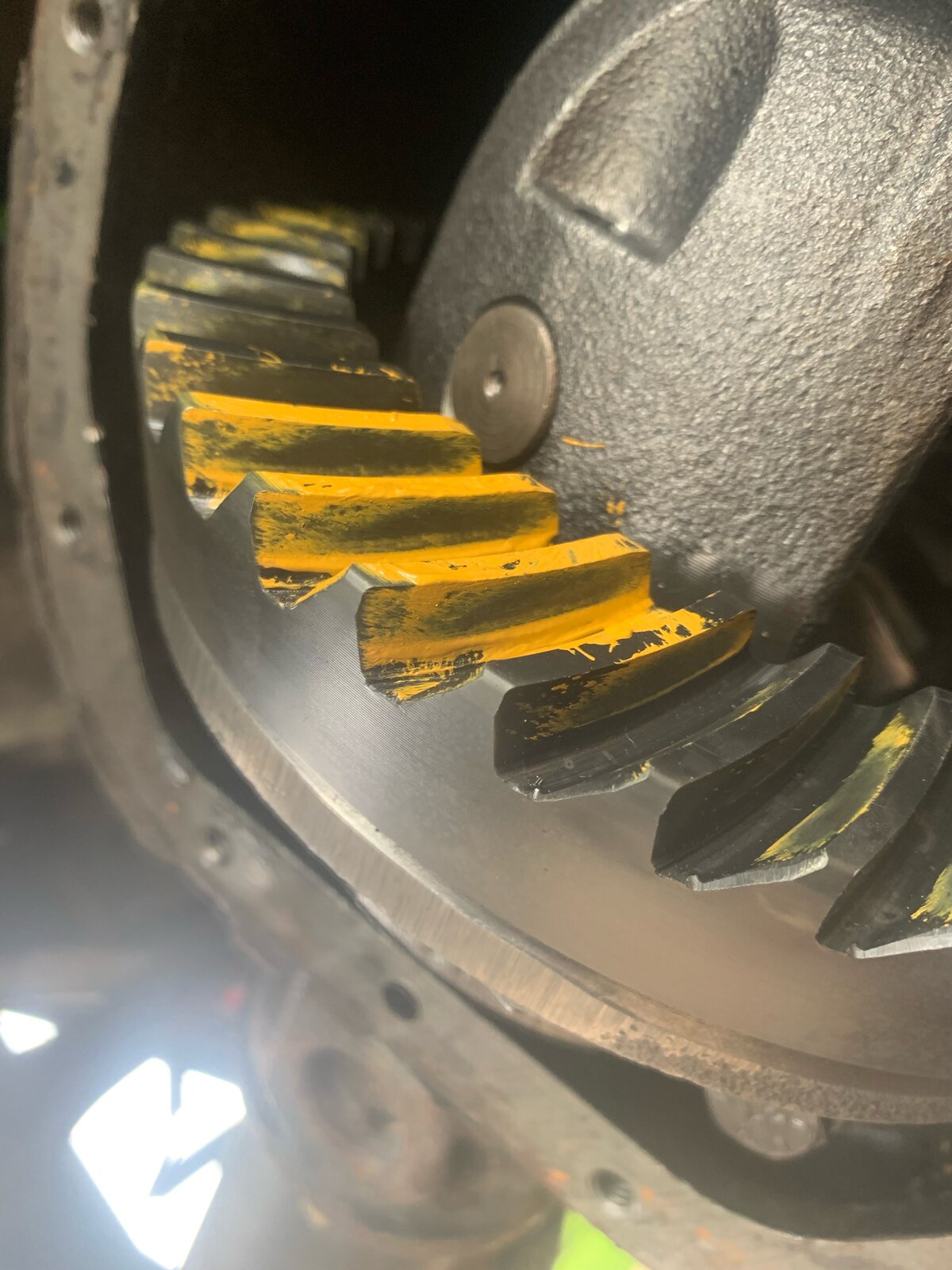

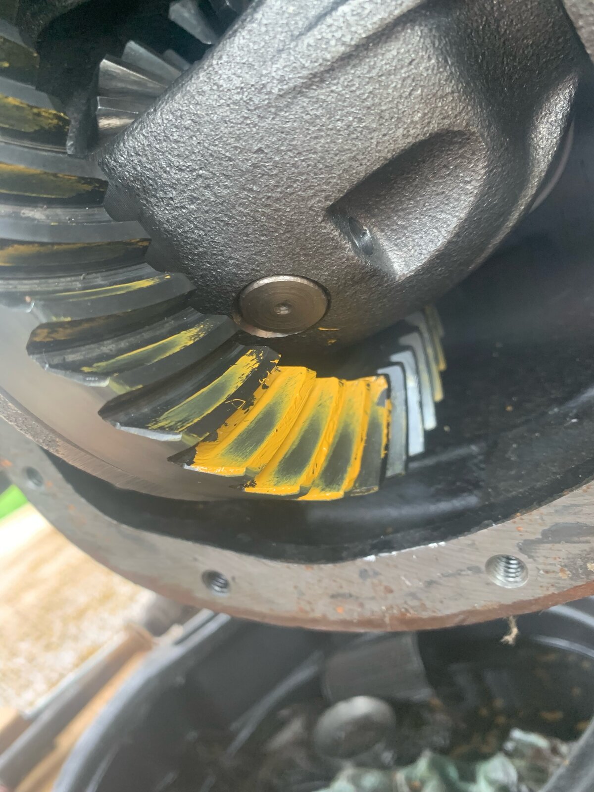

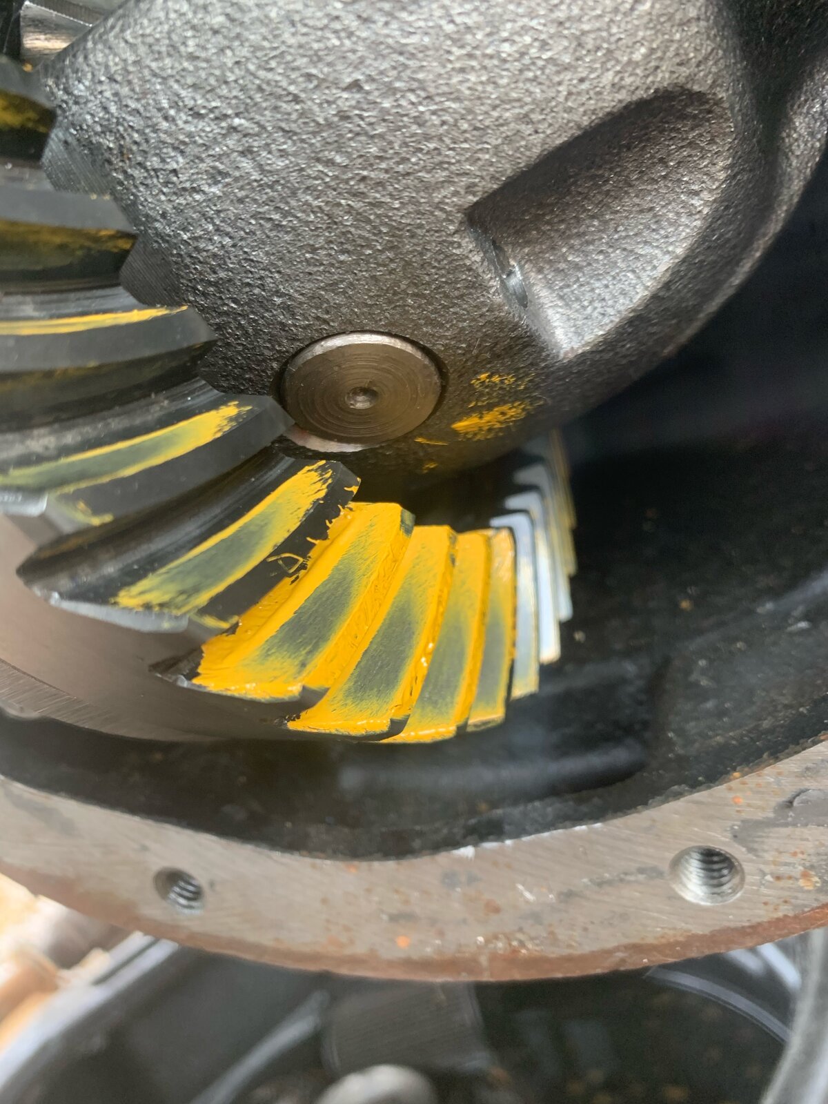

Had to wait a bit, but just ran my first pattern on the dana 30. This is 6 thou backlash. Thinking slightly deep?
You are the tiniest bit deep but for a front I would run that no problem.
That's what I figured I will see if I can take 1 thou out and if so I will do if not I have no problems running it as well. Appreciate the input, time to get all the new steering components put on, and time to slap these 35's on, oh, and that thing called break-in!
Reactions: Blackjack
Took the jeep out for the first test drive today. Axles were cool to the touch after a couple of runs and made ZERO noises. Can't wait to finish breaking it in over the next bit and get it on the trails next weekend. Thanks for all the help!
