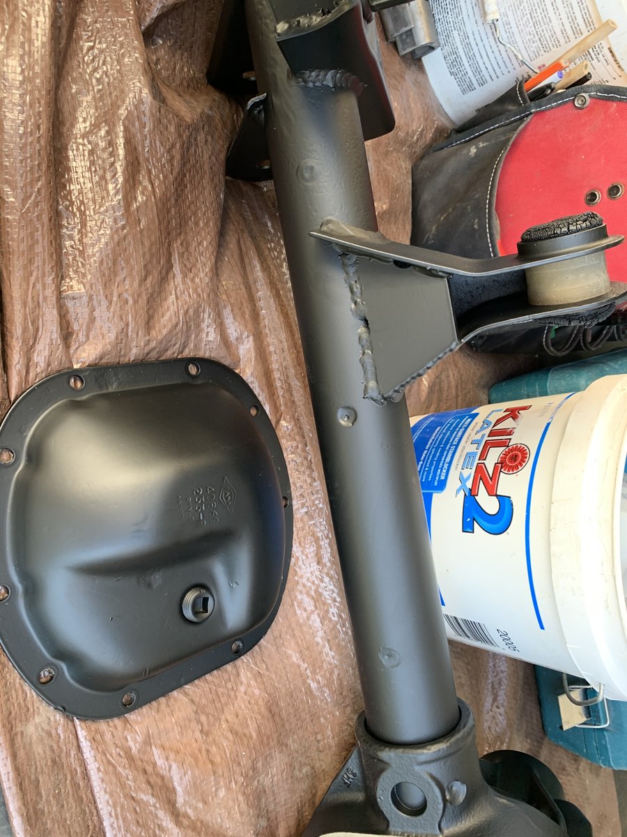

Good question. The current axle is a Dana 30 LP and I’m replacing it with a Dana 30 HP ( free to me ) so I welded Gussets and sleeved the New to me axle and I’m ready to send it out to have the new gears installed Rev Cut 4:88 Revolution RP. This will provide some added strength till I move on to Dynatrac. In the meantime here’s a picture of where I’m headed for the short term. Truth be known. I miss my lj and hate seeing it sit. 6AA4CC18-DE18-4DF9-88D8-BC9671717ABE.jpegFA5956F4-7FE3-43BB-A602-2019785CAADC.jpegA264D60A-6986-4574-B391-25D7F6F3DA1A.jpeg9D945971-6D61-41A5-AD4C-A36FA935CAC1.jpeg
