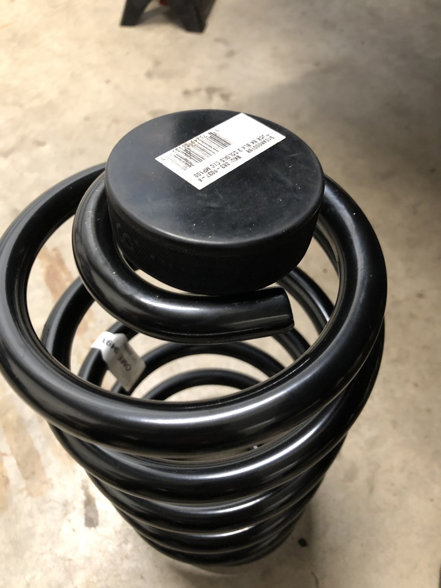

Also, what can be used besides hockey pucks for bump stops that don’t cost a fortune? The pucks don’t fit inside the coil opened at the top end the coil wrap is too tight to go around the puck..

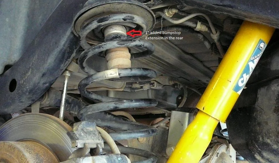

Don't think it matters on the rears. For the bumpstops in the rear, you could unbolt the upper jounce bumper steel cup, get a longer bolt, then add some HD 1/8" washers to your desired bumpness. Or, drill/tap the lower spring pad and add a hockey puck on the bottom.

The opening on the coils is the same top or bottom. Also rear bump stops should be at top on the rear. Would take a lot of washer to get 2” thickness.. I already have a longer bolts that’s not the problem, it’s the puck fitting into the coil. I can’t get the coil all the way up to rest against the perch due to diameter of puck

OME makes some 1" aluminum spacers that work on the uppers.
Also, you'll notice that the lower spring pad has a raised section where the small coil recesses in. Add the puck on top of that if you want to add from the lower pad. You'll obviously need to have the spring installed and extended so you can sneak the puck between the coil windings in order to bolt it down to the lower pad. Honestly, it's just easier to get the upper spacers and add from top. If it were the front coils, then you'd want to add bump from the bottom due to how much the front coils arch on articulation.
