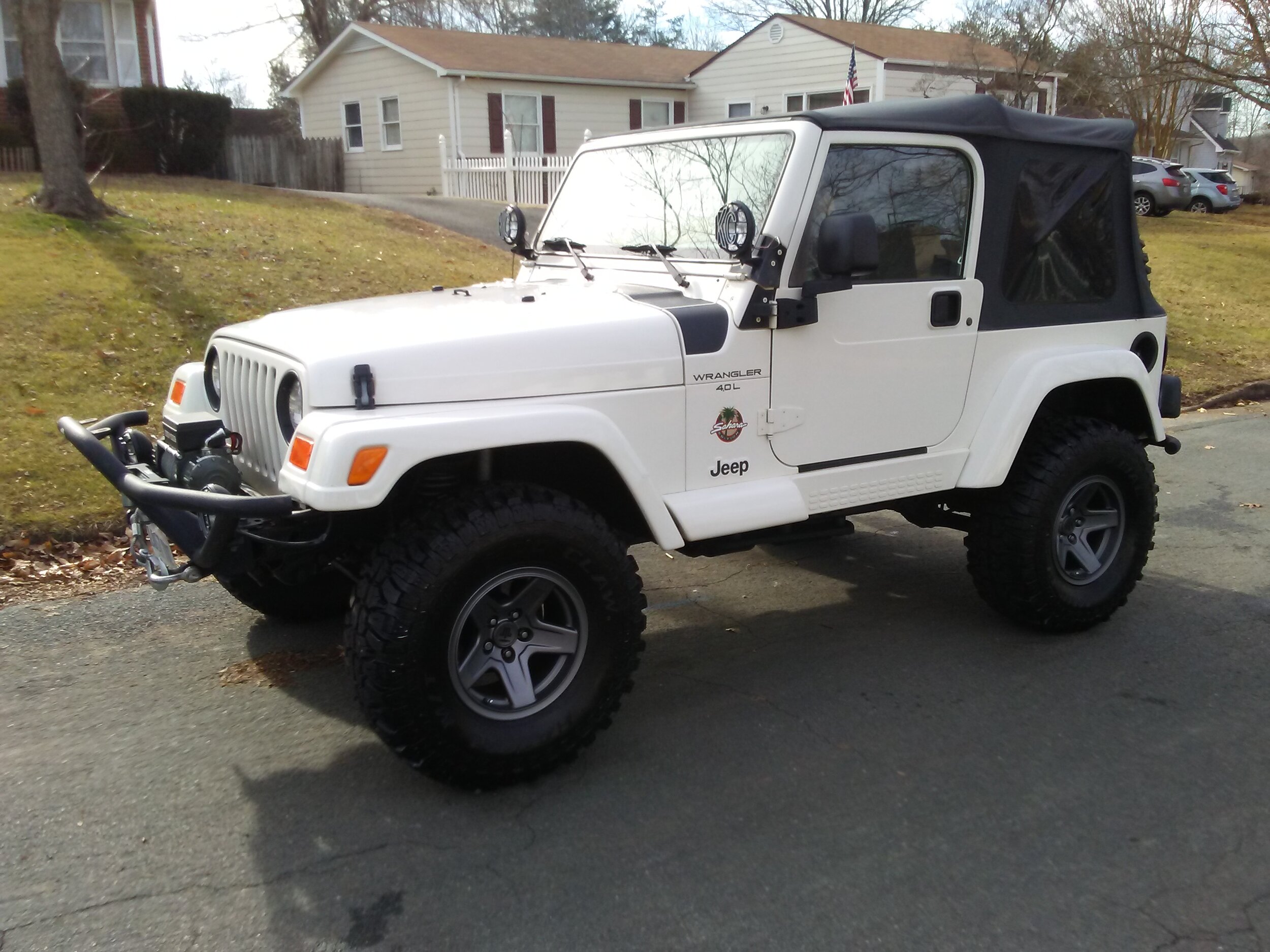

3" lift with 33s. I was going to add a BL before I sold it.

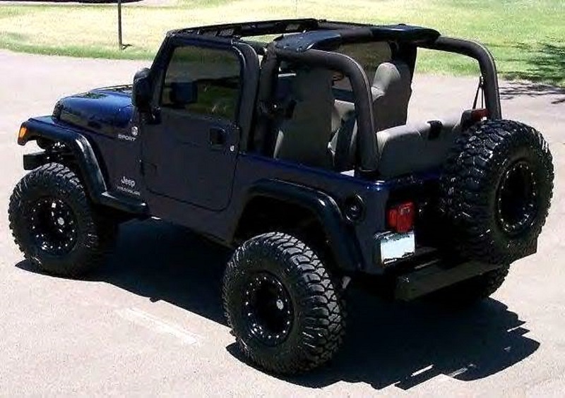

4.25" Zone combo lift with 33s.

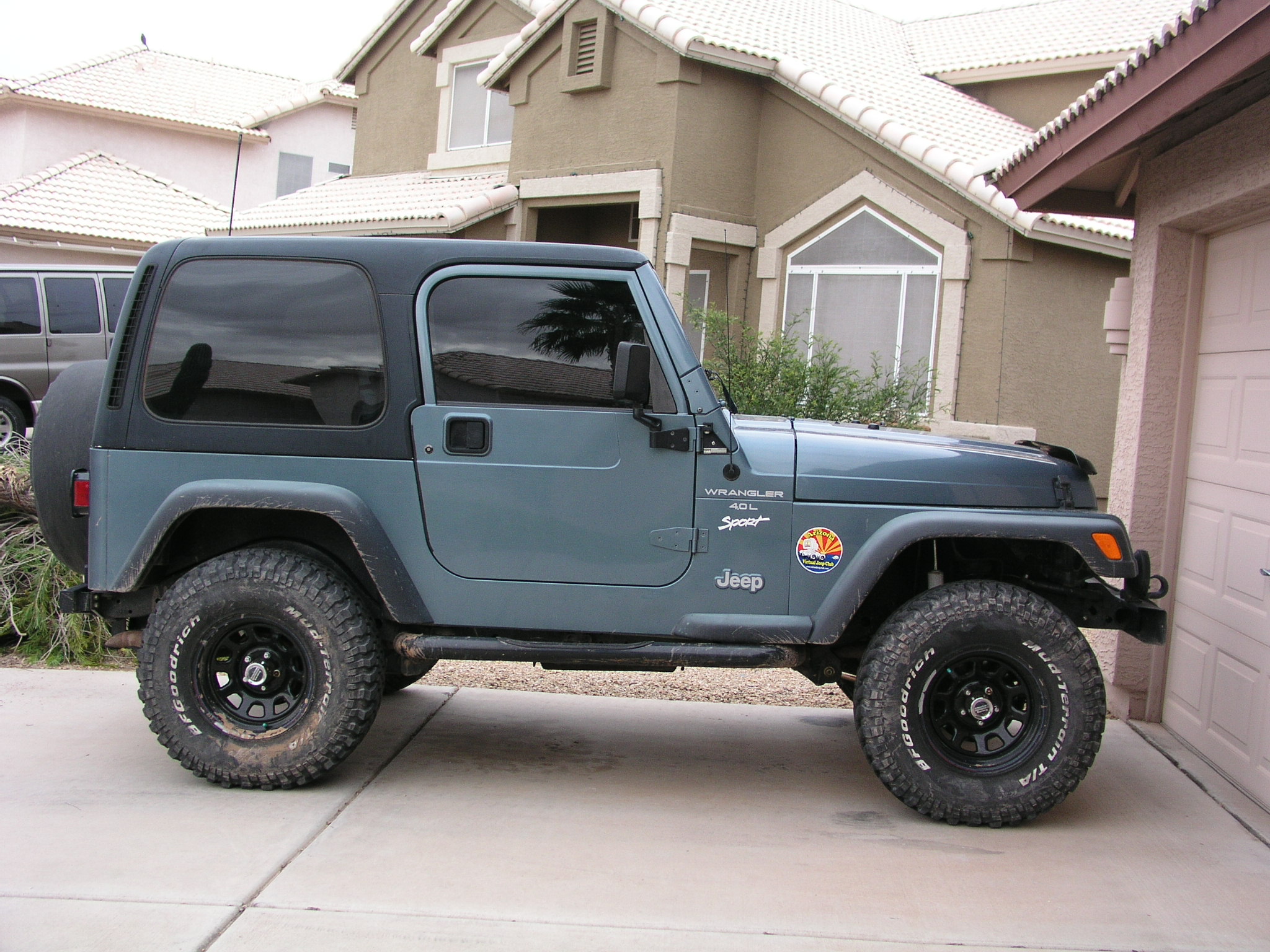

3" lift with 32s.
