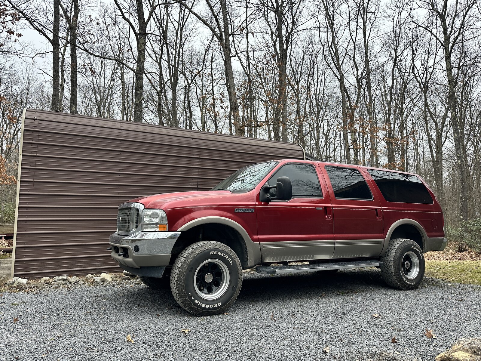

Excursion would solve this 😁 I swapped the original springs, which are incredibly too soft, for F350 springs front and rear. Guys are pulling 11-12k all day long with the proper setup. I regularly tow a dump trailer with my 7.3(9k fully loaded). Finding a V10 Excursion with 4.30 gears would be ideal. Otherwise a set of 4.88’s or 5.13’s is perfect for them.
Eco boost Expedition is another great option, just wish they didn’t have IRS.
Get a Ford Excursion and flat tow your jeep like the RVs do.
They start at 6800lbs and go up to 11000lbs tow rating.
We have two in our family with the V10, both with over 300 k miles on them.
This one will haul you, the missus and 5 kids in style.
