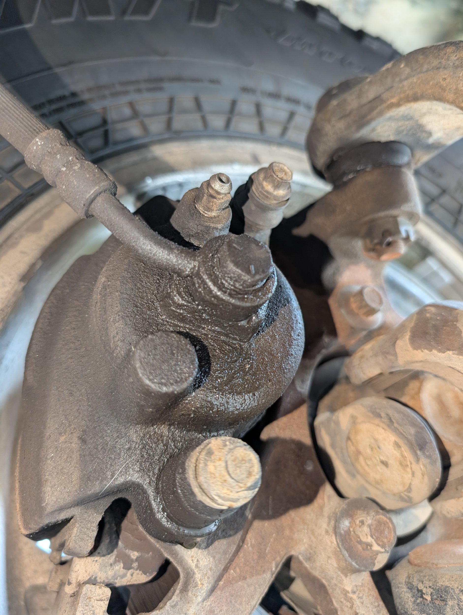

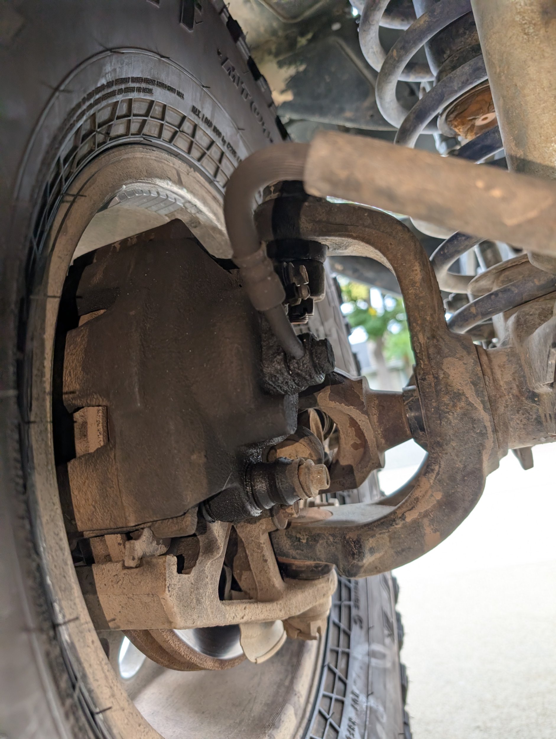

I noticed this leak on my driver side front brakes today. Can anyone tell me what might be the cause for this? Leaky seal?
Yep I’d agree the crush washer. Or….. your wife doesn’t like you anymore🙁
She did leave for the weekend which would give her a solid alibi. 🤔
If it proves to be the crush washer, is that something I could replace on it's own or should I just be swapping a new brake hose in at this point?
Reactions: TJ Jim
Buy a couple of copper washers from any part store or Amazon.
If you're ninja you can swap them without making too much of a mess or a lot of brake bleeding.
Those kinda look like original soft lines. Might want to swap them out. New ones might even include the washers.
-Mac
I grabbed a pack of copper washers. I will eventually buy brake lines when I install the 3" lift.

Have a friend/wife push on the brakes while you look here. Can probably see the fluid ooze out.
New washer or just tighten up bolt a little ??
