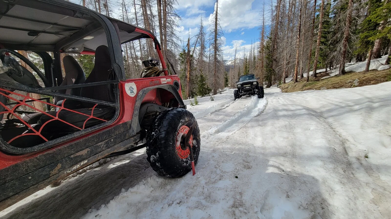

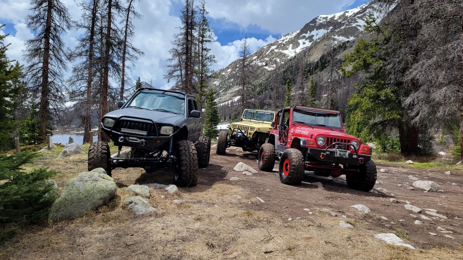

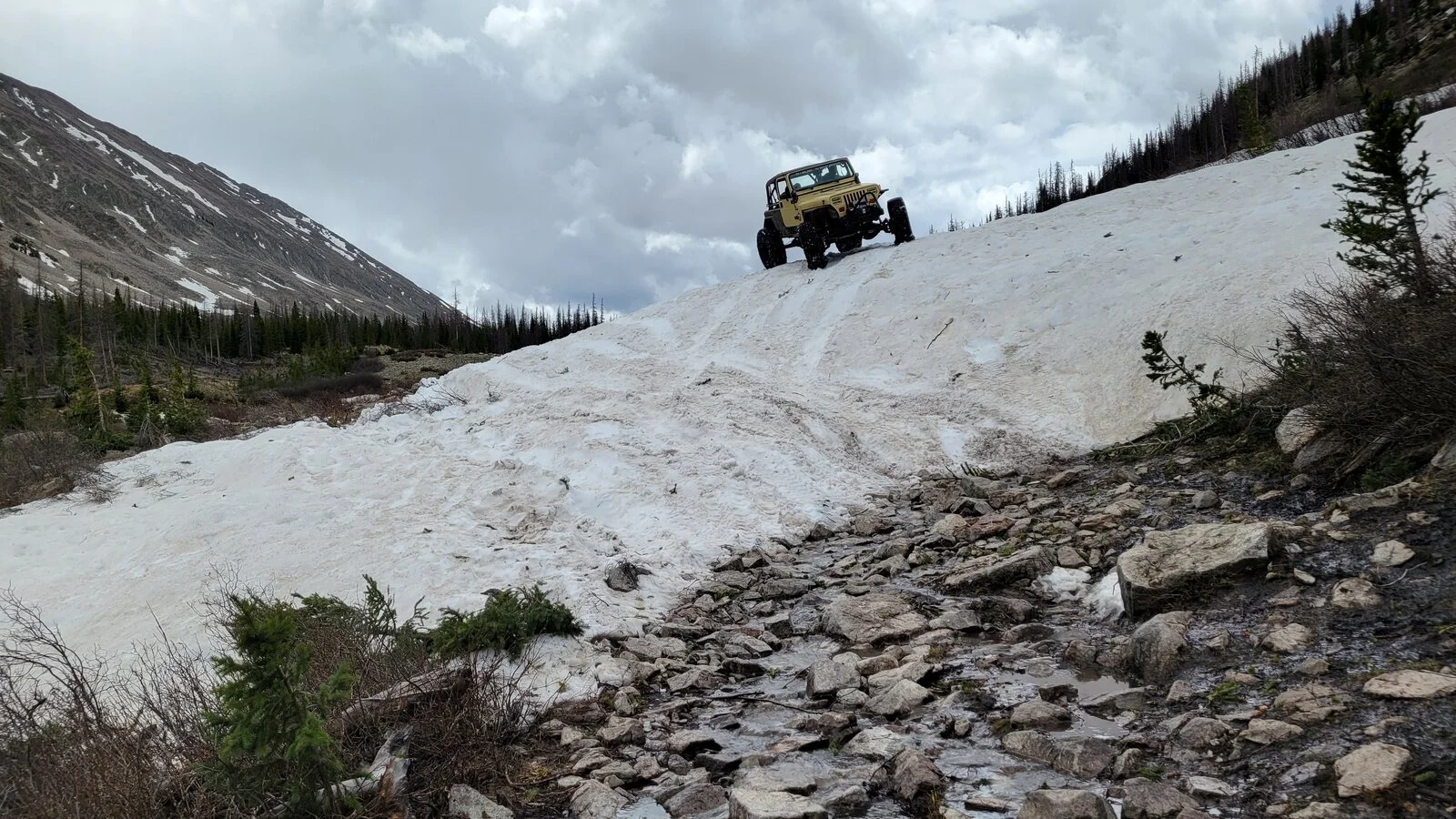

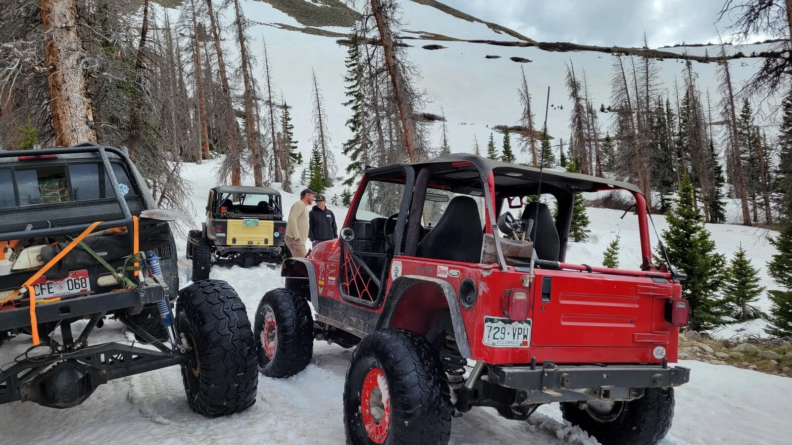

Update on the Buena Vista area snow. We went out Sunday and did some playing. Grizzly Lake is open all the way with an avalanche that you can get around. Hancock lake and pass are still snowed in at about 11,700ft. Tincup will probably not open for about 3 to 4 weeks.

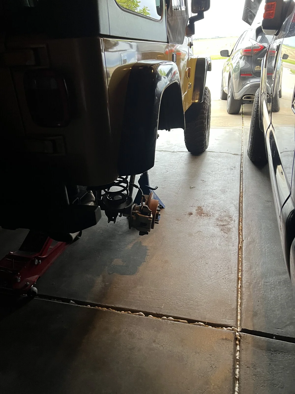

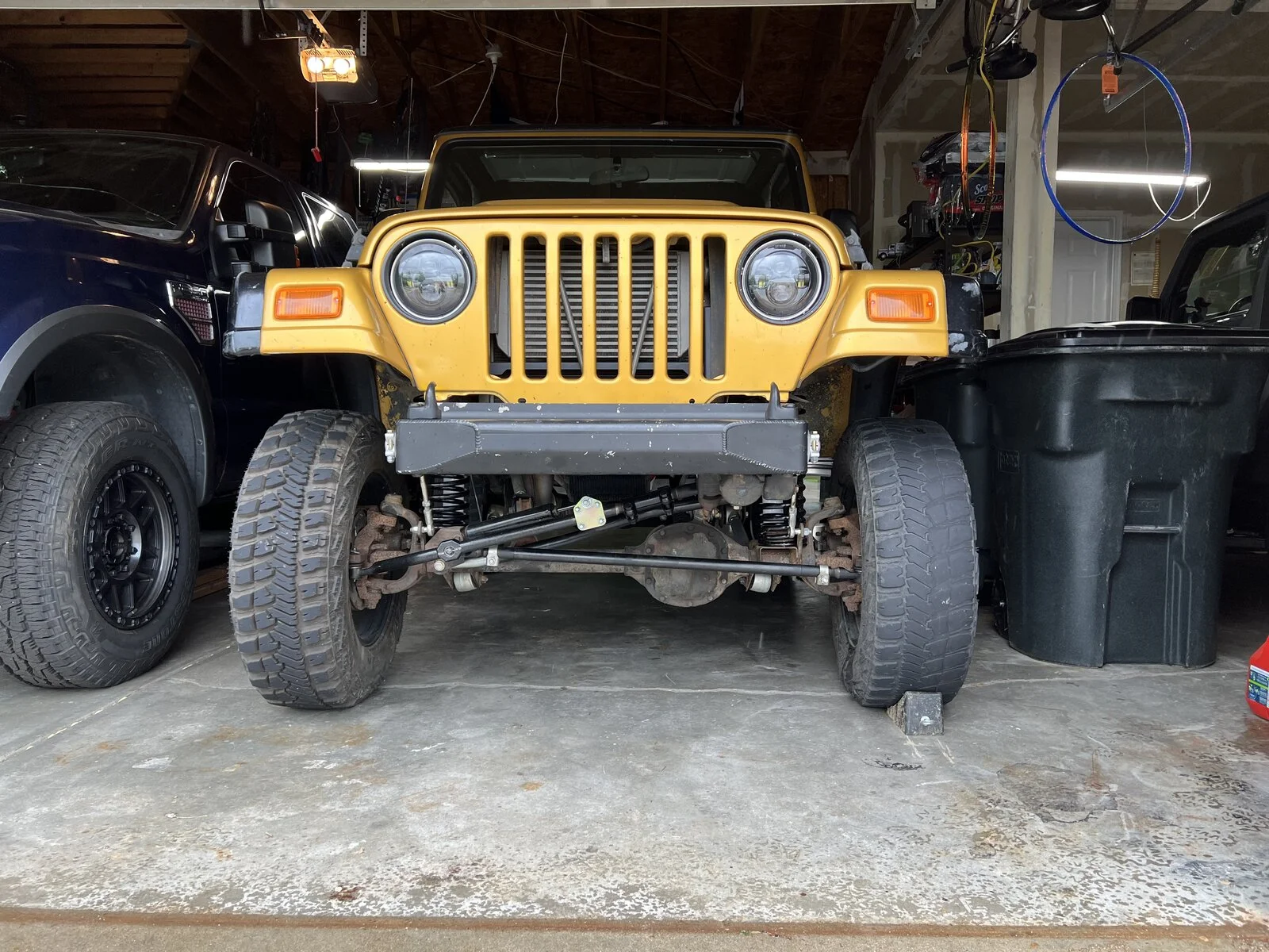

when installing the 4” lift and the 1.5” body lift. do i need to change the shock mounting area. no way can i install these with out hitting the spring perch.
and it looks like i still need to rotate the axle some more. the shock mounts look like they are point straight down.
Trim the coil bucket. A notch that will fit the shock body is generally all that is needed.

You're getting to the point where moving shock mounts make sense, especially with the savvy tuck. The good news is though that you can place your shock mounts wherever they make the most sense and get the most out of your travel.

with the tuck it looks like i need to move the mounts. i don’t know if i’ll even hit the trails while we live in CO
so many mods all at once. i’m just trying to sort out all the changes.
