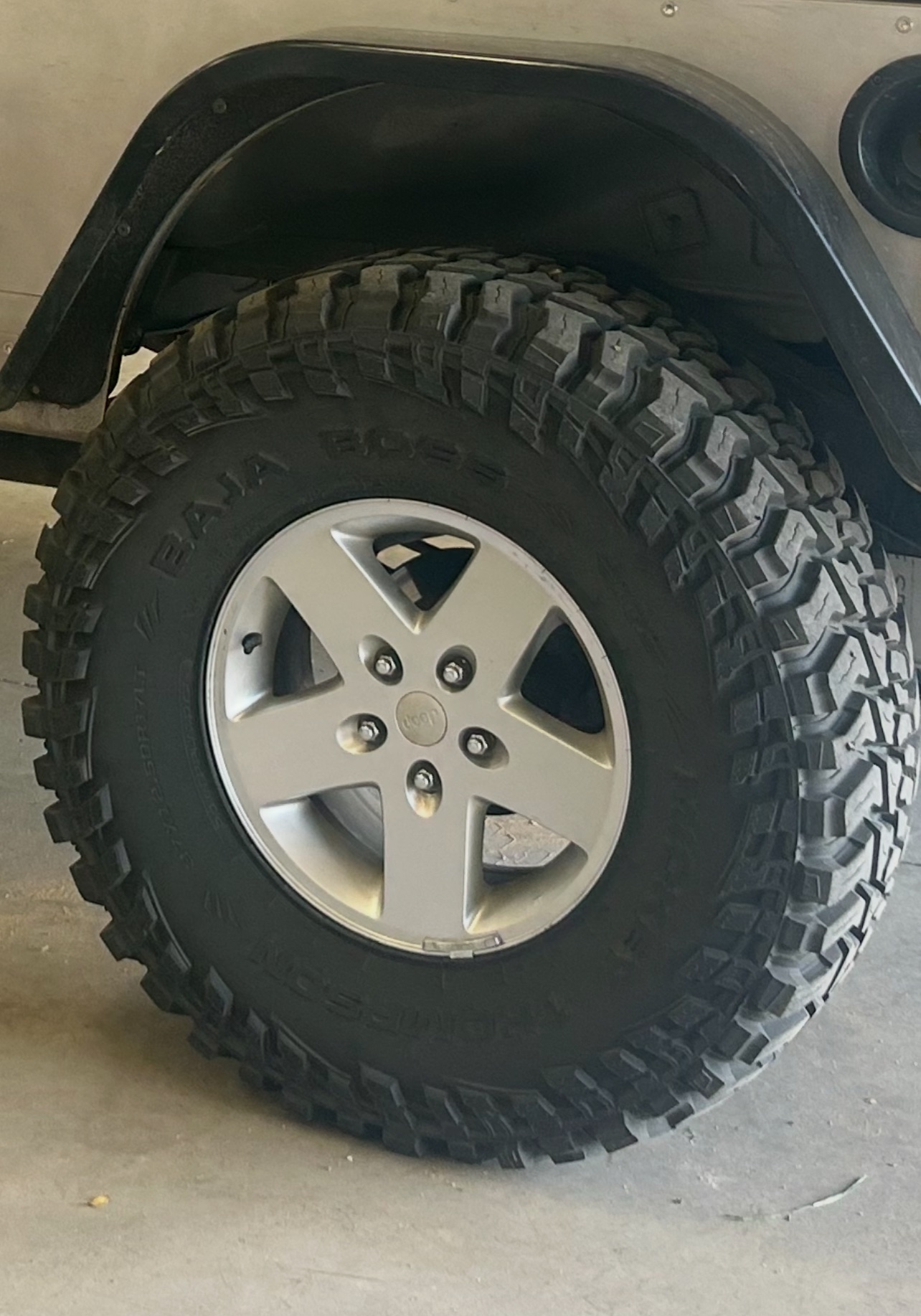

I’ve had trouble with the 37’s on the stock JK wheels. With no tire on the rim the rim spins true, but once the tire is mounted they look like they are bent when spun on the balancer. We got them zeroed out on the spin balancer but there’s still a wobble above 60 or so. Hoping it is a rim problem and these Walker Evans fix it.
