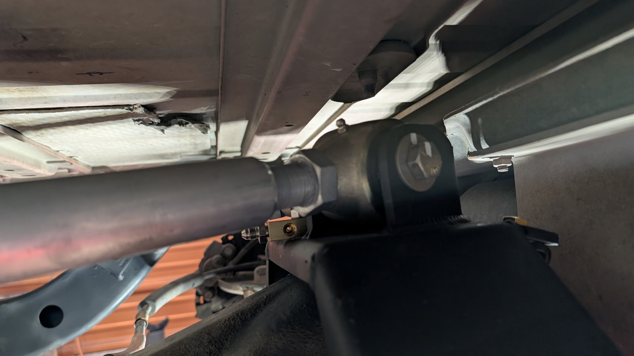

As for the seperation from top to bottom, on the rear it is triangulated to the top of the pumpkin. There seems to be no issue with axle wrap. The front is a 3 link with panhard. There is a single upper arm on top of the pumpkin, still no axle wrap issues.
I will say this though, there is a reason I don't do very much highway driving. I took all of the arms and rebuilt all of the Rock Krawler joints this winter. Found out that my exhaust had melted the joints on both upper joints on the passenger side. Now I have heat wrap on the exhaust. Mike remember when I said it was squirrelly 😲
