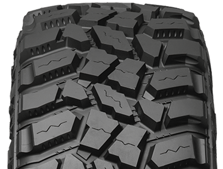

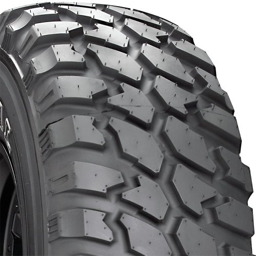

I think it all depends on if the lugs in a mud terrain tire are siped or not. A traditional mud terrain tire is going to skid more on hard packed snow or ice. Something like this....
Adventuro radial gt mt
However; if a mud terrain tire is siped it allows the lug to flatten a little bit more when it rolls plus it allows snow to pack into the sipe. And just like making a snow ball, snow sticks to snow. Something like this.....
Cooper stt pro
Cooper stt pro

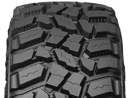

Cooper stt pro
That's why I'm hoping someone who has these tires chimes in to give their experience in snow or wet road conditions.
I've run the Toyo Open Country MTs for the past 2 1/2 years in Michigan and they have a siping pattern very similar to the STT Pro you've posted. In the snow & rain they've been rock solid and I've been pleased with their performance. My only caveat is I run 255/85R16s (tall & skinny) so that definitely helps.
