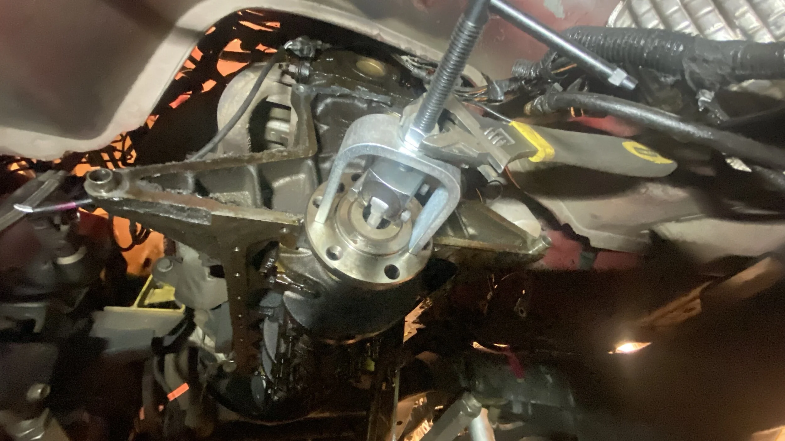

Don't believe I have the right tool for the job here. I got both transmissions out and the pilot bearing but need to replace the crank bushing. I have a blind bearing puller but can not get it to lock had enough to get it to budge. What tool do i need. Thought about welding a nut to it but my welder is inop at the moment.
Literally took 3 mins to get the bushing out with this tool. $23 at Harbor Freight.
https://www.harborfreight.com/autom...aring/two-jaw-pilot-bearing-puller-58209.html
Reactions: Mike_H
If that is the same as the others, it only works if the bushing hasn't been driven in until it bottoms out in the crank hole. If that has been done, there is nothing for the little ridges on the end of the two fingers to grip.
Yes, I guess I was lucky.
Bought the HF tool. Not so lucky with these. So after 2 days of stress anxiety both jeeps are going to local shop to have the bushing removed. Shop will also be doing my gears and lockers as I’ve put poor @LJonloan through enough hell with this.

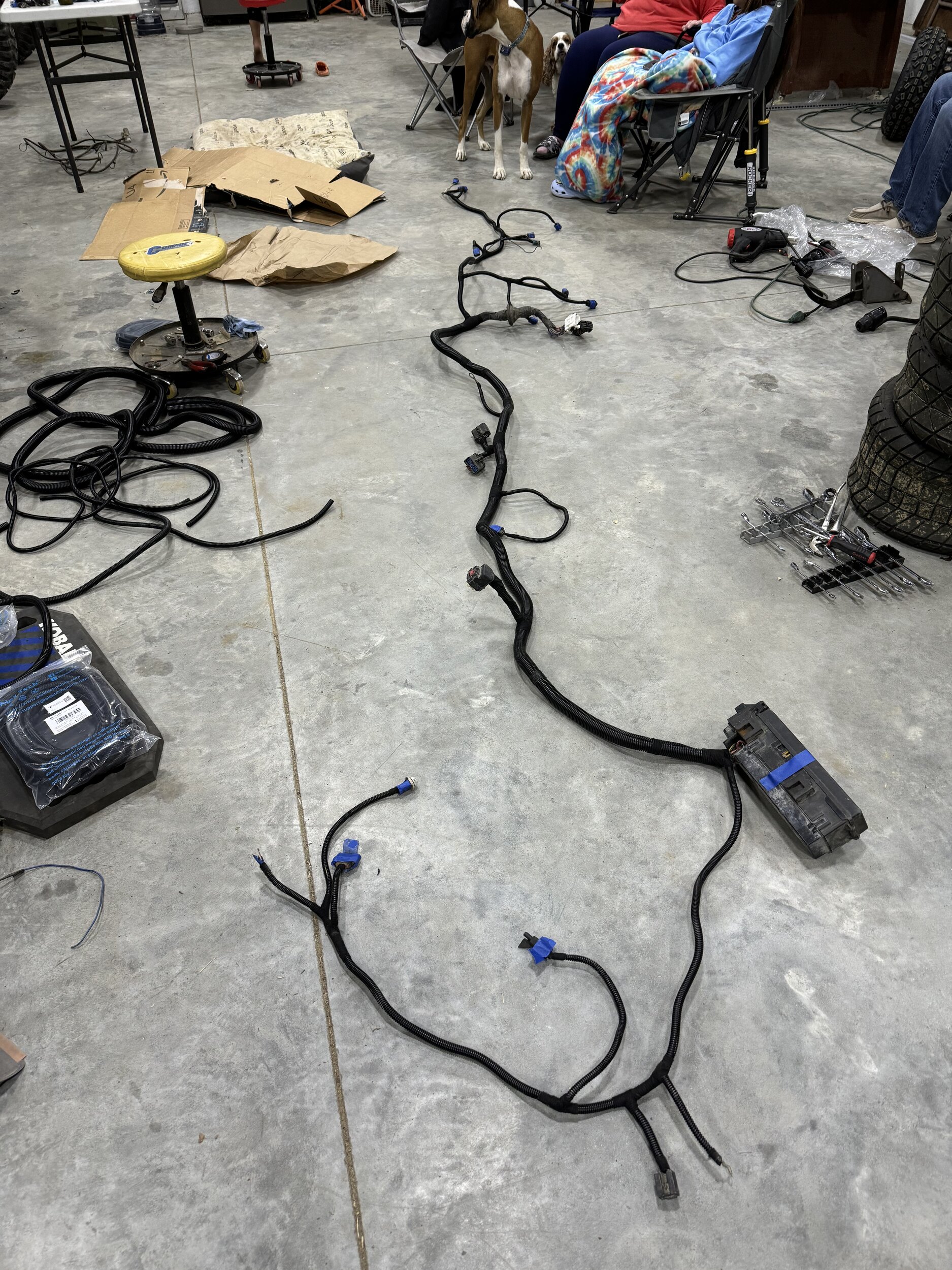

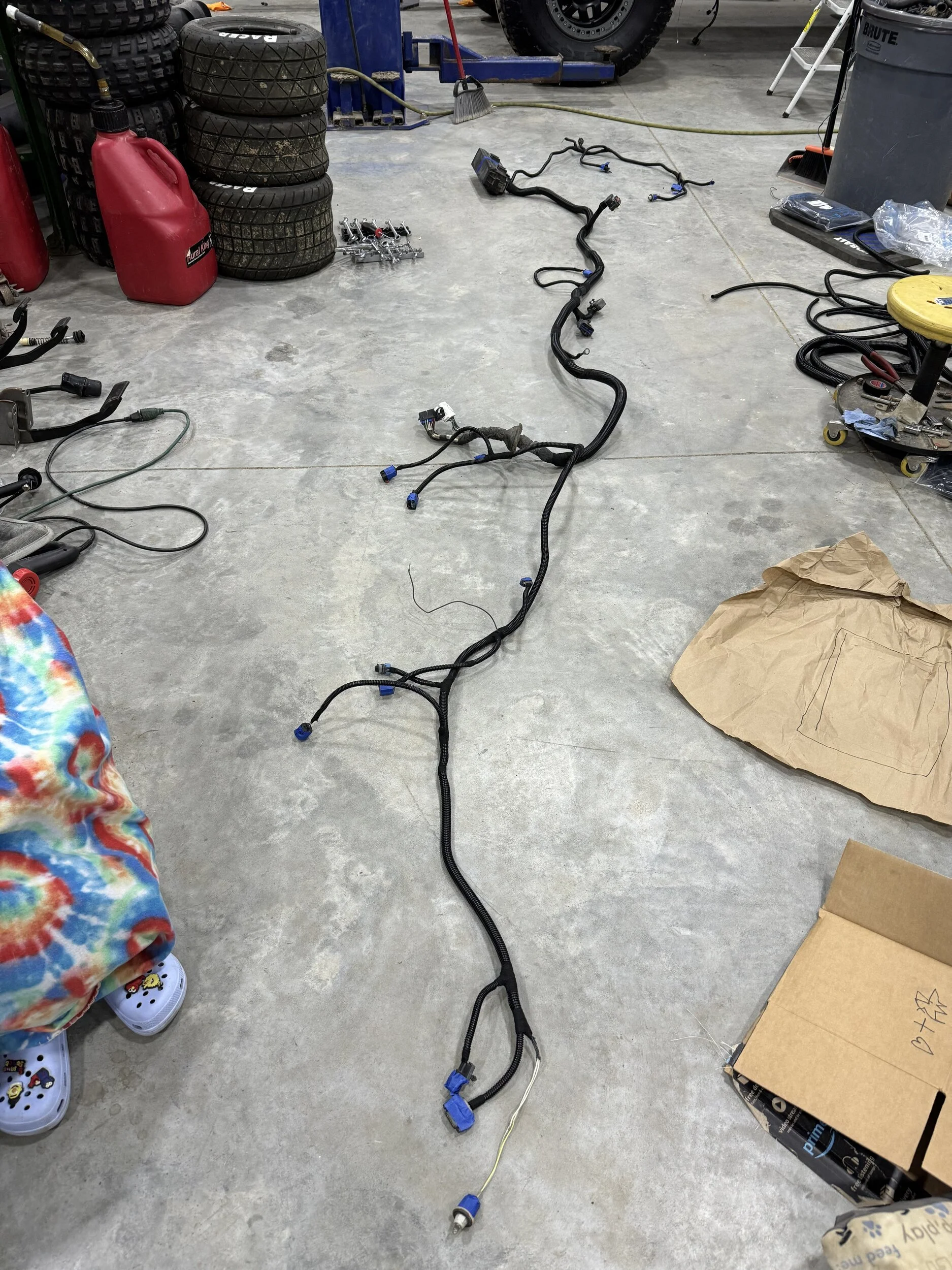

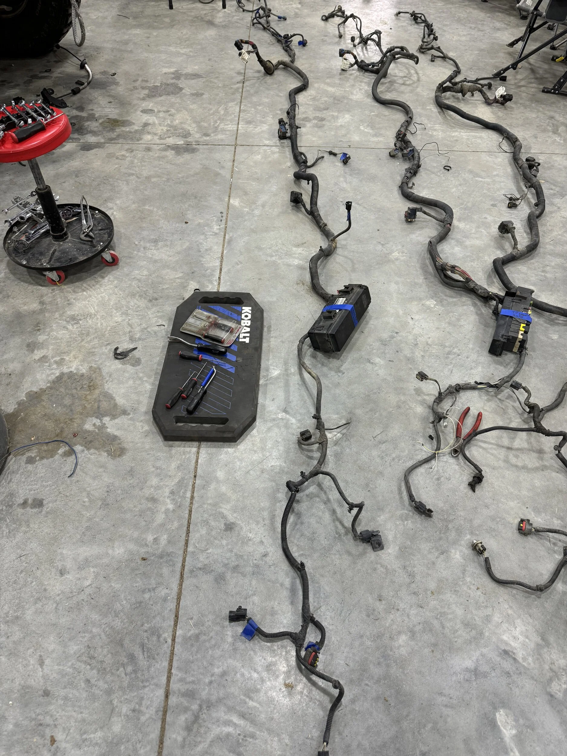

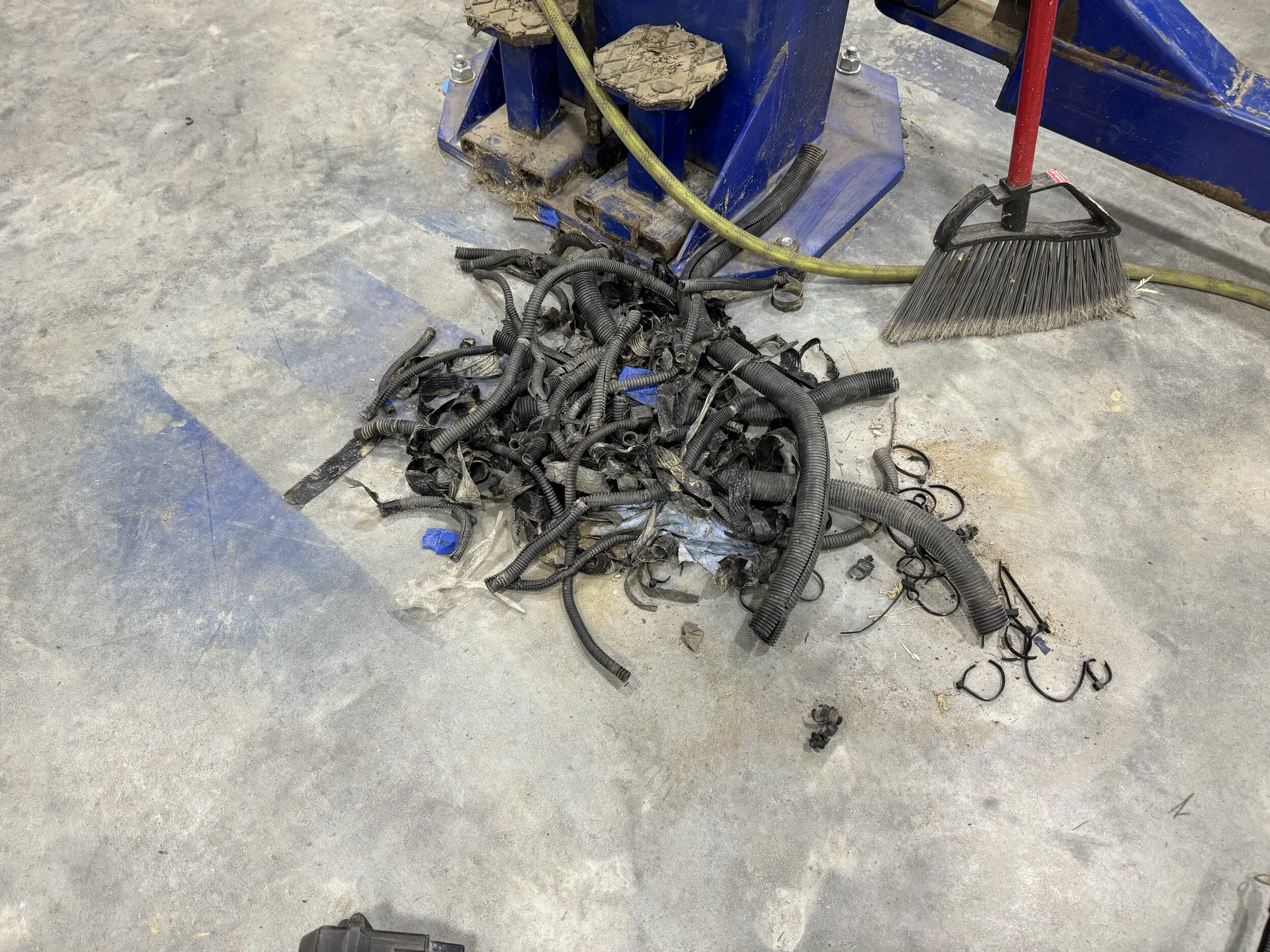

Has been slow recently due to crazy work schedules but starting to see a little progress.
Reactions: JMT
My fingertips hurt as I type this. Lol!!
Good work guys. Some of this takes a long time. The engine harness is one of them. It’s nice to get it refreshed though. I’m sure there was mostly crumbly loom. Just think, you’re ~18 years ahead of everyone else now that you’ve replaced it. I suspect people should be doing this work on their rigs as maintenance now.
