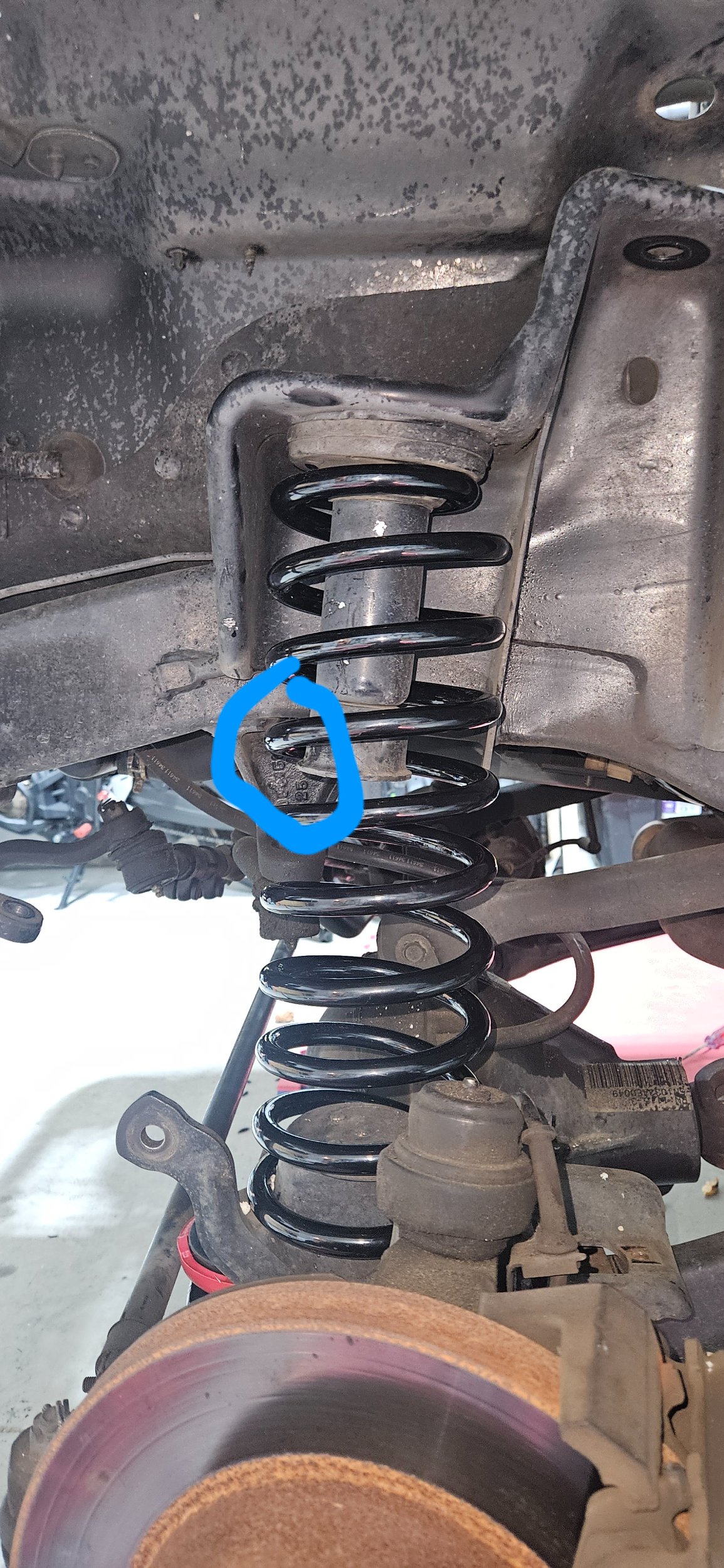

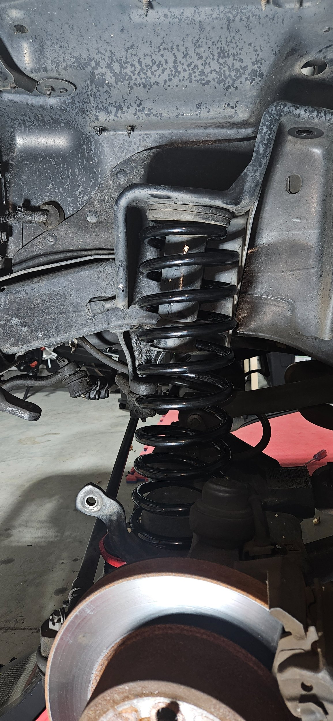

Hello everyone! I got a 2001 Sport 4.0 and while installing a lift kit including 2in BDS coil springs. I noticed the jounce cup (lip) catches on the inner part of coil spring between mid cycle and full droop.
What could be causing this problem and how can i fix it?
I don't have adjustable control arms and didn't really budget for them or think I'd need them on a 2in lift. I've also doube checked the spring is seated properly and it's good.
I'm thinking about grinding off the cup lip on the side it rubs (about 1/8in) to make it clear as that's all it'd take.
Would this be an ok solution or would I have problems down the road?
