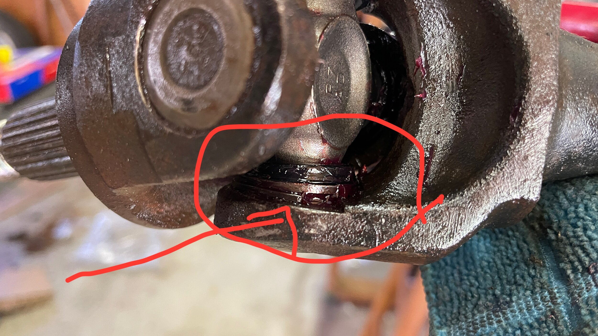

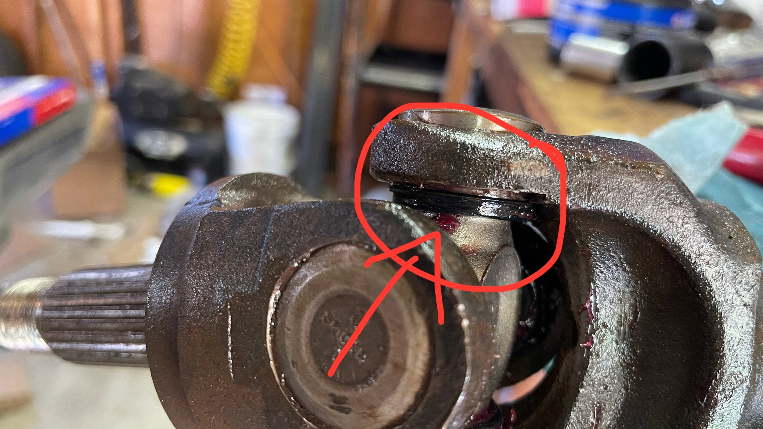

So I’m doing this right now on the drivers side. I have 2 caps that I can’t press in far enough to get the snap rings on. I’ve tried so hard that it’s started bending my C-clamp. I greased everything before putting them in and it’s starting to get on my nerves! Any suggestions?
Snap ring good on this side^
Can’t press enough to expose the groove on this side.

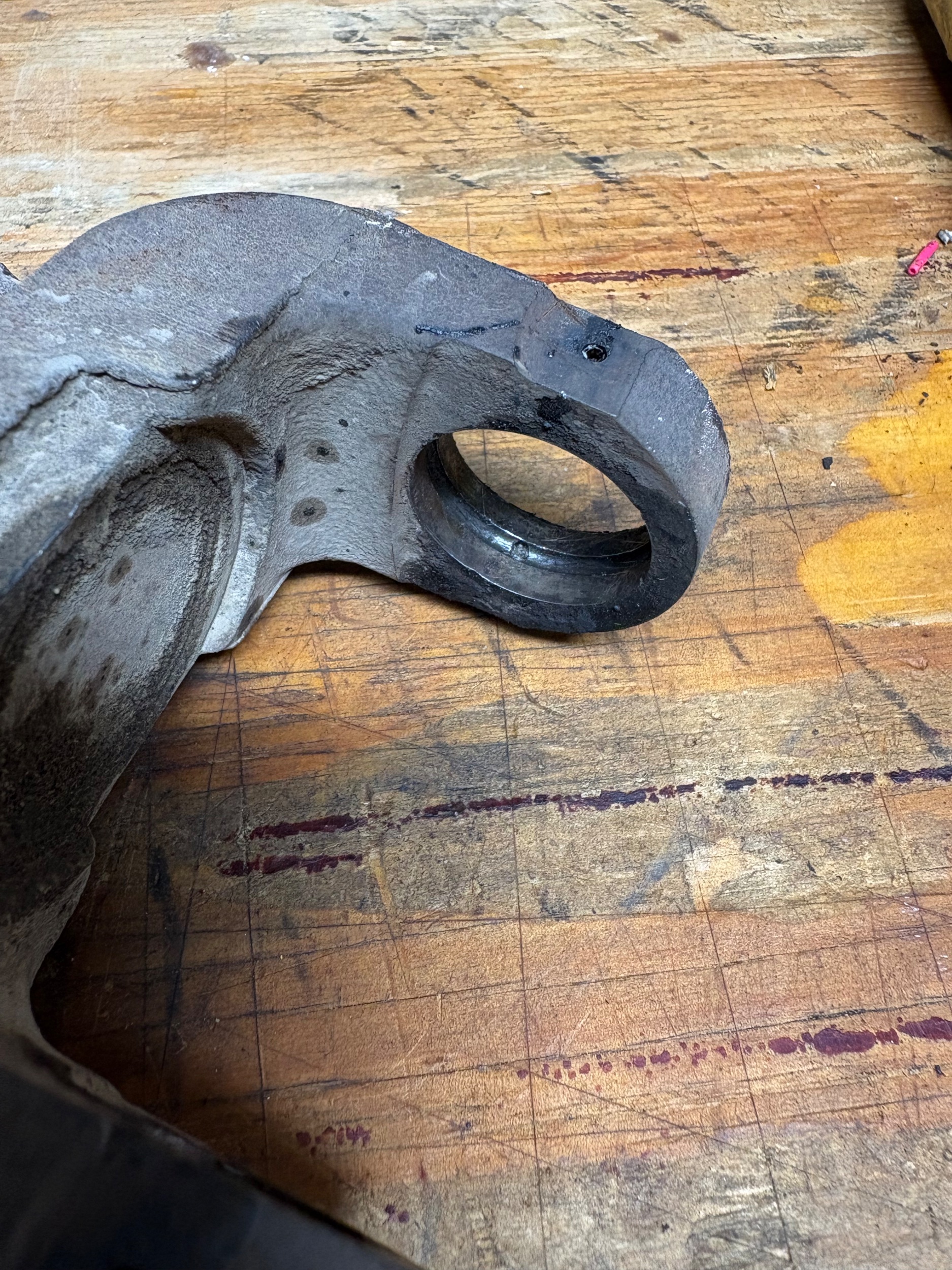

The distance between the inside of the yoke was too narrow not allowing for the groove on the ring to be fully exposed even with both end caps flush. I ended up shaving a little bit off the inside on one end. Once I took just enough off, the cap’s grooves showed it self and I was able to get the ring on with no problem. Got the axle put back in after cleaning out some gunk from the housing and everything reassembled no problem.

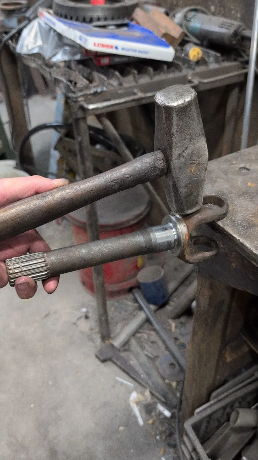

2.188" is what it should be between yokes. If a bit narrower, try opening them with a port-o-power or this method... A BFH

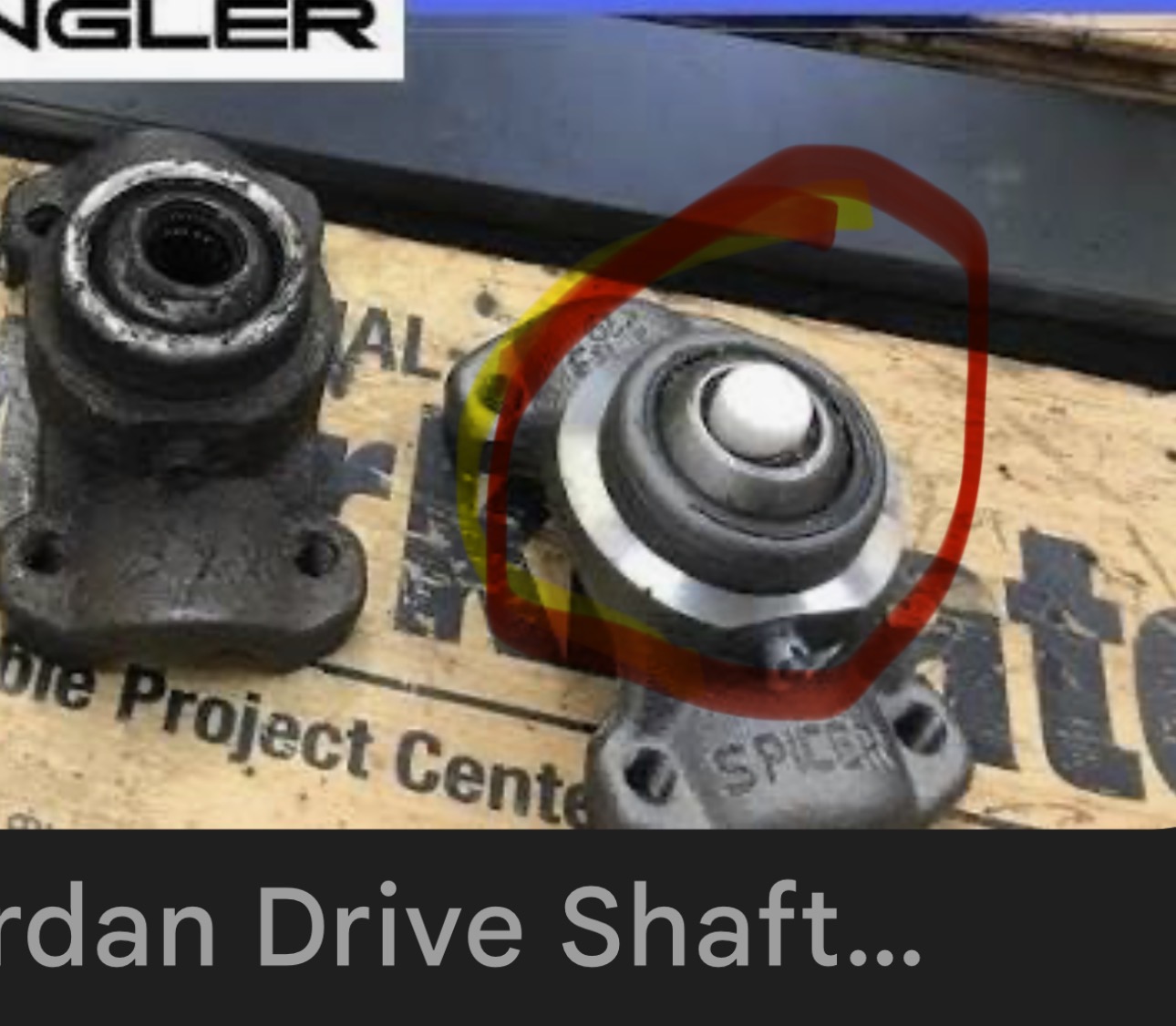

Started replacing the u-joints today. For the front it had the white rope that required to be heated to get it out. I bought the wrong ujoint but seems odd that only the u-joint would only be in about 1/2 the depth of the yoke, as I assume that groove is where the snap ring goes. Any thoughts?
Well looks like i do have the correct u-joint. Went back out today and saw the two ends (caps) are different. Two of them are a larger diameter and have a slot for a c-ring clamp which is on the inside of the yoke. Feel a little stupid now, oh well.
Reactions: Squbbles
