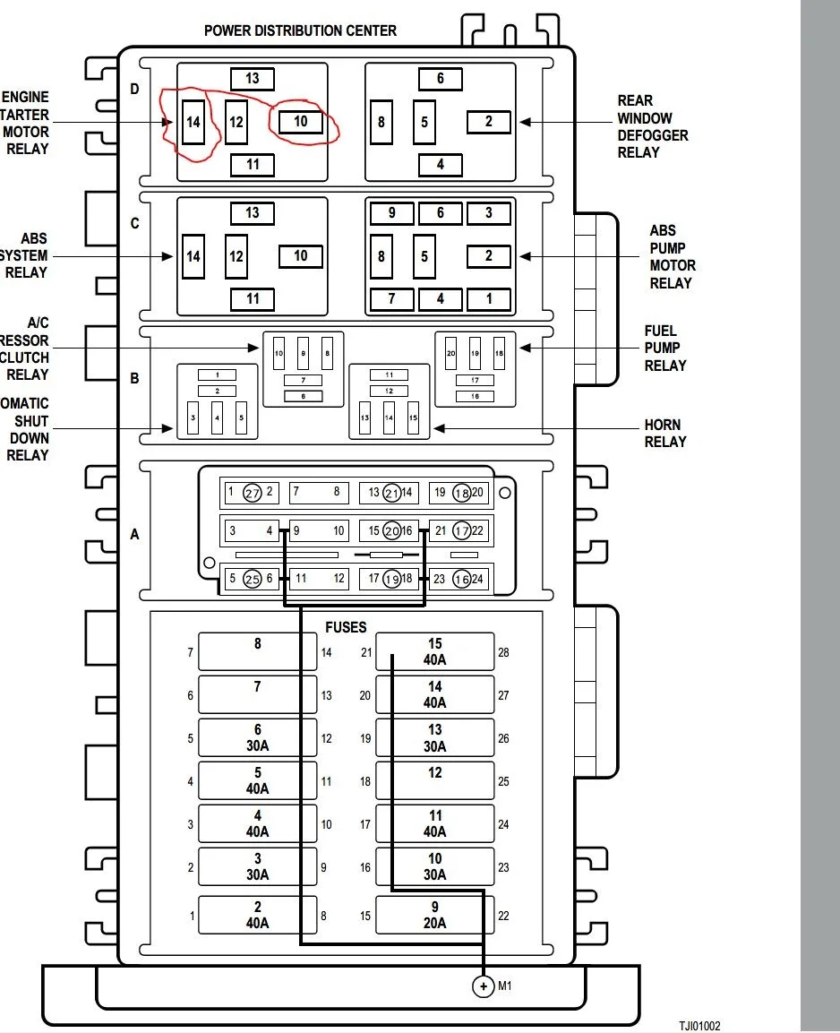

When I t/s a starting issue I like to try and figure it out if it's on the control side (ignition switch, actuator, clutch safety switch, etc) or the power side (battery, starter, cables). It's real easy to figure this out by putting the trans in P or N, pulling the starter relay and jumping the terminals circled at the relay below. That will bypass the control side of the circuit and send battery voltage to your starter. If you do this and it cranks, you know your problem is on the control side. If it doesn't crank then your problem is somewhere between the battery and the starter.
