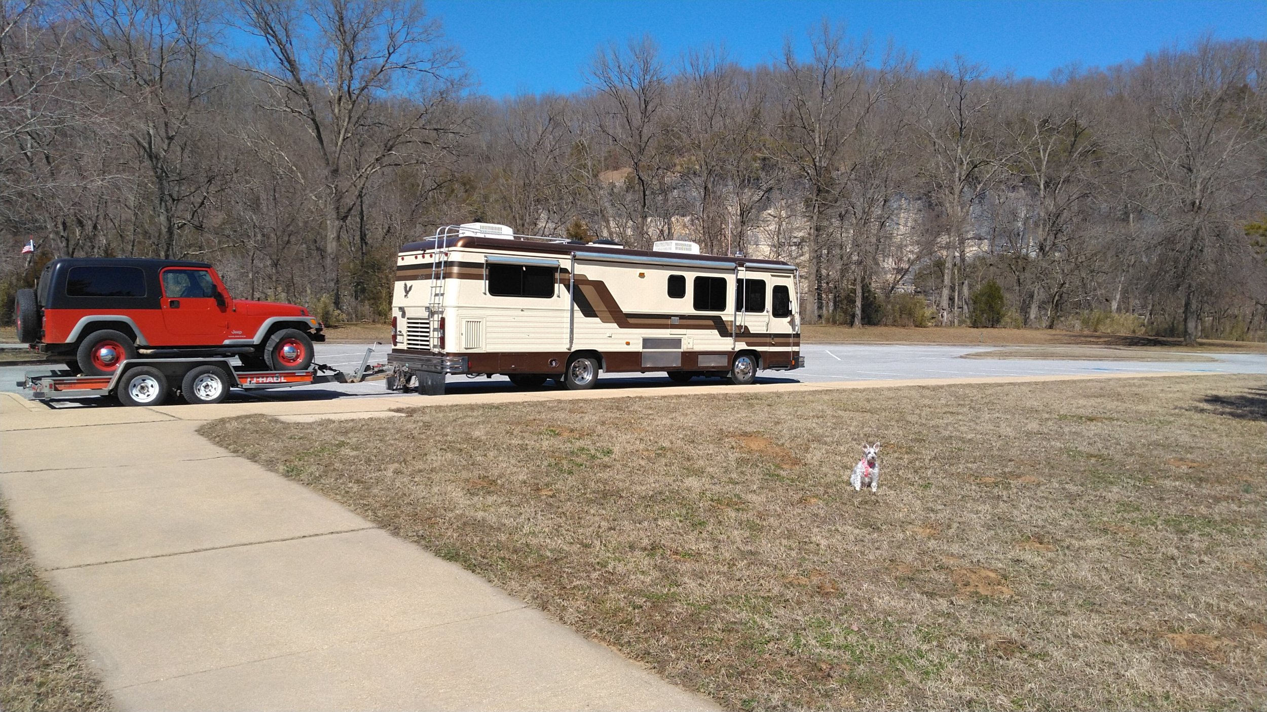

A U-Haul car hauler would be my choice . I've used them twice when purchasing our motorhomes . One from Flagstaff Arizona in 2014 and one from Harrison Arkansas in 2021 . The car hauler wasn't too much more than the dolly .

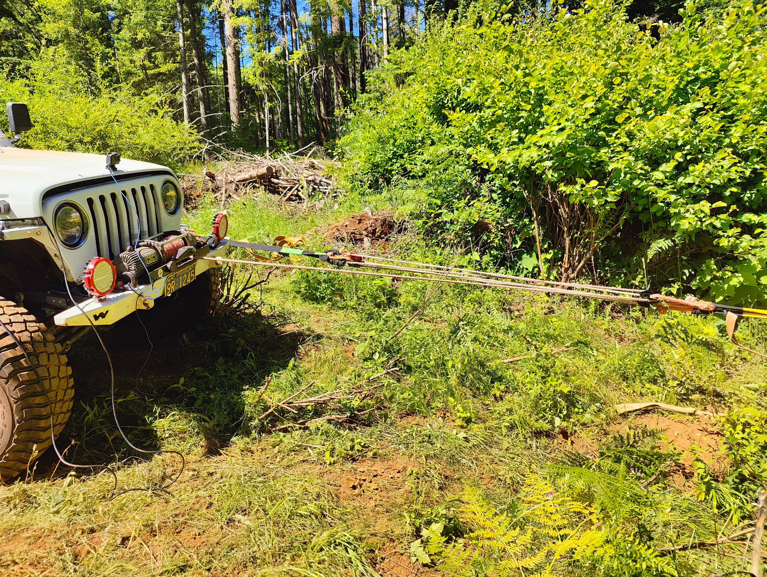

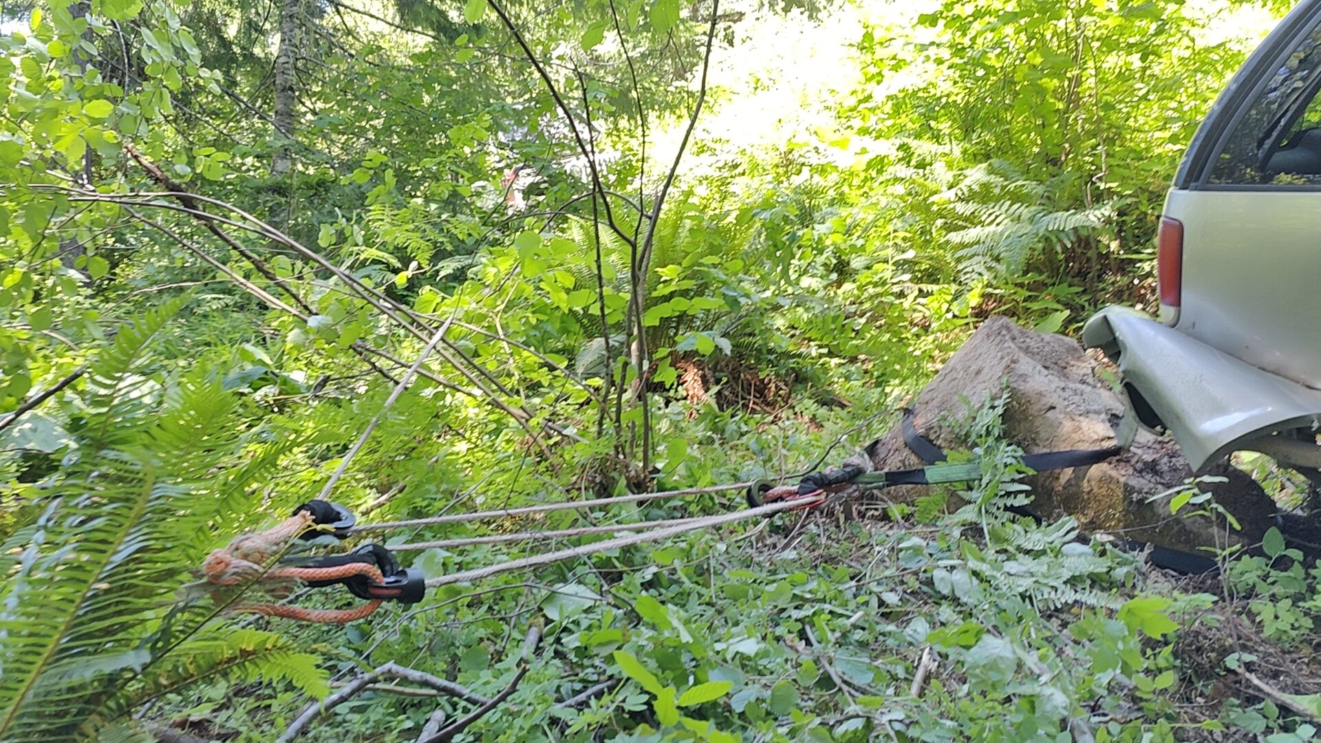

If you were closer I'd help. I pull broken vehicles out of the woods all the time.
See if you have an area 4x4 recovery page on FB. Several here in Oregon.
-Mac
