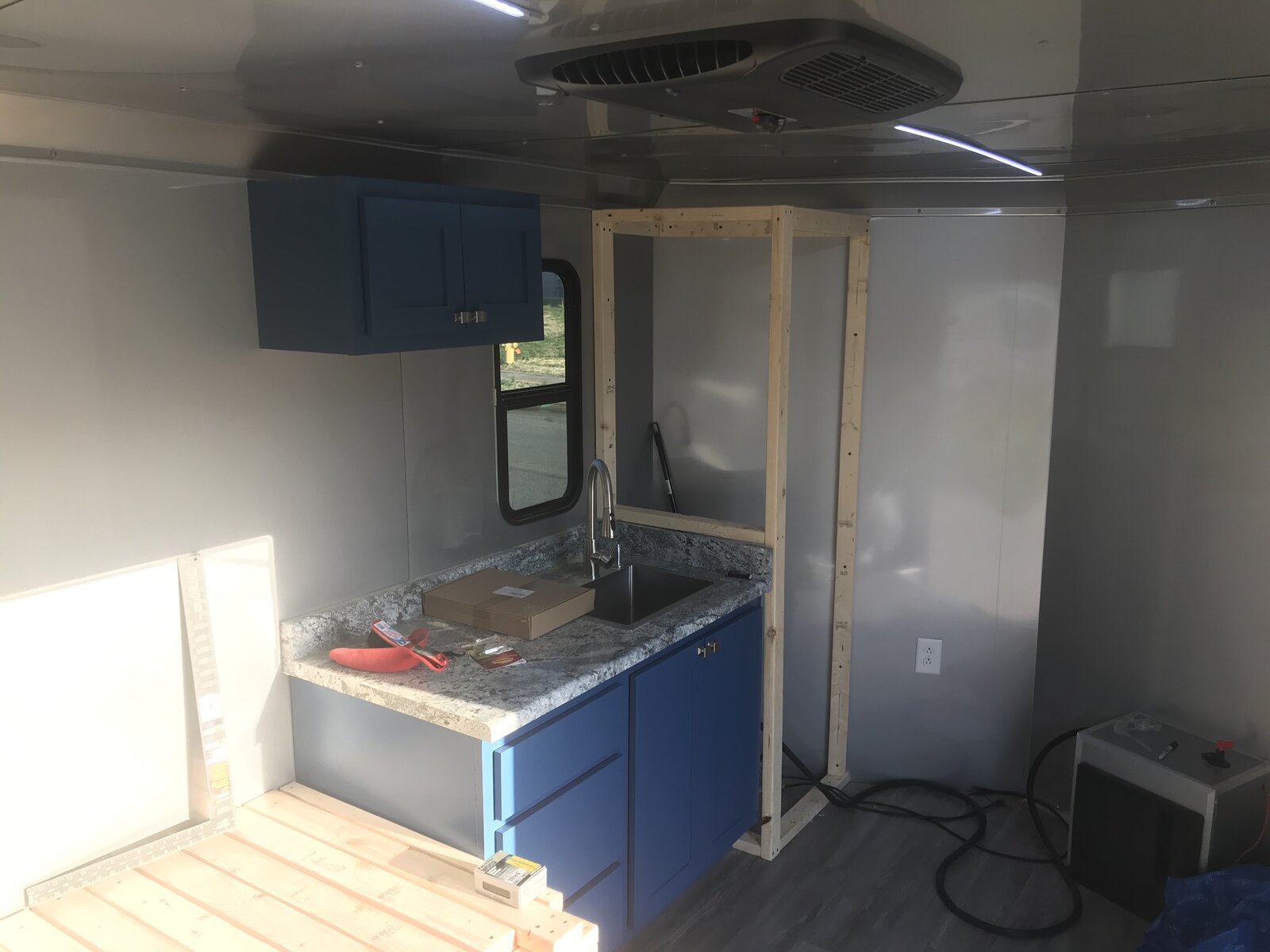

Upper cabinet installed got a few screws into the steel frame so it should stay up. Started building a pantry in the corner. Slow progress but it’s taking shape. Picked up some paneling to wrap the bed and pantry in today too. More tomorrow.
Little more progress. Still have some temp wiring ran until I can start the other pantry that will be opposite the partially completed one pictured. Will relocate the panel and start making things more proper. Going camping this weekend, so this as good as it gets for now.

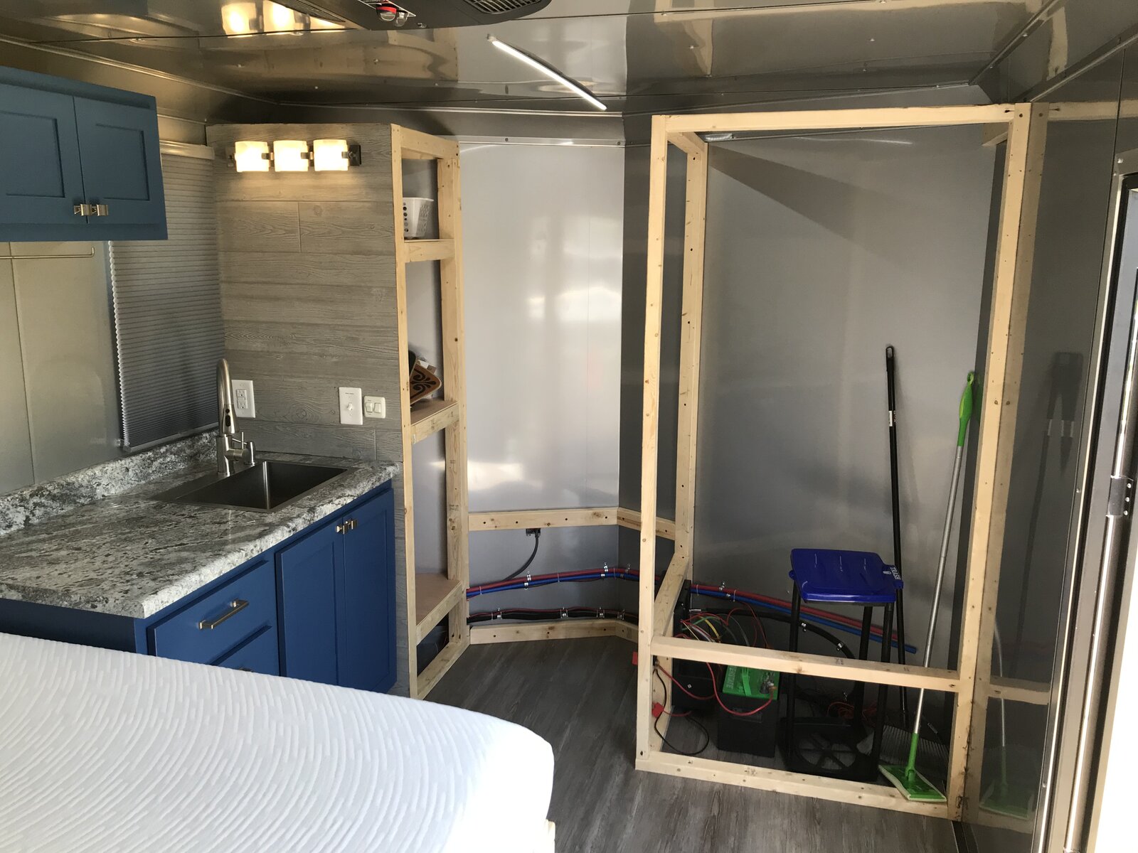

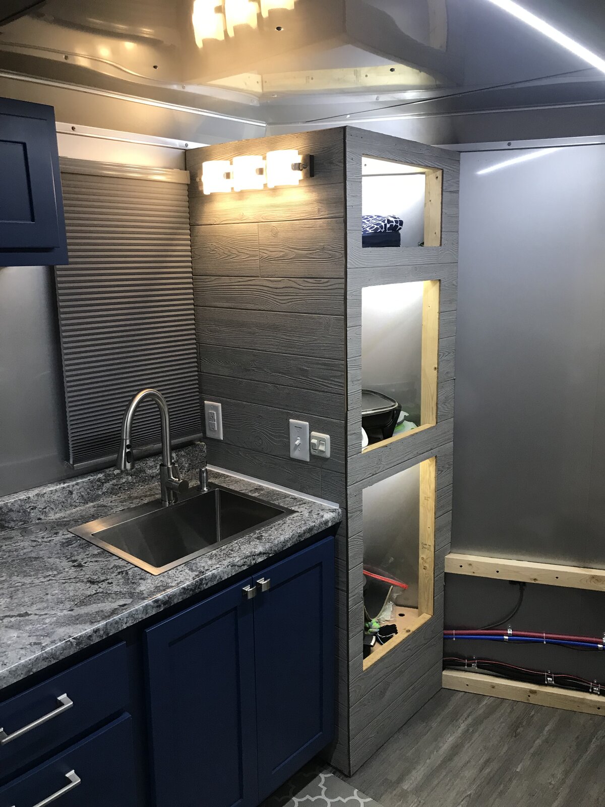

Next I started building the closet that will be the "wet wall" for the shower. I removed the power panel and incorporated it into the bottom of the closet. All the wiring and plumbing is now permanently installed and will be covered with paneling. The cassette toilet will be between to the two closets and have a curtain for privacy. The shelf above the power panel will be removable for access to the battery, wiring and plumbing. There will be one shelf up high and a rod for hanging cloths.
I also added a 12v kitchen light with LEDs and wired in a GFCI near the window. The water heater is now wired and working as well. I built some shelving into the left hand closet and will finish it all out with the grey plank paneling when I am done building the shower out. Each shelf in both closets will have an LED strip inside all ran off a two gang RV style switch along with a light for the "bathroom area"
I plumbed in low points drains in the bottom of this closet for easy winterization of the plumbing. It has two quarter turn valves that are hidden below the shelf bottom. This bottom will remain removable to access them.
That's all for now, off road trip this weekend and boating season coming fast. Hope to have it finished 100% by the Fall. Waiting on parts to install the shower, that's the next big project.

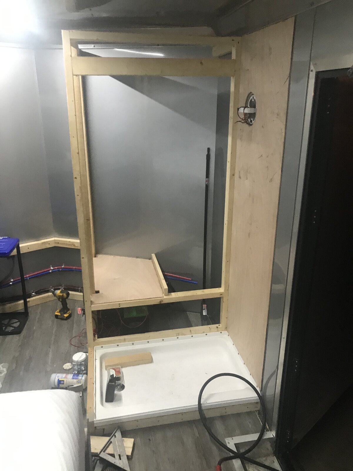

First order of business, finish the hanging closet and prep for shower install. I added a through the wall power vent with a light ring inside to provide light in the shower. Started framing the rest of the hanging closet and installed the shower pan. This pan was intended to be installed with three walls, but I omitted one and built up a curb. This will later be wrapped in FRP same as what is on the shower walls. Ran out of time this week :( but have a big trip to Hot Springs planned this weekend with lots of wheeling.
Next, cut and fit 5mm ply as a backer after framing in several nailers across the span. The ply is glued down, and trim nailed so it stays put. The FRP was cut and fitted to the ply, attached with shower wall adhesive and a couple trim nails in the top corners just to be safe.
Next, installed plumbing, faucet, shower head (Oxygenics nice unit!), installed the interior light ring and the shower curtain track on the ceiling. Pressure tested plumbing, no leaks!!! Caulked everything in tight and had the wife do her part, clean up my mess.
