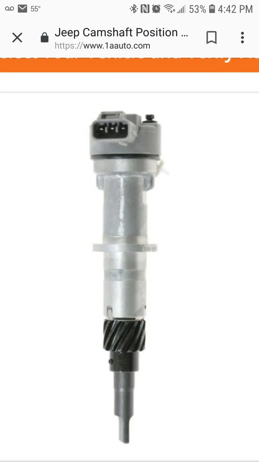

Great I'll order it on the OEM website. Just a quick question do I have to pull everything. Gear and all. Or just the cap on the top with the two screws holding it on. It looks pretty complicated if I pull the gear and all. As far as getting it back in on on the Compression stroke and TDC and Oil pump at 11 o'clock. If it's just the electronic cap with the two screws. I've got that all day.
It was the Cam Shaft Position sensor. I ordered the "Mopar" Branded Part off of Amazon. It was a quick and easy install. Just 2 screws, replace the cap and plug it back in. I have 160 miles on the new CPS and all start ups have been perfect. Fixed!! Below is a link to the specific CPS I ordered and installed.
*Note: this is for the 2000 TJ that has the fuel rail. Check yours to make sure it's the correct CPS for your year TJ. It is a different CPS for different years. Thank you everyone!
