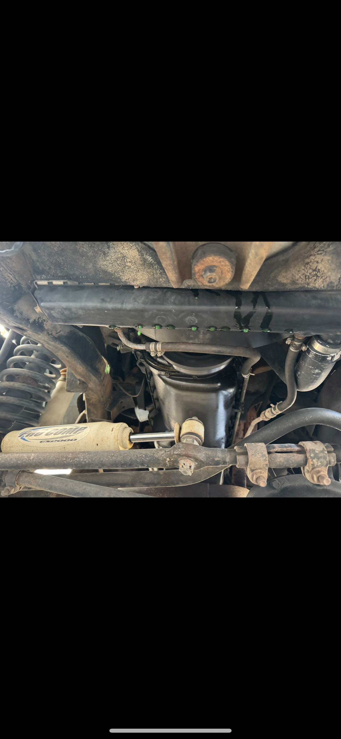

98 Jeep Wrangler. After starting up I am having a decent amount of coolant leak from the bottom housing of the radiator. Will drip steadily for 5-10 minutes and then stops all entirely with no more leaks. Seems to only occur starting up after sitting for a couple days.
No visible leaks/ cracks in radiator from what I can see.

Pretty common. The tanks are sealed with a rubber o-ring that lose elasticity over time. When that happens, it will seep a bit until the radiator warms up and then stop when the heat swells it back to size.
