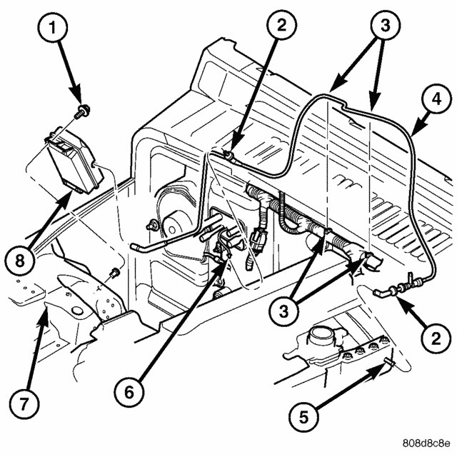

thats what im thinking since theres just a change in intensity, which lines could be the culprit? the one in the engine bay seems fine, but thats as far as i got. I saw a vide of a guy using a brake bleeder connected to the vaccum in order to find it, not sure if that would work.
Edit: thanks for the diagram, im gonna check that next!
Any one of the hoses if leaking will affect the system so start at the intake manifold and work one line at a time, there should be at minimum a main vac to the brake booster, vapor recovery system, cabin HVAC and cruise control if equipped. Be sure to thoroughly inspect the rubber fittings.
