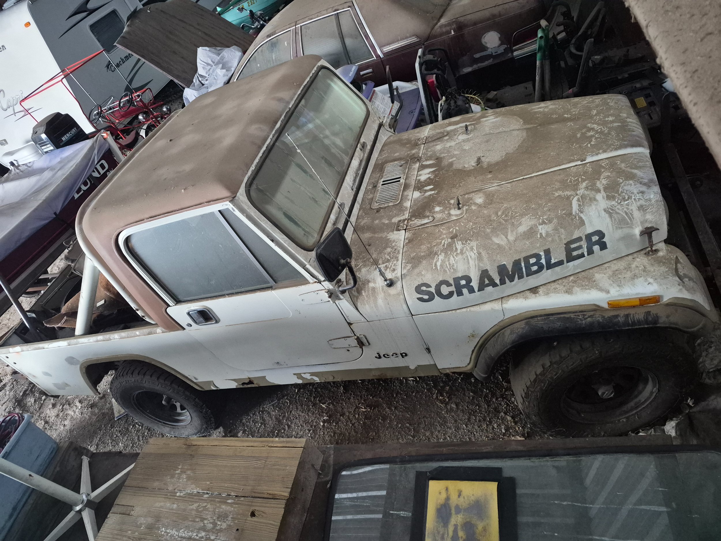

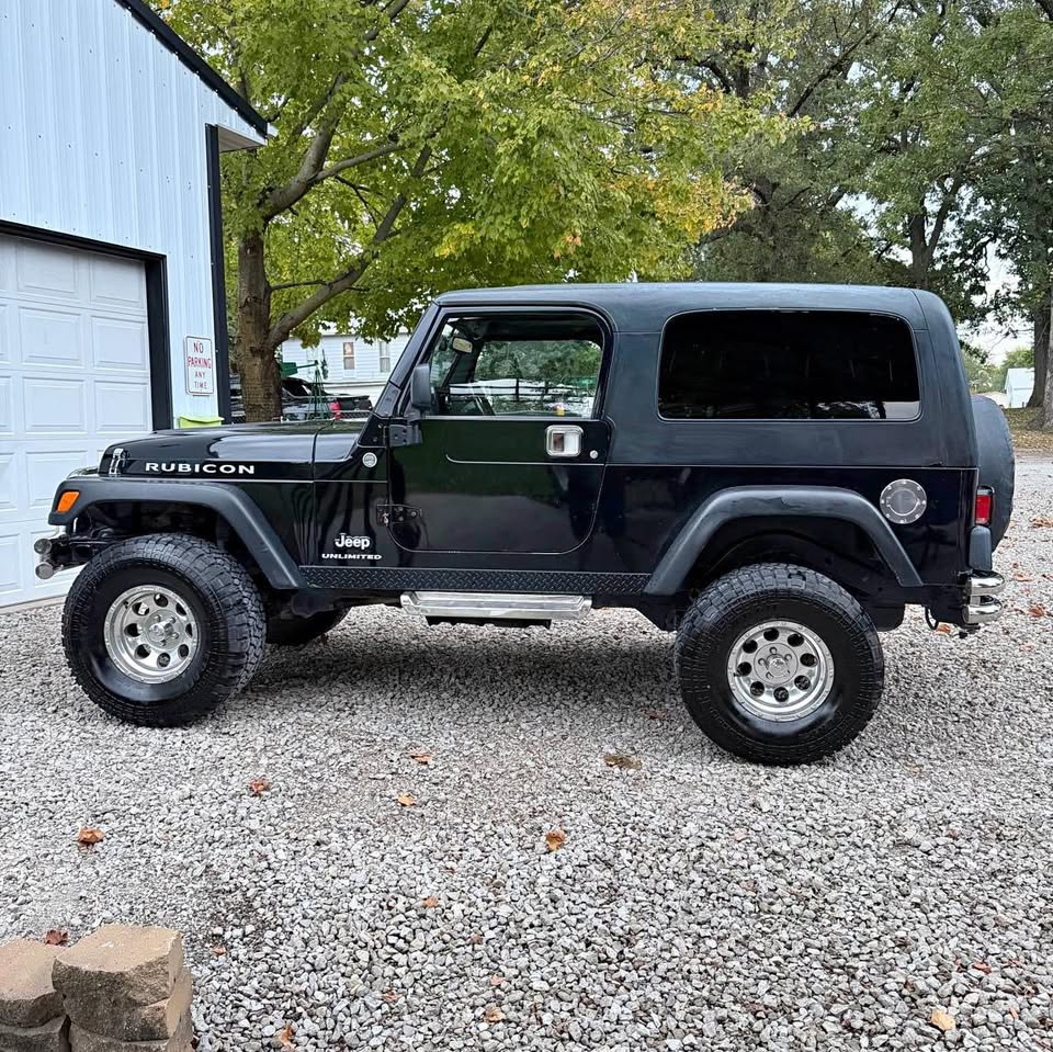

I'd like to drop my CJ-8 Scrambler body on a clean 05 TJ/LJ Rubicon chassis, with the goal of keeping as many factory TJ/LJ systems functional as possible inside the Scrambler tub.

if saving money were the only aim i guess I'd just put the CJ-7 front end kit on the 05 Rubi LJ and get the scrambler decals for the hood. But I have a clean Scrambler. but the carburated 258 sucks and the no het vets suck. Im close to procuring this 05 LJ Rubi So I figure... WHy not cut them both up swap the bodies and build two unique rigs. an 05 Rubicon Scrambler (my dream Jeep) and a bear bones 81 TJ with twin sticks and locking hubs that I might want to throw a plow on. Saving money is not the goal here, although my budget wont be upsurd. I see an oppertunity to combine all the skills Ive honed over the years to put together a unique Jeep. Thats hard in the jeep world because generally speaking if it's Jeep it's been done.

If I still had my 84 Scrambler ain't no way it would get cut up. But I grew up on CJ's and they hold a special place in my heart.

The CJ8 firewall and dash are more rounded than the TJ dash, and probably a bit lower and perhaps narrower. You might have to fabricate some sort of hybrid. In today's world it seems like 3d scanning would be the ultimate cheat code to map these onto each other. I would think the position of the shifter and 4wd linkages are also items you'd want to bring in from the LJ chassis to the CJ body, so really the whole center console stack. As I recall the CJ-5/7/8 all had the shifter position much more forward in the cab than the TJ. And I think you would want to start from an LJ donor if possible and even then the CJ-8 frame is still a bit longer so some stretching will be necessary somewhere.
KeyParts has alot of the CJ8 parts available for restorations and perhaps might have some useful dimensional info.
